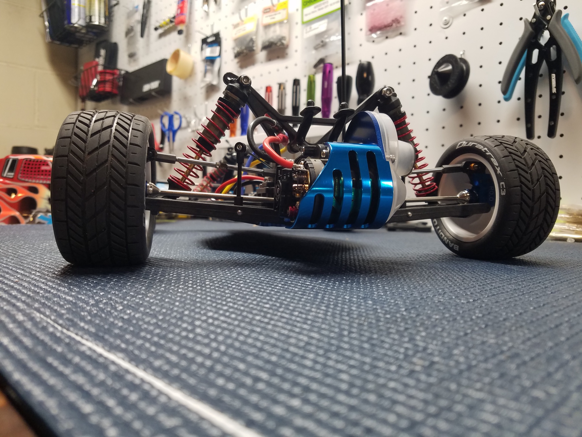

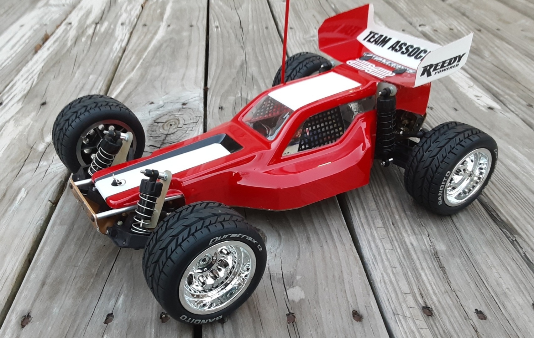

This is another option.
It is a short arm car with hex conversion. It uses wide offset RPM crawler wheels and rear sized tires all around. It is lowered, has very limited shock travel, and stiff springs.

Your short arm conversion was on my mind when thinking about this. It looks to me the short arm is similar to the DS in width. Have you explored the touring car/VTA tires?juicedcoupe wrote: ↑Tue Apr 19, 2022 2:38 pm The T4 would be easiest. Put some street tires on, limiters in the shocks, and stiffer springs.
Does the width of the platform matter, the t4 would be very wide? Wouldn't the ride height be high even when lowered, or is there a way to lower the center of gravity?

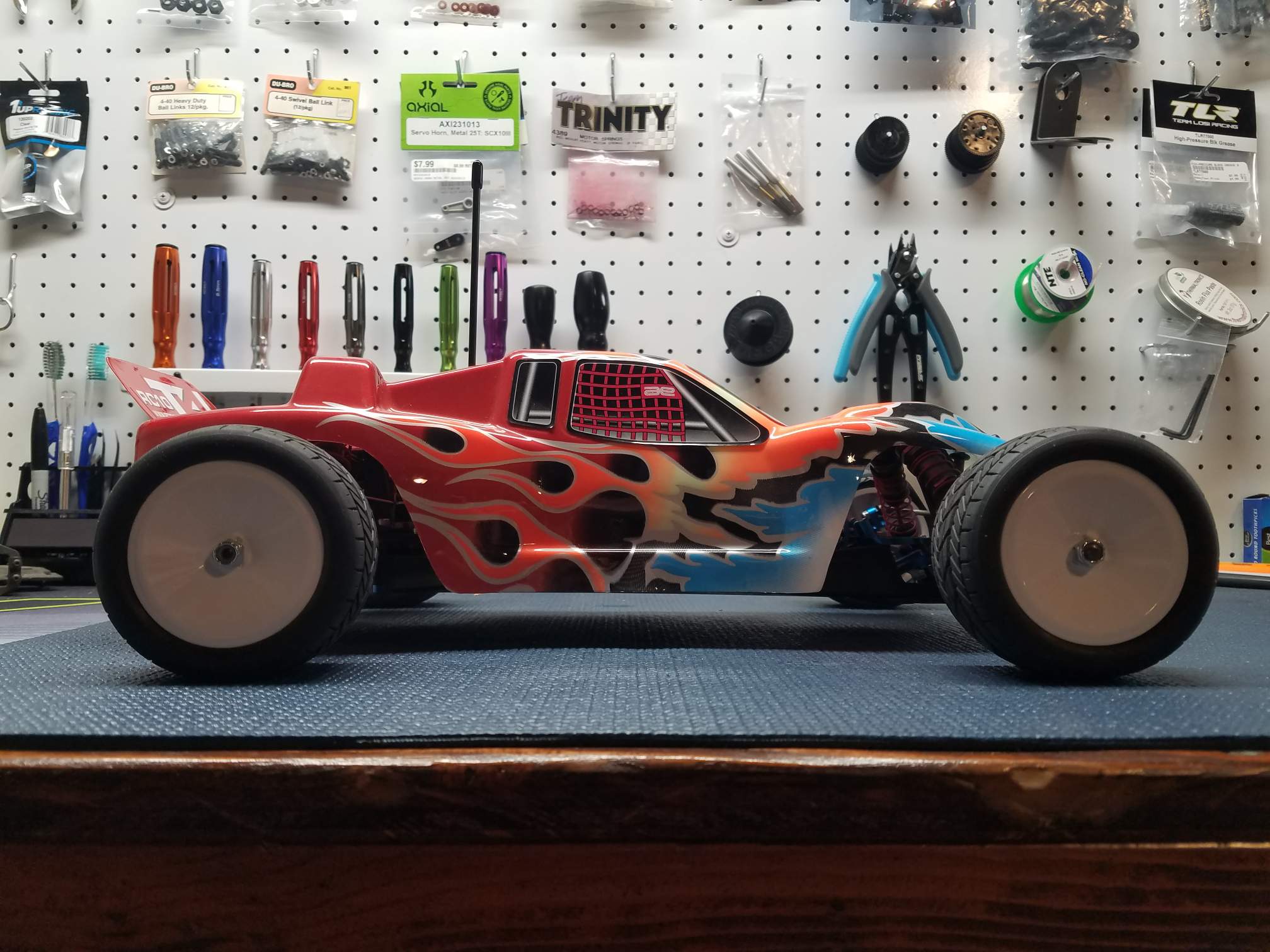

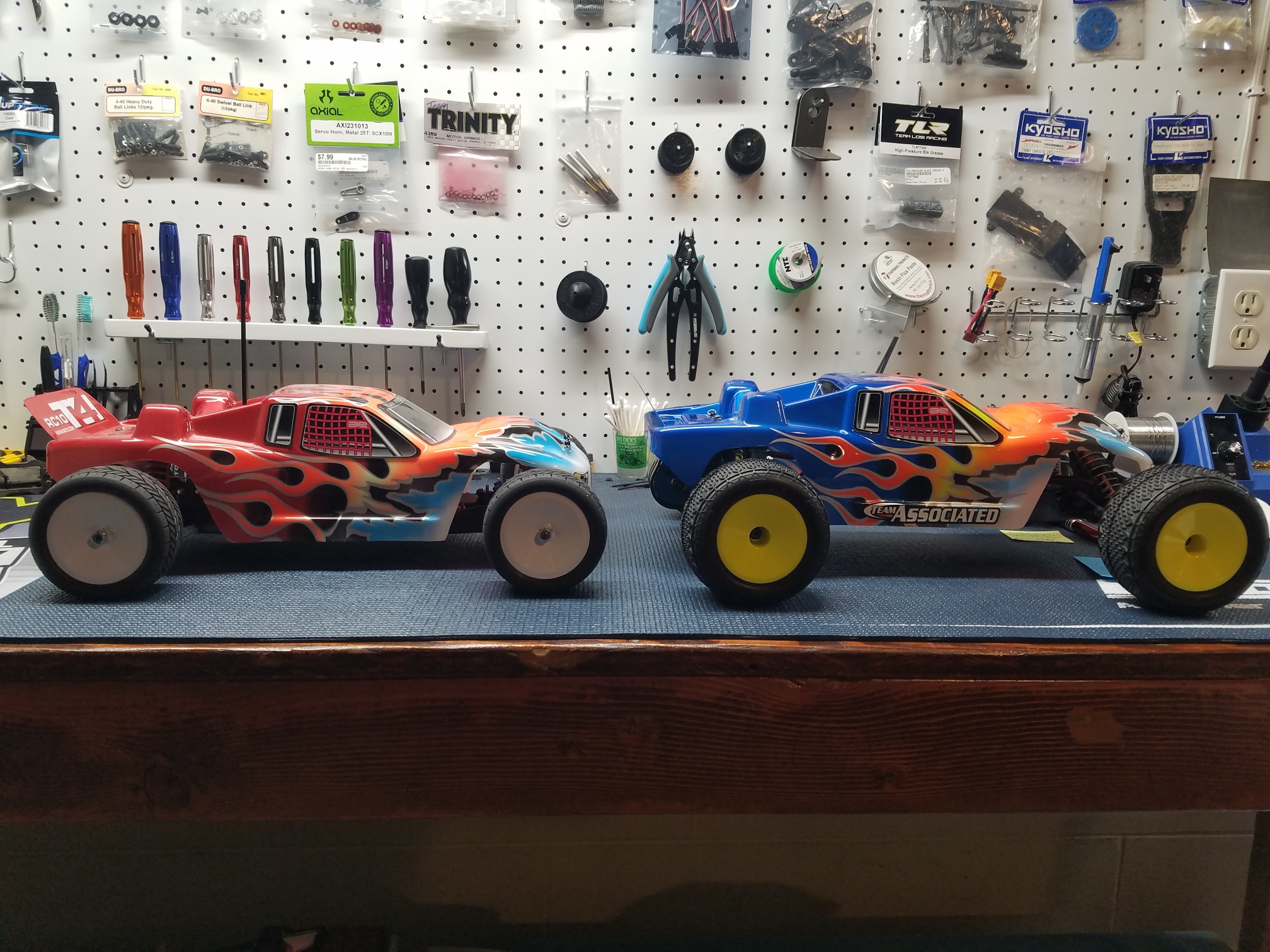

Here's my on road T4 for example. Width is 11.5" compared to the original T4 13" width. The chassis has 3/4" ground clearance, it can go lower but I'm comfortable with it being the way it sits. It has 2.2" buggy wheels in lieu of truck wheels. Shocks are B4 factory team threaded with Associated red truck springs (3.90 lb front / 2.95 lb rear). The one photo is it next to my factory team T4. It sits 3/4" lower than the T4 FT and a full 1" lower than my T4.3.

that looks promising. How is it narrower?R6cowboy wrote: ↑Thu Apr 21, 2022 11:17 pmHere's my on road T4 for example. Width is 11.5" compared to the original T4 13" width. The chassis has 3/4" ground clearance, it can go lower but I'm comfortable with it being the way it sits. It has 2.2" buggy wheels in lieu of truck wheels. Shocks are B4 factory team threaded with Associated red truck springs (3.90 lb front / 2.95 lb rear). The one photo is it next to my factory team T4. It sits 3/4" lower than the T4 FT and a full 1" lower than my T4.3.
