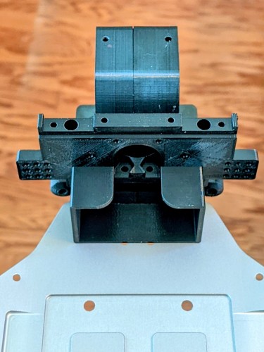

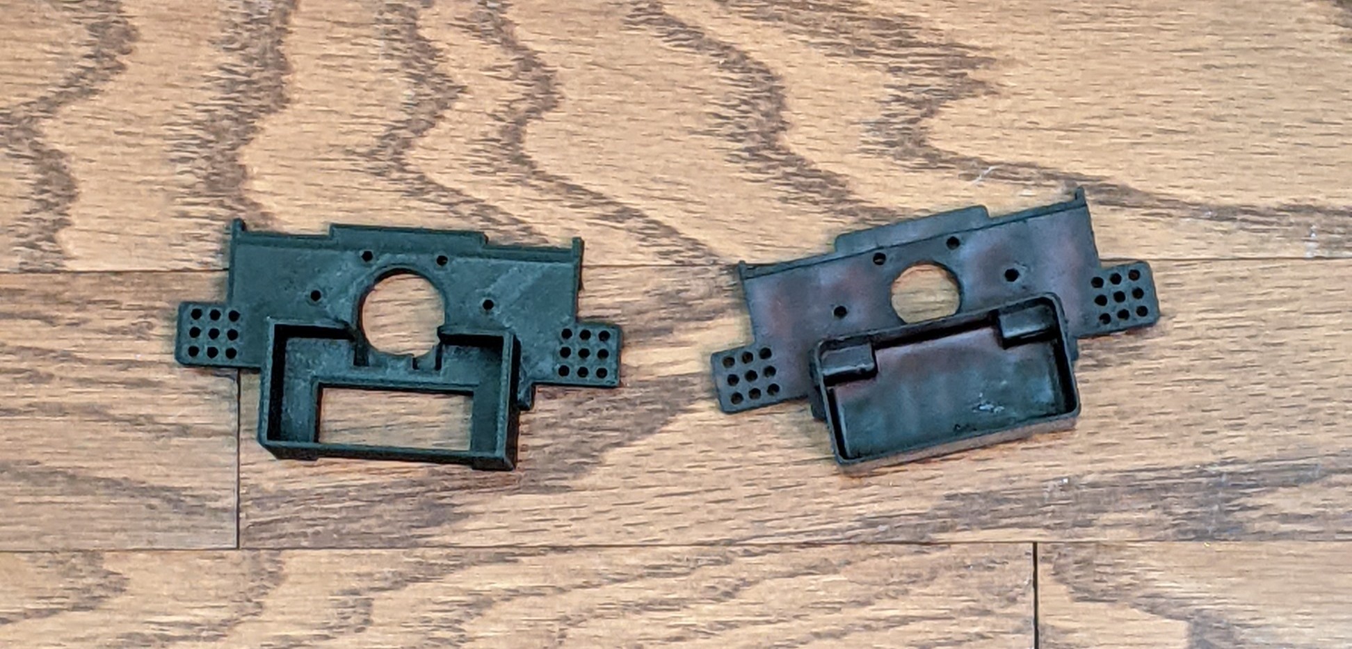

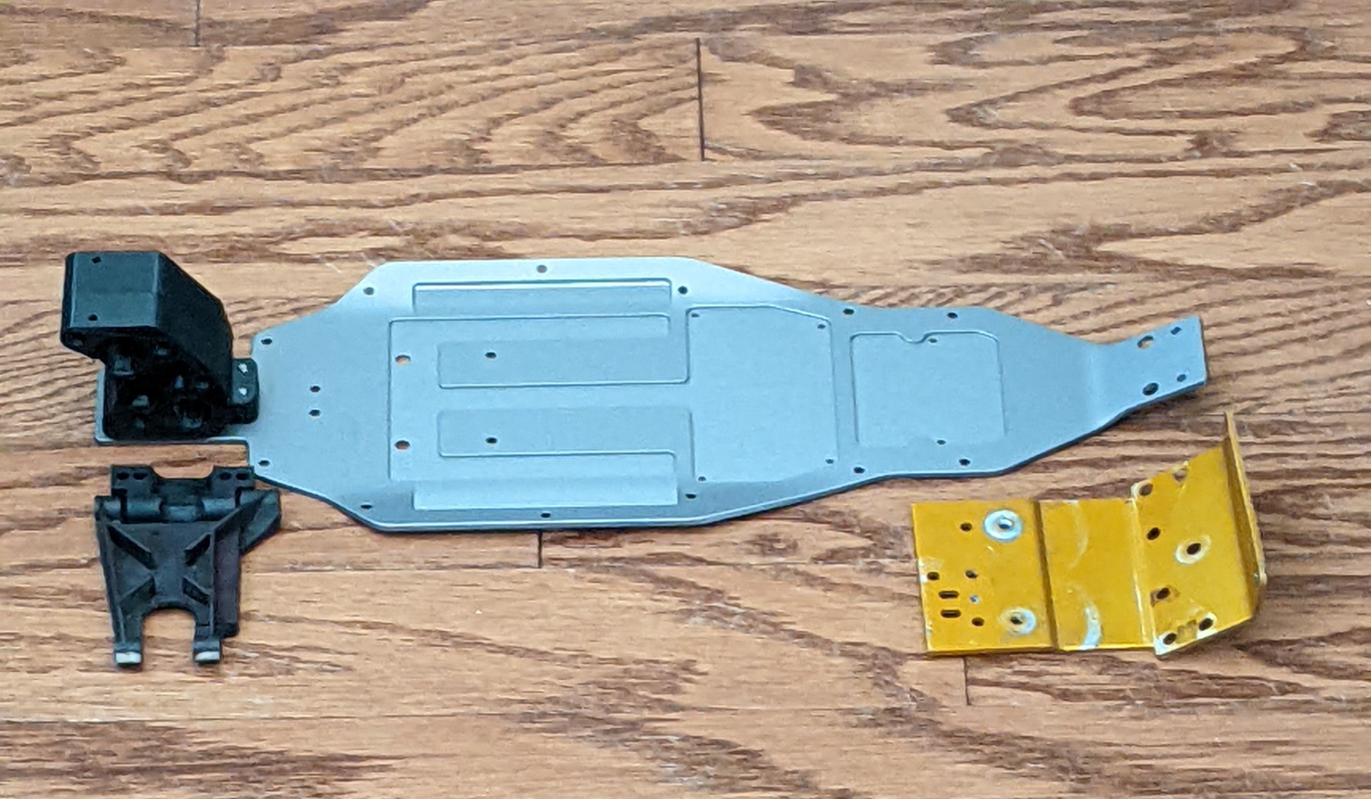

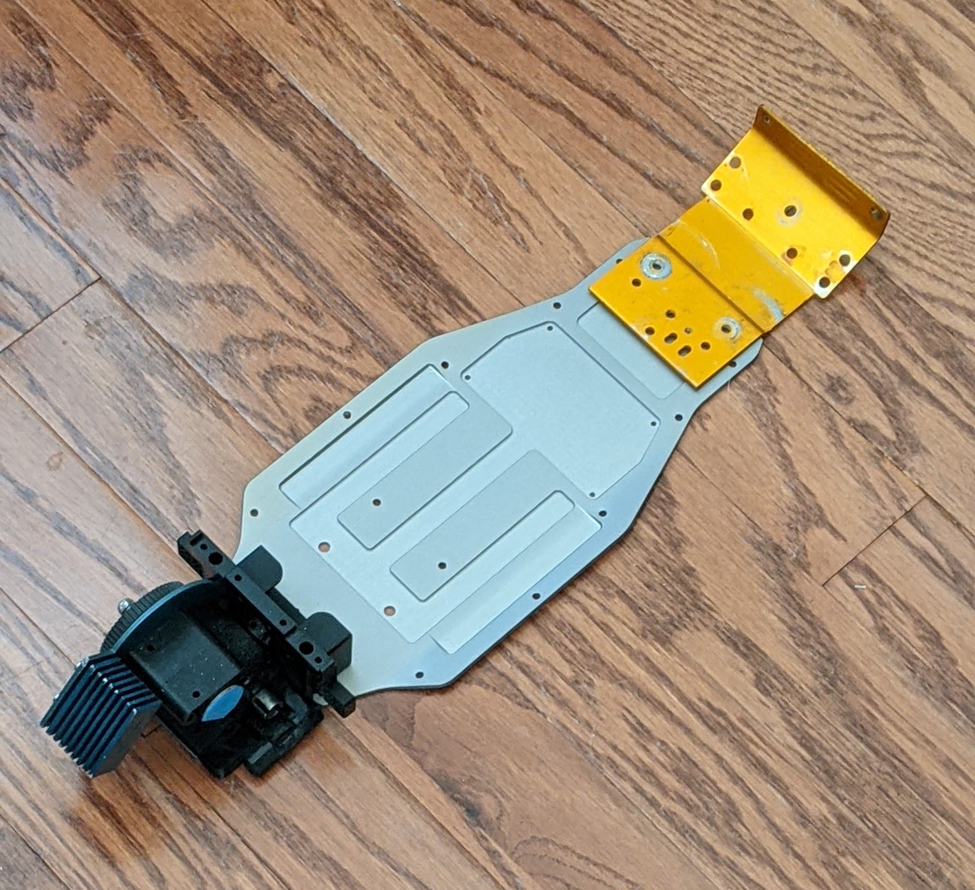

The overall chassis dimensions were close enough that it seemed like 'a good idea' to move a 6 gear RC10 buggy from a heavily used A stamp chassis to a new RC10B6 91650 chassis. My standards for close enough are low though.

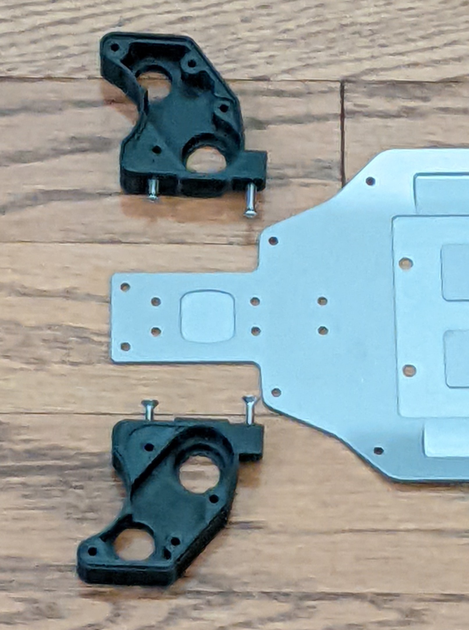

I started by printing a gearbox that's compatible with the chassis. I'm going to run with 5/8" x 3/8" outdrive bearings, so they might as well install on the inside of the gear box.
The first big hurdle is going to be how to attach the rear suspension.

Re: RC10 A+ Buggy Project
Cool project!

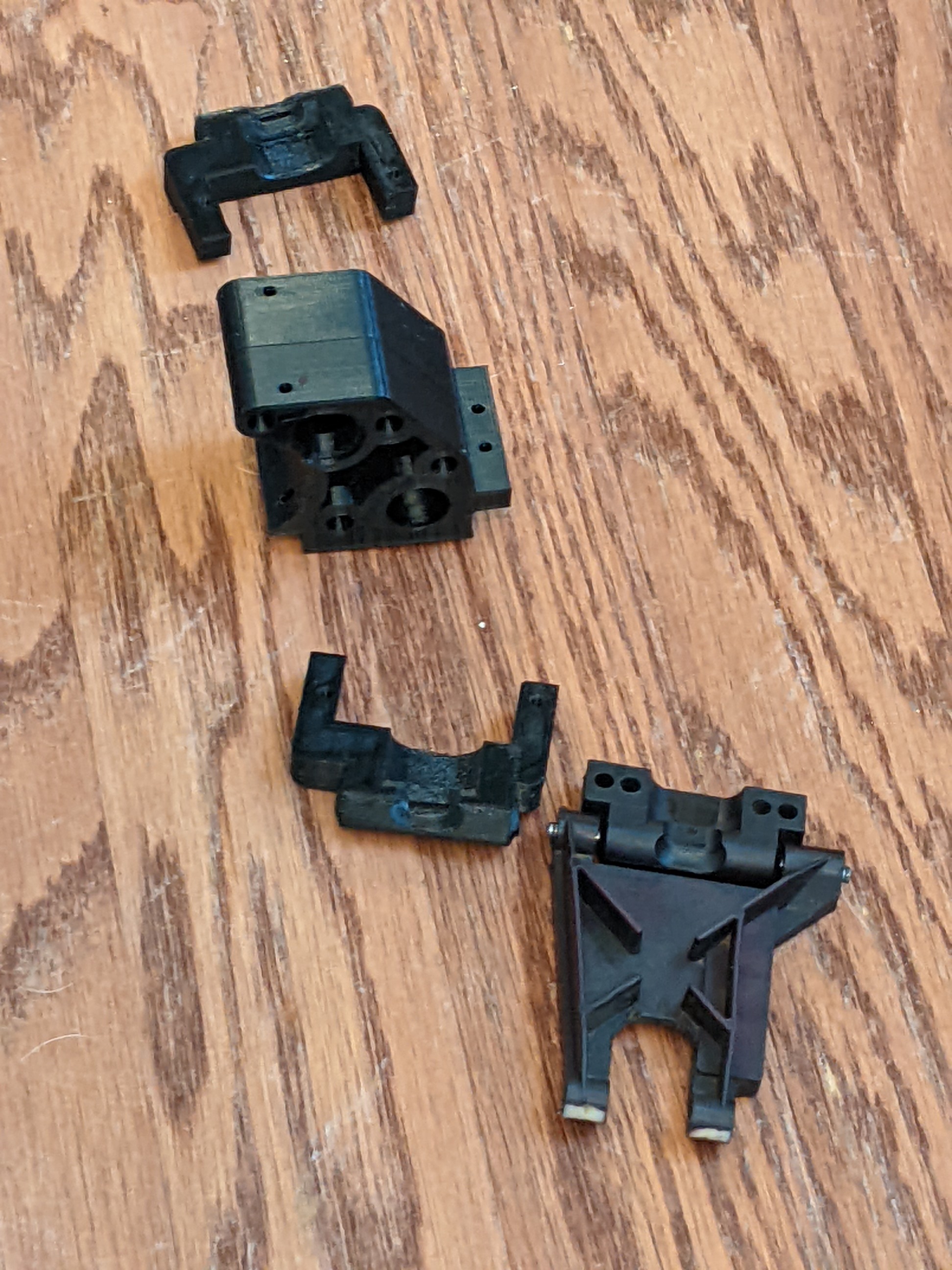

Since you're printing a gearbox case, is it possible to incorporate suspension mounts into the sides of the cases?
Anyway, it was just a thought.
I've thought about that, like a Traxxas gearbox with the other integral rear arm mounts. For the first attempt I'm not going that route. I'm starting with a plan that uses the original mounts.

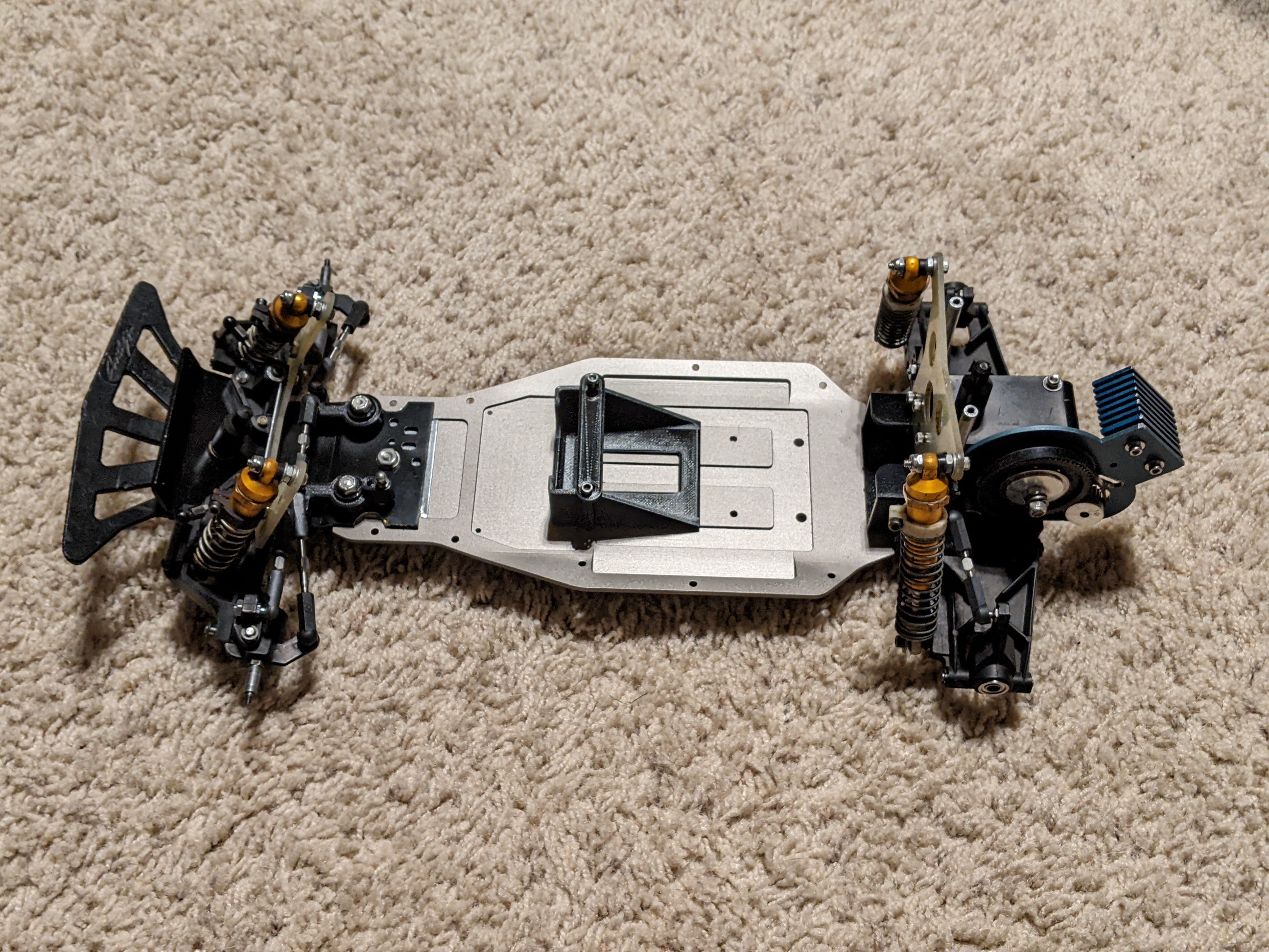

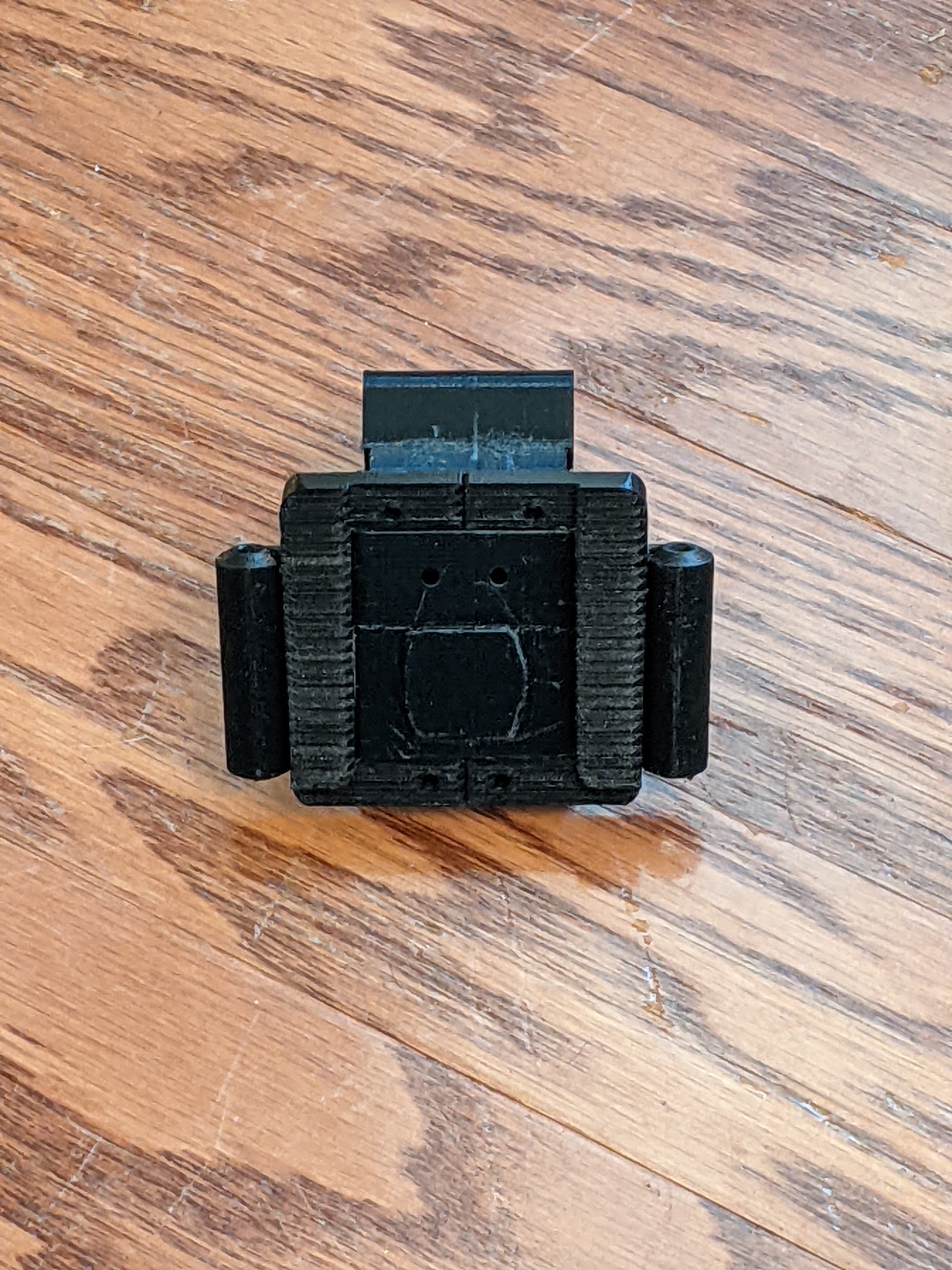

First try: wrap around rear arm mount blocks. Need to work on a compatible rear bulkhead next.

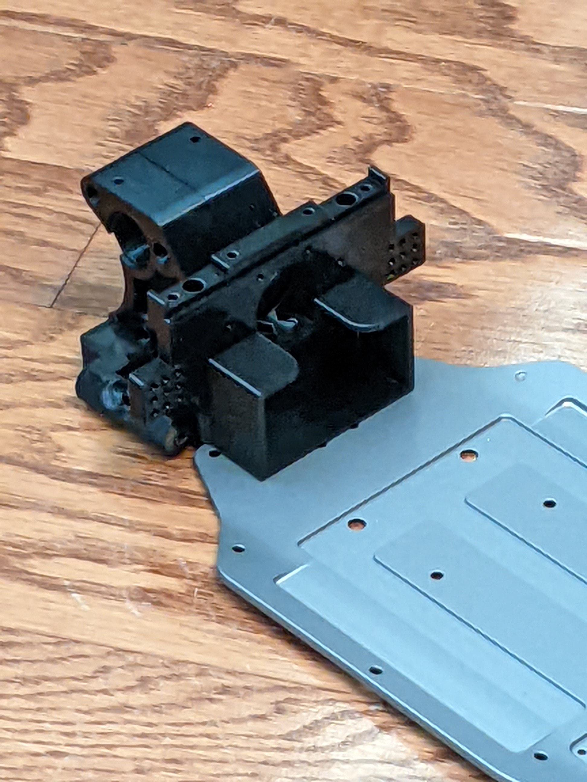

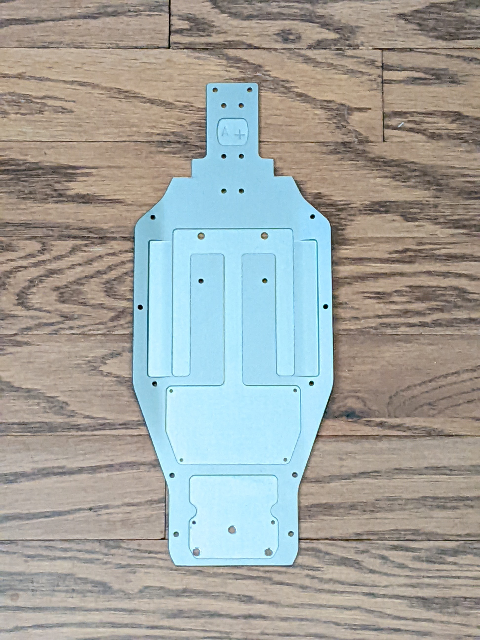

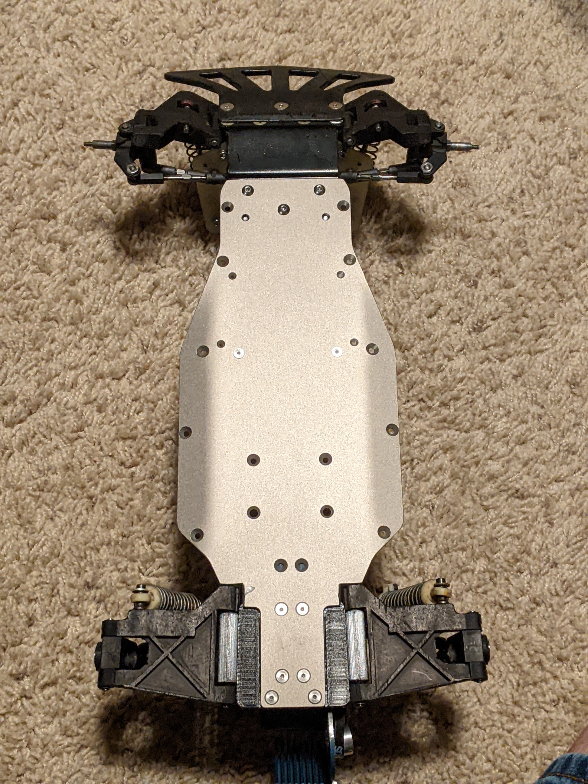

The bulkhead is sorted out, so it seemed like it was also time to christen the chassis plate before rear end assembly.

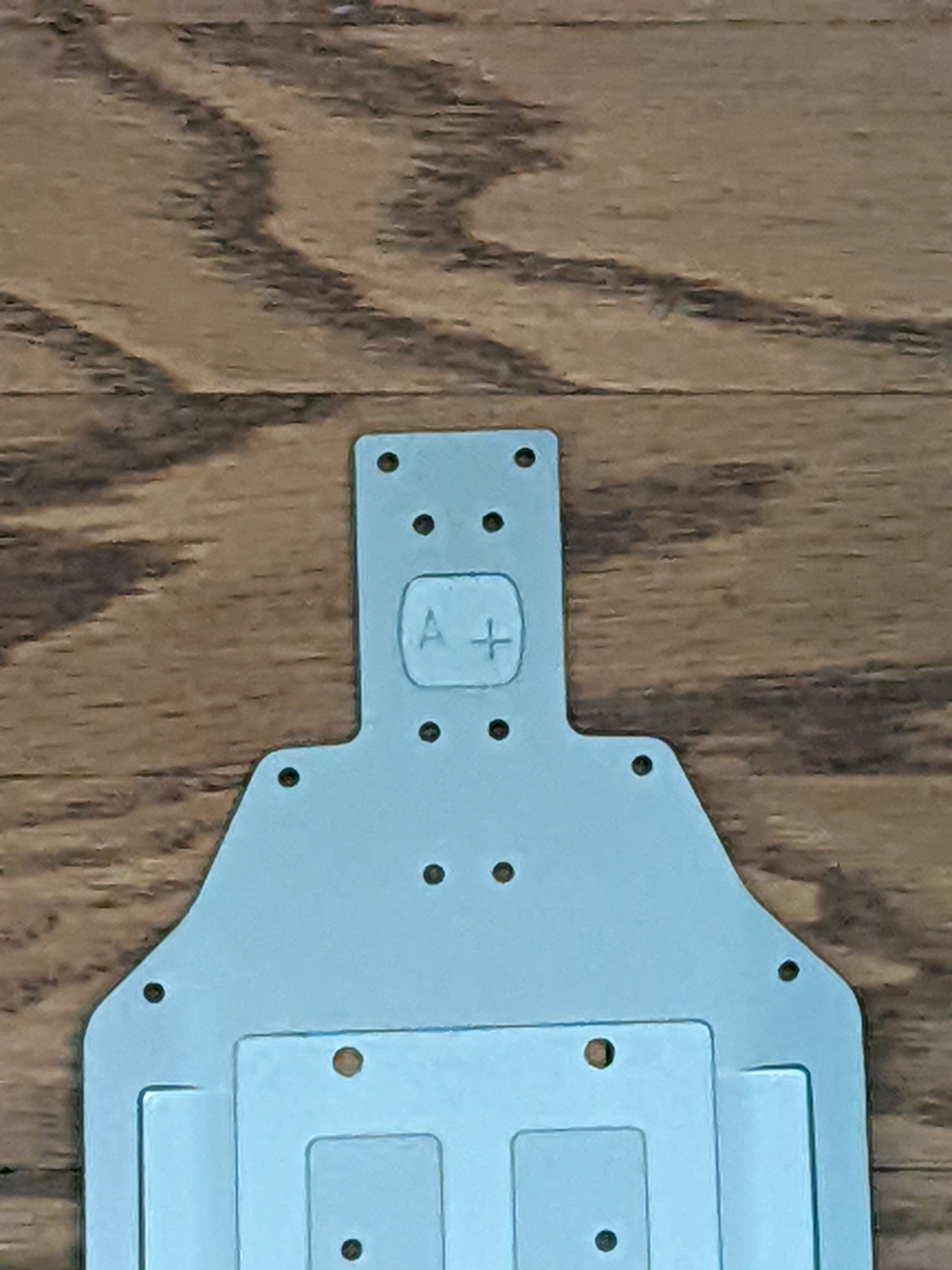

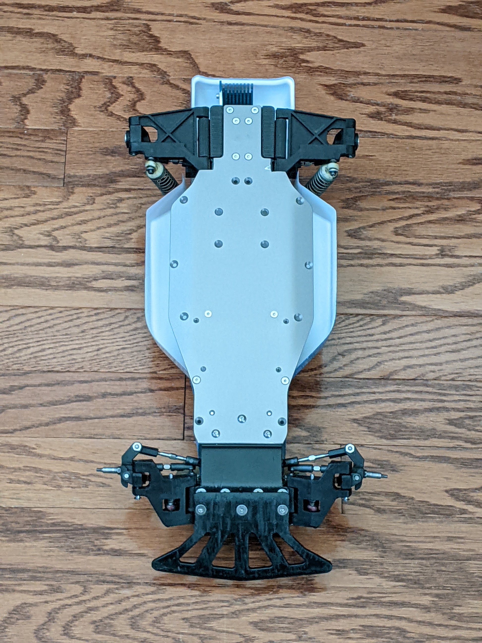

I probably should use a black nose plate.

I still need to figure out what I want to do with the nose tubes. I'm thinking about doing some 90 degree bend tubes.

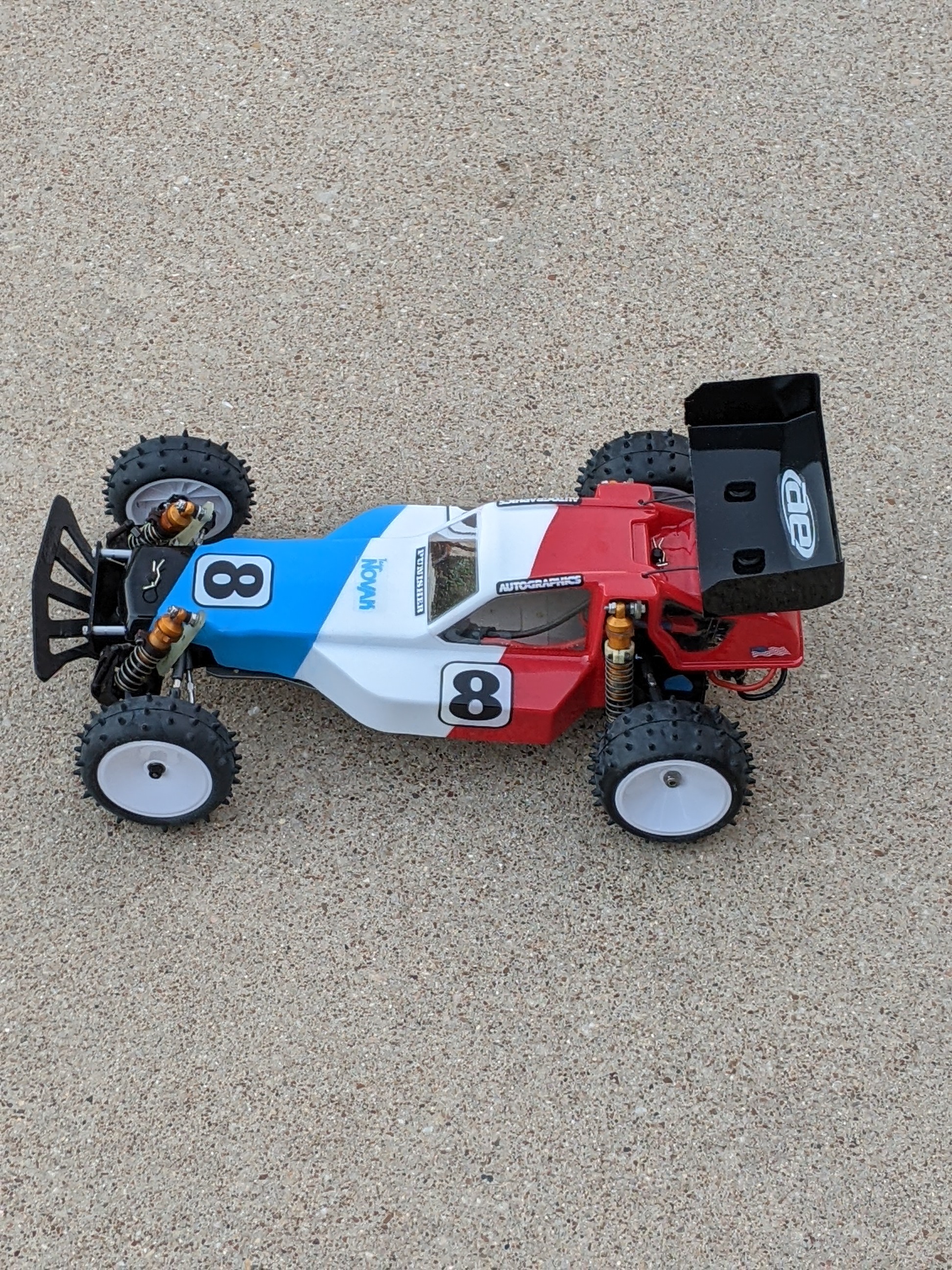

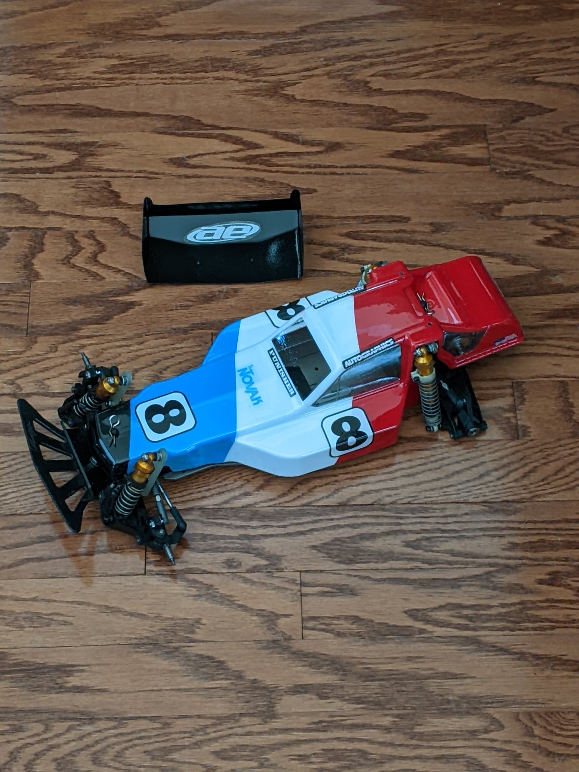

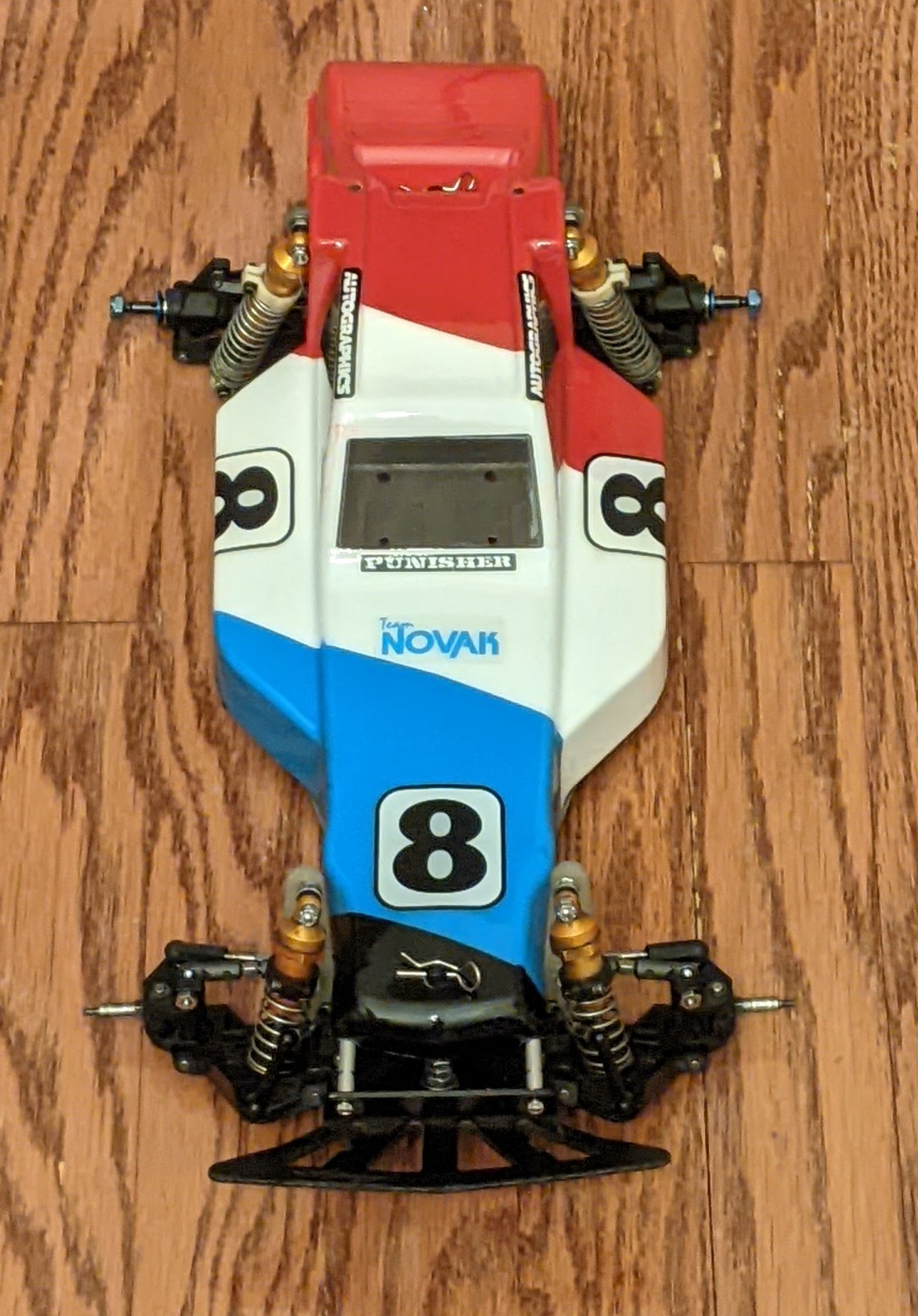

I still need to get some rear axles and stuff it with electronics, but I skipped ahead and painted up a body.
I think I'm going to convert back from hyperdrive to gears because this body has a cutout for the gear cover, and I really don't have more than one hyperdrive ratio to run.
I was planning to try some beginner airbrushing but discovered that my Badger airbrush uses NPT threads and Master compressor uses BSP threads, so that has to wait until I get an adapter. Space aliens are never welcome to visit Earth because the will likely bring with them Intergalactic Standard Threads and I don't want to have to get adapters for that too.
Following your build, very impressive! It looks very stout and sturdy, and a very clean way to update the original RC10.

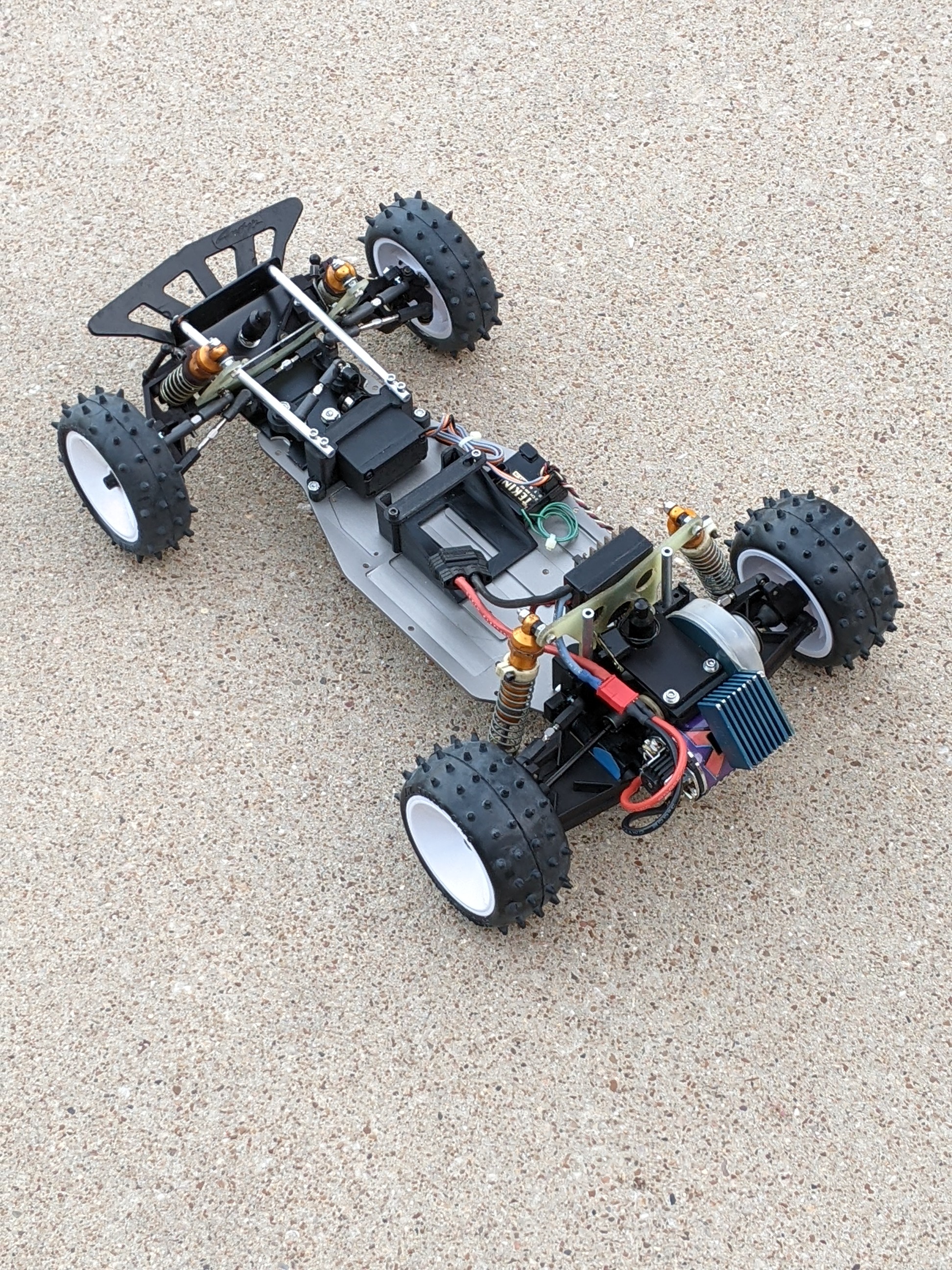

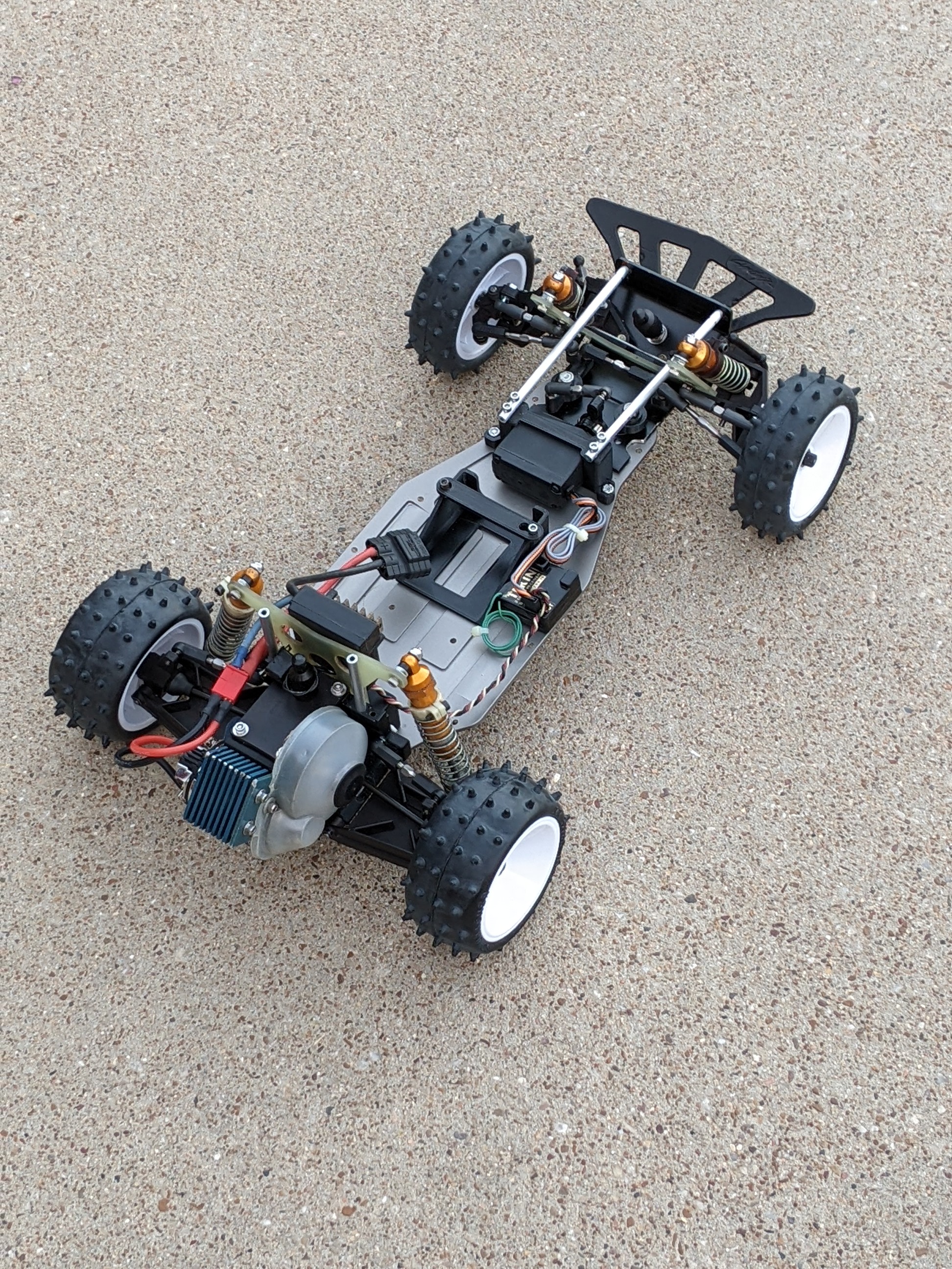

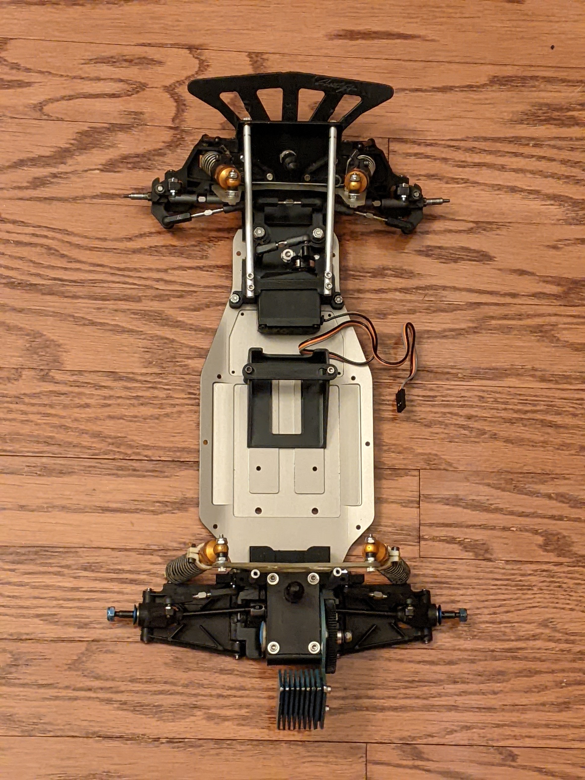

I figured out what I wanted to do with the nose tubes. Attaching them to my steering servo mount ended up being a simple solution. I also built up and installed a set of CVD axles. All that's left is to install the electrics and go driving.

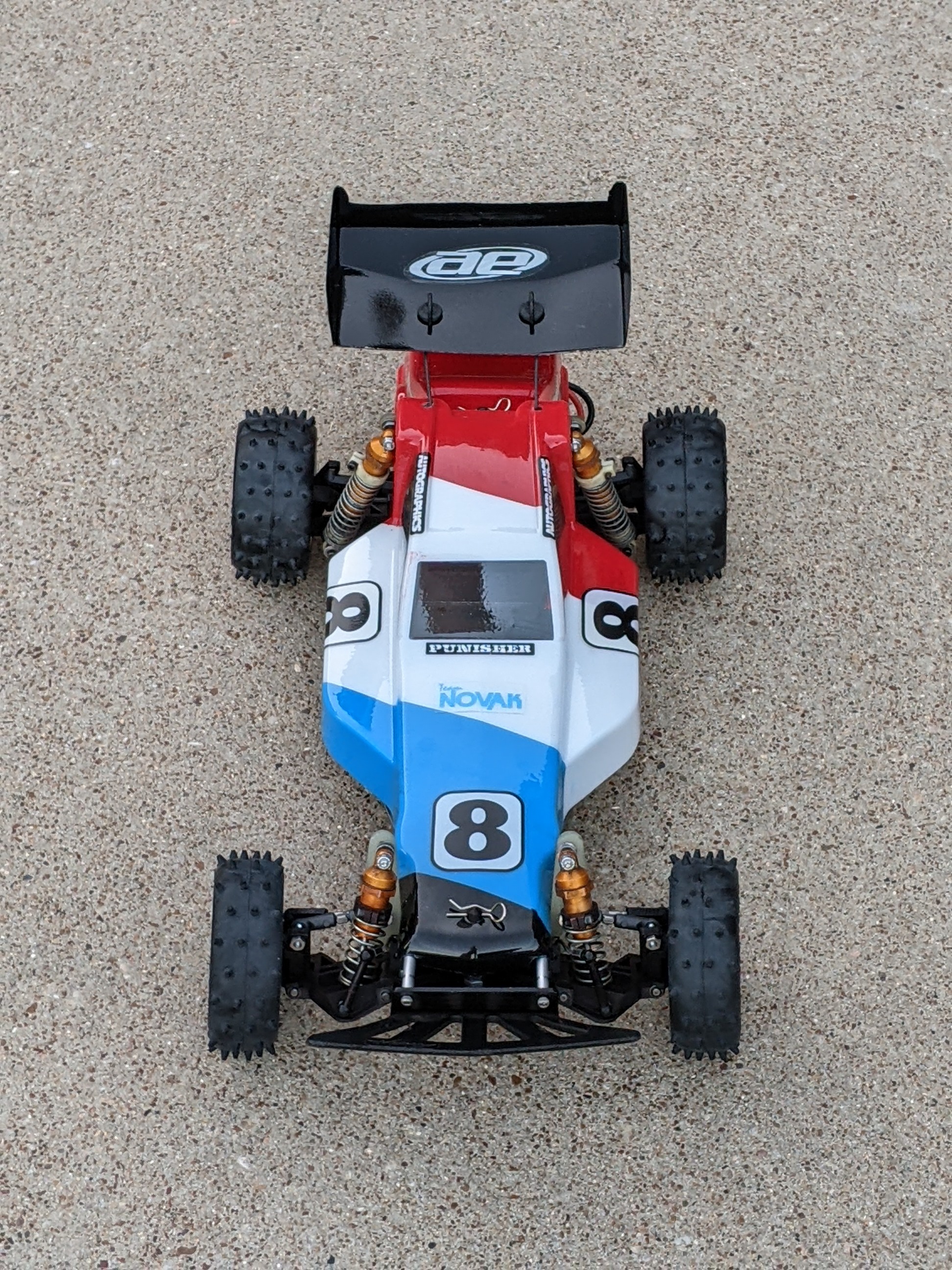

Test fitting the ESC and receiver locations. No, I didn't originally intend to put all Tekin electronics in it, but the Novak sticker on the body is staying.
Also seeing if I like the wing or not.
Really creative build. Yeah, wasn't expecting the Tekin electronics
, but very nice nonetheless. What's wheel and tire package details?
-Jerry-
- juicedcoupe
- Posts: 3539
- Location: Pascagoula, MS
- Has thanked: 269 times
- Been thanked: 2094 times

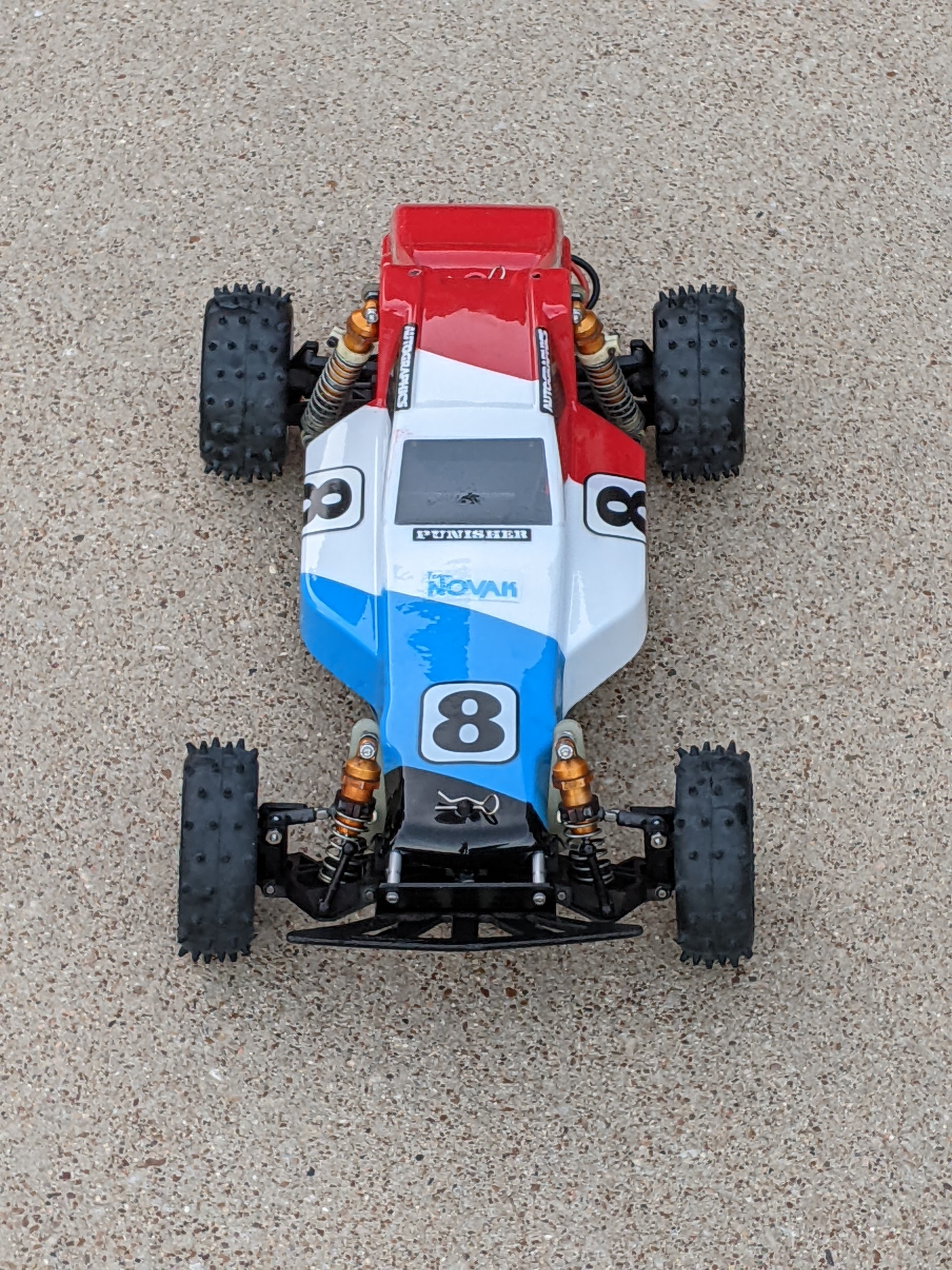

Looks like JConcepts B2 wheels and Schumacher full spikes.
- Frankentruck
- Posts: 3810
- Location: Texas, USA
- Has thanked: 2605 times
- Been thanked: 2979 times
Correct on the wheels and tires. Parts are:
Jconcepts 3403/3404 mono wheels (3/16" rear axle)
Schumacher 6595/6596 full spike off-road tires.
Schumacher U6652/U6653 foam inserts.
It was a fun build. I came across a set of 3 lightly used chassis plates so I feel obligated to chop them up and make a few more of these buggies.
