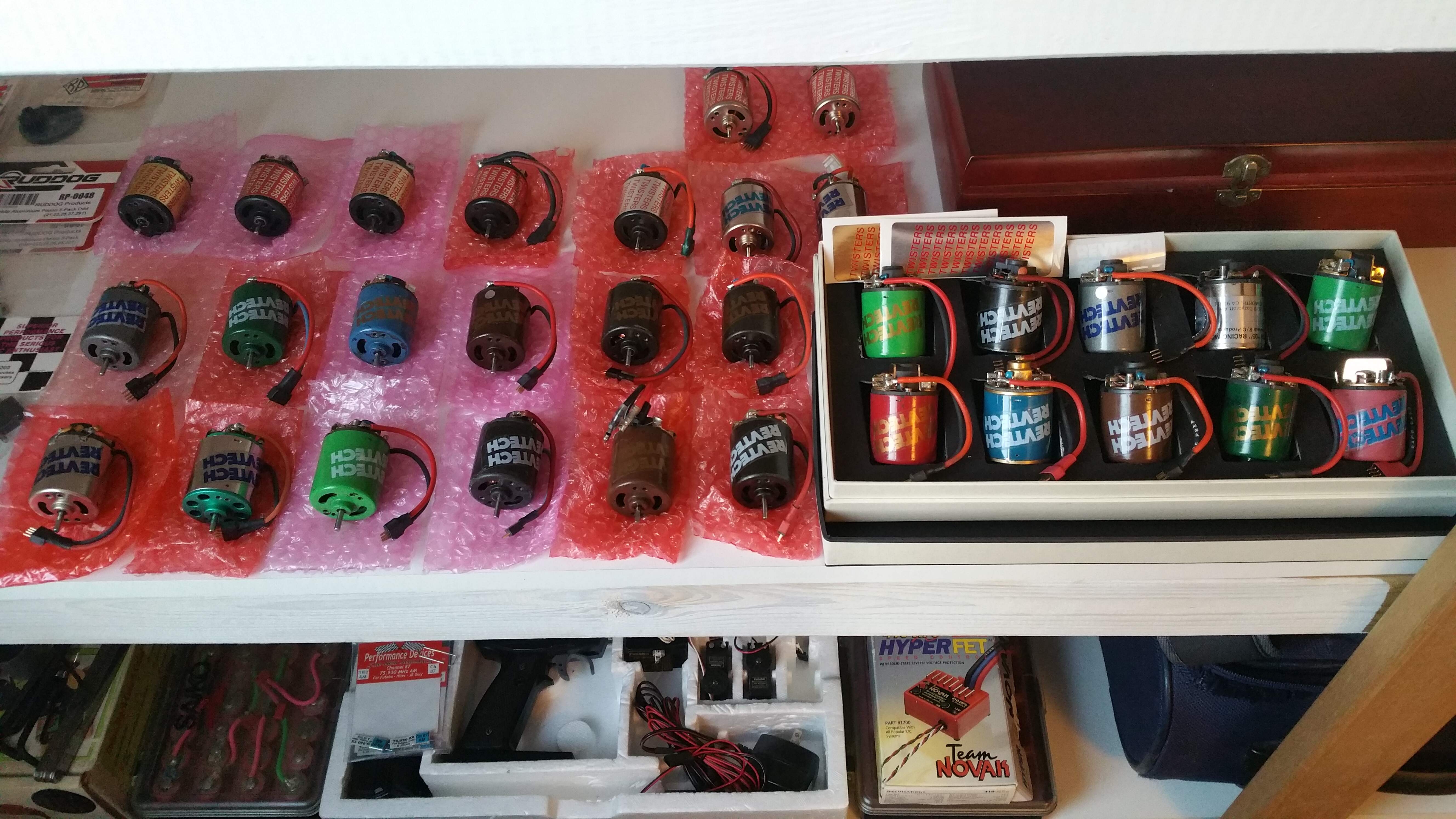

Is it a silver motor (paint) with black Revtech logos on it or is it a chrome motor with black, blue, green or gold logos?
Chrome motors were all stock 27T and not too dangerous to anyone. By today's standards, VERY slow. They required a handful of suppression capacitors to be soldered directly to the can, and between the (+) and (—) tabs. All the same Yokomo cans/endbells with different decals on them depending on what style teardown they were using at the time. That was from the days of sealed tabbed motors. You couldn't open them at all.
All painted Revtech motor cans are modifieds. Lots of odd colors, too—lime green, maroon, yellow, gunmetal...
If it's a stocker, they are rare, but still stock. If it's a mod... you can always sell it to me.
Does it look like this?
13-single if my memory isn't completely shot.

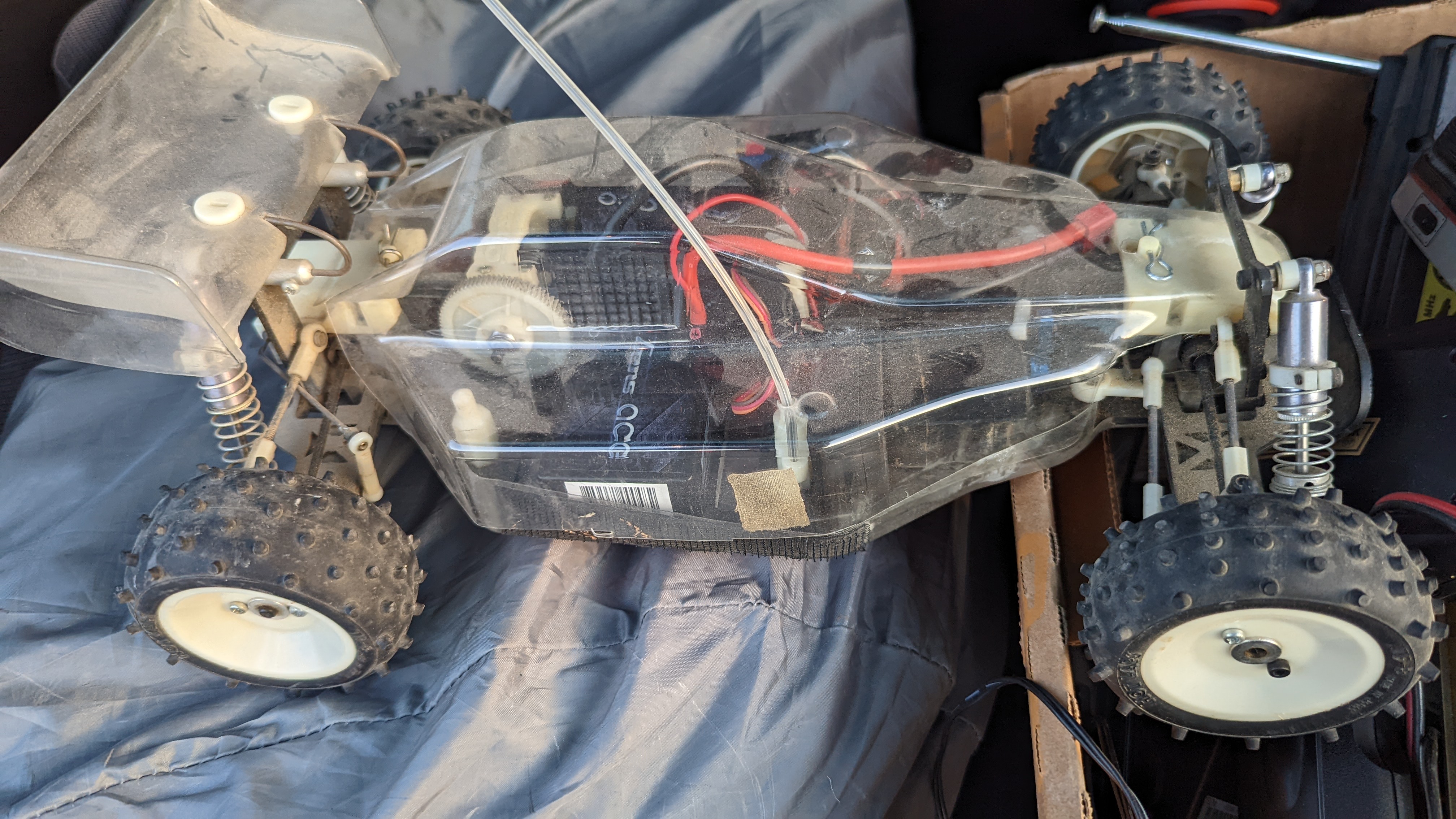

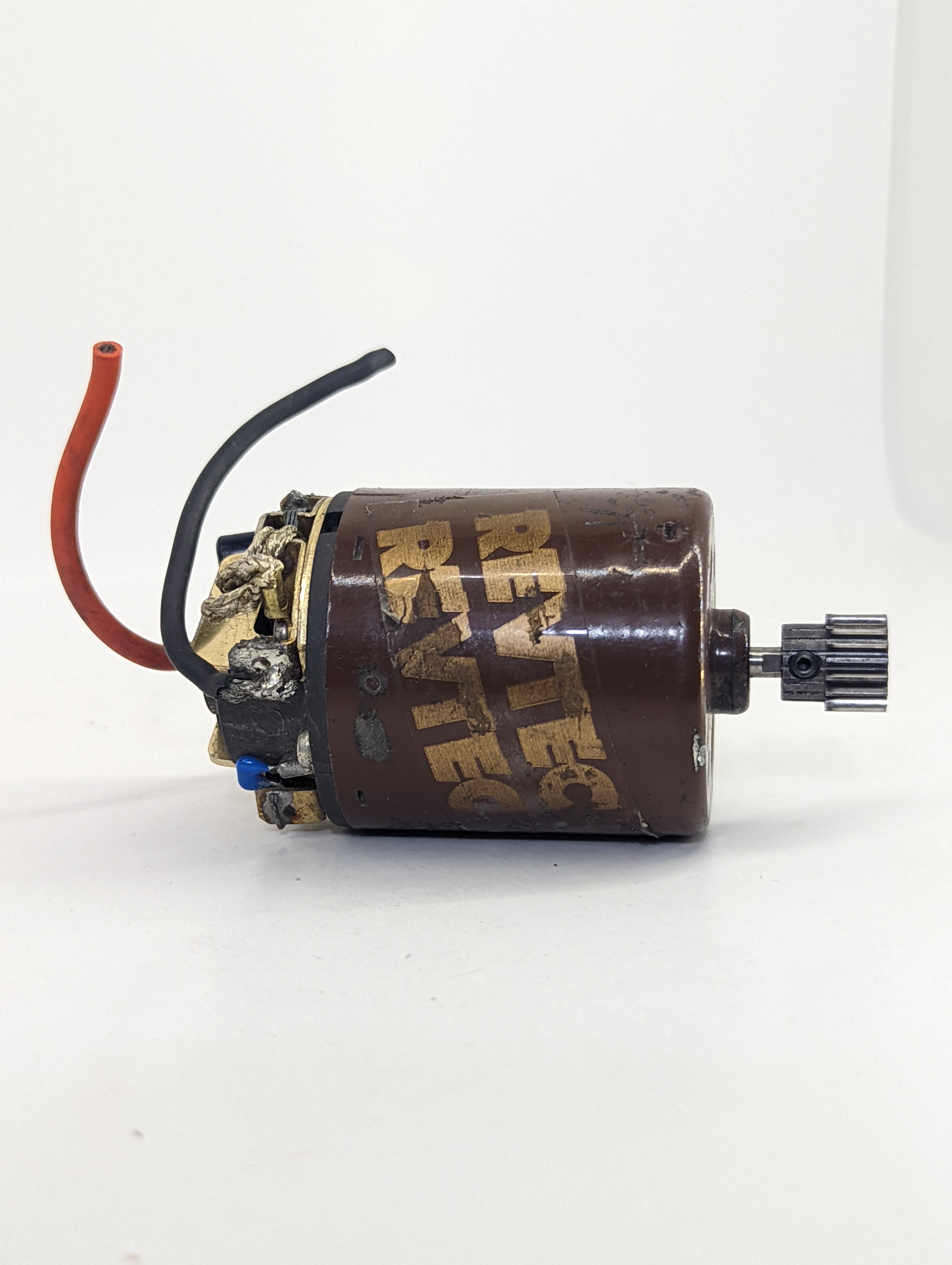

I just had a buddy give me a throw away box full of RC gear someone was dropping off at an electronics recycling drive.
In it among other stuff was a still clear yoko Super Dog fighter yz10 with a REVTECH motor... BROWN w/ gold on clear decal.
Any info? Or are they all just "modified"?
Thank you all in advance!

There is a motor guide thread on here for old motors.
Since it's a modified though, it's easy enough to pop the armature out and see what the windings look like and they probably marked it somehow to indicate the turns. A quick view at the comm tabs will tell if it's a single double etc. If you see single fat wire you know it's relatively low turns.

That's the kind of friends that I need.TeamROCKIT wrote: ↑Fri Jun 24, 2022 2:27 am I just had a buddy give me a throw away box full of RC gear someone was dropping off at an electronics recycling drive.
Mine give me yard tools. I'm like, "dude, its 110° outside". Then they responded with, "thats why I gave it to you ".

Pretty sure it's a 19turn triple wind. However, if you have a silver dot with the same can/color motor label, it's a 19 turn double. I've got both, but in all honesty....you never really know what you have until you open the can. It was sooo easy to switch armatures in cans on brushed motors back in the day. Nice motor....good score....I Love me some RevTech!
