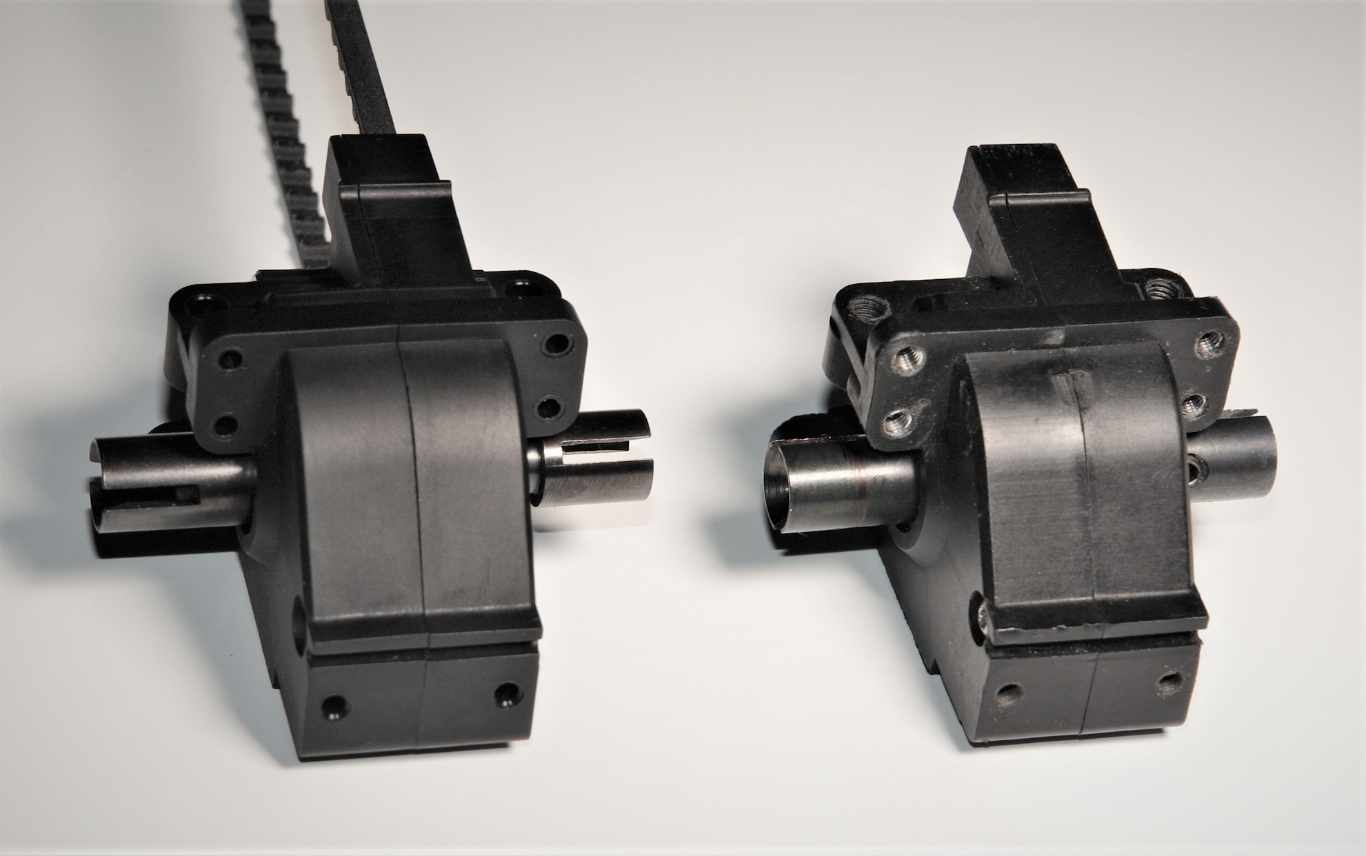

All assembled and no problems.
Took 1 less shim.
I could have used the original case with the threaded inserts. Nope
I could have paid a king's ransom for a new vintage case. Nope
Or have a brand new case with clean threads and a couple upgrades.....
And blue bearing seals 8)

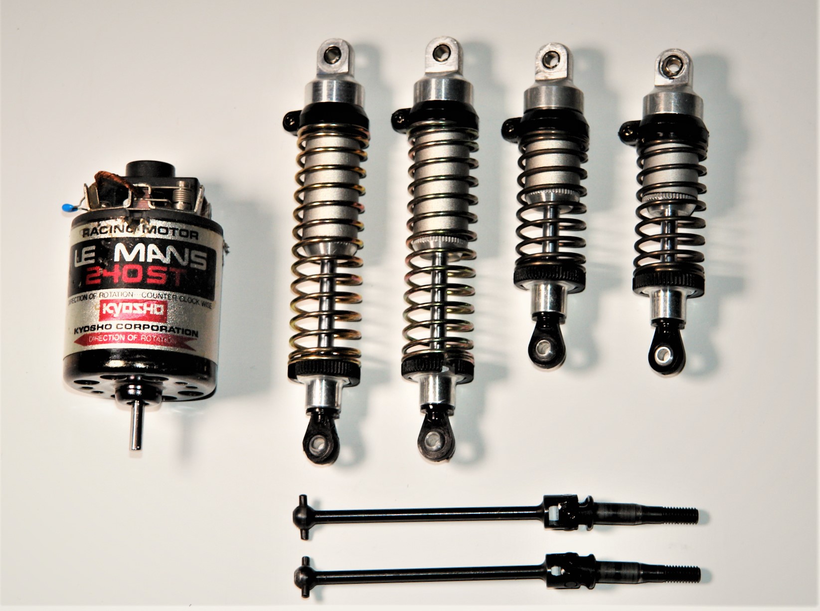

Found a few more parts.
240ST should be appropriate. No rust, no solder burns on the endbell.
Needs a new label on the motor and the terminals cleaned up.
Commutator cleaned up nicely and the motor seems to run well.
:lol: Hope this makes at least one person on the forum happy, maybe two :lol:
Really nice set of Platinum shocks.
I already cleaned the internals. New oil and green slime for the O-rings.
I pretty sure the original oil (smelled like hypoid lube) was still in them. It was very clean for their age.
The lower shock eyelets are correct and in very good condition.
Outside could still use a bit of polish but won't take much.
And a pair of W5061 Universal swing shafts. Very clean and very little wear.
The car had dog bones up front when I got it, but no longer.

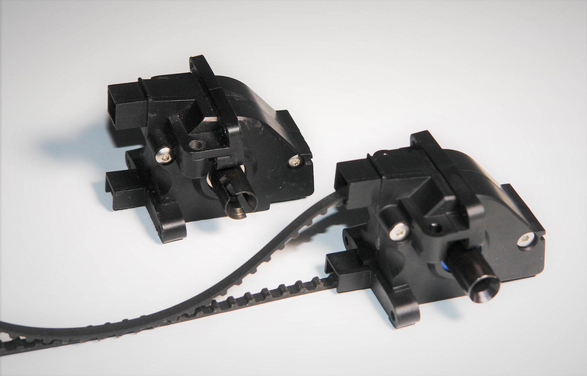

I think the re-re front trans case may be a solution for your broken case?
Chuck

Hey Chuck,
Not sure if your last comment was direct toward me but if it was, it's the rear trans cases I have with the broken wing mounting bosses.
I believe the re-re's rear cases have been changed to the point they won't accept vintage internals (gears and bearings are all different). Anyway, I have a workaround until I happen upon some unbroken parts.
... if it wasn't directed toward me, well then carry on. :lol:

Yep Doug
I thought you wanted a front case for some reason :?
What I can confirm is that the re-re rear case will probably not work with vintage internals. Gear spacing is one, idler mounting is an other.

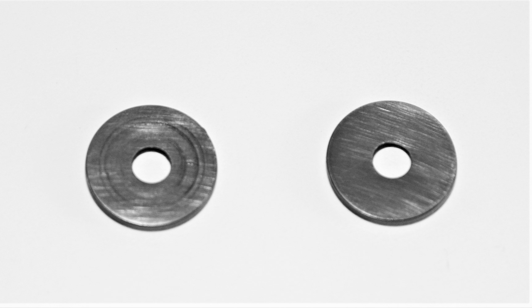

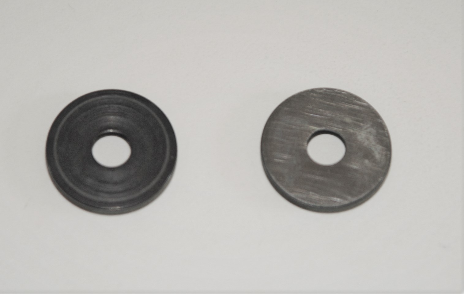

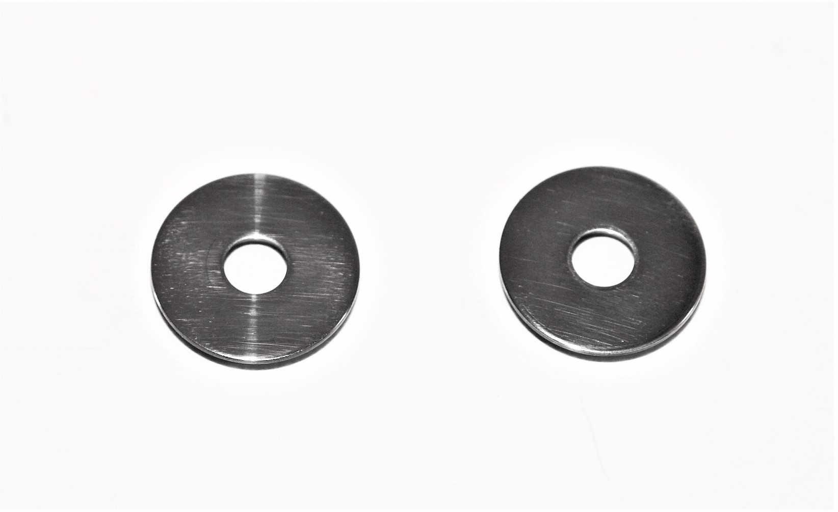

I took a couple pics of refinishing the older one piece pressure plates found in the ball diffs of vintage Kyosho diffs.
Wet sanded on a flat surface with 400 to remove grooves
Wet sanded with 1000 to help remove sanding marks

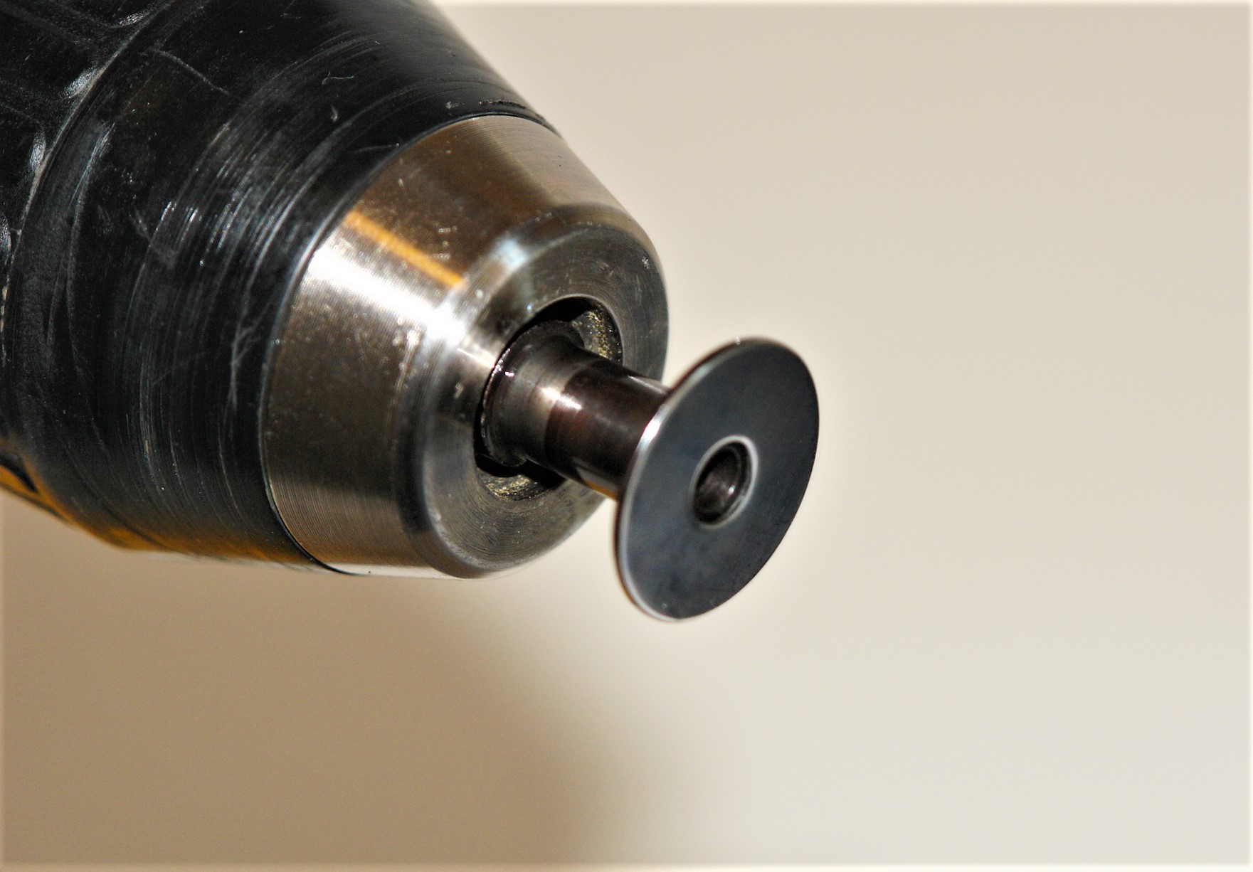

Placed in drill and polished on an 8" polishing wheel with coarse and medium grit polish.
Both the drill and the wheel spinning.
Assembled the diff with new diff balls and it is very smooth.
Way better than the new original one piece pressure plates.
Chuck

Those pressure plates are actually from the Turbo Ultima. I had forgotten to take pics of the Optima's front internals before assembly.
The Optima's front was done the same way.
I did catch one of the plates with the buffing wheel and it went flying... 3 hours later I found it.
