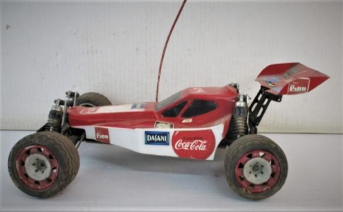

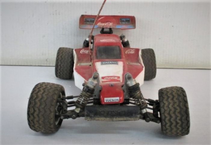

Resurrecting what may be the worst, drug through the mud, rode hard put up wet, beaten, thrashed, trashed, bent and broken mid ever sold on the internet.
Caked with what looks to be sugared clay baked into every nook and cranny that an rc car has.
Broken parts were probably replaced but it looks as though it probably never had any maintenance, ever!
Except for stupid amounts of grease to help weld the clay/sugar to every "moveable" part of the car.
Nearly every hinge pin and tie rod end is a friction fit.
The transmission needs lots of help to put it mildly.
Going to try and not spend stupid money rebuilding.
Chuck

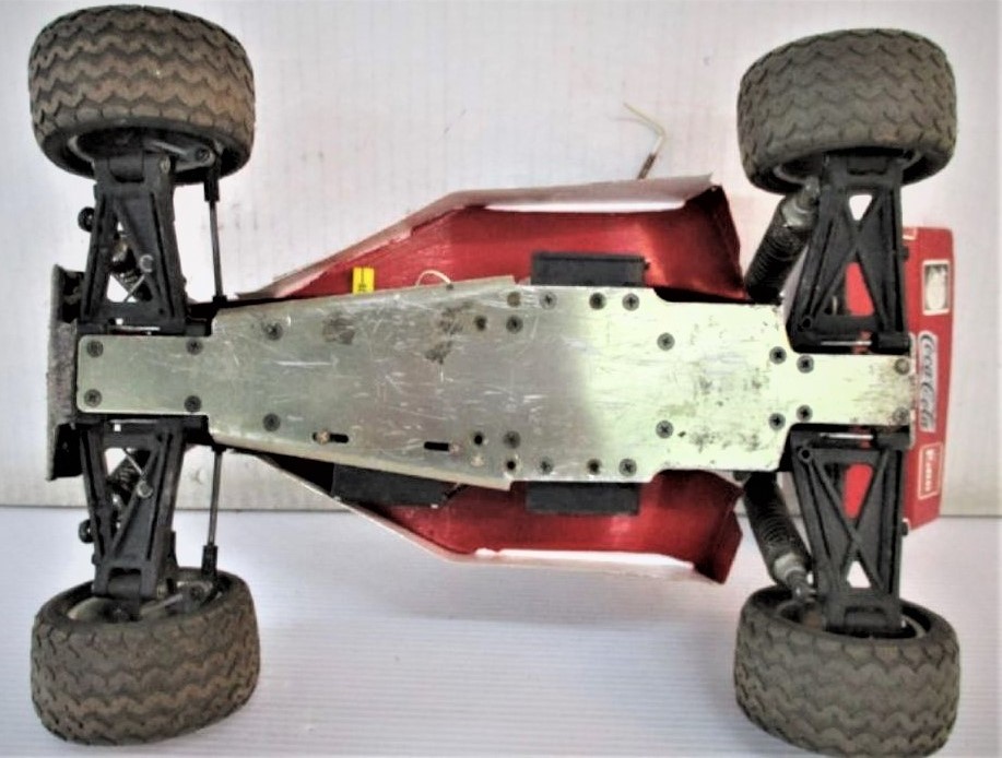

Your chassis plate looks to be an SE as the screw holes are countersunk. I believe the Platinum shocks were also an SE option (not an upgrade though, IMO...the Gold shocks were the best). Condition? I've seen FAR worse than that. Looking forward to the resto.

Wow, a challenge to rebuild perhaps, but what a great car it will be when it's finished.
If the belt covers haven't been sealed well, the transmission could hold some very ugly surprises so be prepared.
Is this your first Kyosho buggy Chuck? If so then welcome to the club. They make great cars.
Very much looking forward to this. Based upon the quality of your past builds, I predict that one's going to be epic.

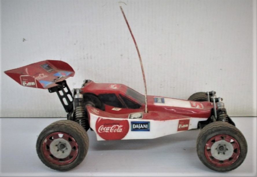

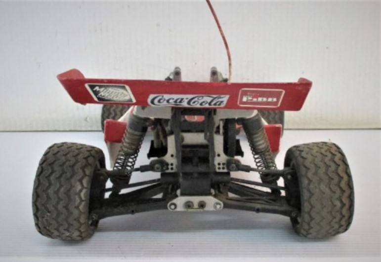

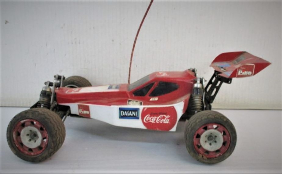

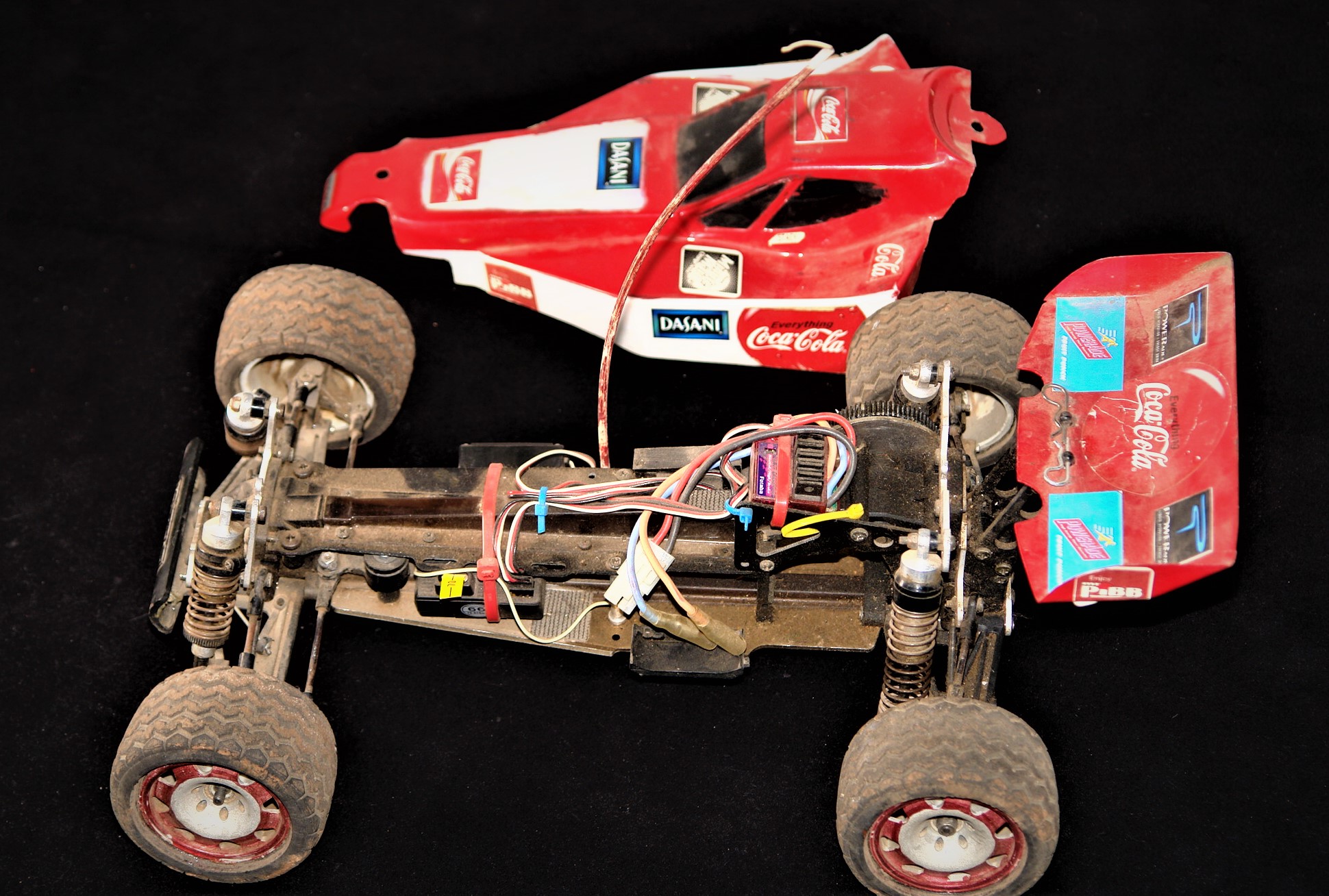

A better pic with body off.
Chuck

Actually, that doesn't look too bad.
I got a derelict Ultima once that was held together with giant sheet metal screws - and they weren't even philips head. What a mess!
I'm betting that the only replacement parts you might need are gears.

Coelacanth wrote: ↑Fri Mar 05, 2021 1:58 pm Your chassis plate looks to be an SE as the screw holes are countersunk. I believe the Platinum shocks were also an SE option (not an upgrade though, IMO...the Gold shocks were the best). Condition? I've seen FAR worse than that. Looking forward to the resto.
Chassis, shocks and chrome wheels say SE but aluminum towers and gear diffs seem to say mid. I really am not sure of all the parts origins.
I ran Platinums for a few years back in 80s-90s on my Houge RC10. Honestly never could get them dialed. Always questioned their having more damping on the down stroke.
I have since sold them, but now kind of wish I hadn't because they were in nearly pristine condition.
Hoping to get feedback and possible ideas/direction from some of the others that have way more knowledge of these cars than I do.
Chuck

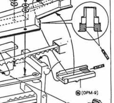

FWIW, I've owned 3 or 4 Mids and all of them were missing part OPM-9. You can see it here on page 13 of the manual.
I've never actually seen one but I think it's rubber. It's meant to seal the underside of the belt cover where the belt exits the rear gearbox - directly above the motor. This part never comes up on ebay so I think it's rare.
I've made a rather poor substitute by forming a piece of lexan but it really doesn't work very well.
I'd reckon this part would be a perfect candidate for 3d printing if anyone has access to one they could replicate.

I've never even noticed that in the manual. You're right that it never comes up in auctions, it's gotta be a hens teeth sort of part. And you know, when I went to university in Urbana-Champaign, I spent a lot of time at an LHS that got all the scratch and dent pallet loads from Tower Hobbies. Those got sorted into huge Rubbermaid tubs of parts, almost half of them Kyosho, and I have never seen that part, ever.XLR8 wrote: ↑Fri Mar 05, 2021 7:00 pm FWIW, I've owned 3 or 4 Mids and all of them were missing part OPM-9. You can see it here on page 13 of the manual.
