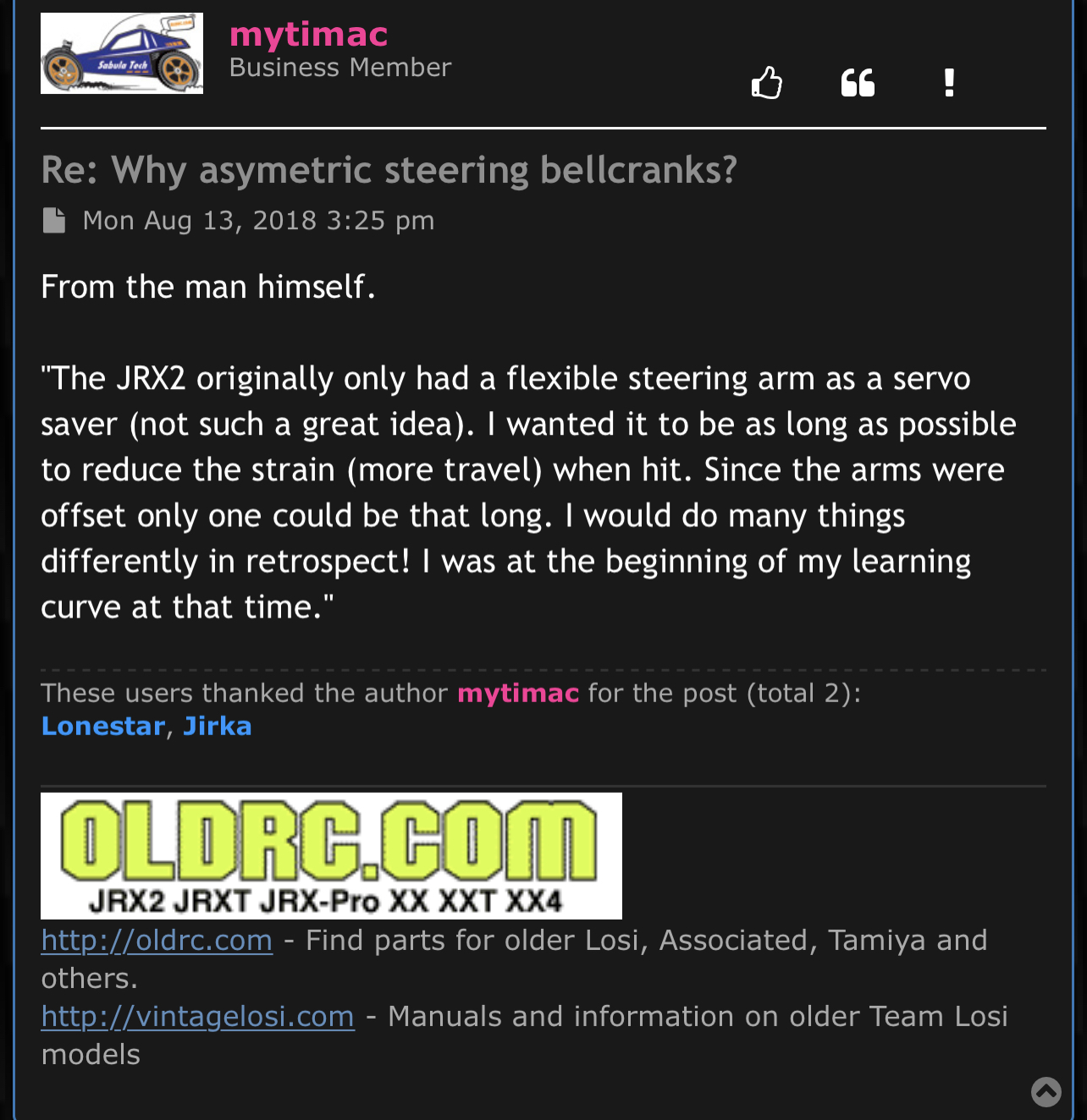

Can anyone explain why Losi have one bell crank slightly longer than the other?, initially i thought it was some weird Ackerman adjustment or compensation.
Now I'm thinking when they changed from the skinny "servo saver" arm to a parallel one they didn't want to retool for the alloy connection piece?
There's loads of nicer alloy set ups for the RC10 etc that would suit, and much easier to source than the Losi originals?
Anyone spread any light on this for me?
Cheers
Craig

Probably has something to do with the lefthand bellcrank being offset to the right slightly so the steering arm didn't rub on the body.

Re: Losi jrx2 Rigid Ball Bearing Steering
cas22
Posts: 292
Joined: Tue Jan 31, 2017 6:03 am
Location: New Zealand
Has thanked: 130 times
Been thanked: 249 times
Post by cas22 »
Thank you Jeff,
That clears that up, you have an encyclopedic memory for this stuff and where to find it.
Cheers
Craig
