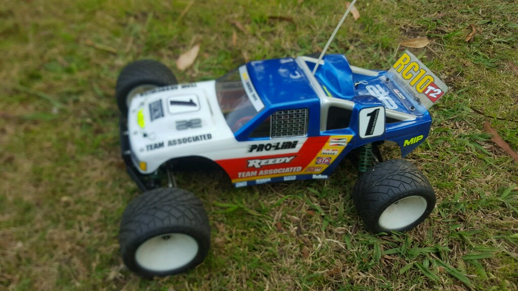

Took it out for its first run today and it ran pretty flawless. A grassy park wasn’t my first choice but it worked fine, except for when twigs would occasionally get stuck in a rim and sound like the old playing card in the spoke trick.
On the open road I realized it was a bit undergeared as I used the set up that I use for insane boost/turbo timing. I'll likely increase the pinion by 2 teeth and load the "stock" firmware instead of "mod" for more timing flexibility. The good thing with the program card is you can save 3 different profiles which you can easily switch between on the spot.
Crappy picture from the park..... semi slicks and grass don't go too well together, but made for some fun drifting action
Oh, and the battery seemed to last forever, it was only a 5000mah LiPo sport pack but it never seemed to end....

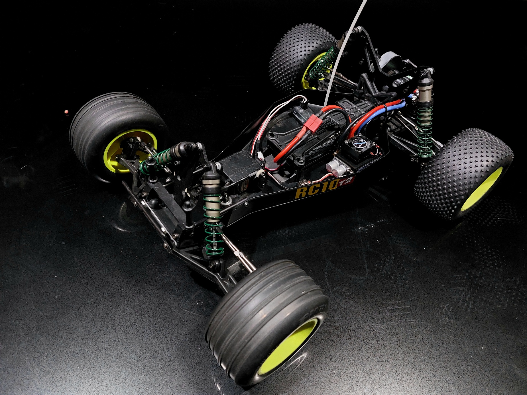

My T2 is getting some upgrades!!

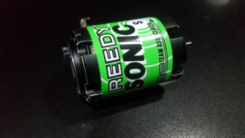

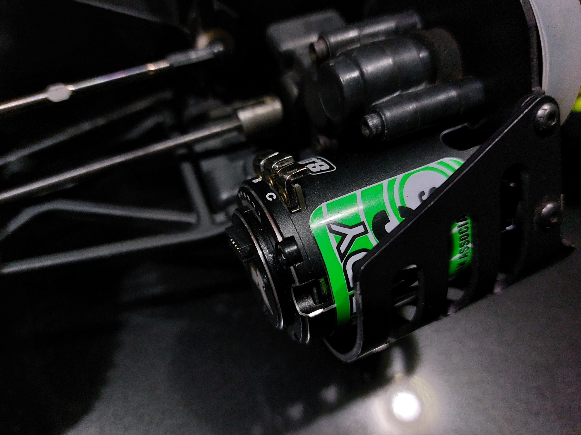

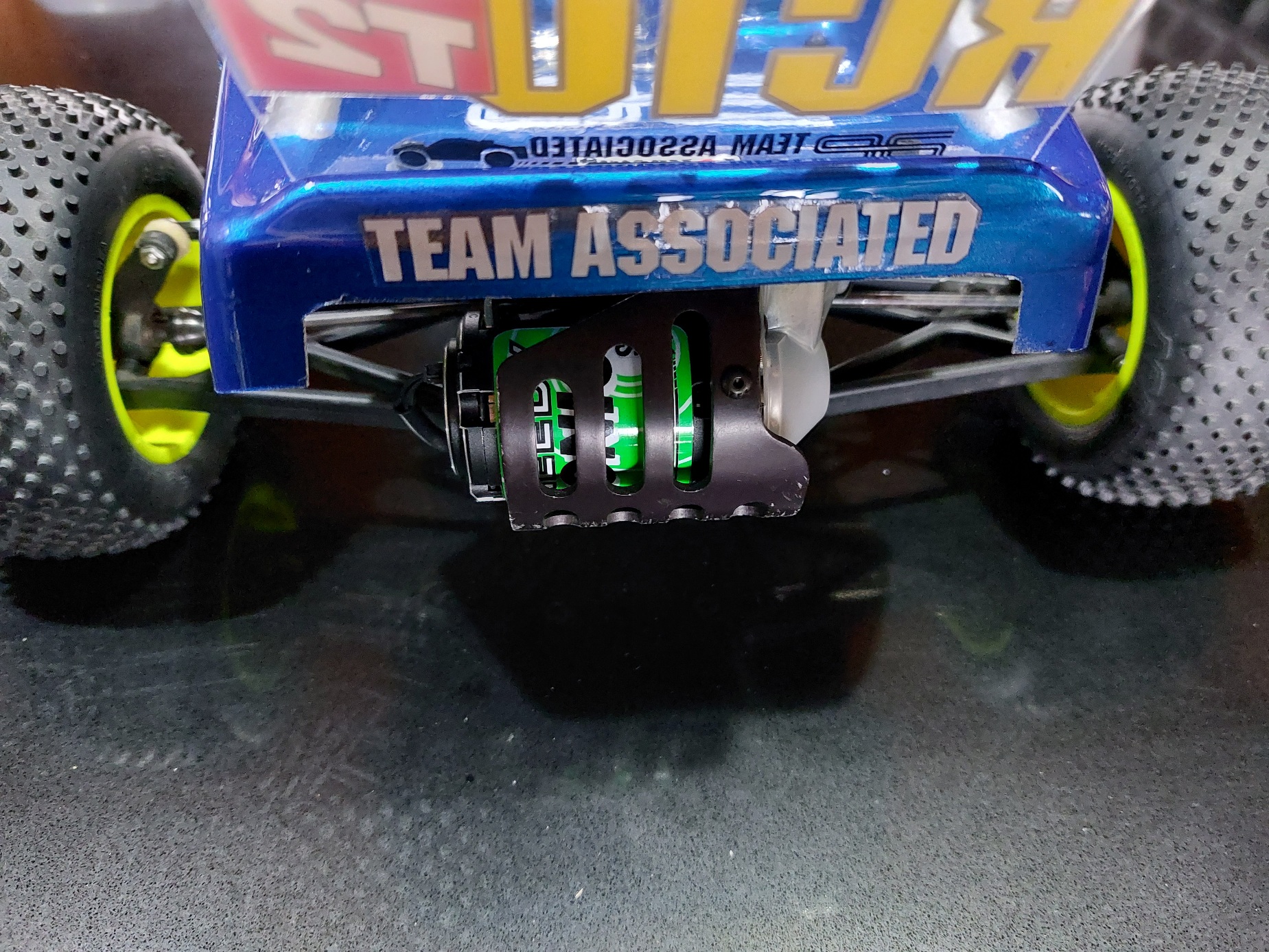

The blue motor and ESC were doing my head in so I decided to change it to look more period correct. This motor looks much more respectable and fitting. It is an 8.0T similar to the Hobbywing that I had in it before, hopefully it runs just as good.
I also found an old black Hobbywing V2.1 to replace the blue one. Now I just need to copy and install the software/settings from the old ESC into this ESC.

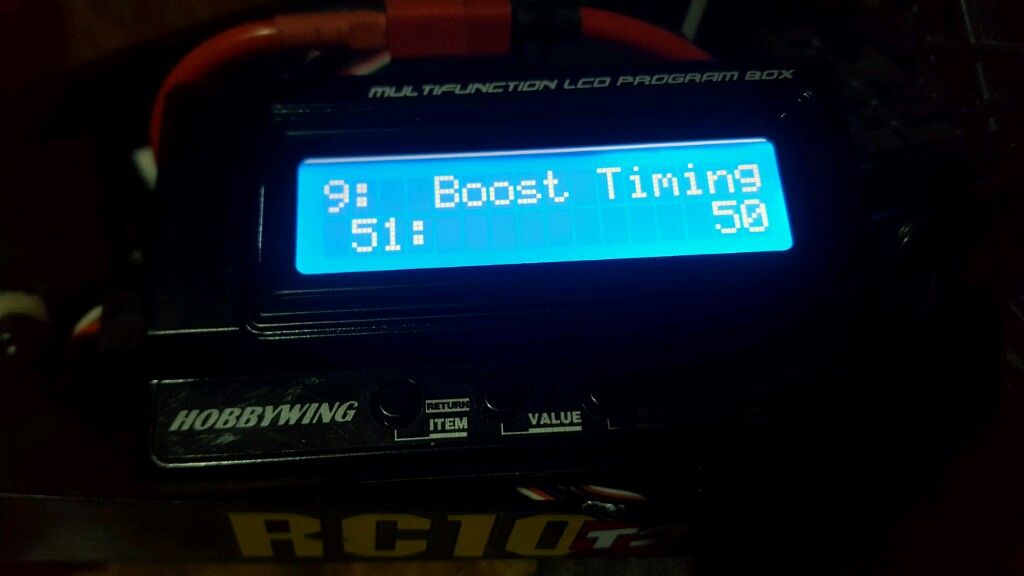

I just checked the settings and Turbo was 40*. You couldn't run that much timing on a track, it's just too much to use. In my gravel driveway it actually didn't get too hot since you weren't using full throttle or pushing the motor too hard for very long, but when you started squeezing the trigger a bit harder things get pretty lively.TeamMoo91 wrote: ↑Fri Sep 17, 2021 5:16 pmRC10th wrote: ↑Fri Sep 17, 2021 12:57 pmIt was a handfulThat kind of power sorta defeats the purpose of a vintage car and could easily spell disaster, but regardless still ran flawlessly, didn't overheat, and I didn't crash it. I'll have to check how much Turbo timing was on top of that as well, lol. Not sure if it's still the same now but from memory the Hobbywing maxes out at 64* total timing.

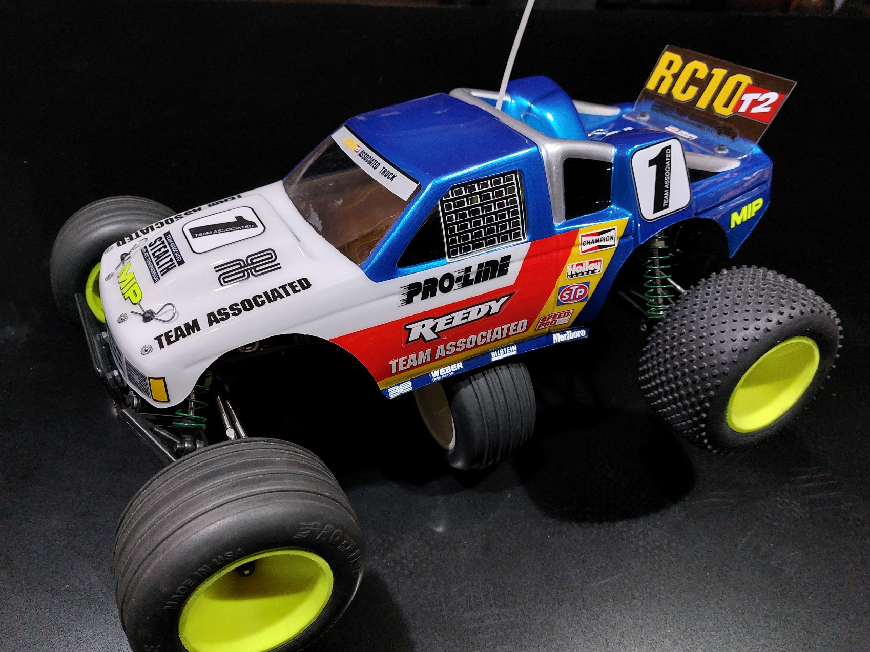

I tried to keep it as "authentic" as I could so it's pretty much bone stock with the exception of Lunsford turnbuckles. I did however cut the cross bar out of the battery holder so the lipo sits flat on the chassis pad. Unfortunately square lipos don't fit so I had to buy a couple quality round packs. You could make square lipos fit with a 3D printed battery strap and by relocating the antenna mount.
Yes, the motor is an 8.0T, these motors seem to be getting harder to find now in the 6.5T - 8.5T range. I basically chose the Sonic M3 because it's easy to slap a sticker on it and look the part, which is surprisingly hard to find motors suitable.

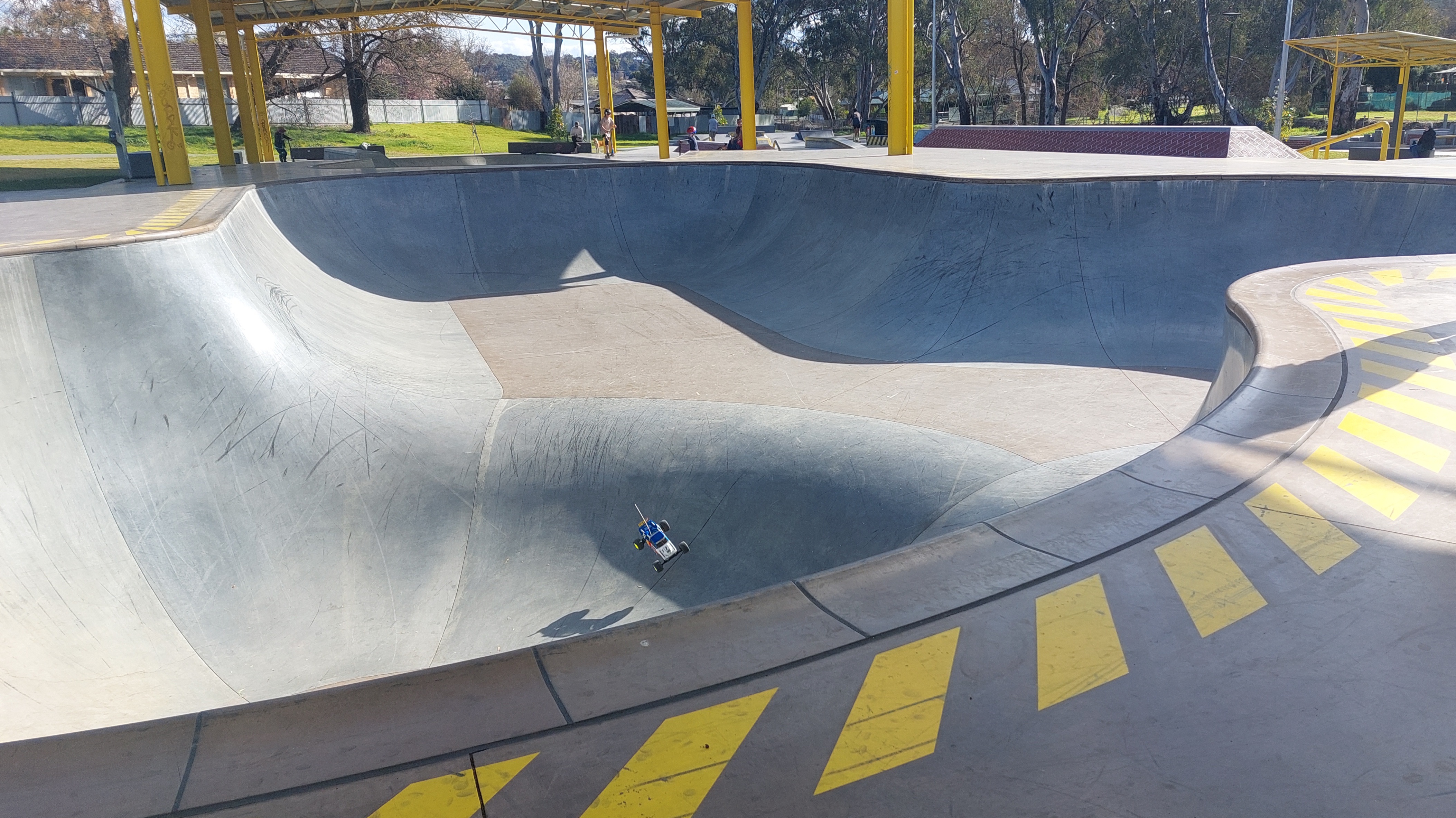

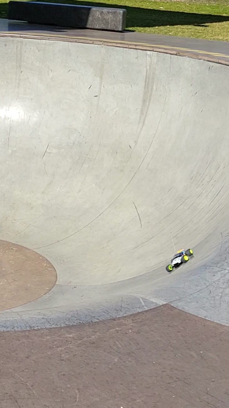

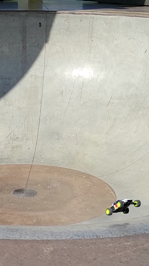

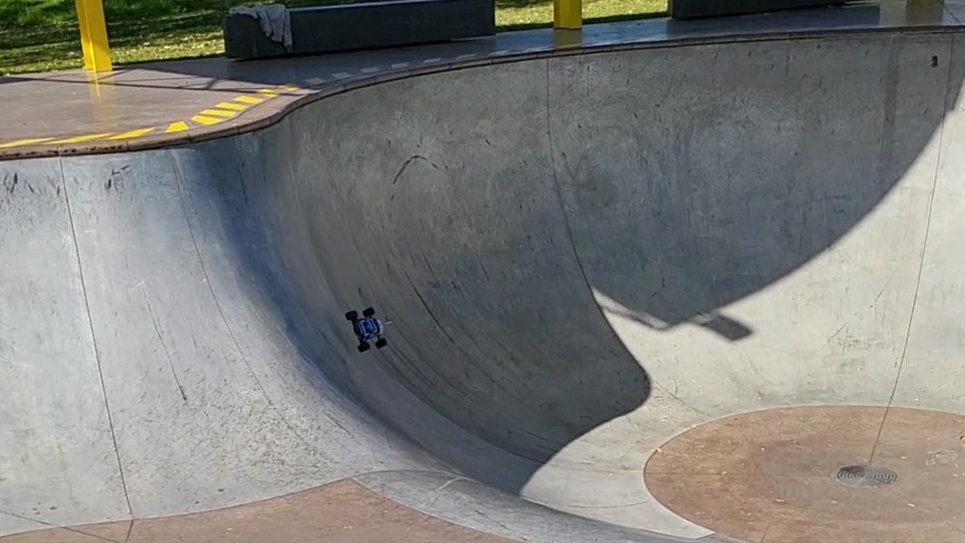

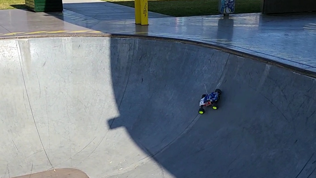

The T2 got a bit of a workout today and man was it fun, the size of the park was unreal. Traction was very low on the polished concrete and the truck was sliding around a lot, but everything flowed excellently. Please excuse the crappy "video capture" pictures as I couldn't drive and take pictures at the same time. You could get quite a bit of speed up, especially in the bowl or hooking off the banks. Battery life was amazing..... Unfortunately the park was filling up with kids so I couldn't really use other areas of the park, hopefully I'll go there again earlier tomorrow and be able to use more of the park.
