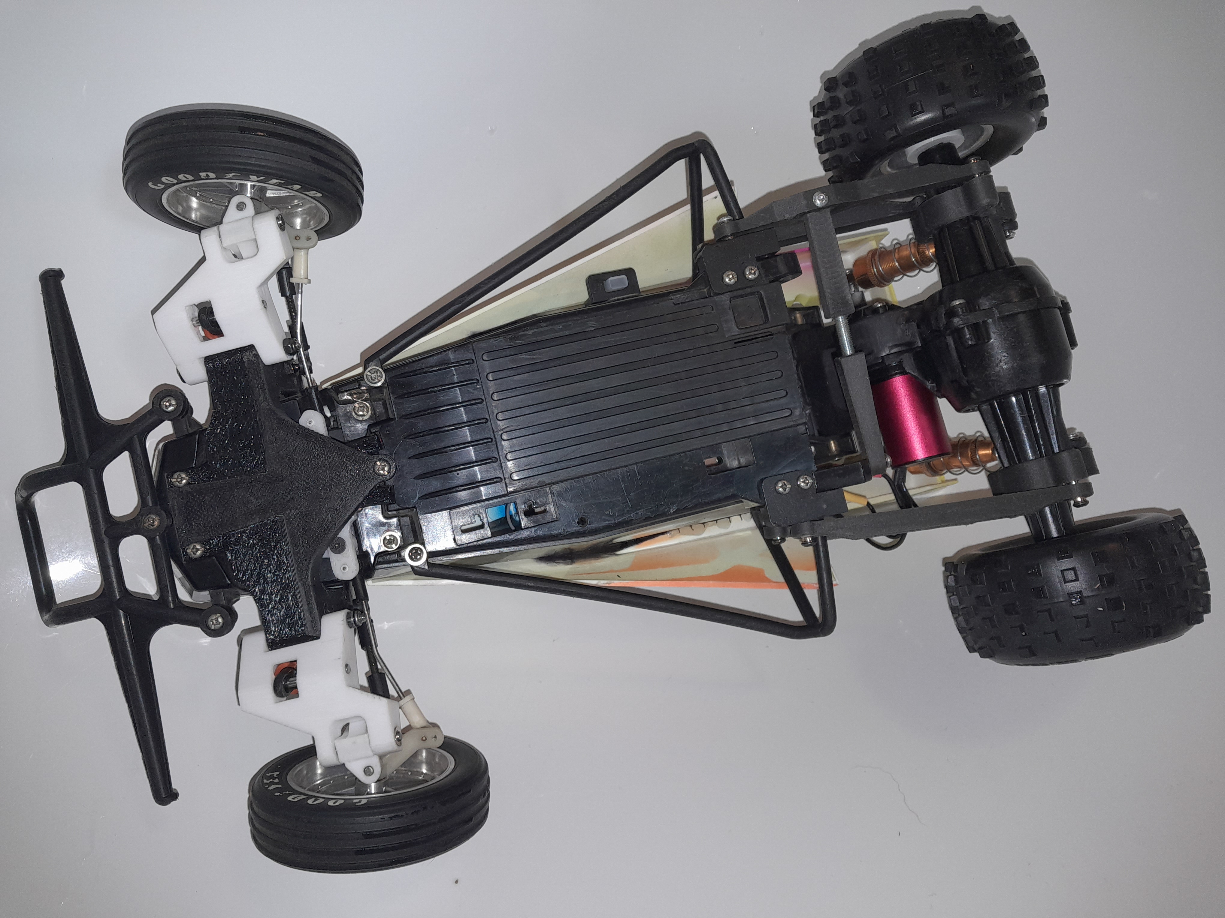

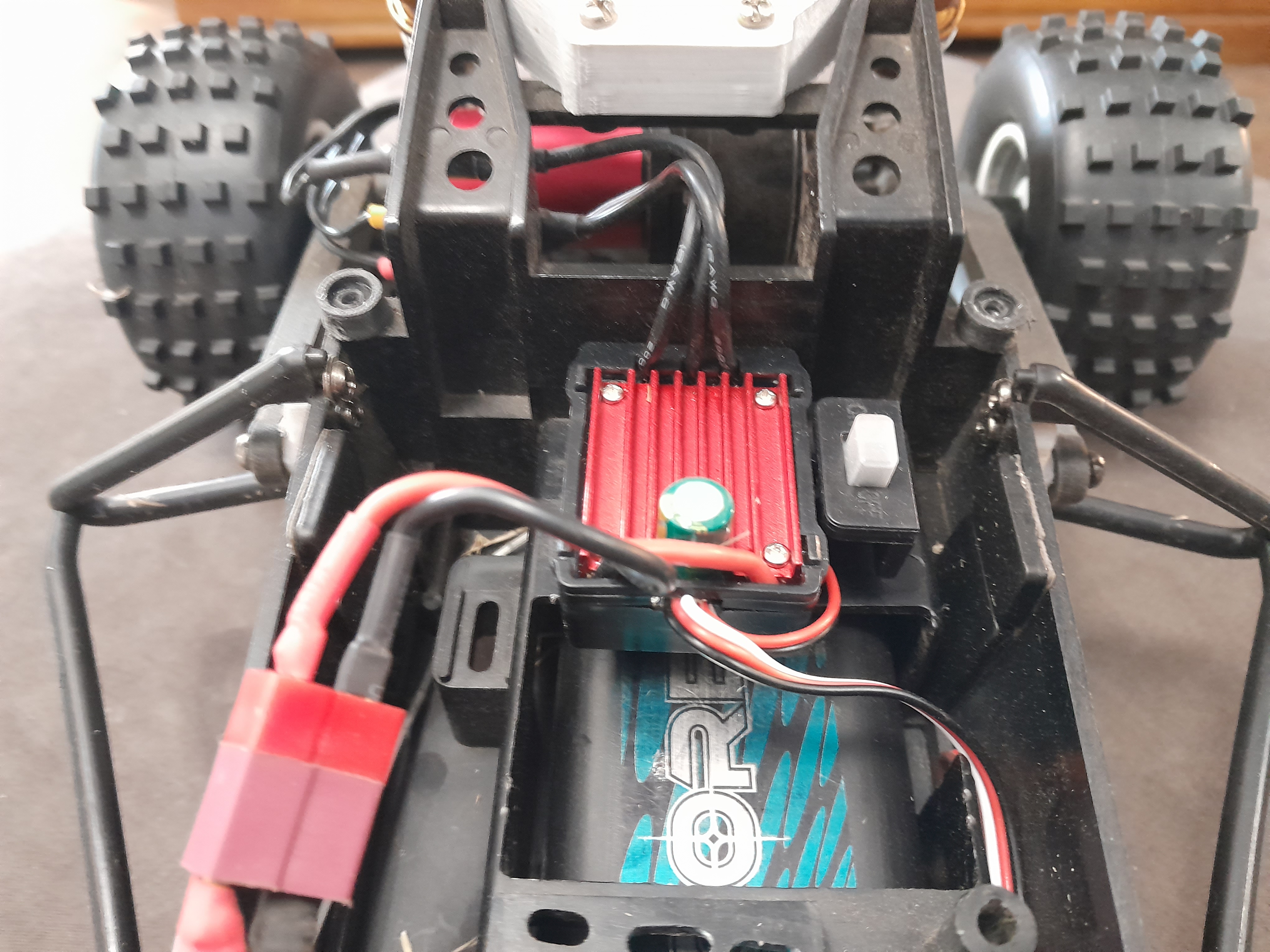

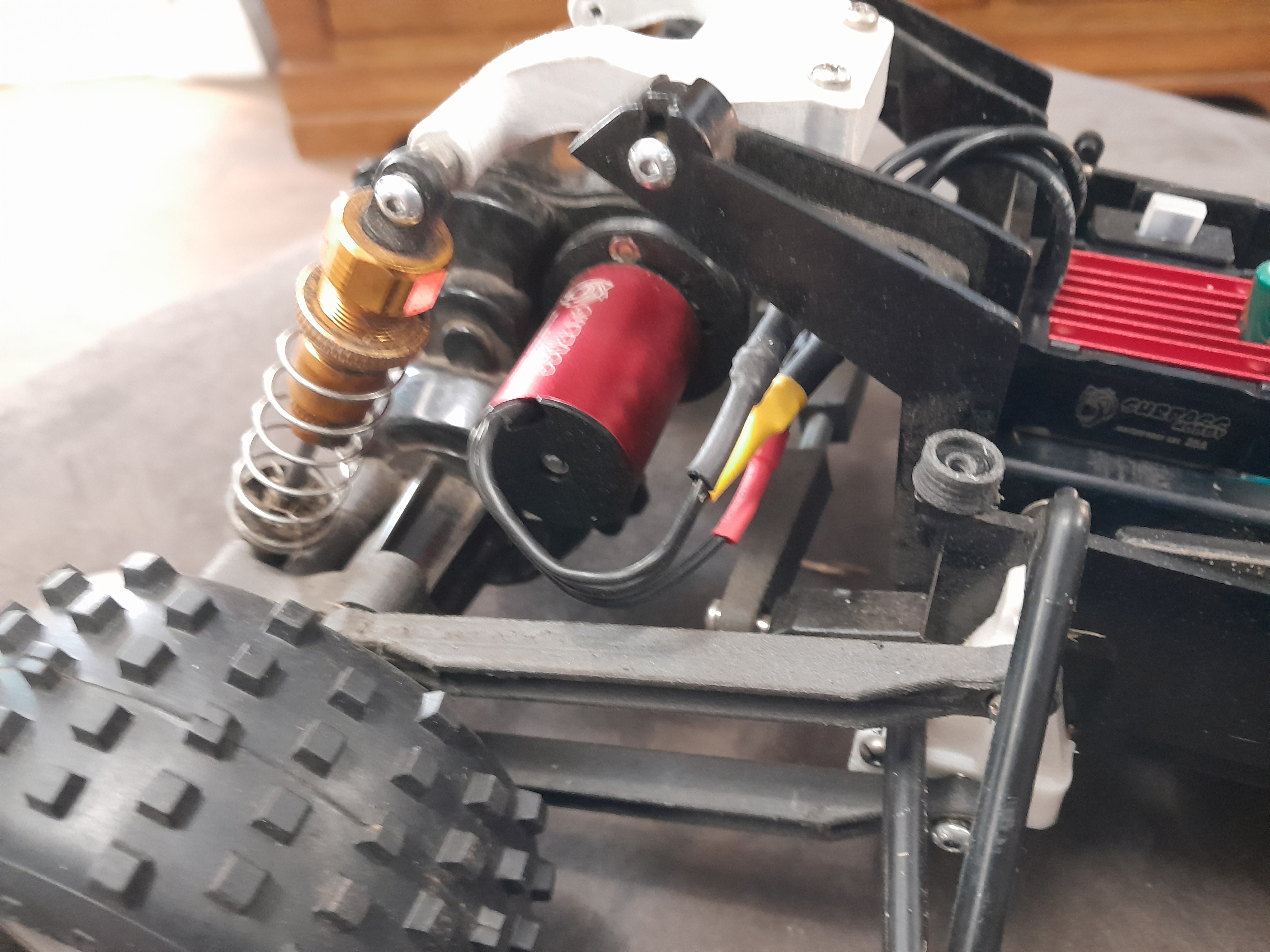

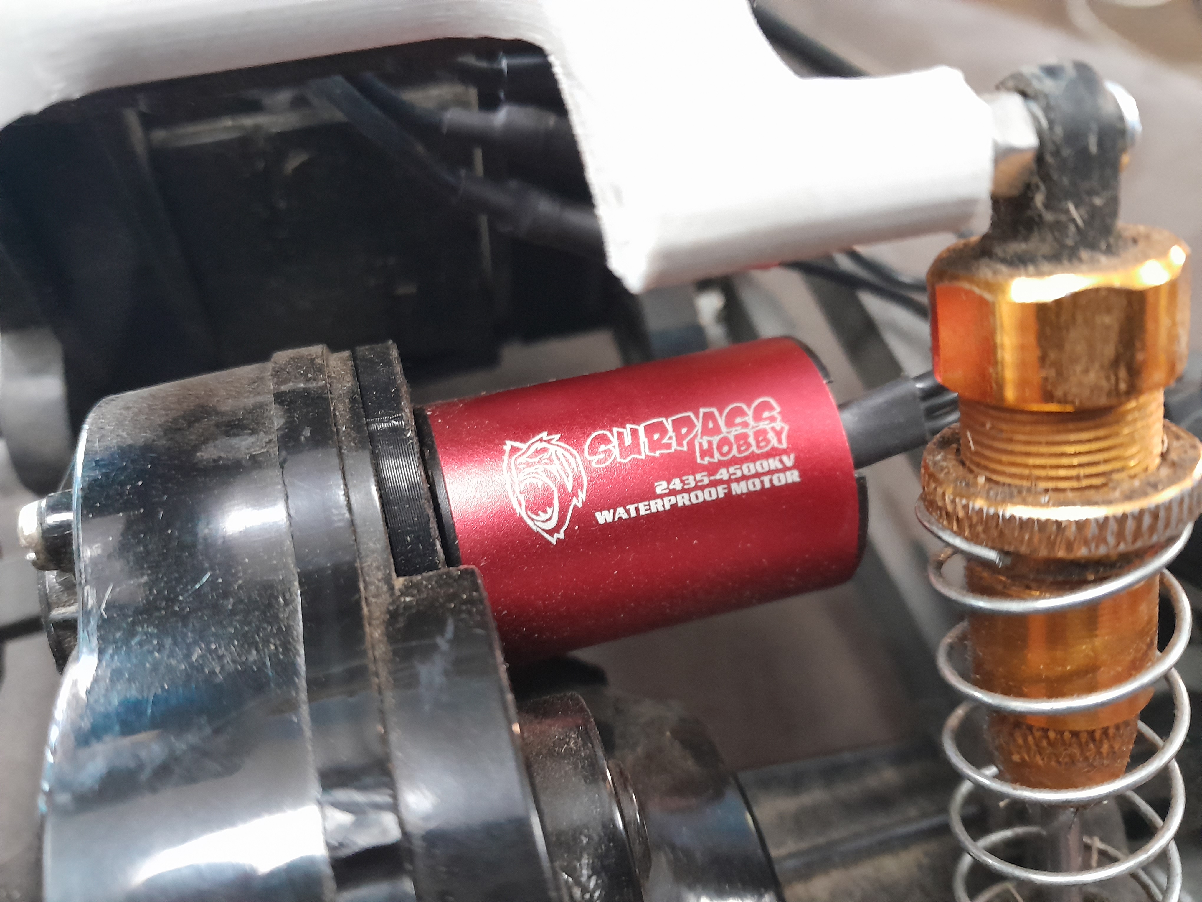

This little Brushless combo arrived yesterday , was a little p!ss@d off at first as it was advertised on Bangood as having a 3.175 standard motor shaft but its 2mm so I to turn up a sleeve on the lath then I couldn't even use the stock pinion as thats 2.2mm so I had to rummage through my 0.8mod pinions and the lowest tooth one I had was a 15, so it was time to print off a new motor mount thats adjustable for pinion size , finally got it installed and the steering servo died , just kicked its little feet in the air and shuddered , at that point it was late so I gave up :(
Anyway fitted another servo this morning and gave I a spin , little overgeared as it cogged a little and warmed up a little too much for my liking but much much faster , I've got a 10t pinion coming but I'm thinking the sweet spot is more like 12 or 13t , I'll get some video in a bit .
Can't say I'd recommend this combo unless you can make the adapter sleeve for the shaft , 0.8mod pinions with 2mm bore are virtually non existent as I found out yesterday when I looked :( , anyway this will work for me with a lower tooth pinion .

The little motor weighs maybe a little less than the 380 I think , when I swap out the pinion in a few days for the 10t I have coming I'll get a proper weight . I'm still a little peeved about the shaft size as it's not going to be something that most people can use , I'm just lucky enough to have a lath , I do know that there was a 2.2 to 3.175 sleeve that came in the original Tamiya Sand Rover kit so there may be a size of tube that could work , probable an imperial size but it's still 0.2mm too big , could work if you put a wrap of baking foil round it :?:

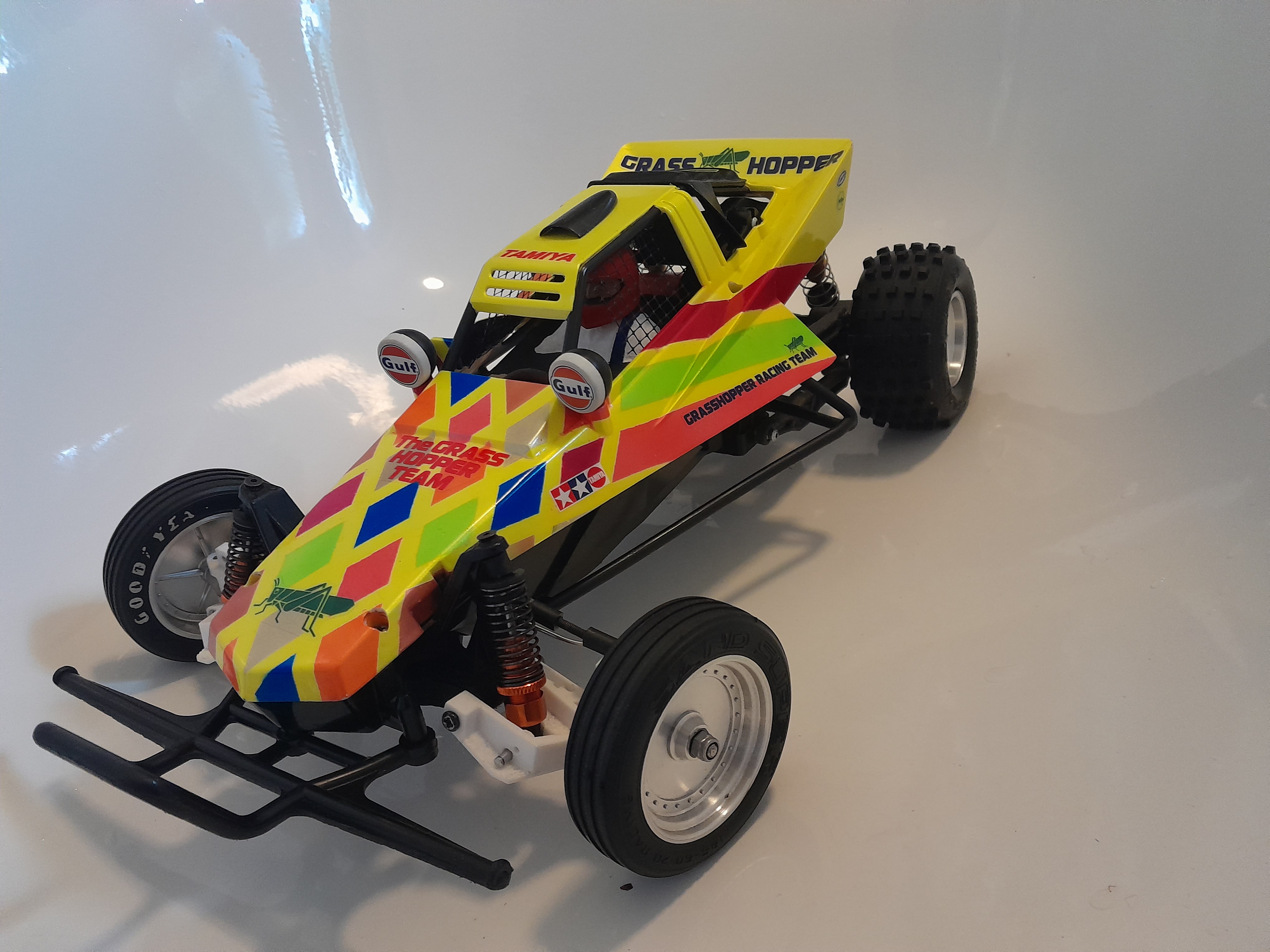

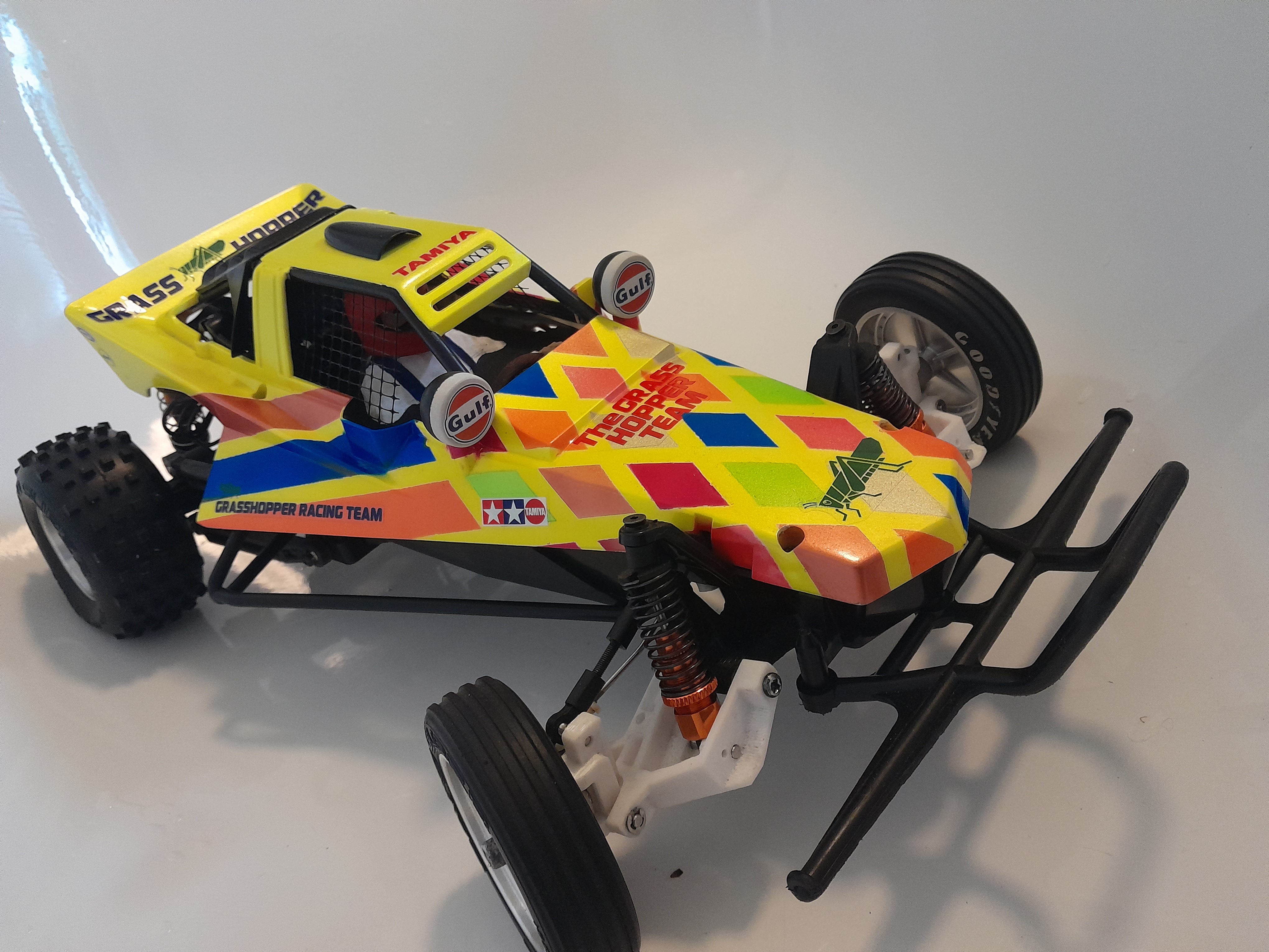

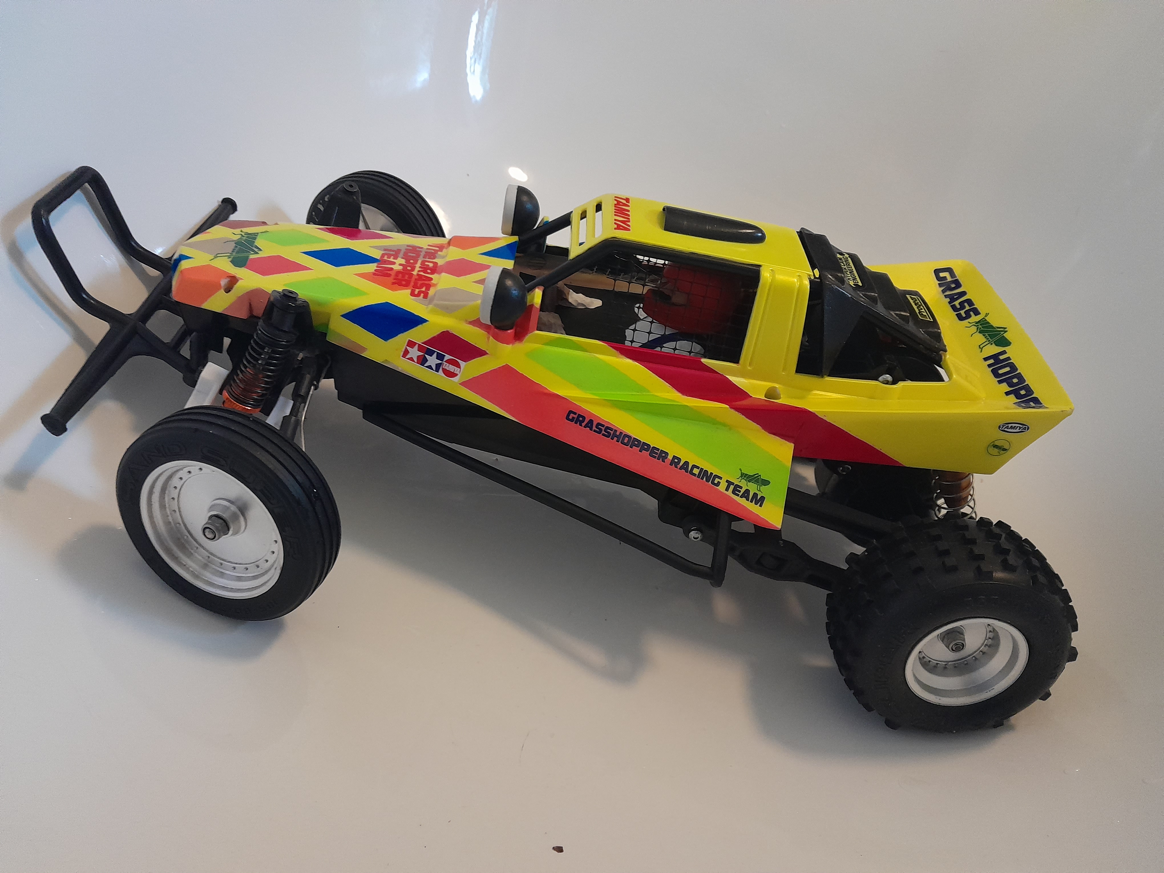

It didn't look right with white wheels up front and chrome at the rear so I've taken the axles out of the Tamiya front hubs and turned them down to fit the Kyosho front bearings , I think it makes it look a bit tidier .

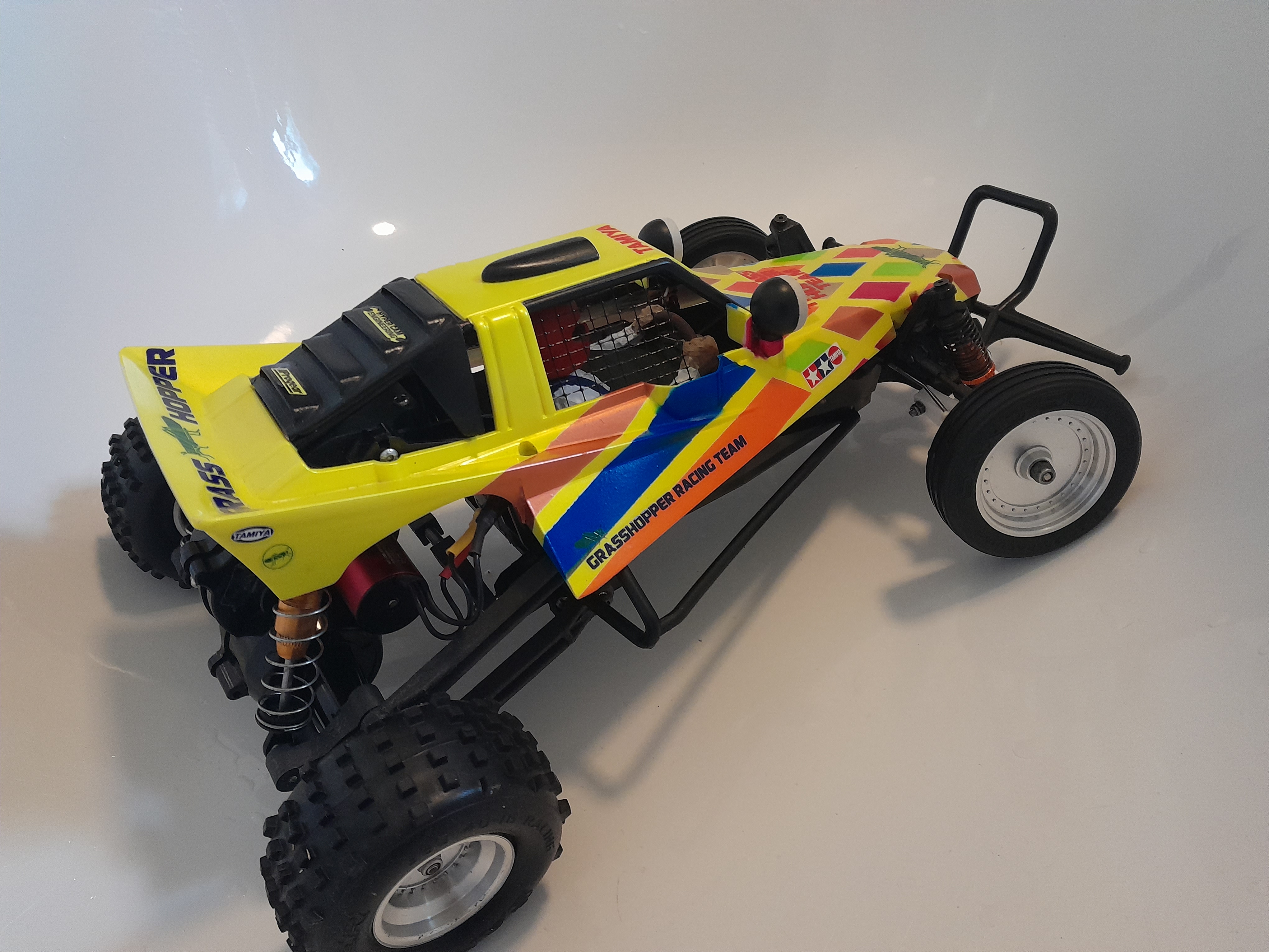

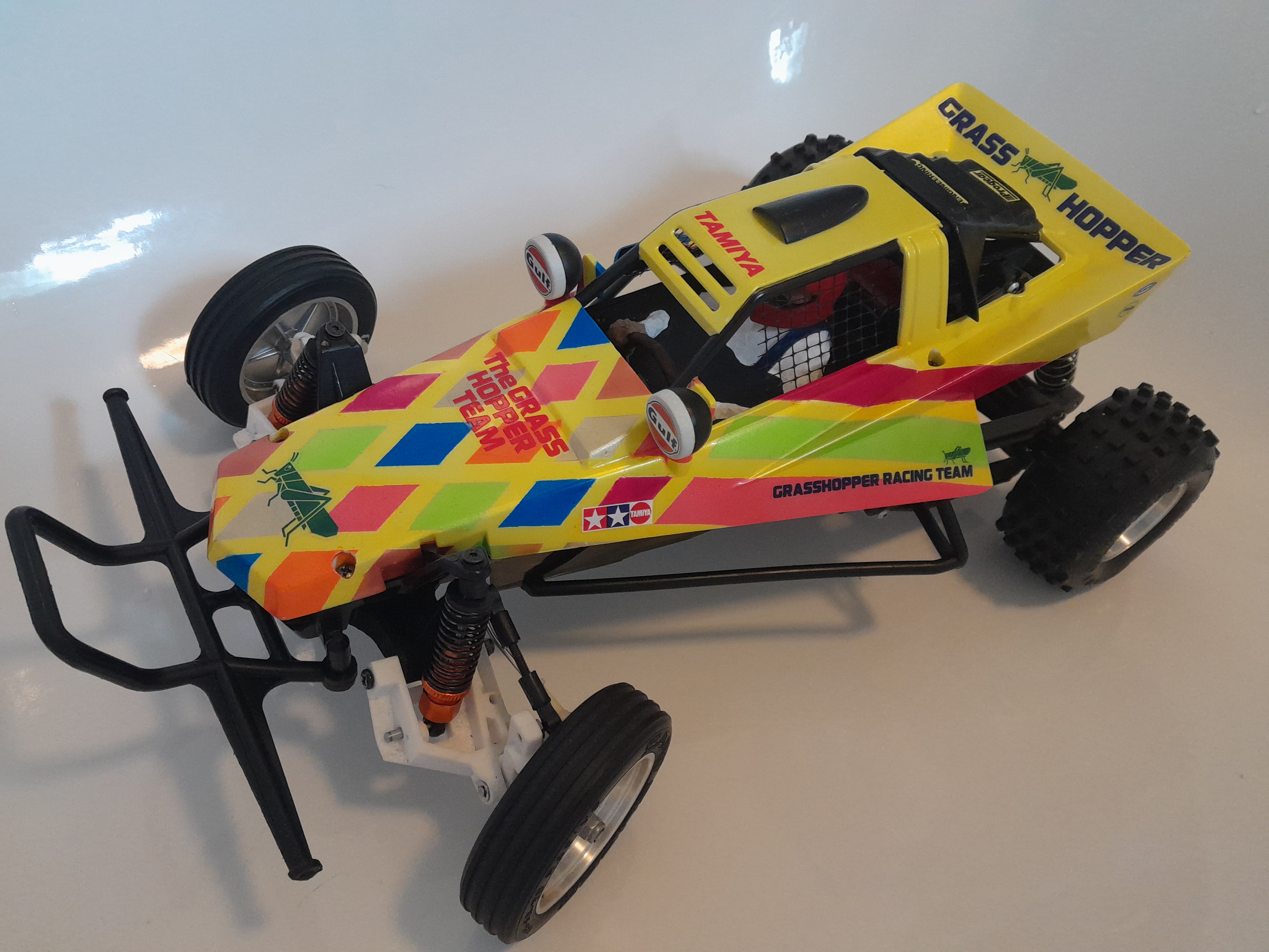

While painting I was really nervous that it might not come out well or just look rubbish , I still was unsure after peeling the last of the masking tape and only really decided I like it once the decals were on , so many layers of paint it's untrue , Candy's,metallics , plain and pearl with a final coating of clear lacquer , all the while praying that nothing would pickle :?

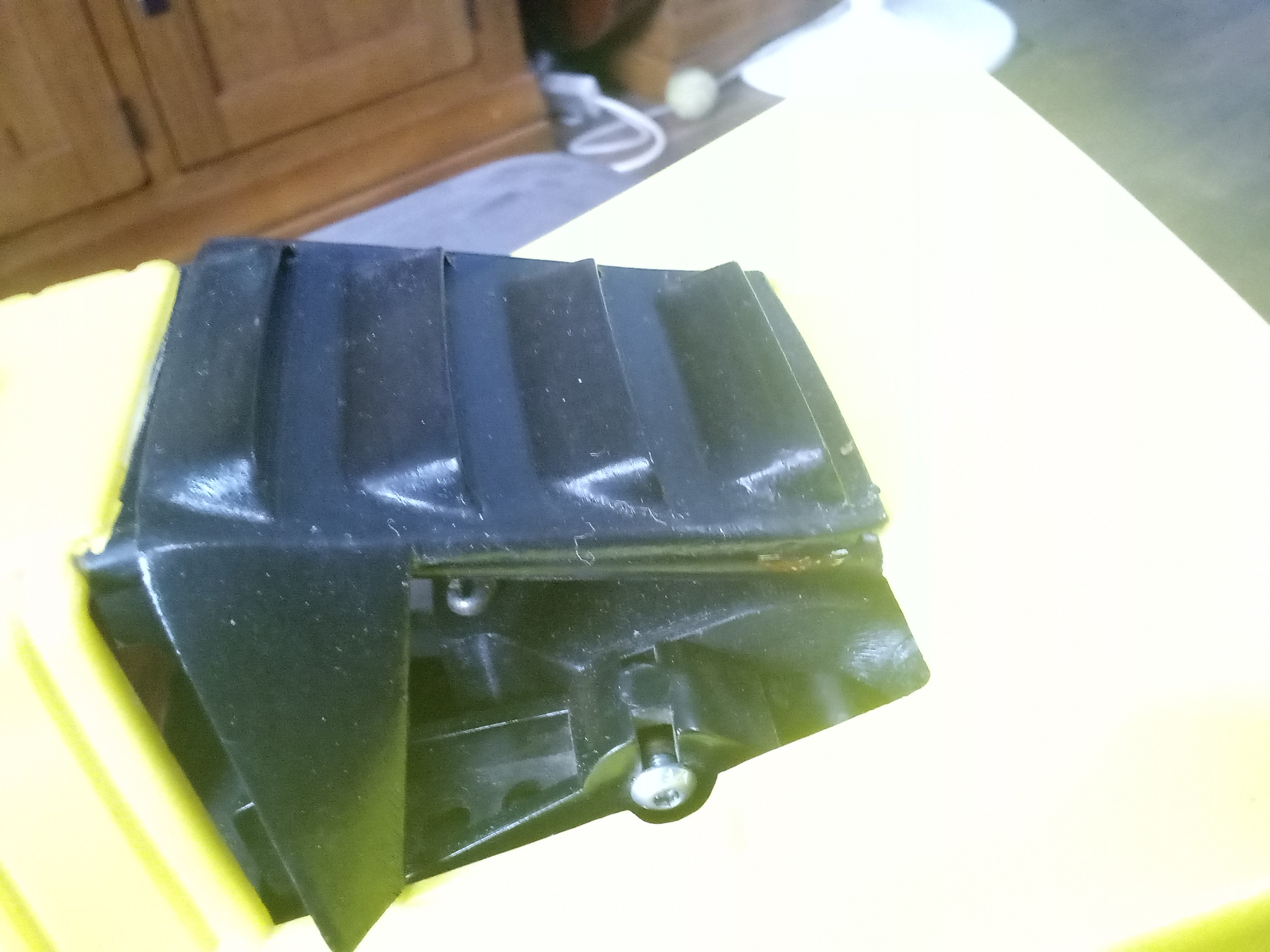

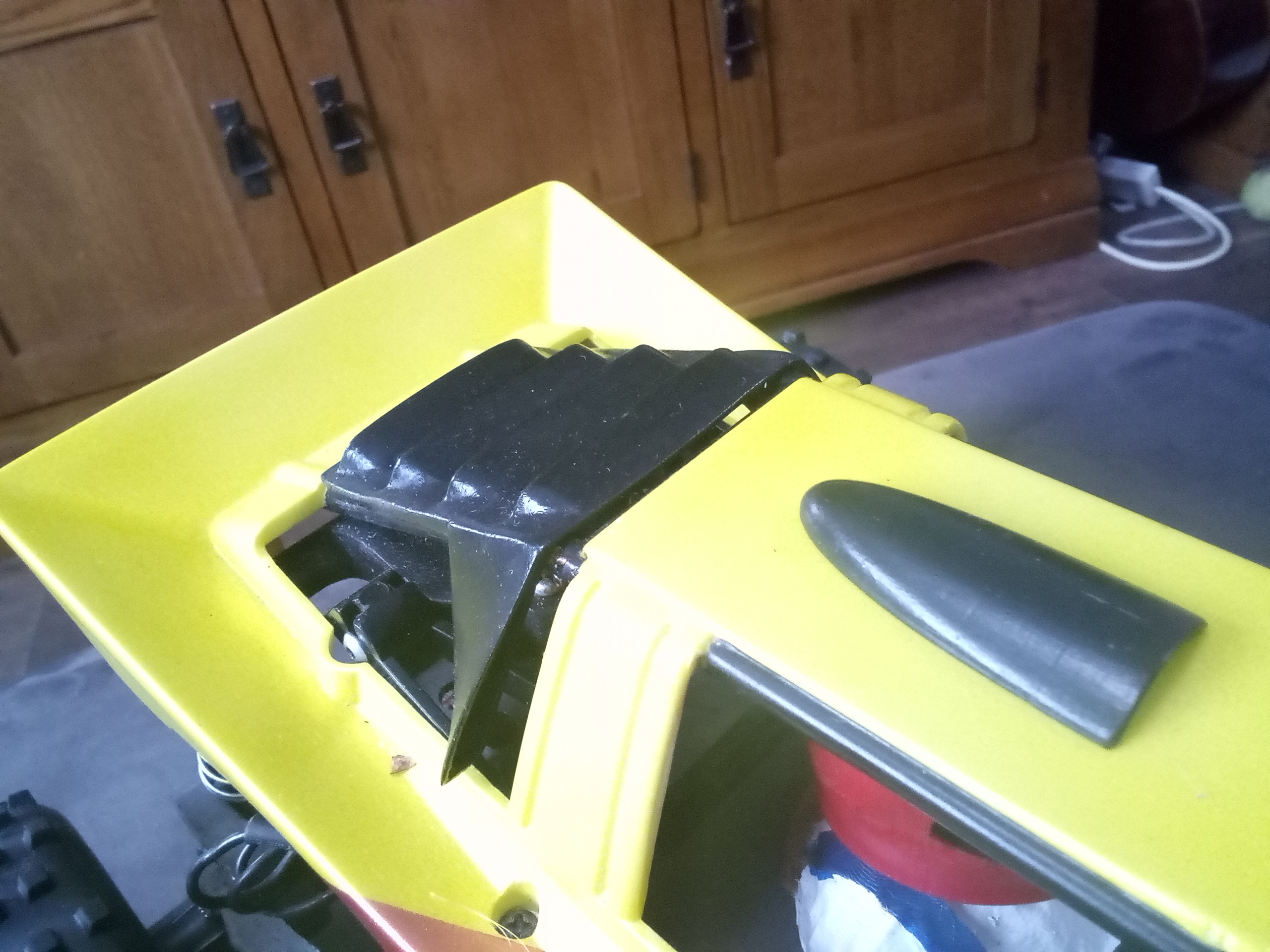

A few final pictures , I widened the front end to match the rear , the louvered rear window will be on thingiverse soon along with the front end .

That's a fantastic Hopper! The paint looks right on it. I'd also be nervous attempting a paint job that elaborate. Very well done!

Even the yellow base is first a coat of white , then clear pearl and a candy (transparent ) yellow , then after all the other colours are similarly done a coat of clear , so even at its thinnest it's four different paint coats . The little diamonds then needed a base white before the metallic or pearl and candy , so on some of the diamonds including the clear lacquer it's seven different paint coats , really was praying it looked better once the decals were on and they were four days before they arrived , I was chewing my toe nails by that point :lol:
I just could not get a picture that does the yellow justice , it really shines and reflects , you sort of see it in places in pictures but not how it is in real life .
