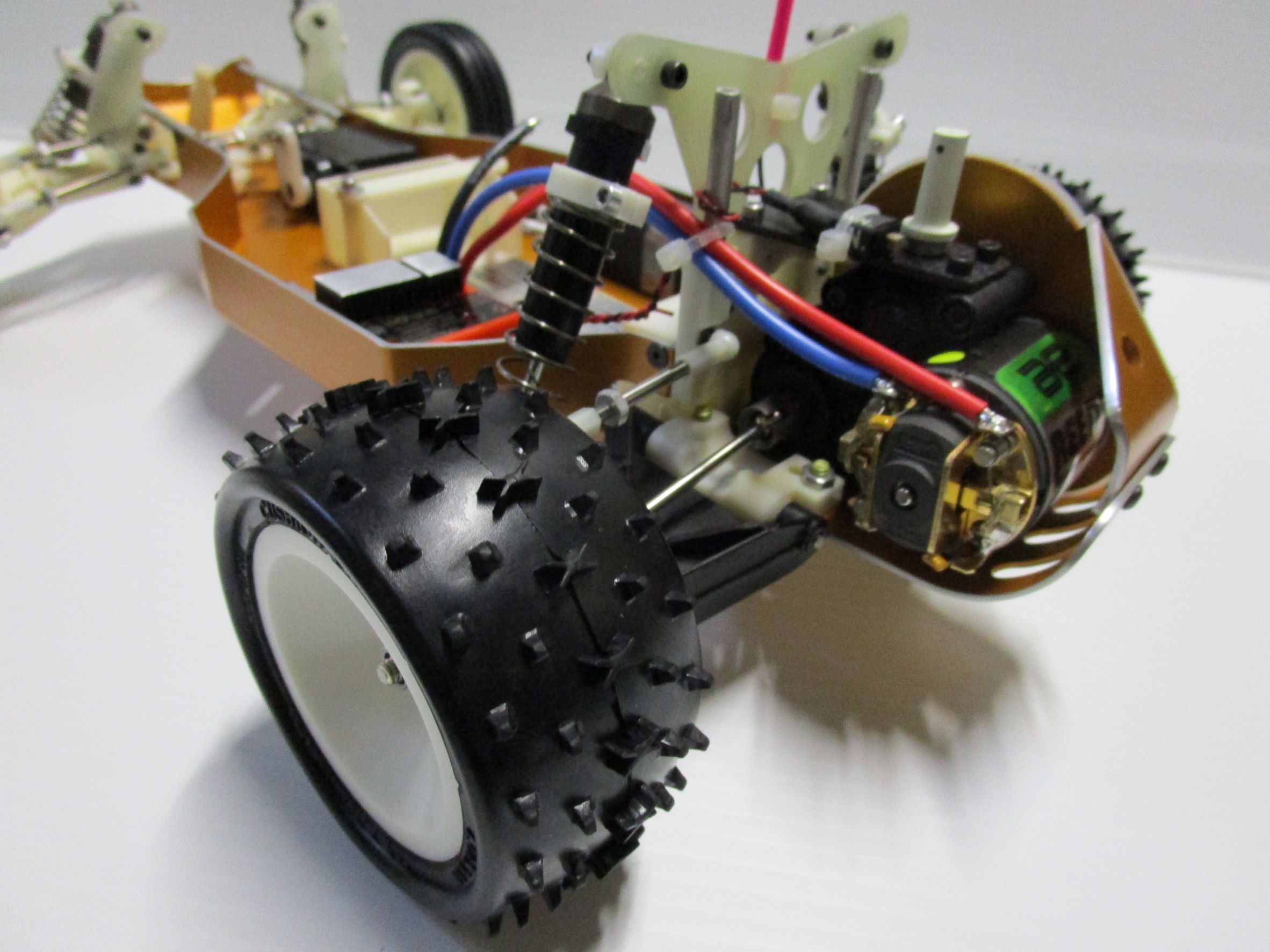

This car came about as when i bought the Futaba sticker sheet for the "'power under pressure"' sticker (see roof) for my Yokomo project i received two so needed another project :wink: Anyways here it is never going to be 100% but close.

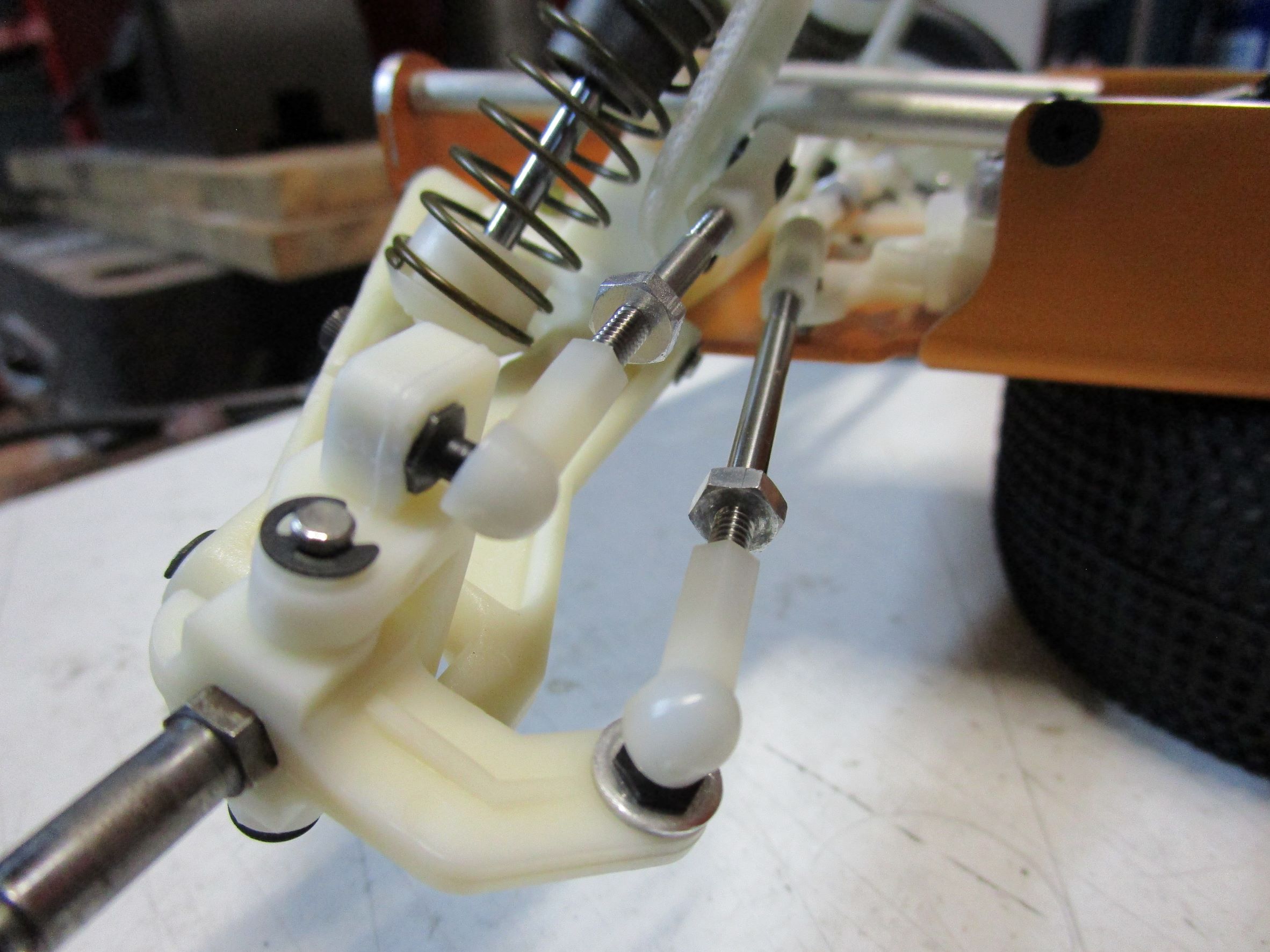

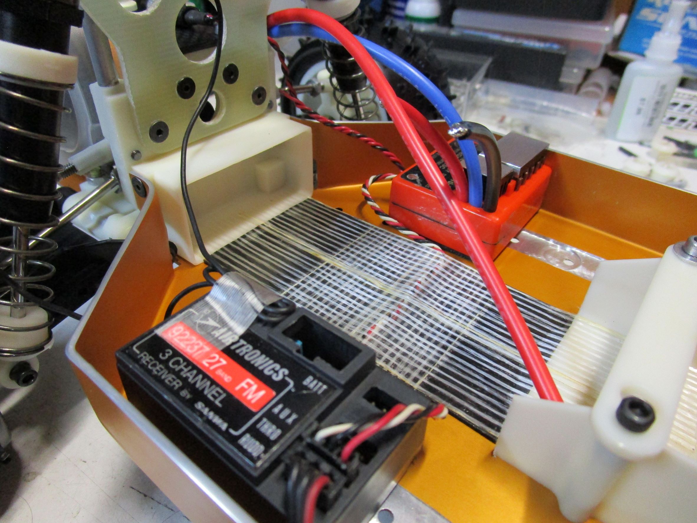

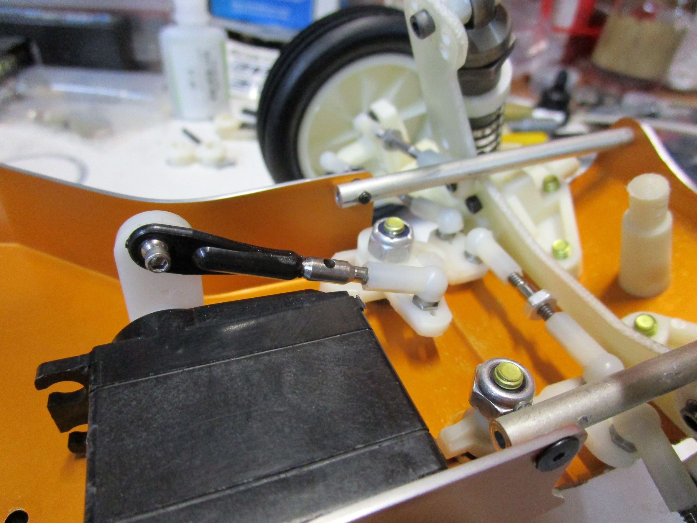

A few more pics with more detail.

I am not an RC10 expert (blasphemy, I know), so what differentiates Cliff's setup from a standard RC10 of the time? Any prototype bits on it that became standard later?

1911Colt wrote: Wed Sep 28, 2022 7:30 am I am not an RC10 expert (blasphemy, I know), so what differentiates Cliff's setup from a standard RC10 of the time? Any prototype bits on it that became standard later?
I believe the stealth trans was the main "prototype" item on this car. More of a pre-production piece really. The servo was special too if I remember right.

1911Colt wrote: Wed Sep 28, 2022 7:30 am Very cool pre-Team Moo paint scheme :D
The shocks of the time were not hard coated so just plain gold anodized that wore internally fairly quickly also the front shock tower would be in newer kits.
Middle of the car pretty much the same.
And the rear like Scrap said the stealth gearbox with all new slipper.
As for all the small chassis bits that are different from kits of the time.
25 degree front caster blocks
Lunsford titanium turnbuckles
Yokomo ball studs and rod ends
rear universals
RCPS body
Associated 6 inch wing
Carbon trans brace
