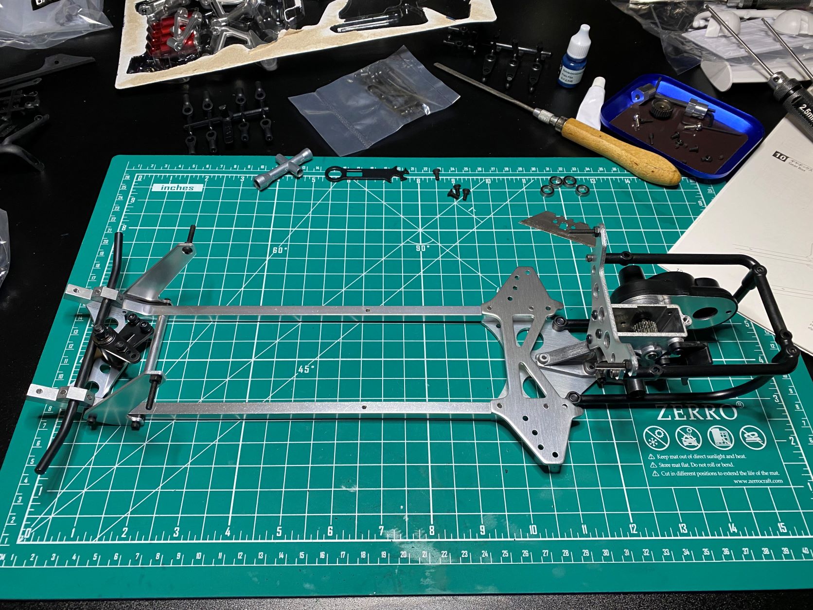

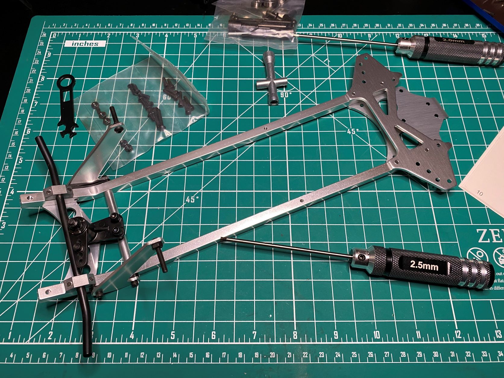

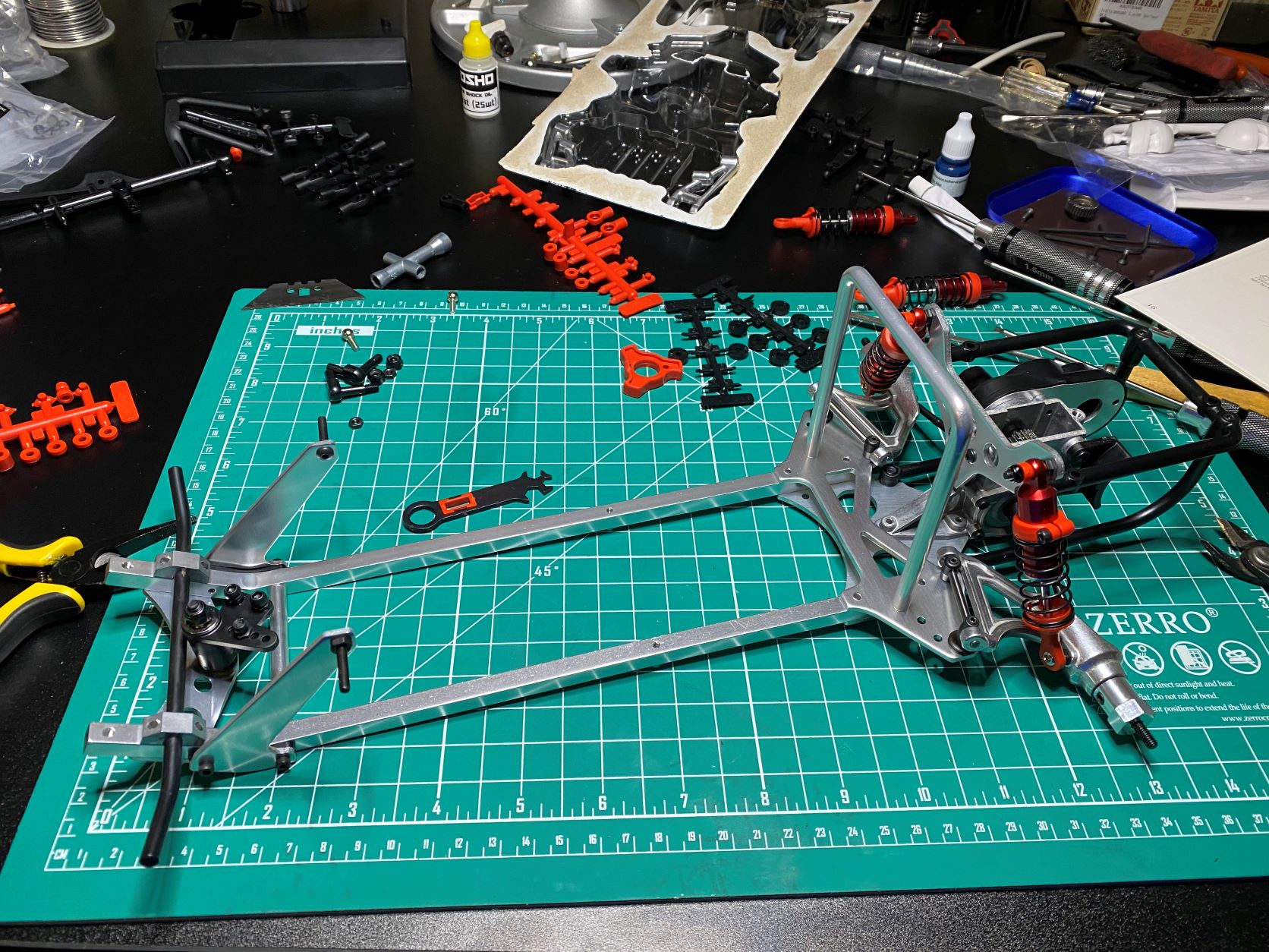

i'd never seen a Scorpion in person and i wasn't sure what to expect when building it. i was immediately impressed with the quality of the metal parts for the frame. as an engineer, the design is intriguing and i felt a sense of regret for not having bought one in the 1980's.

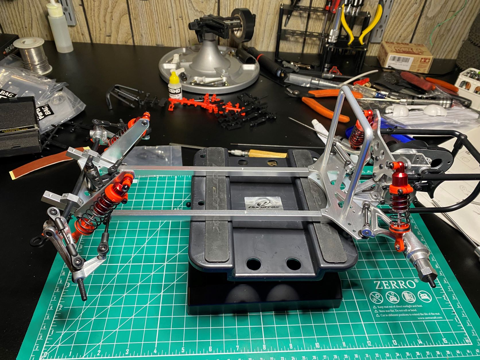

the pre-assembled gearbox made assembly a fast but still enjoyable process. as an owner of a vintage VW, the rear suspension seemed oddly familiar.
it did not take long to have the chassis completed. i sat for more than a few minutes admiring the design and precision of the Kyosho kit.

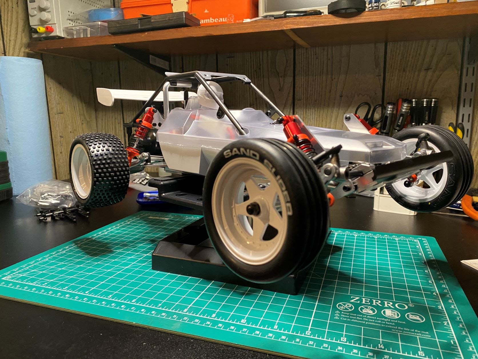

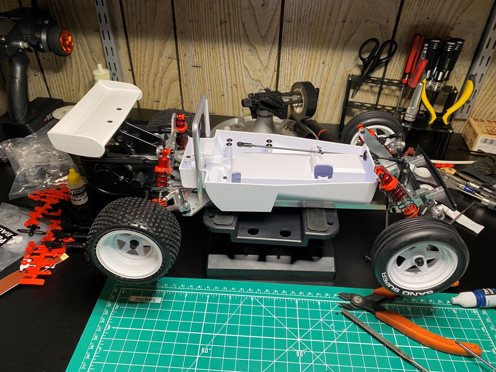

with the tub in place and the wheels attached, the assembly is nearly complete.

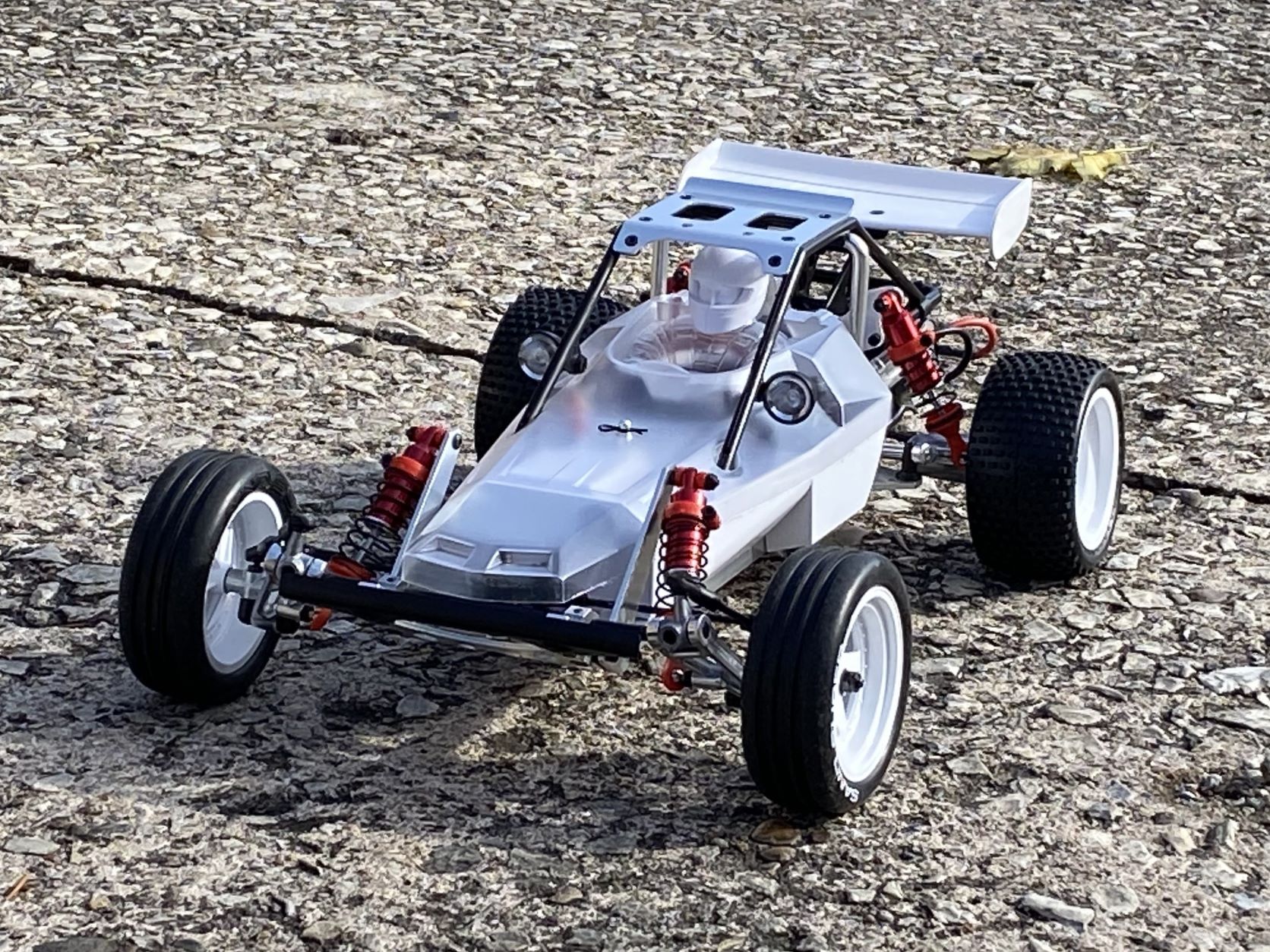

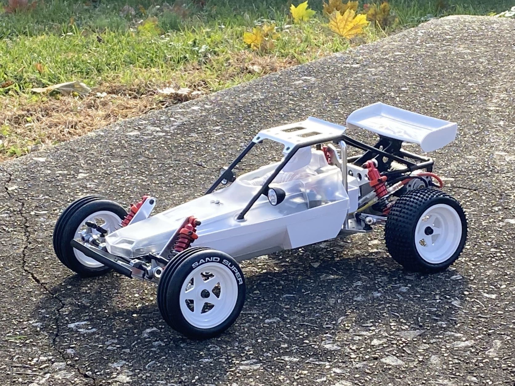

i assembled the body with the roll cage and driver to see how it looks. it looks mighty fine and is ready for the electronics.
i installed a Radiolink R6FG receiver, a Hobbywing 1060 ESC and an Airtronics servo from the 1980's (taken from the AYK Radiant's mechanical speed control). i had ordered a Kyosho G20 motor and instead of waiting for it to arrive i installed a Tamiya Sport Tuned 540 motor and took the Turbo Scorpion for a test run in the alley behind my house. i had a blast running around the alley seeing what the car could do. i run with 4600 maH NiMH batteries and wasn't sure how long the car would run... i was out for a good half hour blasting around the alley before it started to show signs of the battery running down. i LOVE this car, it's a fun and easy build and it puts a huge stupid grin on my face when driving it.
i still have to paint the body and apply the decals, but that doesn't stop me from enjoying this great looking and really fun driving car.

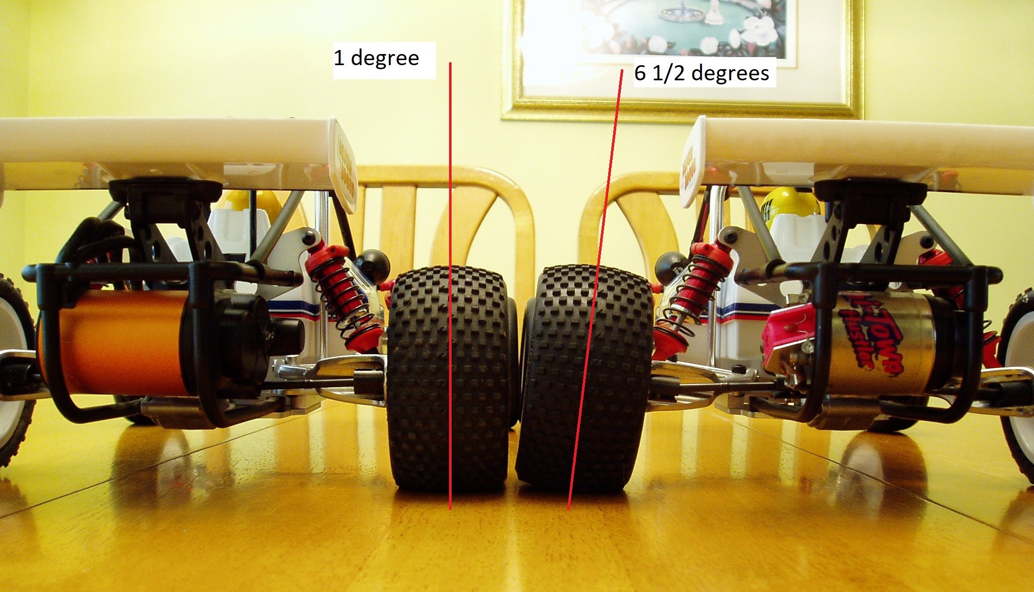

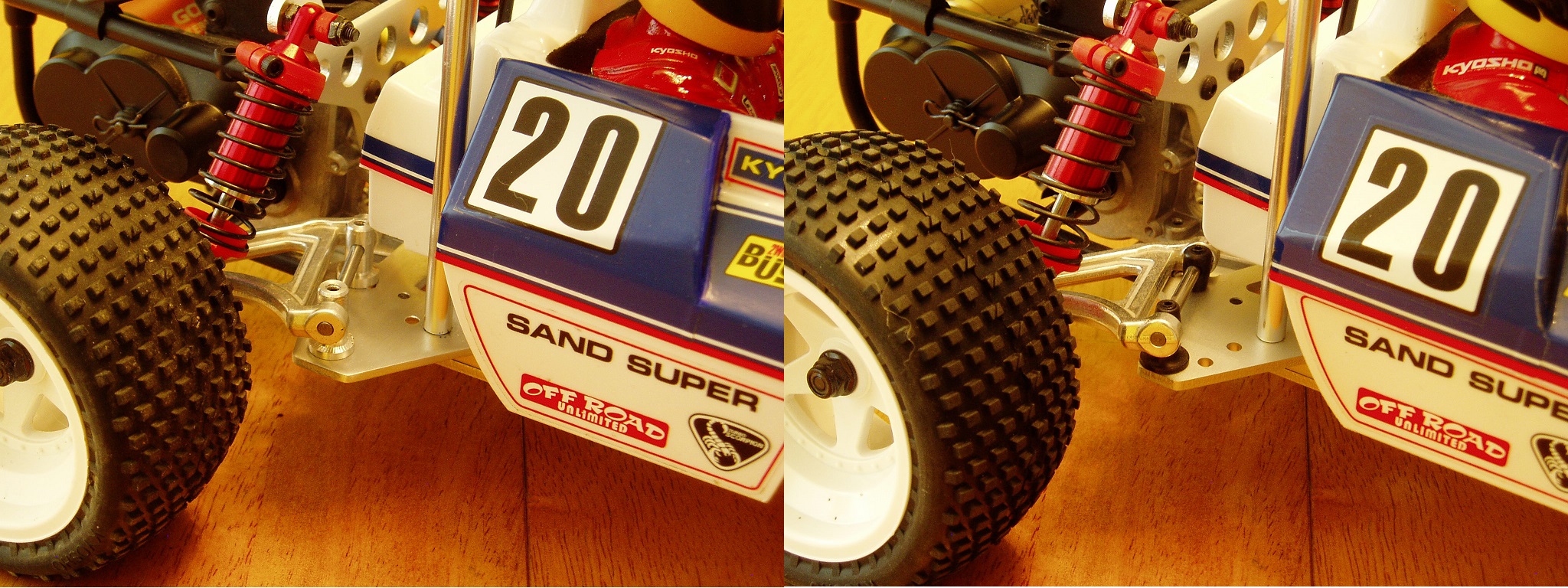

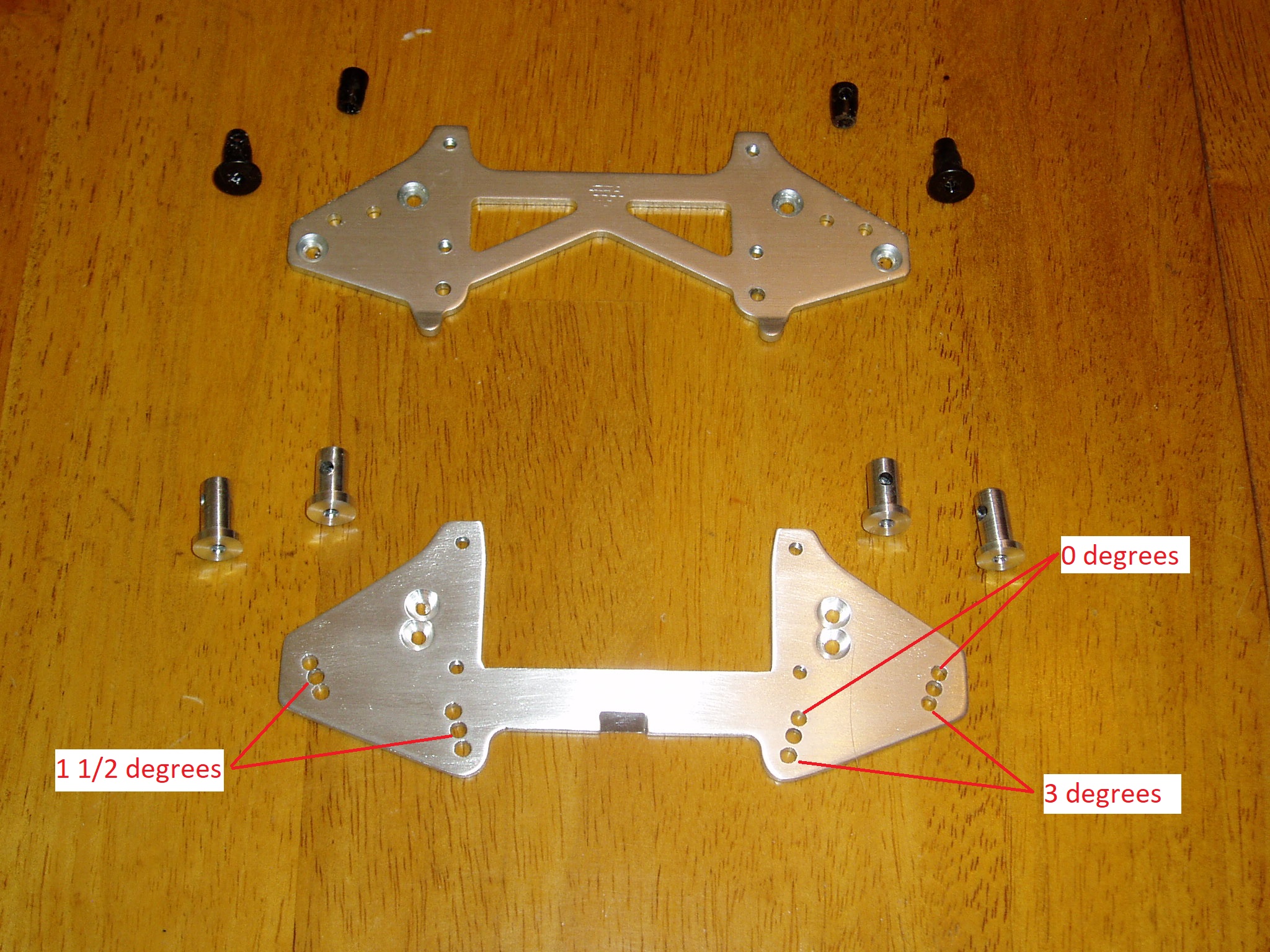

Out of the box, my runner car tended to oversteer on a loose dirt track so I've made some rear suspension mods to provide some toe-in options and reduce camber angle at normal ride height.
Here's the modded assembly vs. stock:
That said, the mods certainly aren't necessary to just go out and have some fun - as you've already discovered.

you are 100% correct, it is the best looking 2wd buggy of all time. it looks the business.
very nice straightforward mod for adding adjustments to the toe-in and camber. i was considering using a shim on the outward swing arm mounting post to add camber but i wasn't sure how it would affect the angle of the driveshaft in the rear axle cup at full compression.

In stock form, my car's rear camber angle measured 6-1/2 degrees which I felt was far too much for optimal rear traction. It also caused uneven tire wear.
The redesigned stanchions brought the angle back to 1 degree which is what I run on my RC10's.
The car handles much better now but it still won't perform as well as an RC10 using the same motor and battery.
Nevertheless, I very much enjoy running the car. It looks awesome out on the track.
