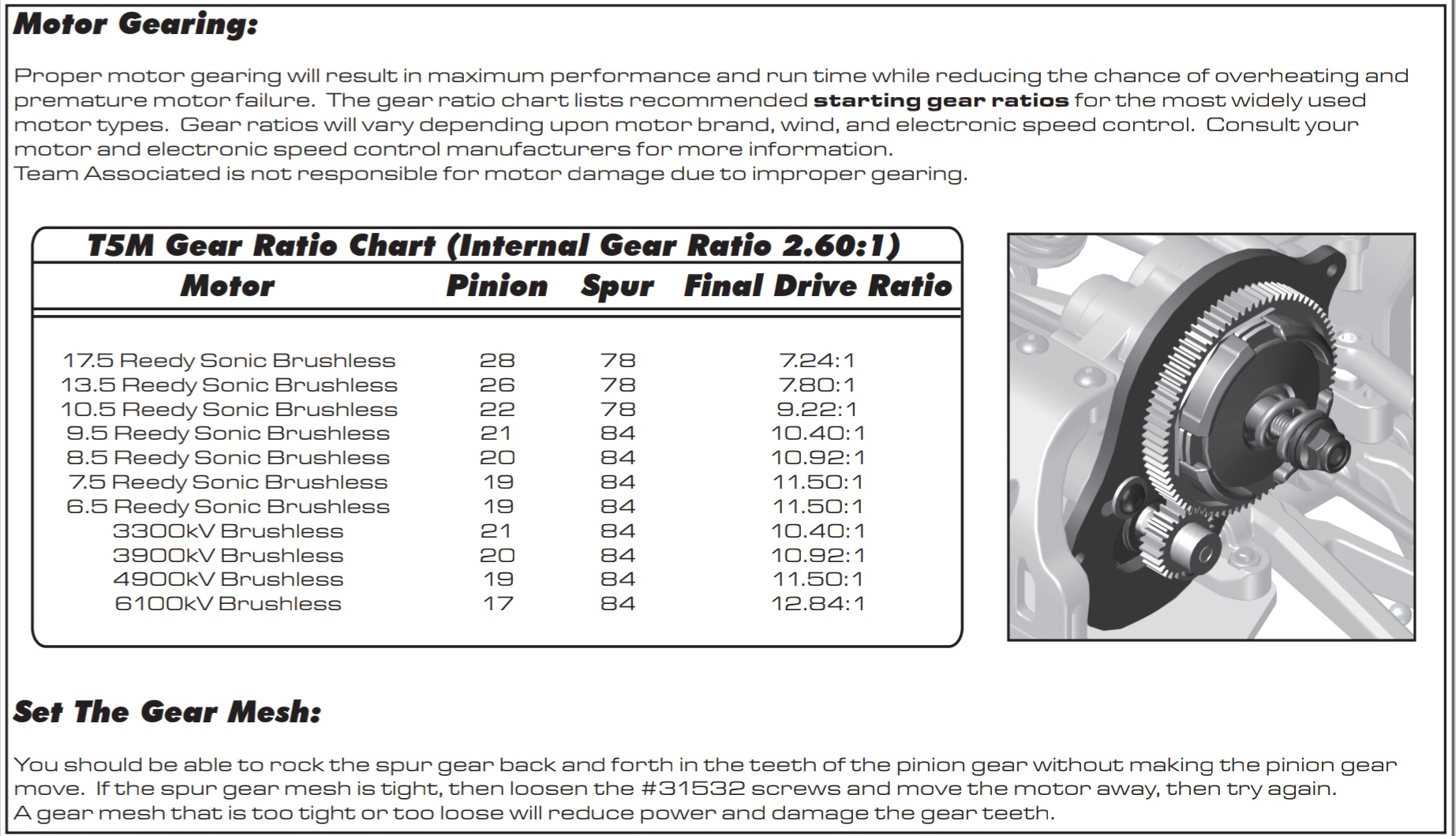

Xwelder wrote: Sat Mar 04, 2023 10:22 pm Really nice conversion. Thanks for posting. I’m converting my black tub and I got some good ideas from your photos. One question; what KV motor are you running and how does it do?
There are lots of E-GT conversions around here. The flat blue chassis is a little easier but there are still several tub trucks.
This is from a T5 but should still be a good starting place for motor and gear ratio selections.

Thanks for posting that chart I was looking for something like that. I'm also building a E-GT and almost done, just need some electrics and to paint the body.
