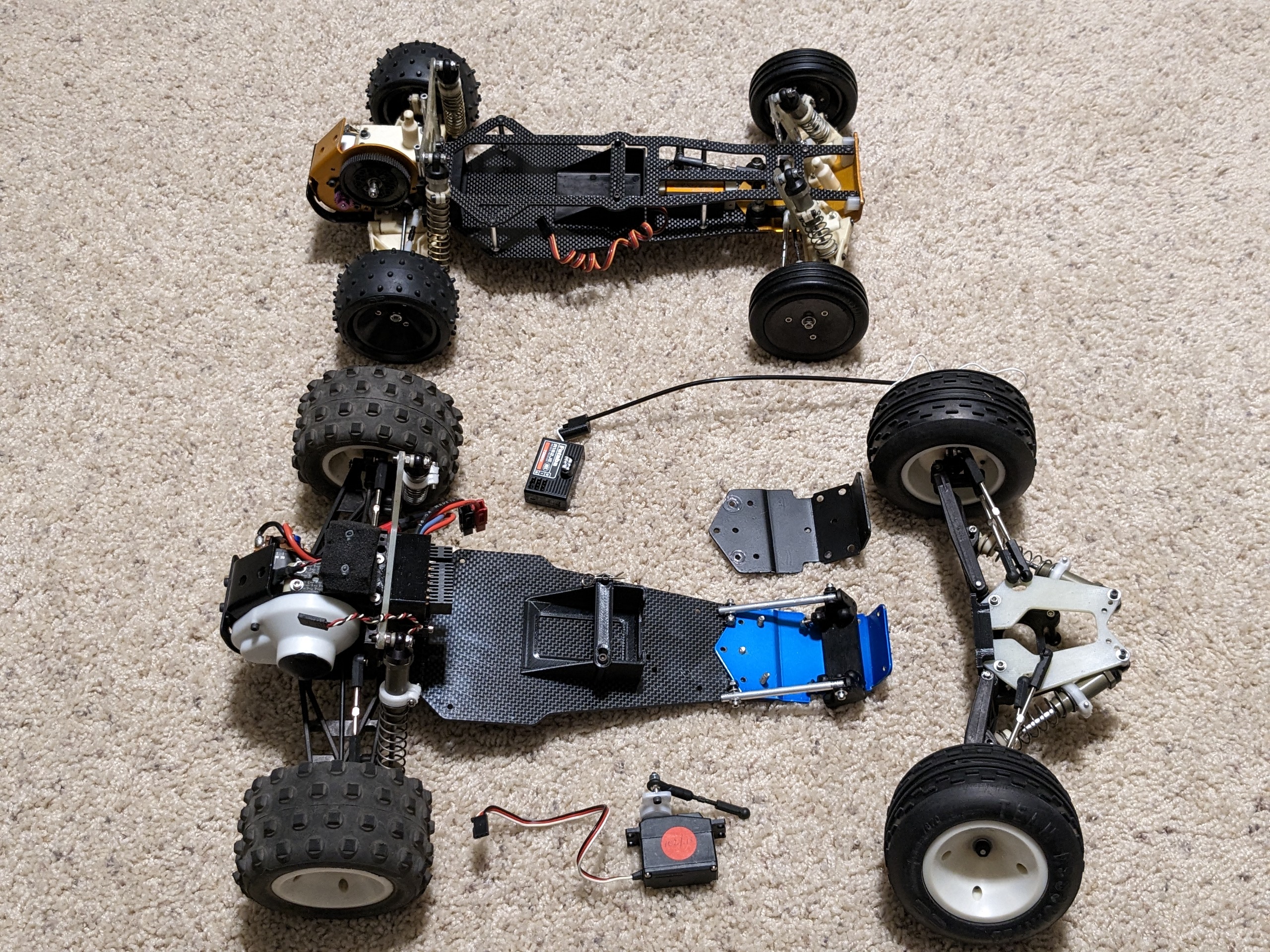

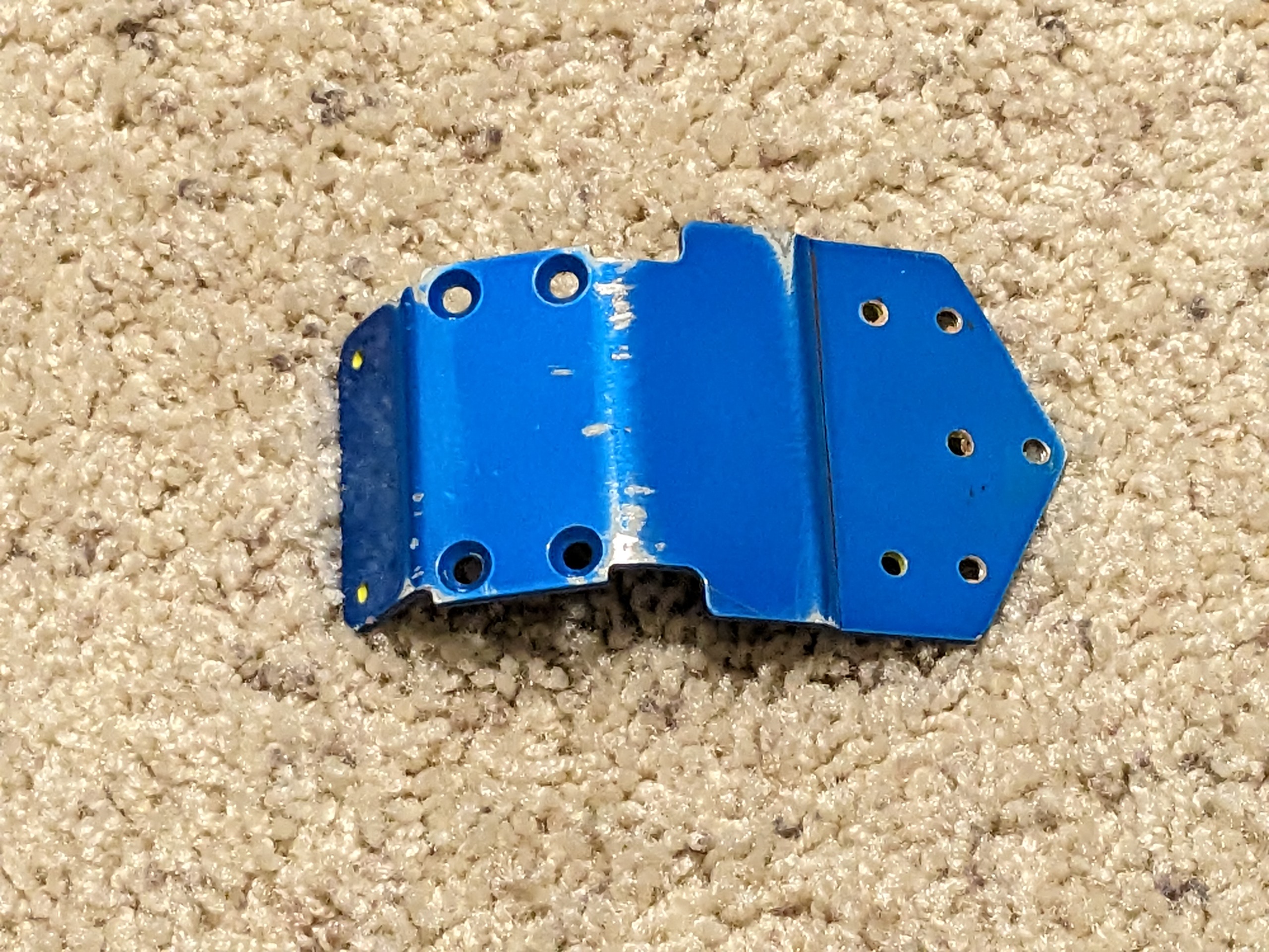

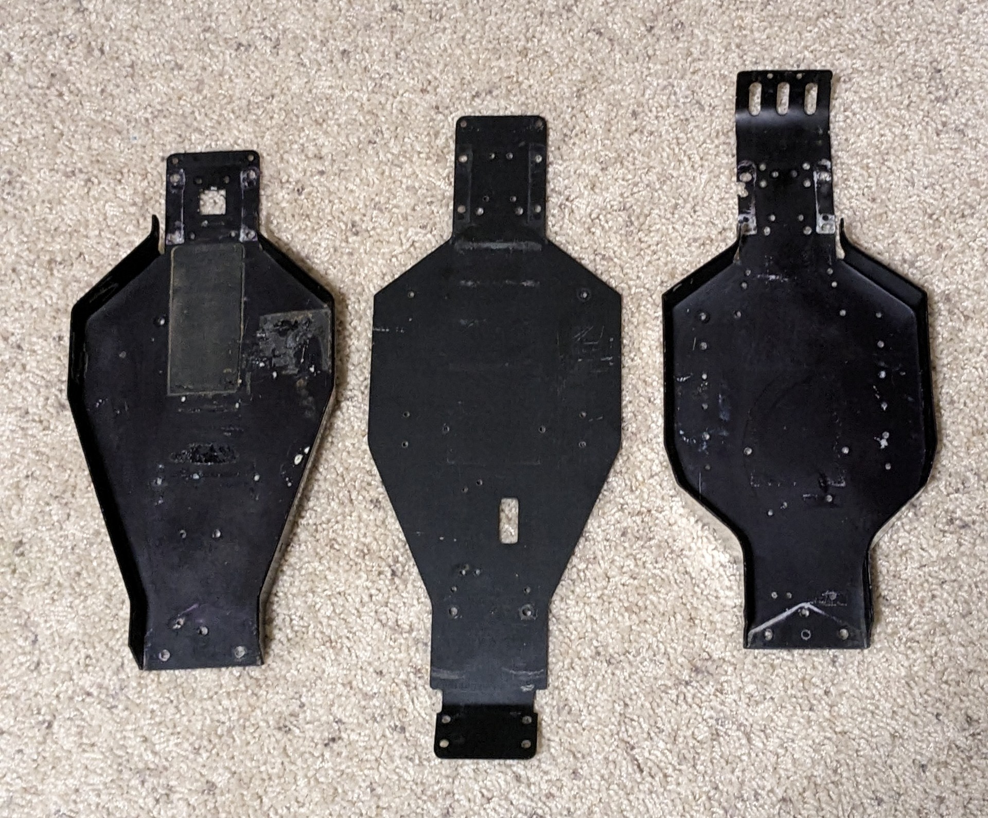

Frankentruck wrote: Thu Mar 17, 2022 7:35 pm It's now an RC10T Graphite. Gearbox is mounted and steering is sorted out. All that's left is pick the receiver, ESC, motor, make a front bumper, and add an undertray. I did some wet sanding work to mostly clean up the underside and don't really want to add new scratches. An undertray sized for the aluminum chassis will work, but will be a bit wider than needed (which is ok). I just need to go ahead and order a couple of them.

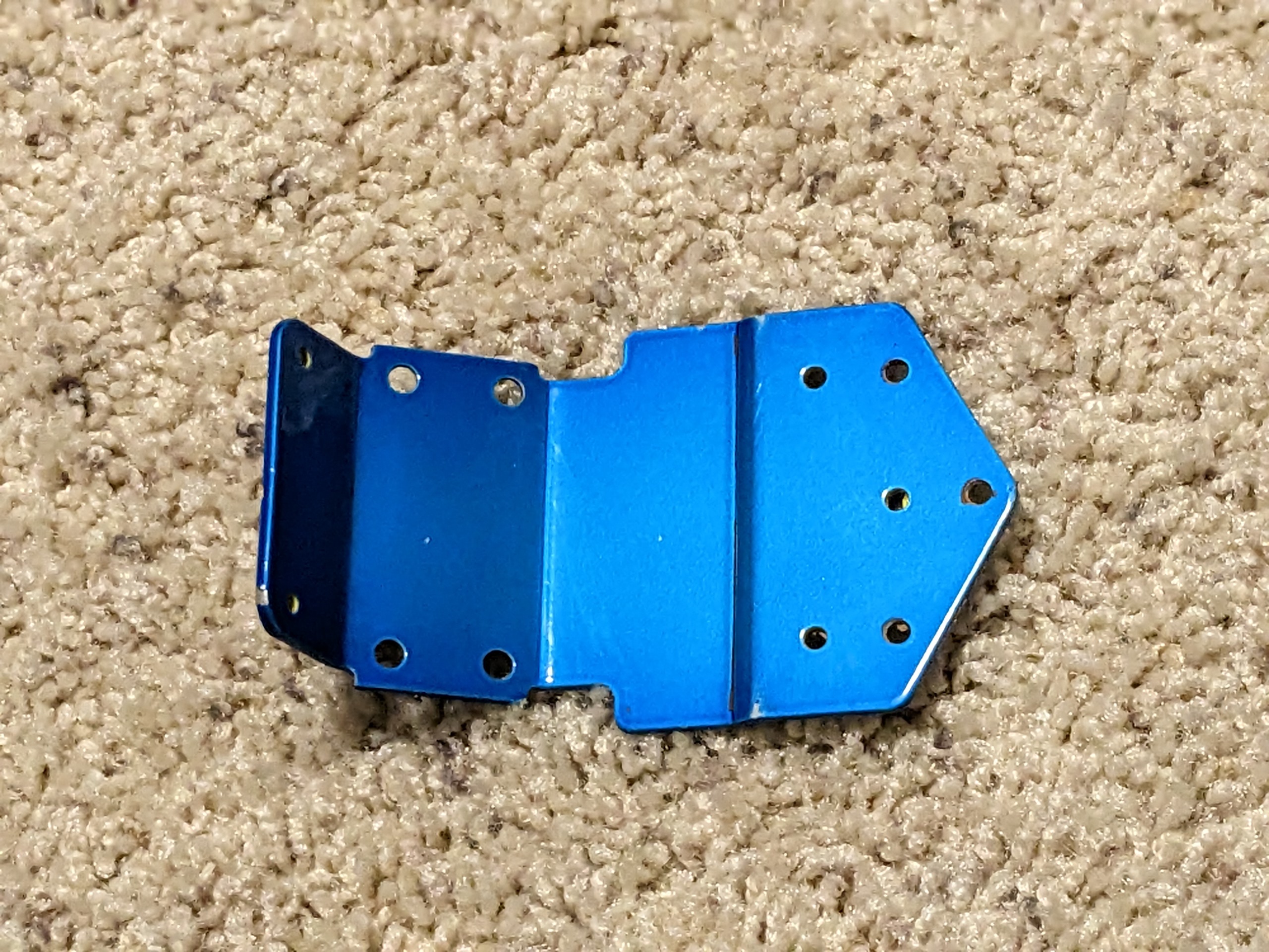

Sometimes it's hard to leave things complete without tinkering some more. I have an extra coffin style chassis plate, and then I ended up with this painted nose plate that I stripped down to the blue finish.

Re: Fixing up the Frankentruck(s), the fleet of them
Why short wheelbase? Shouldn't a truck use the longer setup?

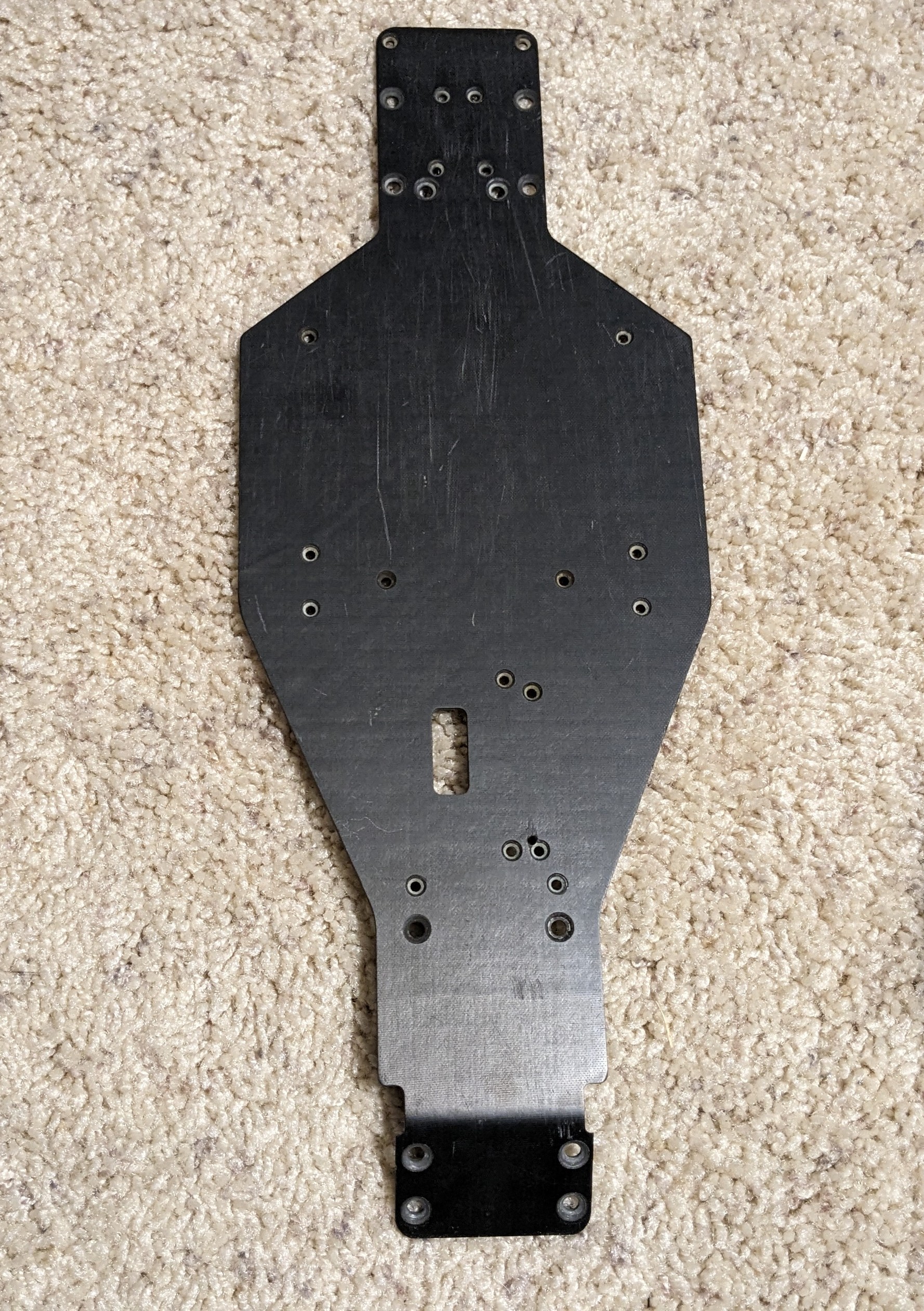

But then this cool graphite chassis came my way. It was sold as a T2 chassis, and the shape is similar to a T2 pan chassis. But it's setup for a 1st gen stealth gearbox so it must be for a T. Hmmm...

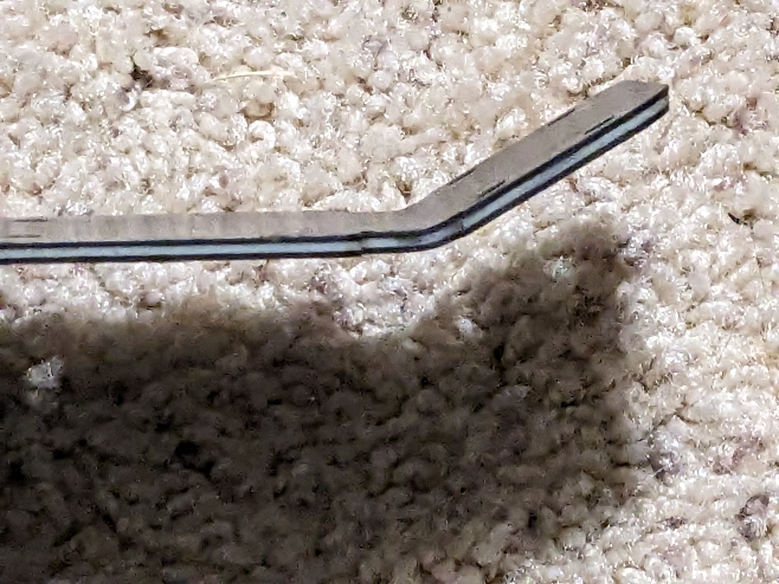

Interestingly, it looks to be a black/white/black sandwich construction similar to the TQ10 chassis. Maybe the same company made both of these chassis. Maybe?
juicedcoupe wrote: Sat Mar 04, 2023 9:37 pm Why short wheelbase? Shouldn't a truck use the longer setup?
I don't know, should it? I tend to start with the short wheel base position by default but I'm relatively inexperienced with setting up the T.

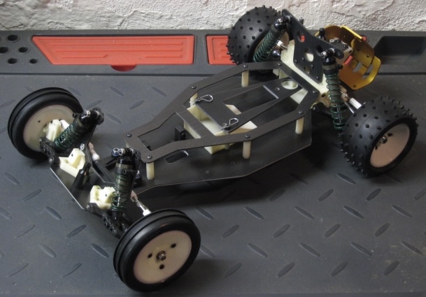

Sure does look like a Composite Craft RC10T chassis, would look real good with a Factory Works top deck. 8)

MarkyDents wrote: Sat Mar 04, 2023 9:54 pm Sure does look like a Composite Craft RC10T chassis, would look real good with a Factory Works top deck. 8)
Oooooooo! Yes it would! I mean, if I knew what that top deck looked like. Got any pics? 😁
Frankentruck wrote: Sat Mar 04, 2023 9:44 pm
The original 10T used a buggy length chassis and the long wheelbase holes in the nose plate. The T2 used a longer chassis.
That said, using buggy bellcranks in the front holes makes for better steering geometry.

Frankentruck wrote: Sat Mar 04, 2023 10:01 pm
You can thank Jason for this one.
Interesting. That's a buggy, but there's a similar one for the truck?
