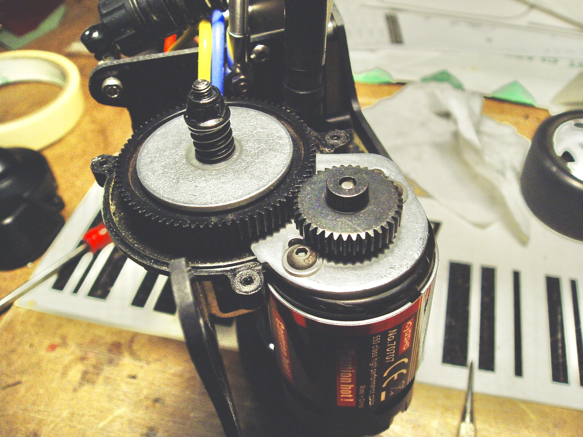

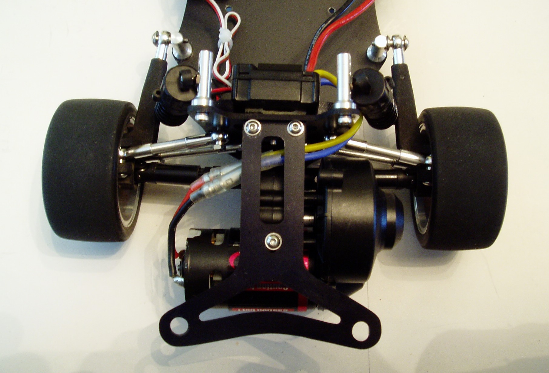

The new motor is very heavy and changed the car's balance (understeer on corner exit) but I was able to bring it back a little closer to neutral by decreasing rear toe angle from 2 to 1 degree. I like the handling with the new motor but now I'm searching for a bit more speed. After 30 minutes, the motor was only slightly warm so I'm gearing up from 7.28:1 to 6.15:1 FDR.
I also noticed a wear pattern on the rear tires that suggests that it needs more camber angle so I've fitted 1 shim (a washer, actually) to each lower radius rod. The lengthened rod kicks the bottom of the tire out by about 1-1/2 degrees.

I’m using 4000mah batteries and after a 30 - 35 minute run, the motor is still only slightly warm. The taller pinion gear installed yesterday has yielded an increase in speed but I think there’s more left in that motor - maybe much more. It just needs more gear.
I’ve been running the largest 32dp pinion I have (22t) with a 52t spur for a 6.15:1 FDR. After rummaging through some boxes, I found a 38t 48dp pinion so I’ve paired that with a 78t spur for a 5.34:1 FDR.
FWIW, that is the largest motor pinion I've ever held in my hands. :shock:
