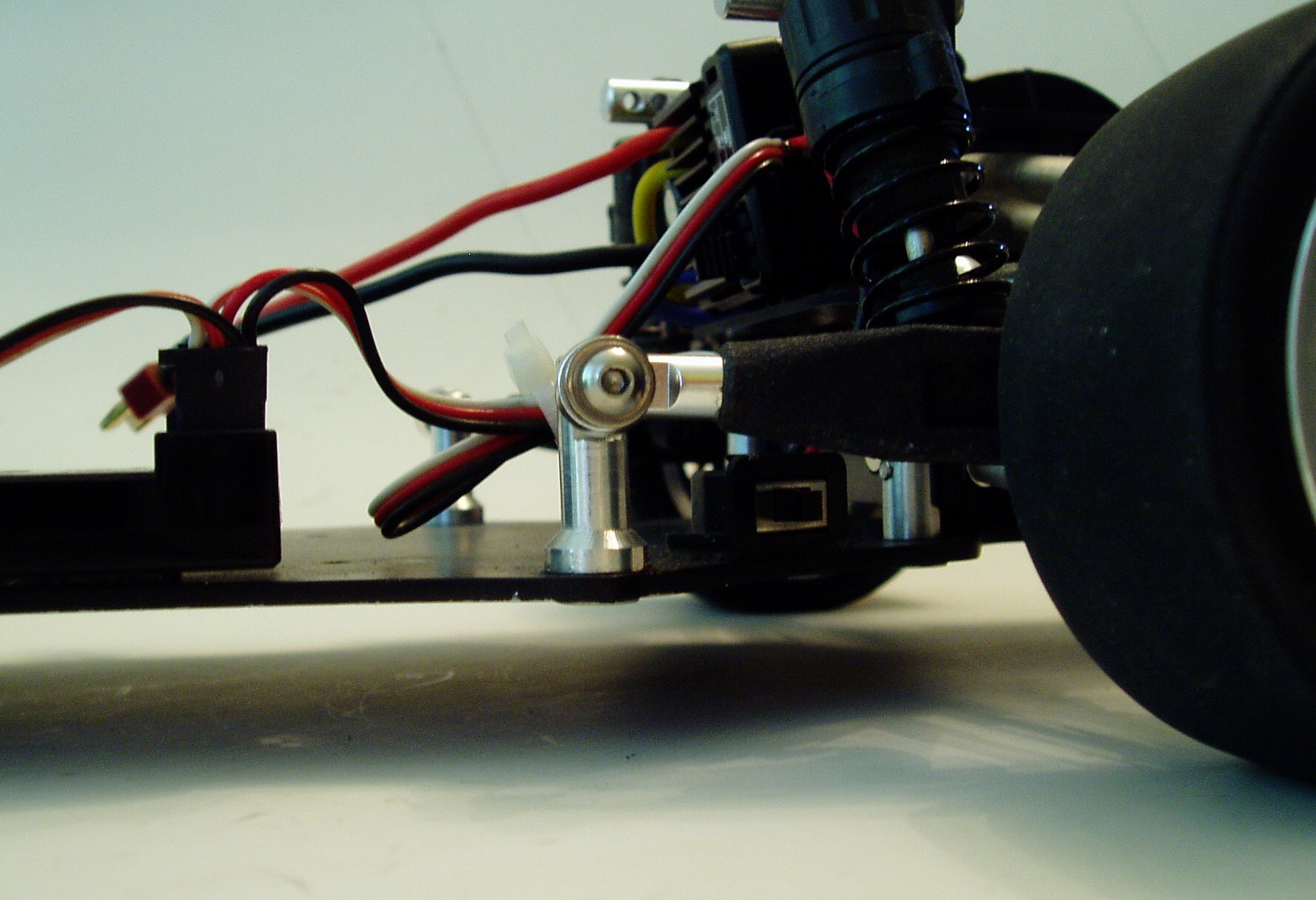

The new motor is very heavy and changed the car's balance (understeer on corner exit) but I was able to bring it back a little closer to neutral by decreasing rear toe angle from 2 to 1 degree. I like the handling with the new motor but now I'm searching for a bit more speed. After 30 minutes, the motor was only slightly warm so I'm gearing up from 7.28:1 to 6.15:1 FDR.
I also noticed a wear pattern on the rear tires that suggests that it needs more camber angle so I've fitted 1 shim (a washer, actually) to each lower radius rod. The lengthened rod kicks the bottom of the tire out by about 1-1/2 degrees.

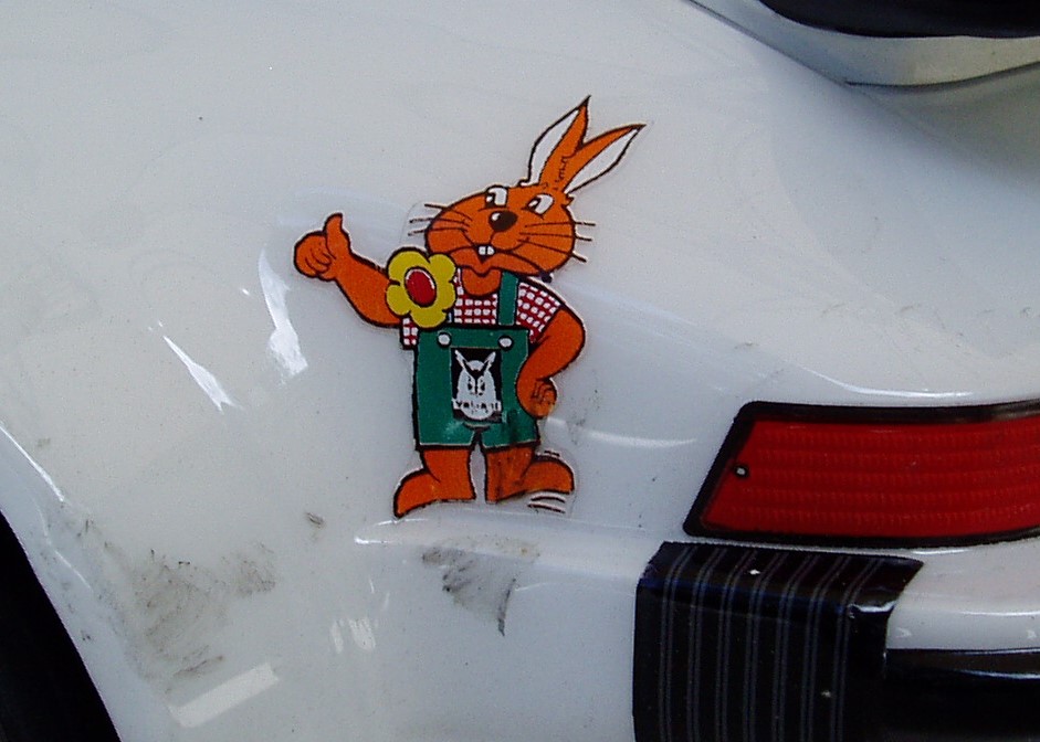

The tennis courts were very dusty and slippy - probably a result of the high winds over the past several days. Anyway, the car was faster but much harder to drive on that dusty surface.
It handled the curves fine but the tires would suddenly break loose in a straight section -- the tire spin was completely random.
I had been lucky so far -- not hitting anything -- but eventually the car spun and I was unable to stop before it backed into one of the support posts for the nets.
A wheel is broken, the motor plate is bent and even the chassis plate is bent. :( I’ll order another set of wheels and straighten the bent plates.
Fortunately, the printed trailing arm has survived the impact. MFJ nylon is very tough.
The bunnies are okay as well. :wink:

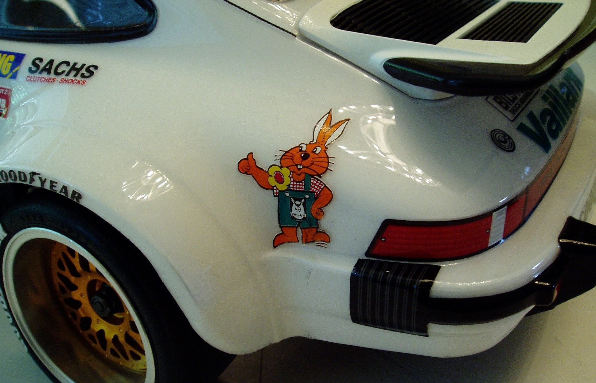

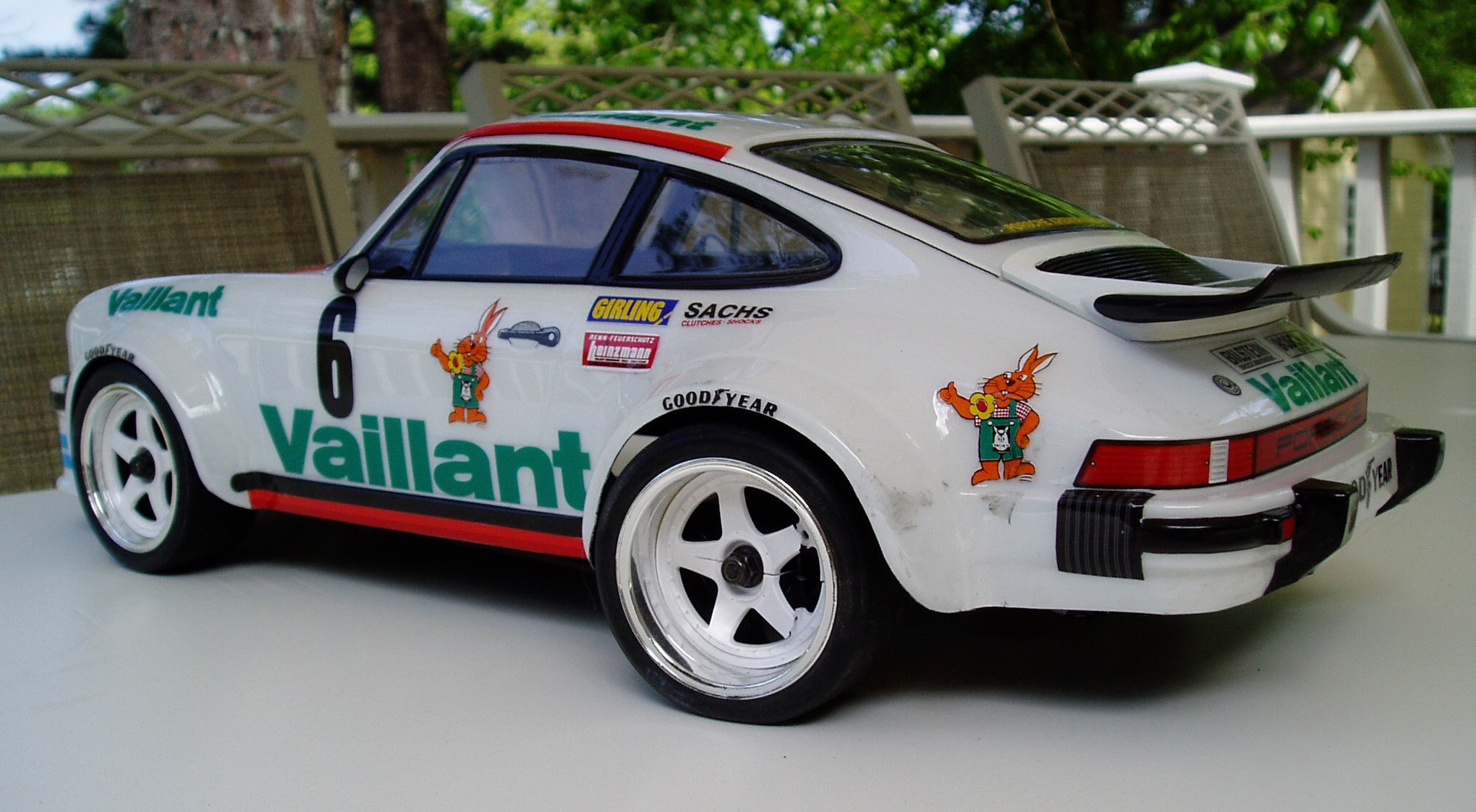

The bent plates have been straightened, the wheels re-aligned and it's ready to go again.
I can run those heavy aluminum wheels until the replacement plastic Tamiya wheels arrive.
Bugs is happy. :D
