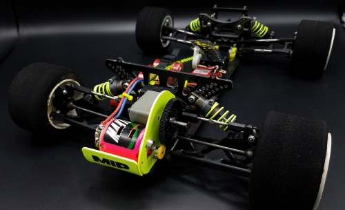

Here's my LX-T that I raced on carpet ovals as a kid. It's close to how it was back then, except for the .36" shocks and yellow motor plate.
I ran A&L Roadkill & BTS Liberator, Dahm's Ruff- E-Nuff SE and Andy's Lo Profile bodies. I had Trinity Pushed 1400's but the Point Blank labels fit the color scheme better.😄
- Composite Craft TLTO chassis
- Factory Works oval front & rear towers, Tru-Spin axle kits
- A&L mounted foams & steering
- Thorp 64P tranny gears
- MIP CVD's & Lite Drives
- Dynotech slipper eliminator
- Lunsford Punisher titanium turnbuckles, hinge pins, Quik-Tune shock mounts & Fat Boy motor screws
- Tecnacraft aluminum screw kit
- RPM front bulkhead, front arms, shock bushings & pivot balls, rod ends & 0/2.5-degree anti-squat bar
- Losi .36" hard anodized shocks
- Trinity motor spacer heatsink
- Maxtec 30-degree Team stock motor, Novak 410-M5, Dynamite MicroPro receiver, Futaba S-148 servo, Point Blank 1400 SCR's, Dan's LTO Battery Belt

Wicked cool piece as usual ! 8)
Hey Cru ! Go balls out 8)

Crazy cool chassis. Got a body for it?

Like most everything you build, that looks great!

Well... it's a cream dream. Probably my favorite yet. 8) Seriously.
