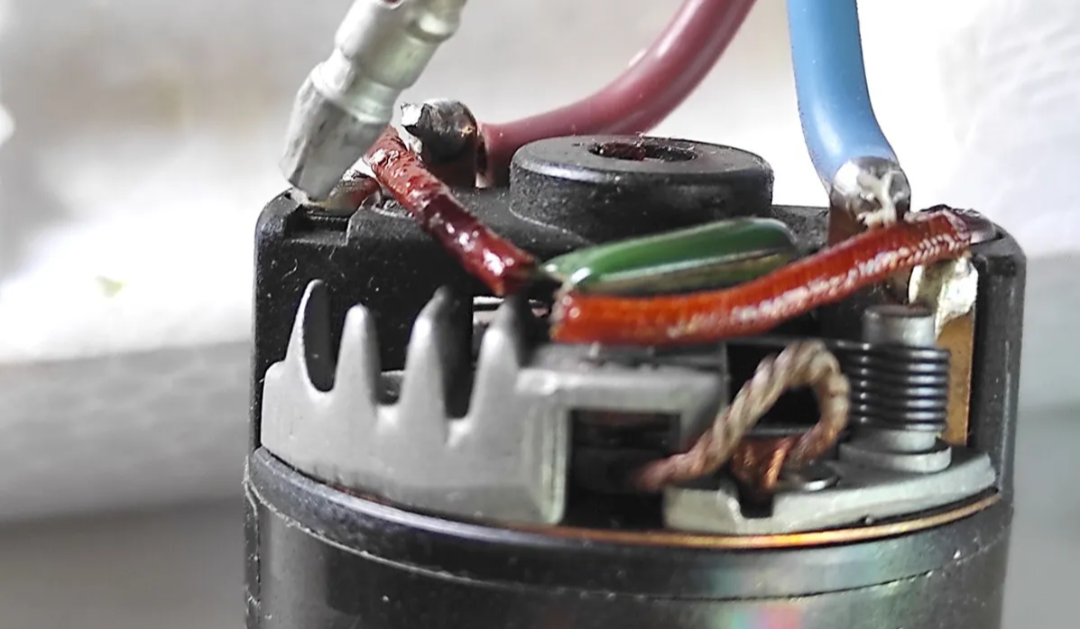

Re: Brushed motor cans & endbells
Checkpoint motors are the most common place to find these cans and endbells but some other brands did use them. I'm not positive if Checkpoint was the maker of the parts. They are one of the cans that had an aluminum mounting face.
. Example of an early Checkpoint motor with early Yokomo can and open endbell.
