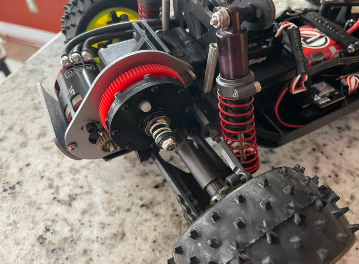

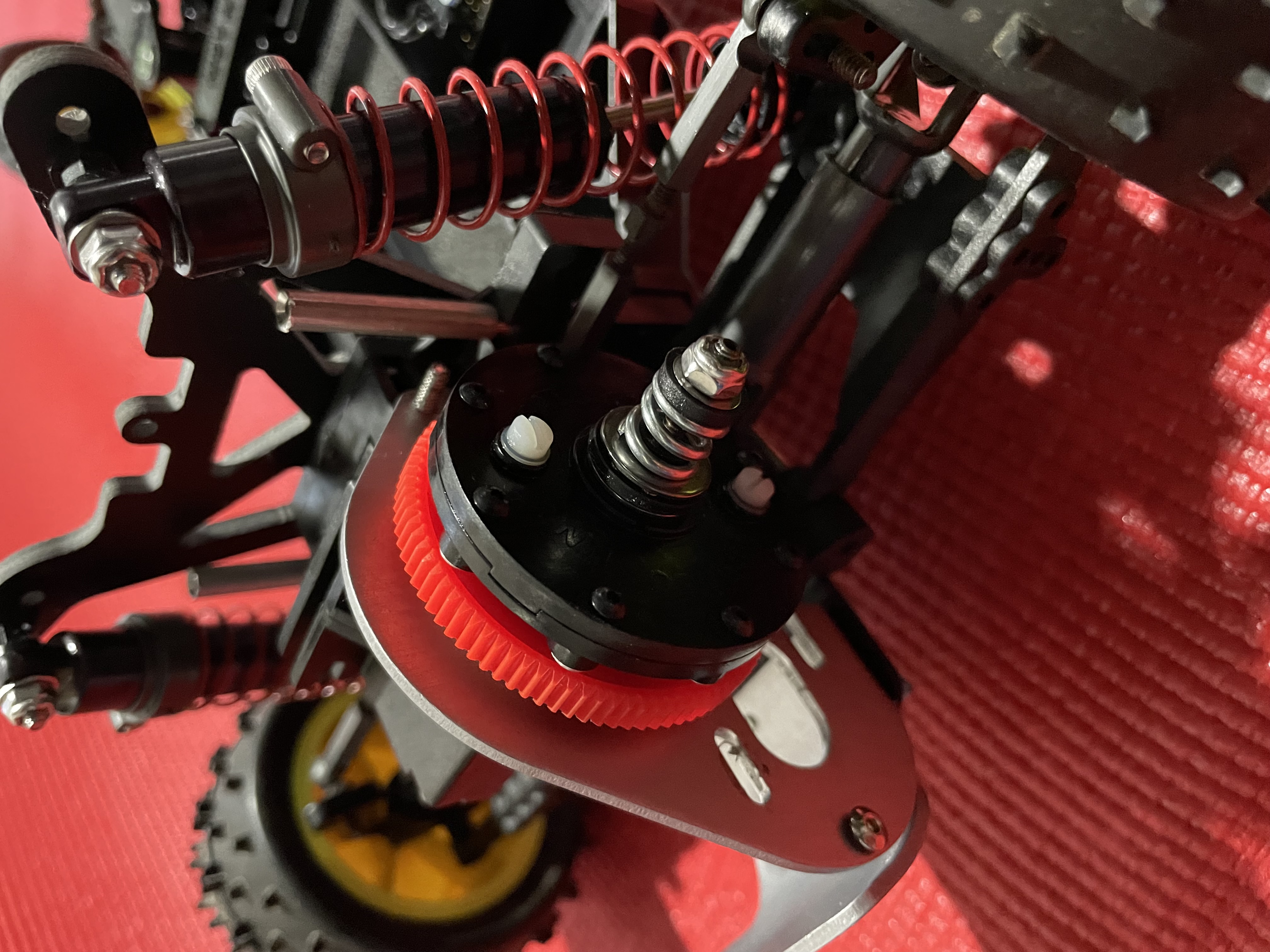

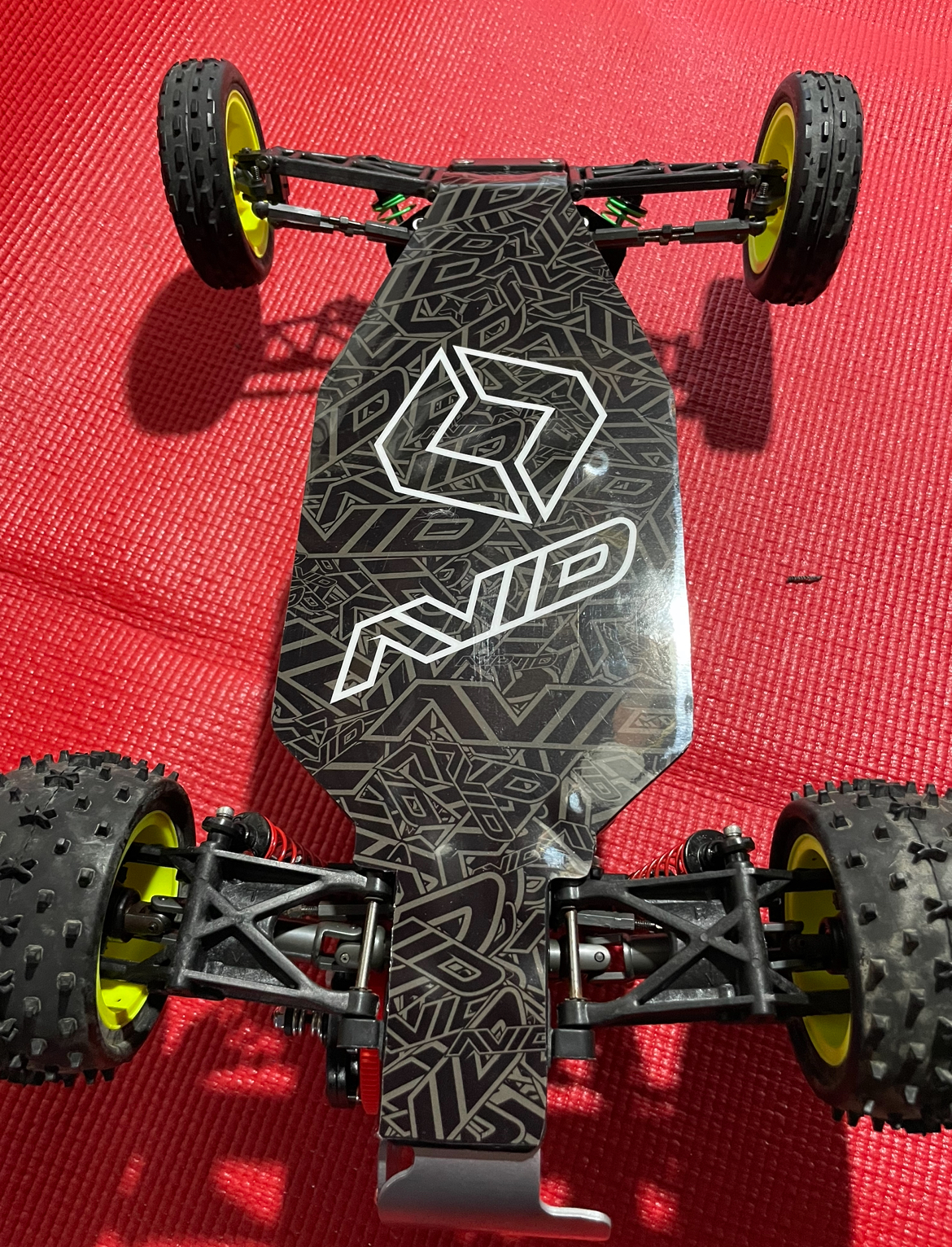

Re: My "New" JRxPro SE Build thread

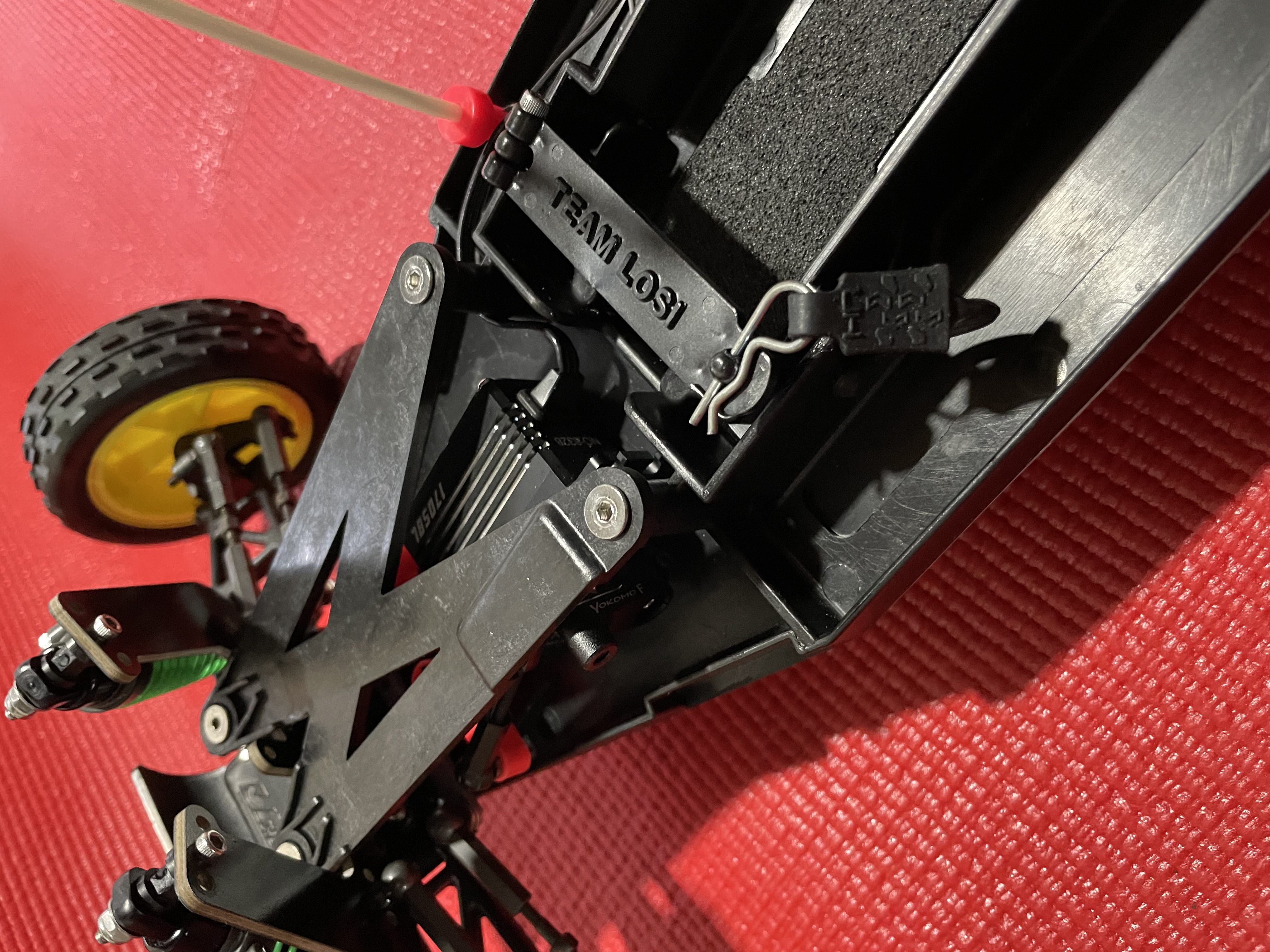

Completed assembly of the hydra drive by piecing parts together from eBay finds. Forgot about the silver spring. Had to purchase that separately along with a rebuild kit. Filling it up was no easy task. I eventually found that adding oil prior to sandwiching the halves together was easiest way to clear air bubbles. I then worked the internal rotor several times between topping off. Hopefully I did it right. Had to fashion a tip for the silicone diff oil I used, which was 7k.
Added a stainless screw kit and also custom cut a chassis protector to keep the chassis mint.
Another subtle change was the battery clip rubber holder to prevent losing it along the way somehow. I like paying attention to detail.
Hopefully I’ll install the jammin’ steering enhancement kit soon. RPM ESC tray is on the way.
For now I’m sticking with a modern Tekin ESC and 13.5T brushless motor. Eventually I’ll probably revert to older Novak electronics and a cool retro motor if I can find one.

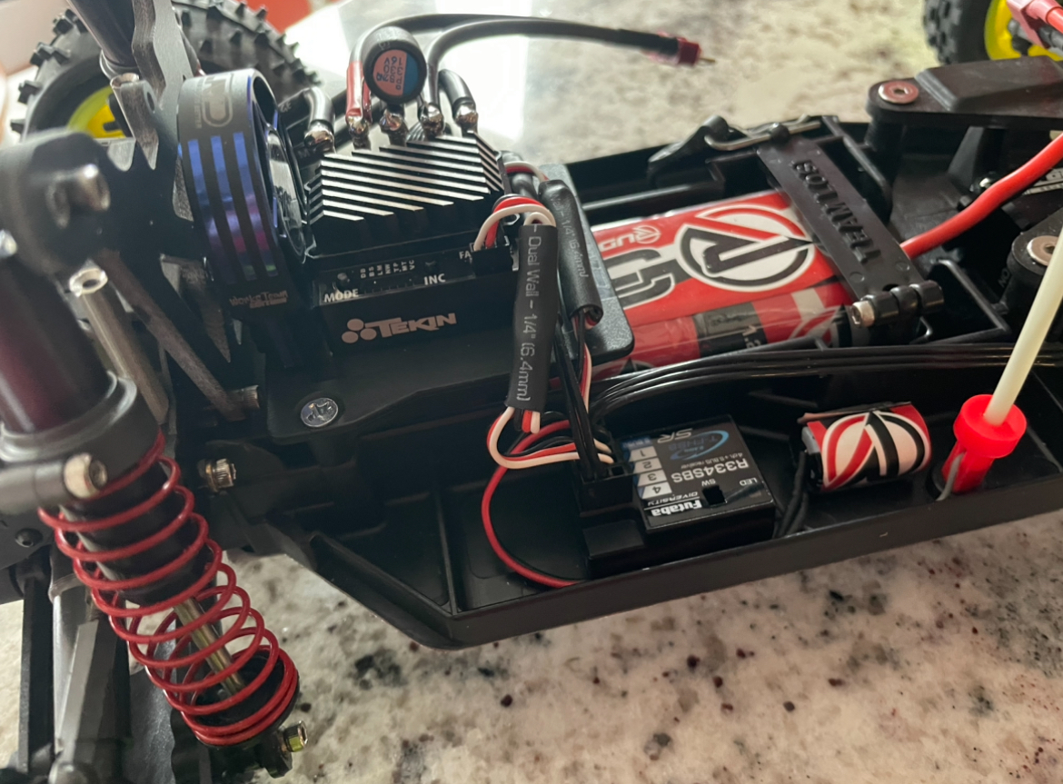

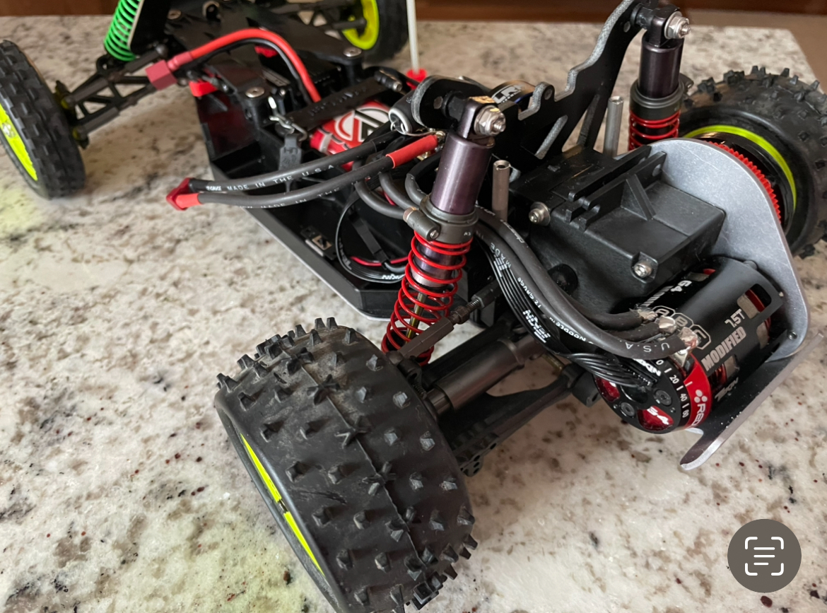

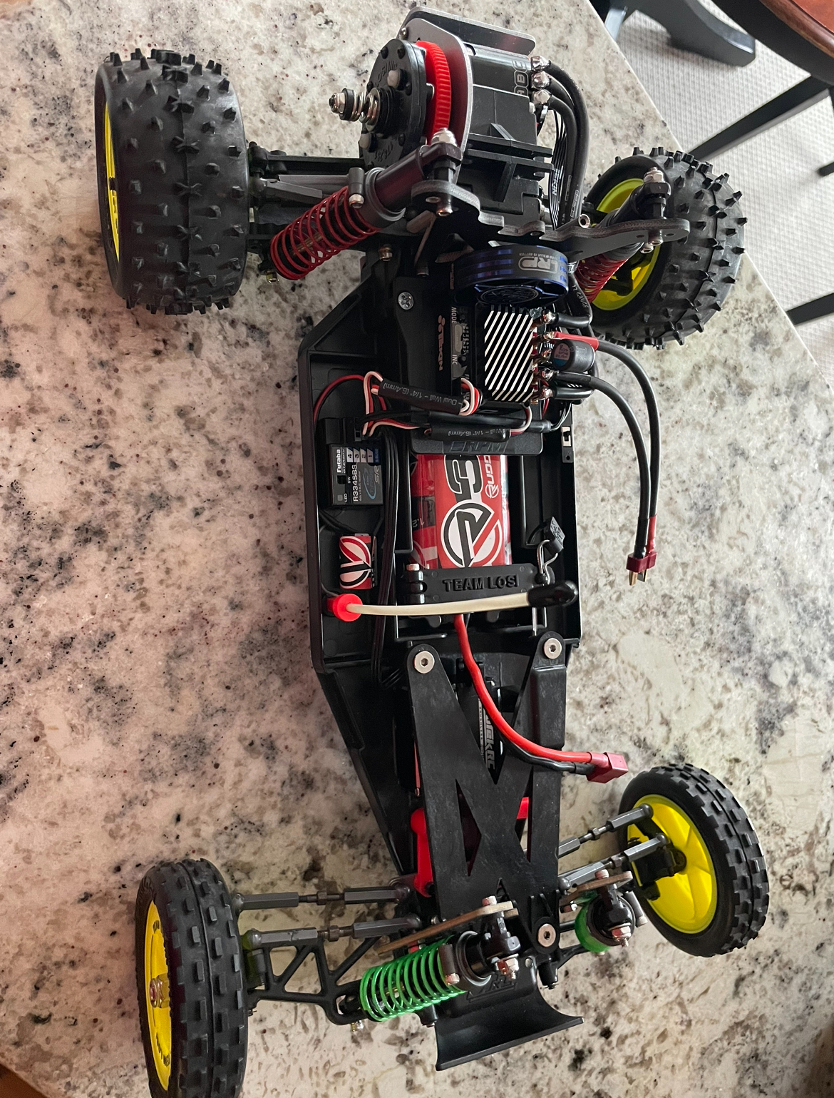

Photos of finished electronics. Tekin RSX Pro and g4 motor combo. LRM high speed fan. Ruddog 3600mAh NiMH battery. The only battery I could find that fit properly. Added NOS RPM ESC shelf. Will be installing Jammin’ steering enhancement kit soon.
Hopefully I will also find ball bearing bellcranks and the steering servo brace kit in the future.
I know this setup is kind of a resto mod with modern bits on a vintage new chassis but I kind of like the look. At least until I find the right vintage electronics.
I chose Tekin because of its long history in competition with Novak. But truthfully I find other ESCa and motors of better quality. The Acuvance electronics I’m using
In my Yokomo MO 2.0 are much much better overall.
