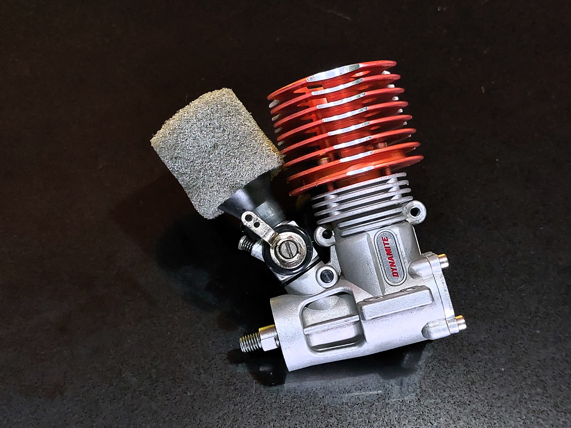

I never had one on these as I was an OS guy but they look like a great little engine.
This one came in a bulk lot of stuff and while fairly clean could still use some help.
Engine all stripped down, the sleeve was pretty stuck and I had to use a heat gun to get it out. The insides looked OK with a bit of corrosion, the rear bearing wasn't turning with the crank which was a little concerning.
Carb all pulled down, nothing looked too bad here, just dirty
Dynamite TNT .12 Overhaul

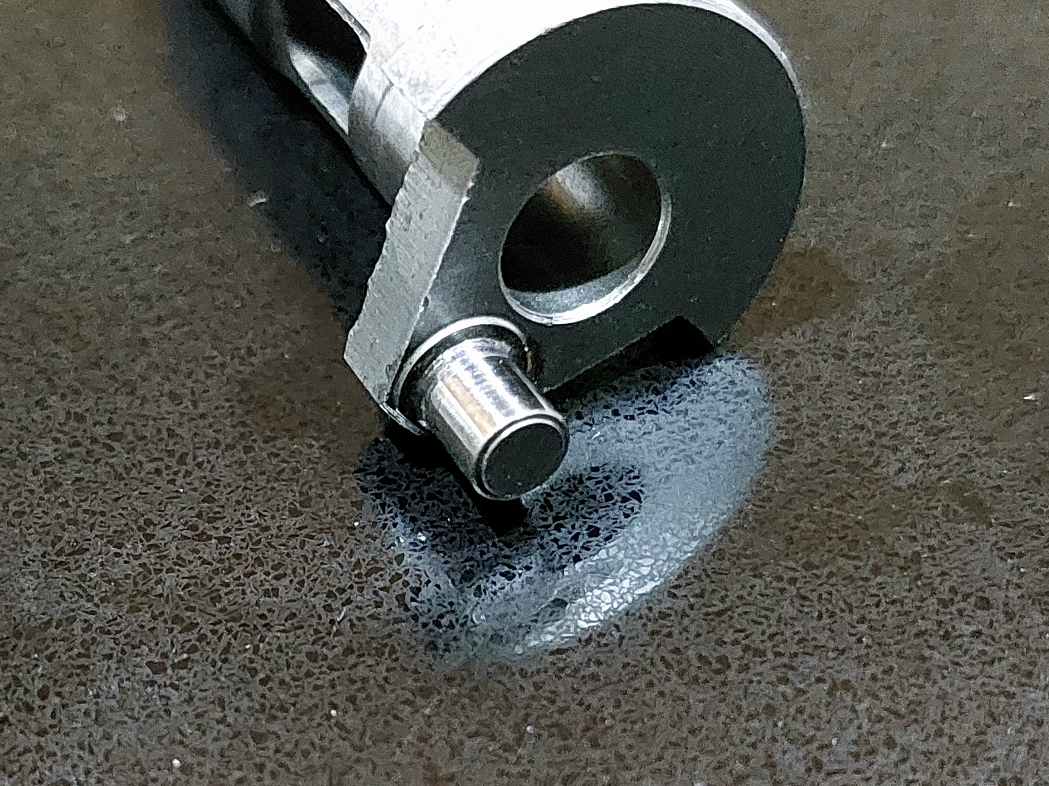

Since someone decided to pull the pullstart off and lose it I just so happened to stumble across one of these kits.
I'm surprised it came with a new crank, OS just told you to grind the starter pin off the crank. The new crank is standard length so you'd still have to cut it down.

I chose to grind the starting pin and save the crank just in case.
Before
After
Before
After
