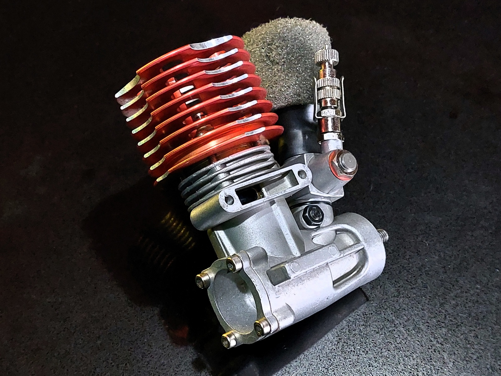

This one came in a bulk lot of stuff and while fairly clean could still use some help.

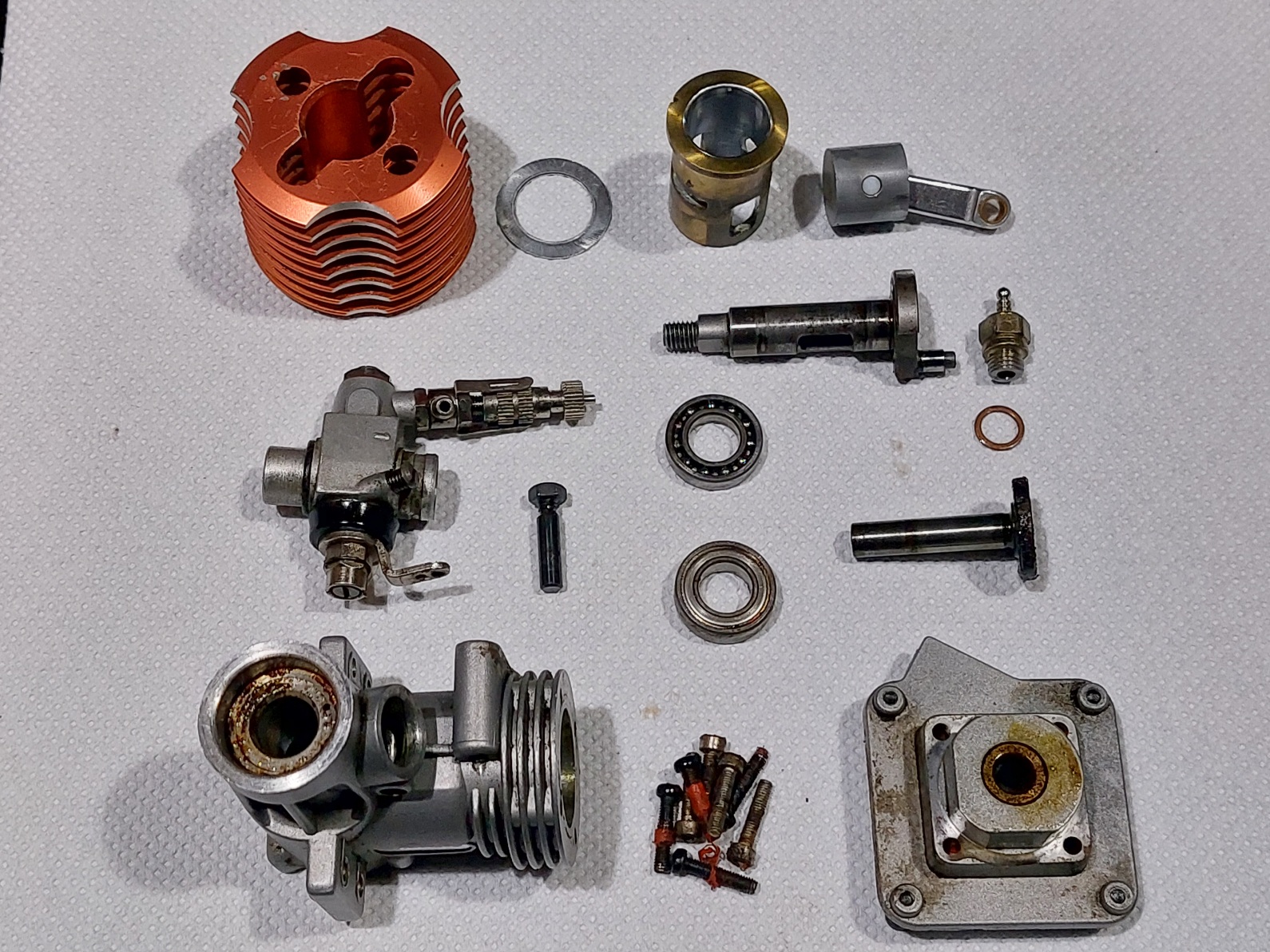

Engine all stripped down, the sleeve was pretty stuck and I had to use a heat gun to get it out. The insides looked OK with a bit of corrosion, the rear bearing wasn't turning with the crank which was a little concerning.

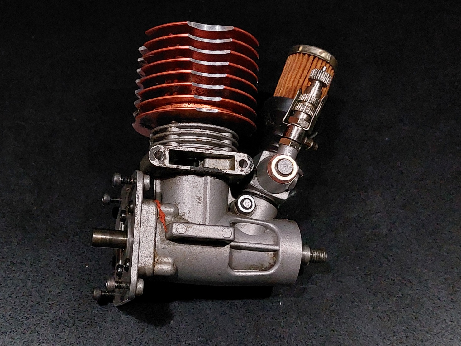

Carb all pulled down, nothing looked too bad here, just dirty

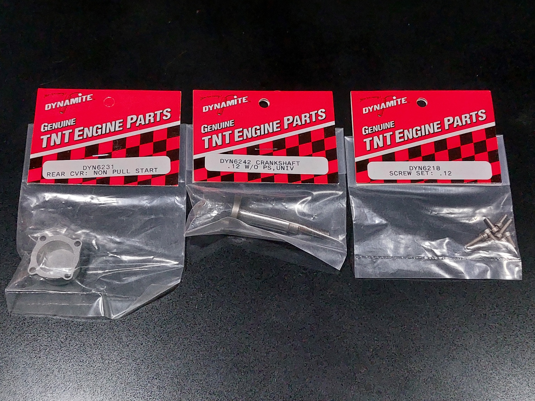

Since someone decided to pull the pullstart off and lose it I just so happened to stumble across one of these kits.

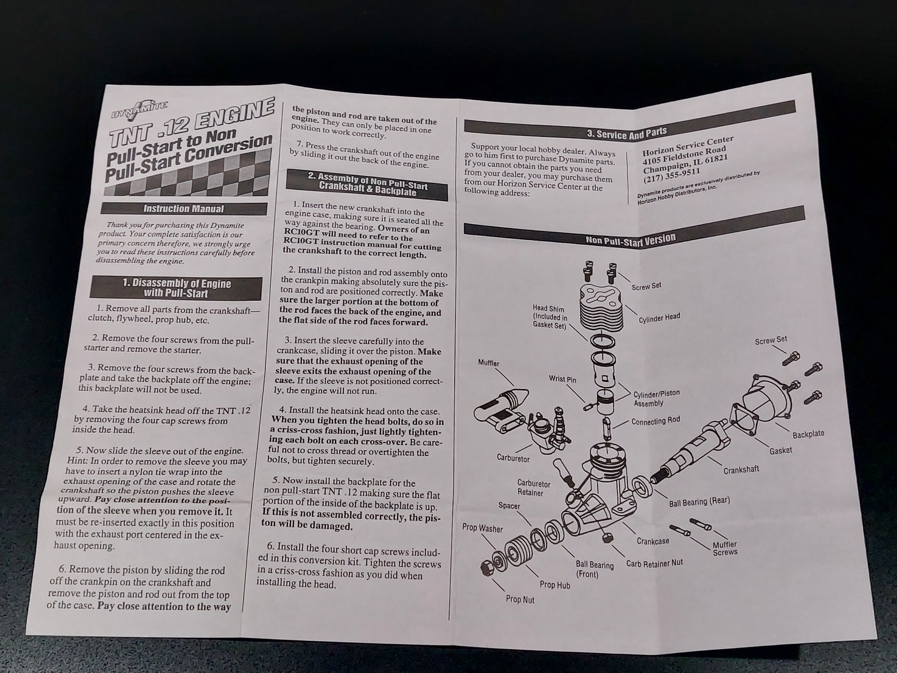

I'm surprised it came with a new crank, OS just told you to grind the starter pin off the crank. The new crank is standard length so you'd still have to cut it down.
Instructions.....

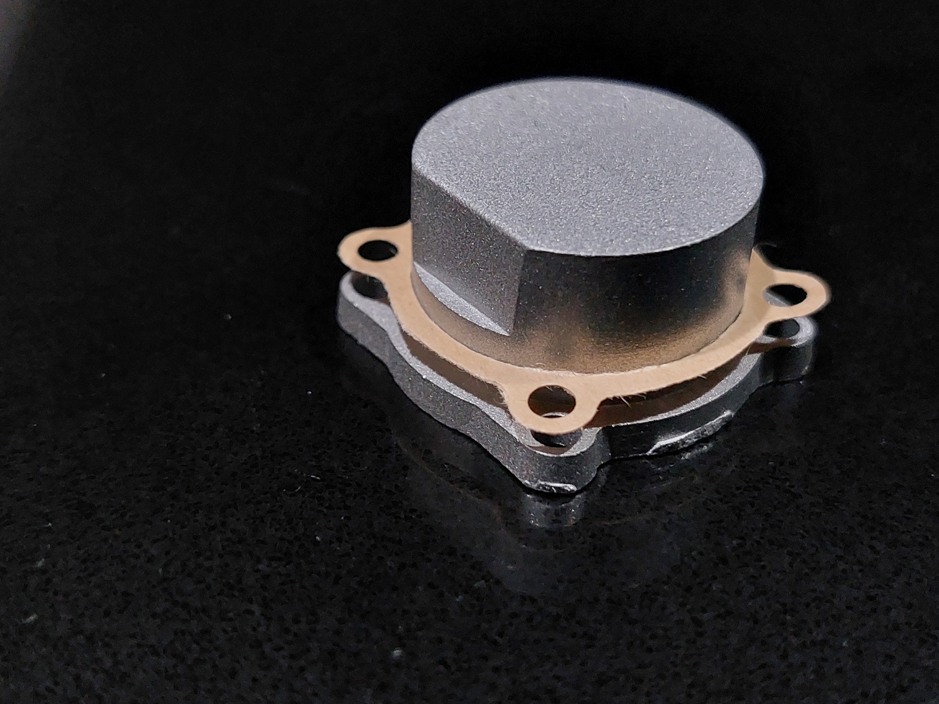

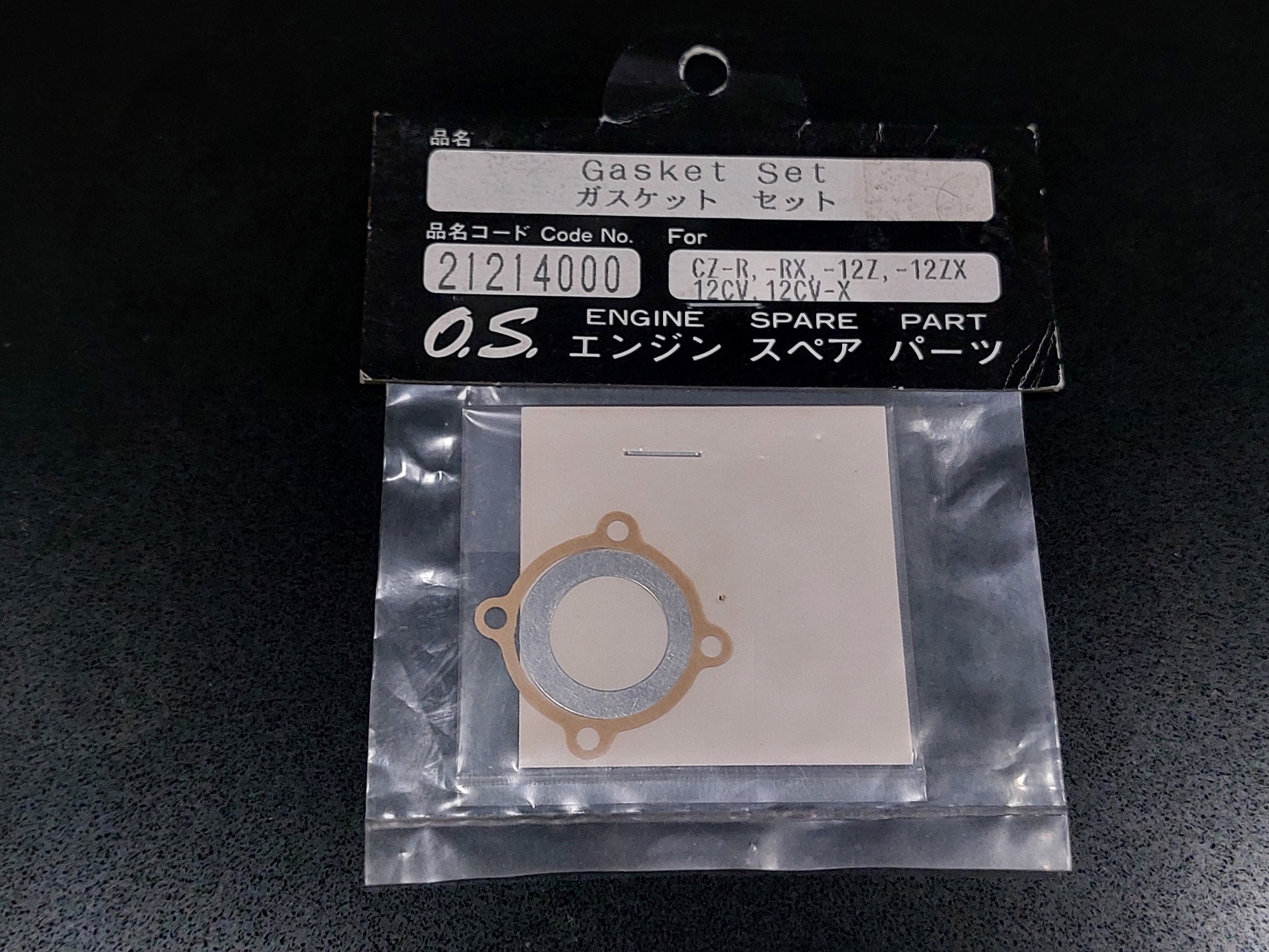

I'm a bit surprised the kit didn't include a new back plate gasket which is the most fragile thing in the whole engine. Mine was stuffed anyways so I had to dig out an OS gasket set. Luckily they are pretty much the same.
Fits perfect

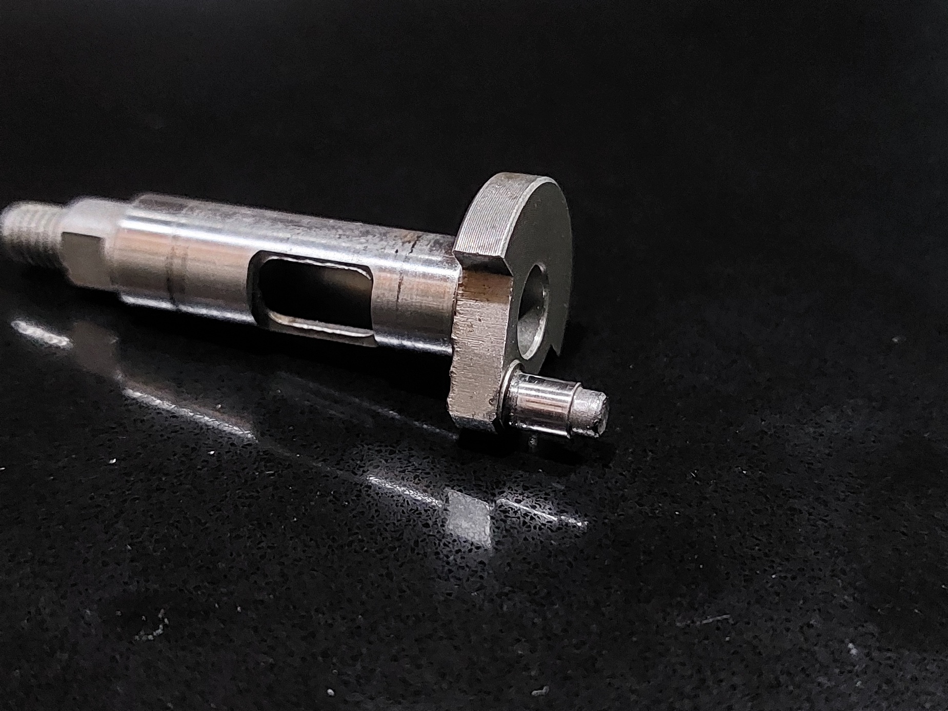

I chose to grind the starting pin and save the crank just in case.
Before
After
Before
After
