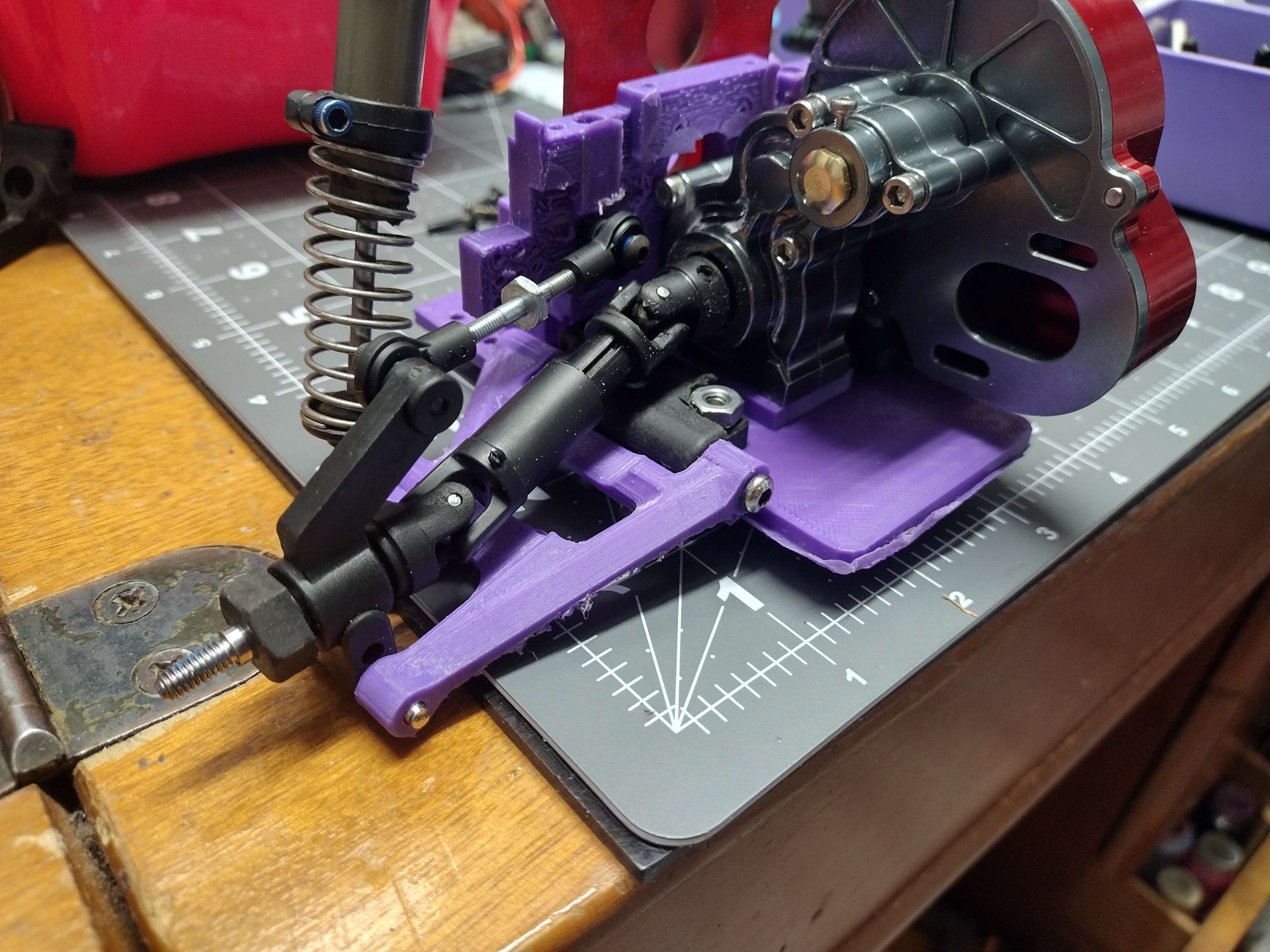

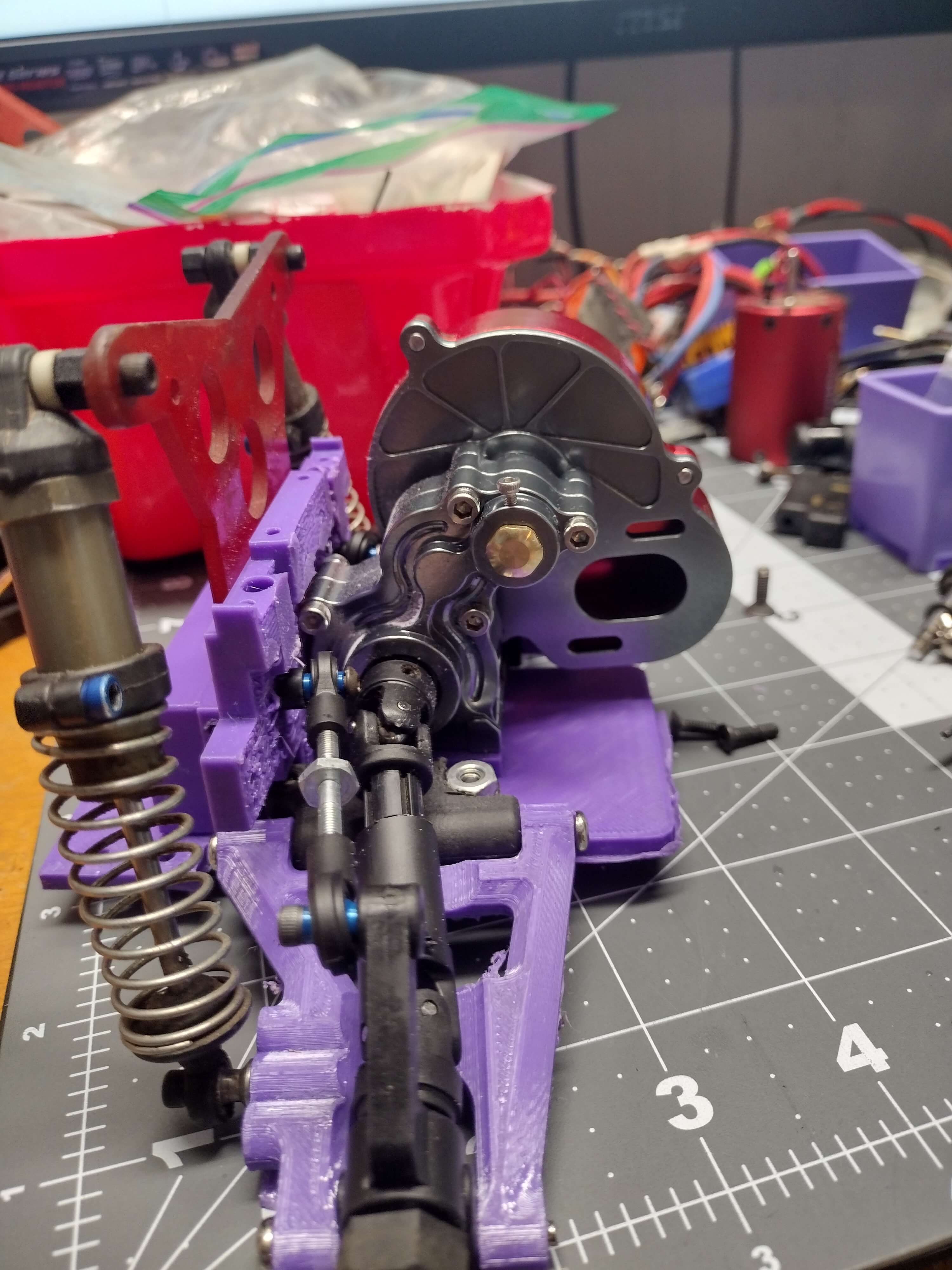

well making progress on building one with a diffless transmission lol .at 17$ for the complete trans its pretty tempting even with no diff .

good to know . a bunch of the members on the fb page are screaming "no diff" like its a big deal lol . it will steer like crap but as you said its a basher for my son he is 7 and could care less lol. people forget they used to run old new bright toys as a kid that had 0 suspension, and a straight drive axle lol and loved every second

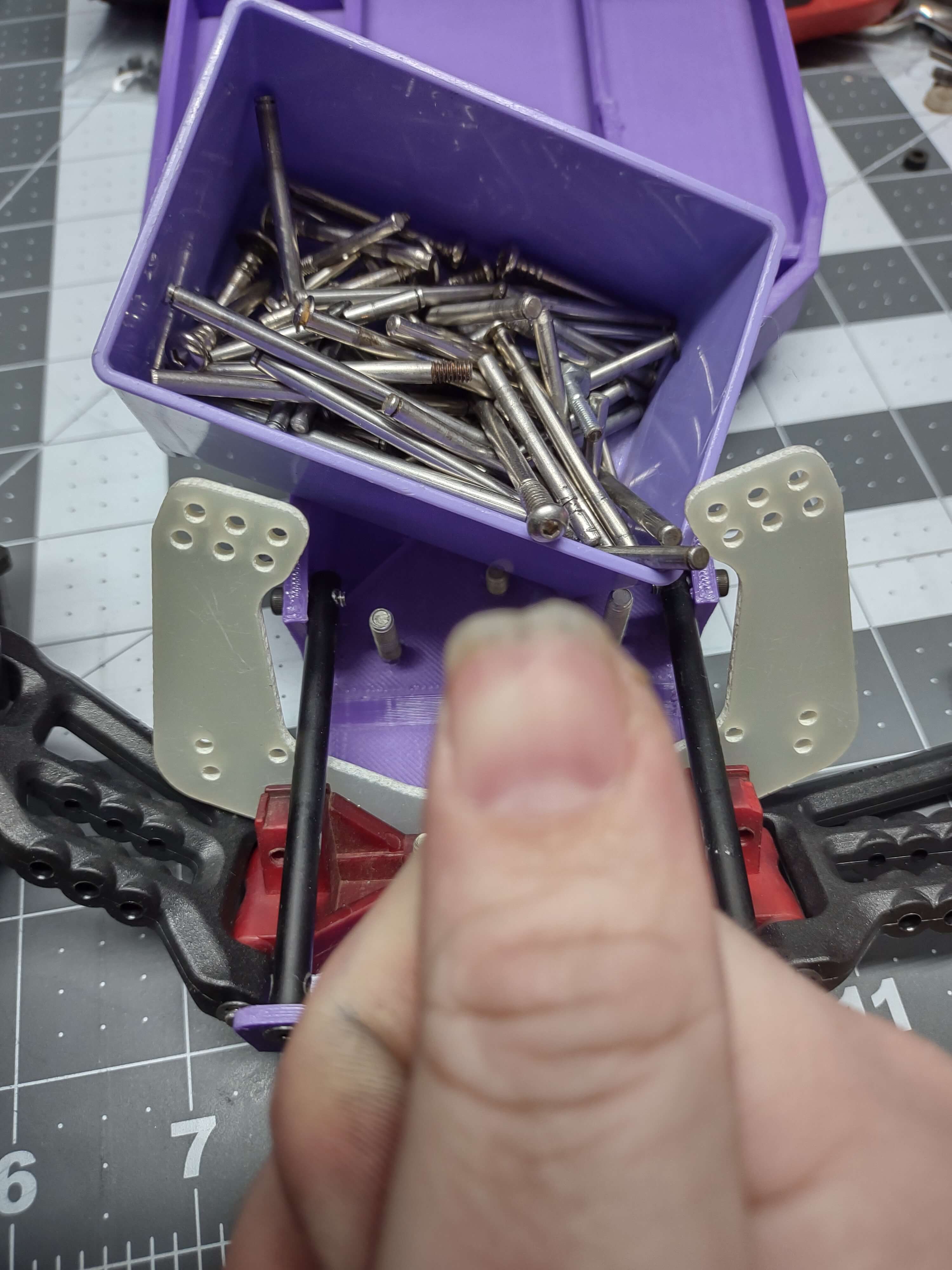

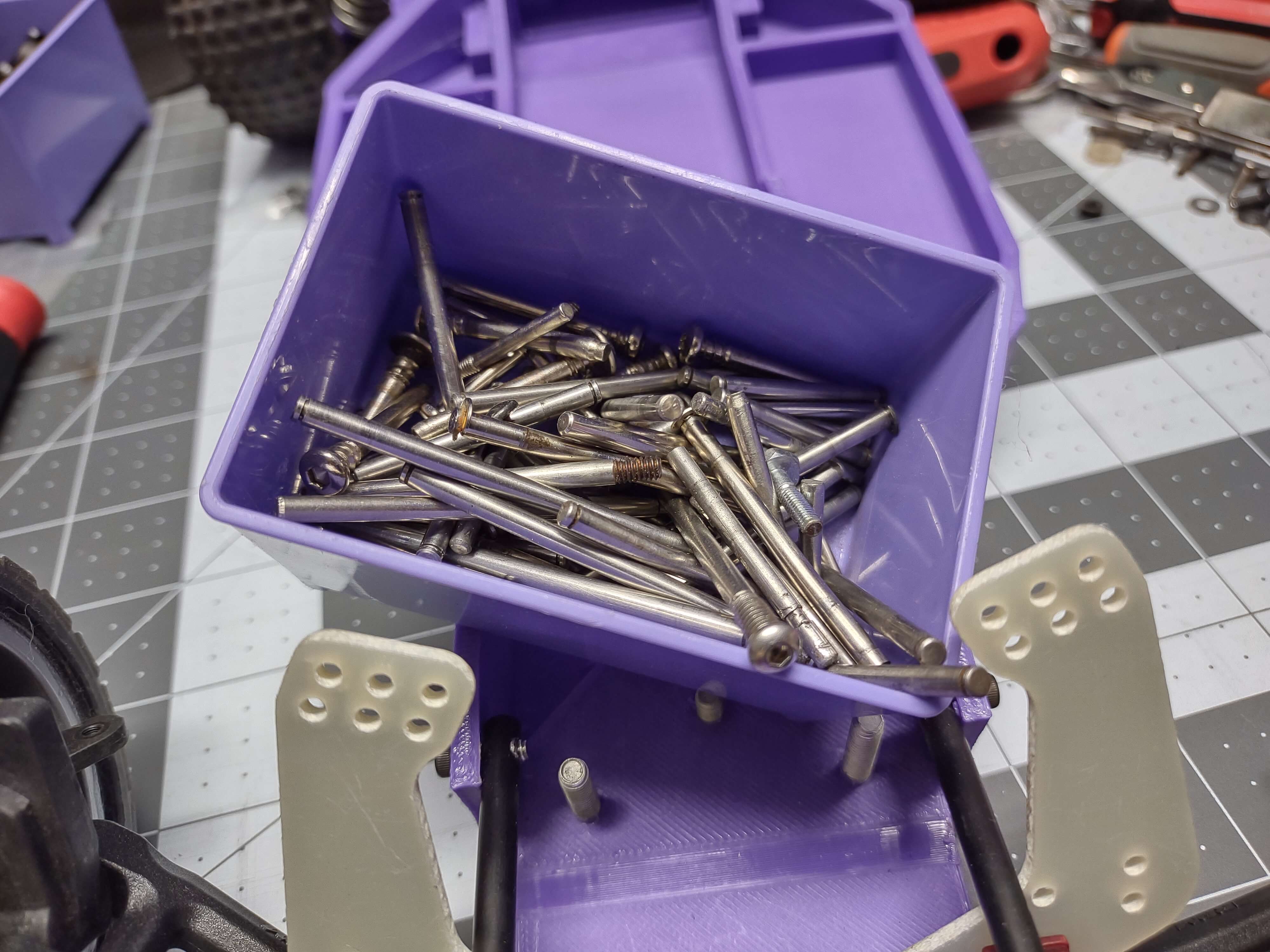

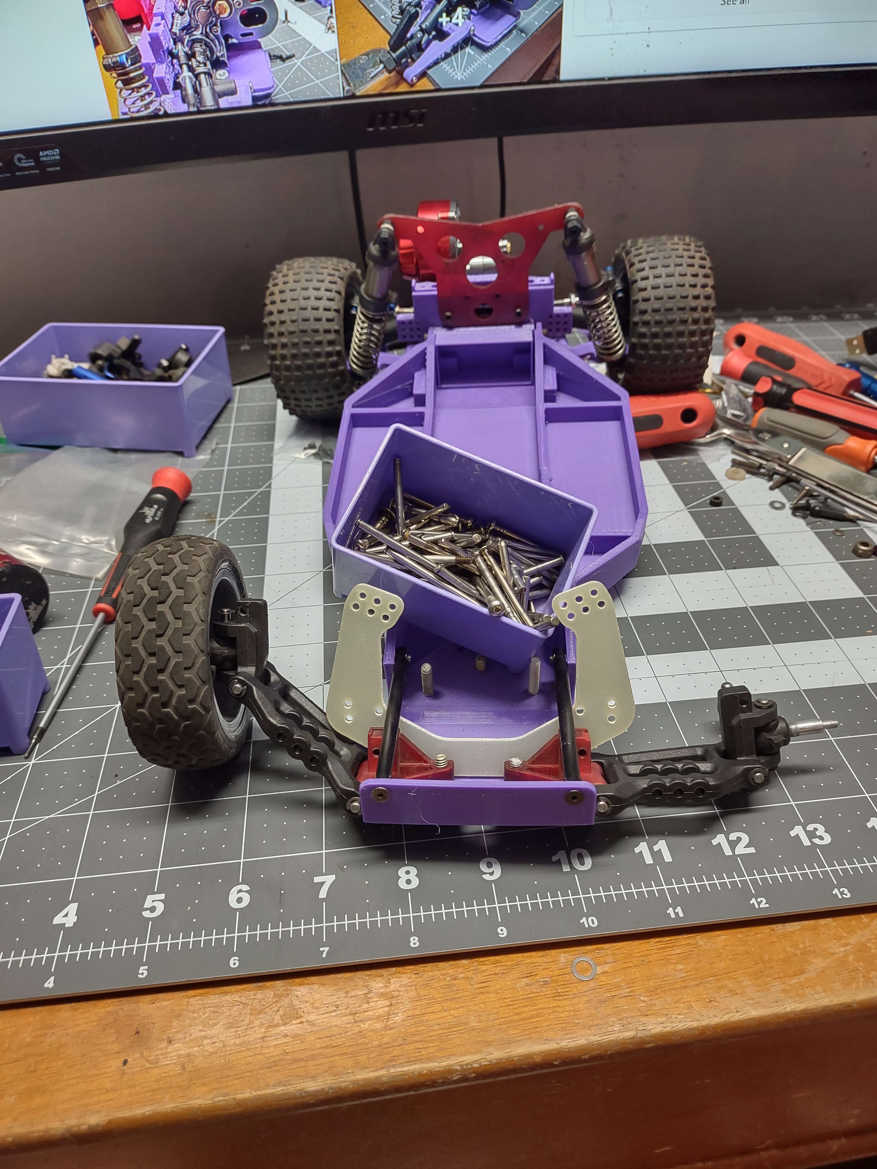

made some progress on the front end . my fingers hurs from installing 3 cars worth of hinge pins over tha past week lol , have a groove in my nail lol
looks like i can get at least 3 or 4 more set out of my hinge pin stash

saw your videos on fb. This is AWESOME! how much of the car is printed vs parts you have or are buying? Are the print files something you created or freely available online? i searched for just a min but didnt find any type of print file but i know nothing of 3d printing.

sbednara wrote: Tue Mar 26, 2024 9:19 pm saw your videos on fb. This is AWESOME! how much of the car is printed vs parts you have or are buying? Are the print files something you created or freely available online? i searched for just a min but didnt find any type of print file but i know nothing of 3d printing.
The video of the scx10 transmission. it looked like it was a success. Im interested to hear how the 2wdtraxxas transmission works now.

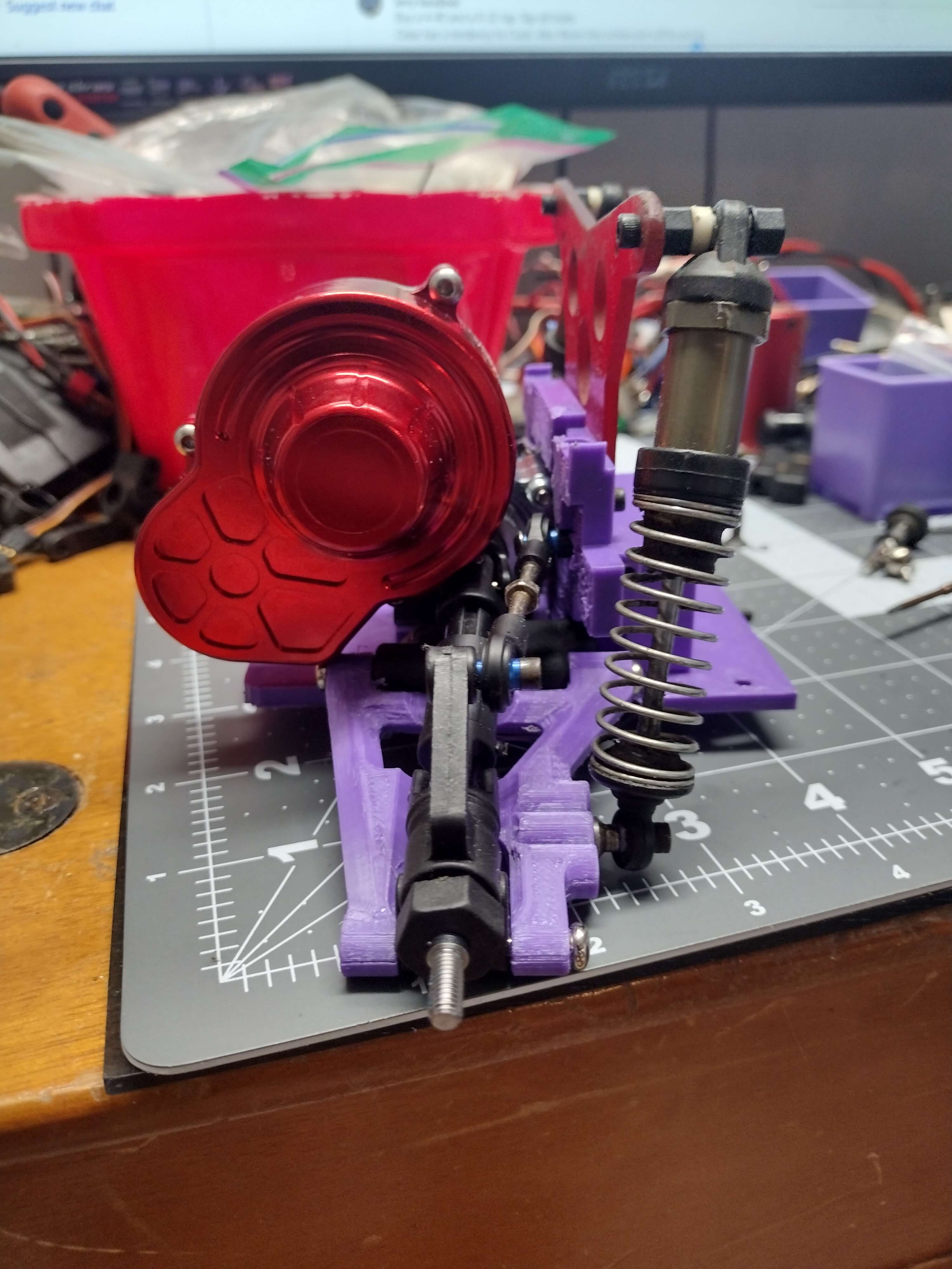

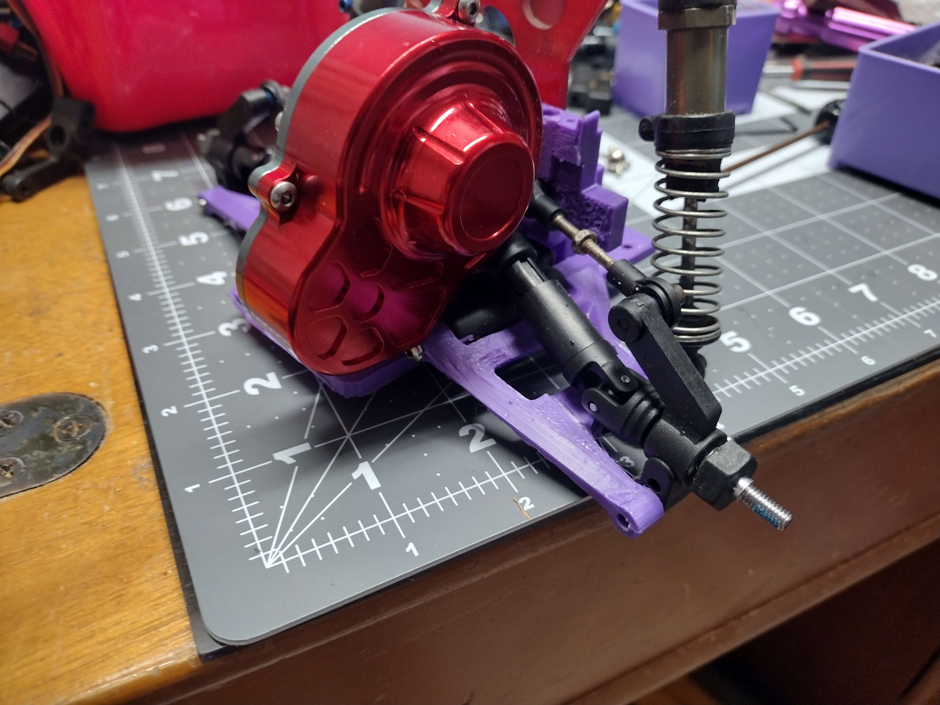

thanks
i did not create the files but i did modify the chassis it was wrong in the rear and needed material removed to fit the rear arms(even stock)
here is my thingiverse with some revisions of the chassis , and a few supporting parts . https://www.thingiverse.com/thing:6532318
this is the one I'm doing now
it is using a rc10gt transmission with a electric conversion kit and i drilled the top so i could install the top shaft the opposite direction.
when i went and bought paint today i also got the rest of the parts i needed to build out a trx 2wd gearbox soo once i finish the gt ,im ready to go for a trx lol

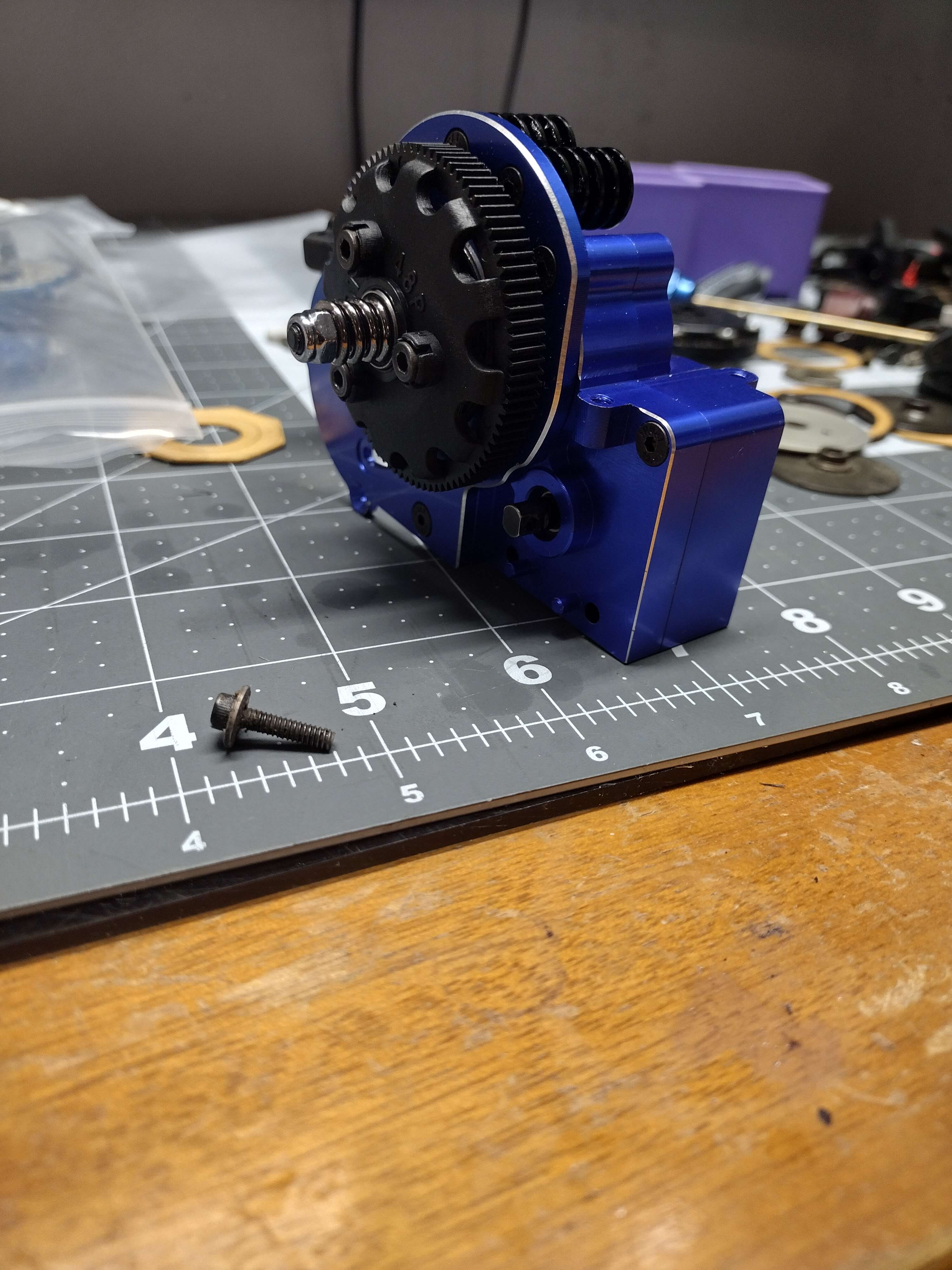

EDIT: The Stealth diff gear is much smaller tooth count so no chance replacing it with a TA06. Anyway, curiosity got the best of me and I've opened the BBX and Injora cases and discovered the diffs are interchangeable after swapping out the bearings; Injora requires 16x8 while BBX uses 15x10 (easily sourced). But there's a problem. With bearings, the BBX diff assembly is maybe a couple mm's wider than the Injora so it won't allow the case halves to close. :?

got the rear transmission brace sorted out for using a rc10gt gearbox

discgolfer72 wrote: Thu Apr 04, 2024 2:29 pm got the rear transmission brace sorted out for using a rc10gt gearbox
That's awesome, well done.
Me thinks you might need a wheelie bar. :D
