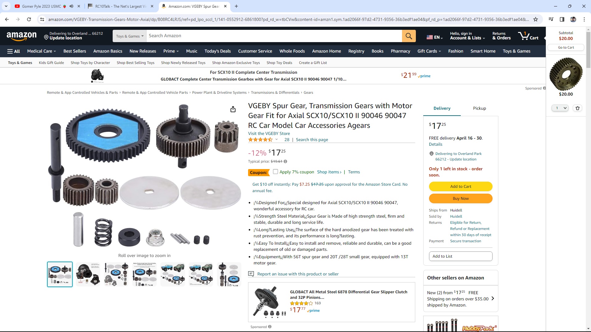

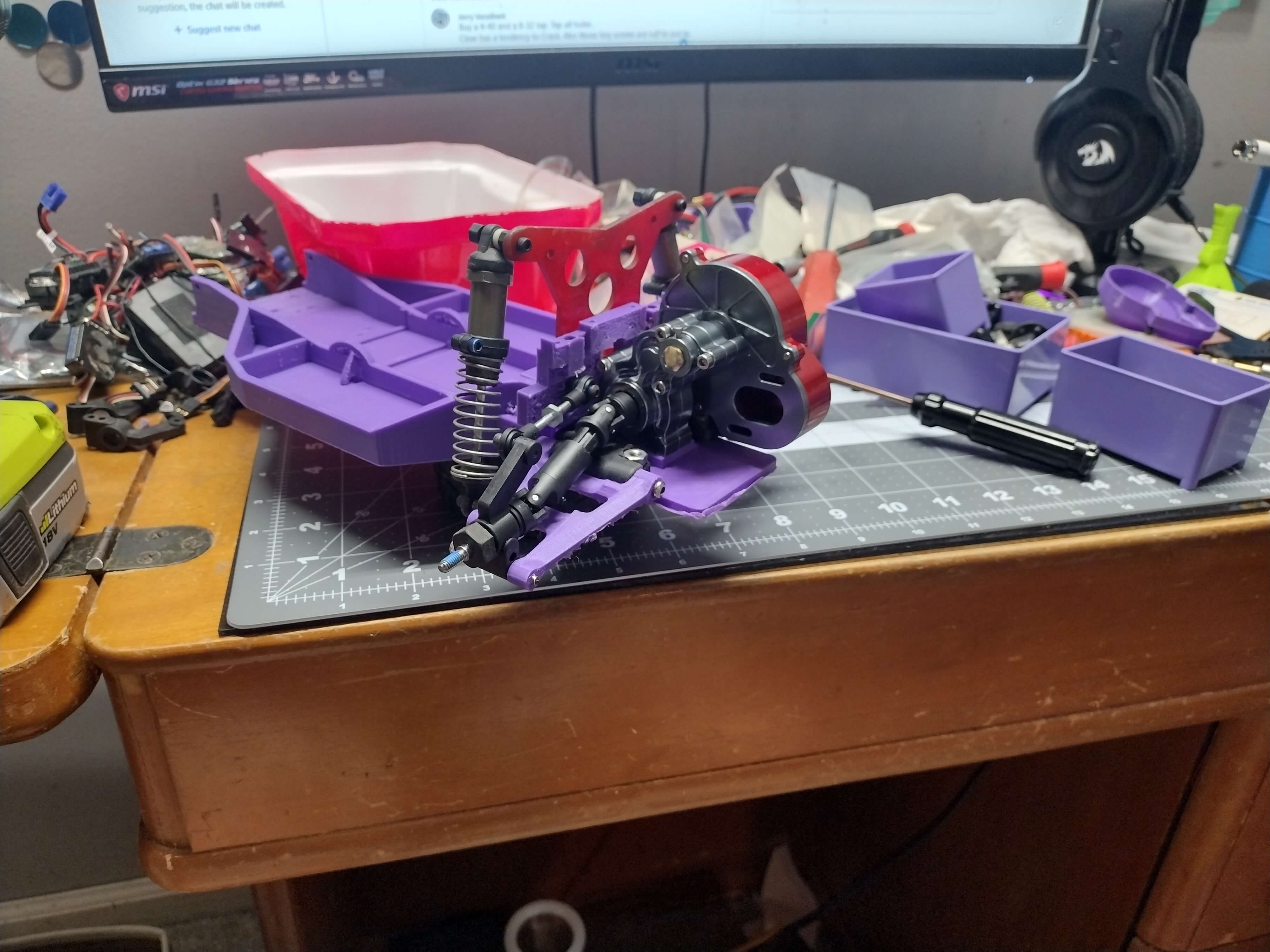

well making progress on building one with a diffless transmission lol .at 17$ for the complete trans its pretty tempting even with no diff .

I modified an old gold pan to use with one of the Injora transmissions. For a basher, I don't have any complaints.

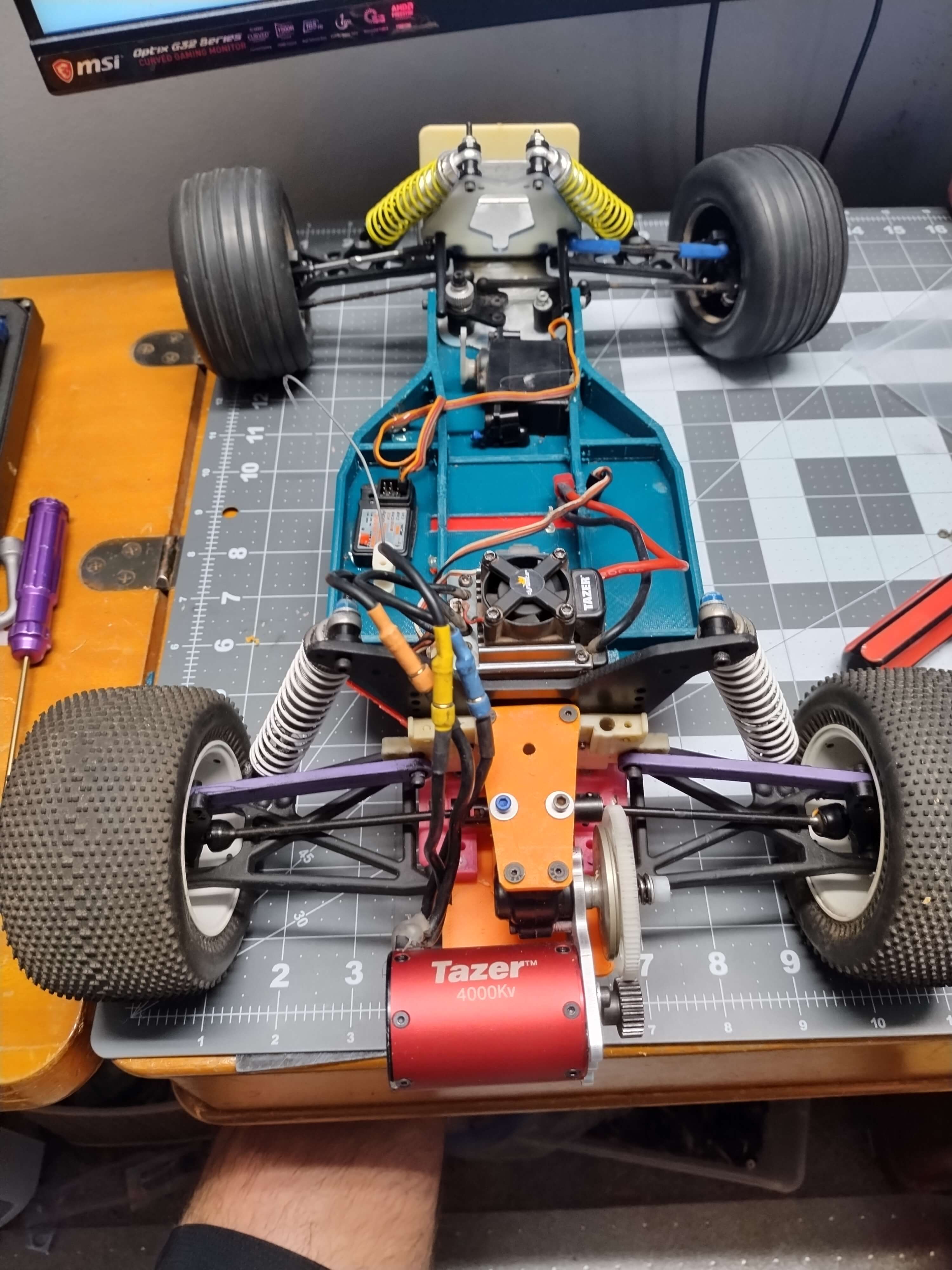

good to know . a bunch of the members on the fb page are screaming "no diff" like its a big deal lol . it will steer like crap but as you said its a basher for my son he is 7 and could care less lol. people forget they used to run old new bright toys as a kid that had 0 suspension, and a straight drive axle lol and loved every second
made some progress on the front end . my fingers hurs from installing 3 cars worth of hinge pins over tha past week lol , have a groove in my nail lol
looks like i can get at least 3 or 4 more set out of my hinge pin stash

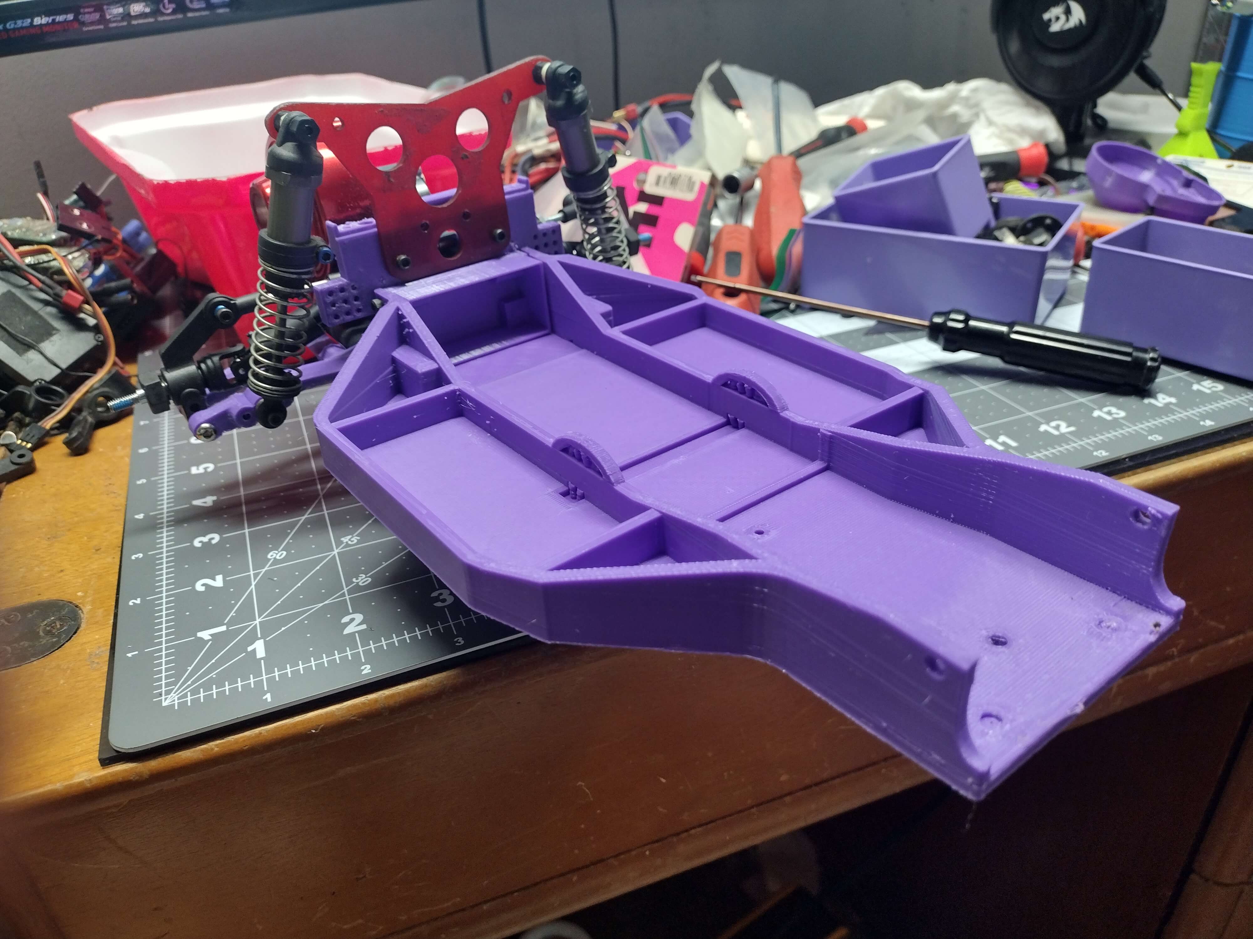

i did not create the files but i did modify the chassis it was wrong in the rear and needed material removed to fit the rear arms(even stock)
here is my thingiverse with some revisions of the chassis , and a few supporting parts . https://www.thingiverse.com/thing:6532318

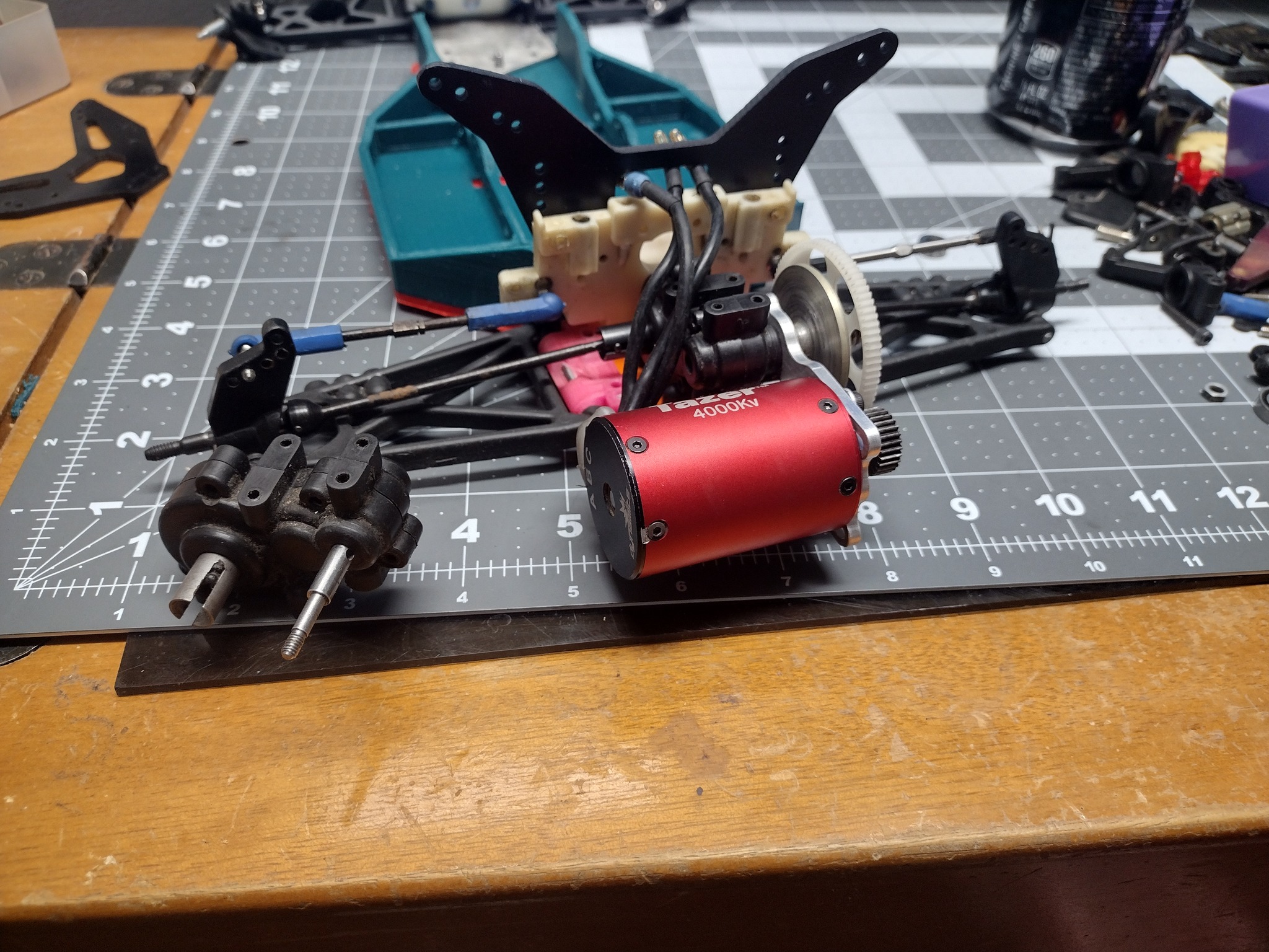

this is the one I'm doing now
it is using a rc10gt transmission with a electric conversion kit and i drilled the top so i could install the top shaft the opposite direction.
when i went and bought paint today i also got the rest of the parts i needed to build out a trx 2wd gearbox soo once i finish the gt ,im ready to go for a trx lol

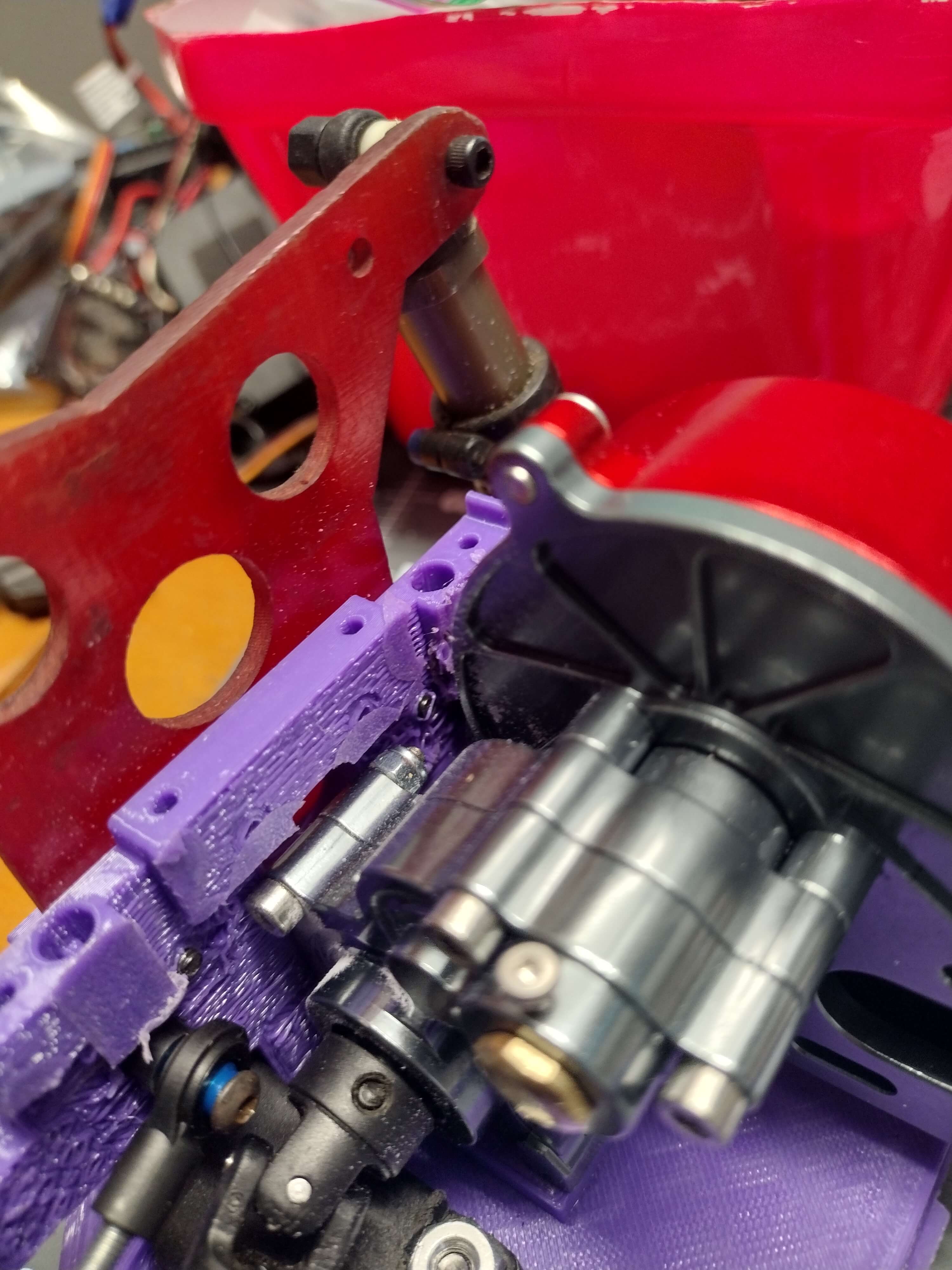

someone chimed in on the fakebook page and said you can use the tamiya hbx diff but you have replace the bearings (they have standard dogbone style outdrives). this should be th e gear set for the scx10 gearbox
looking at this one it has screws to remove the outdrives im sure its could retrofit a ball diff setup

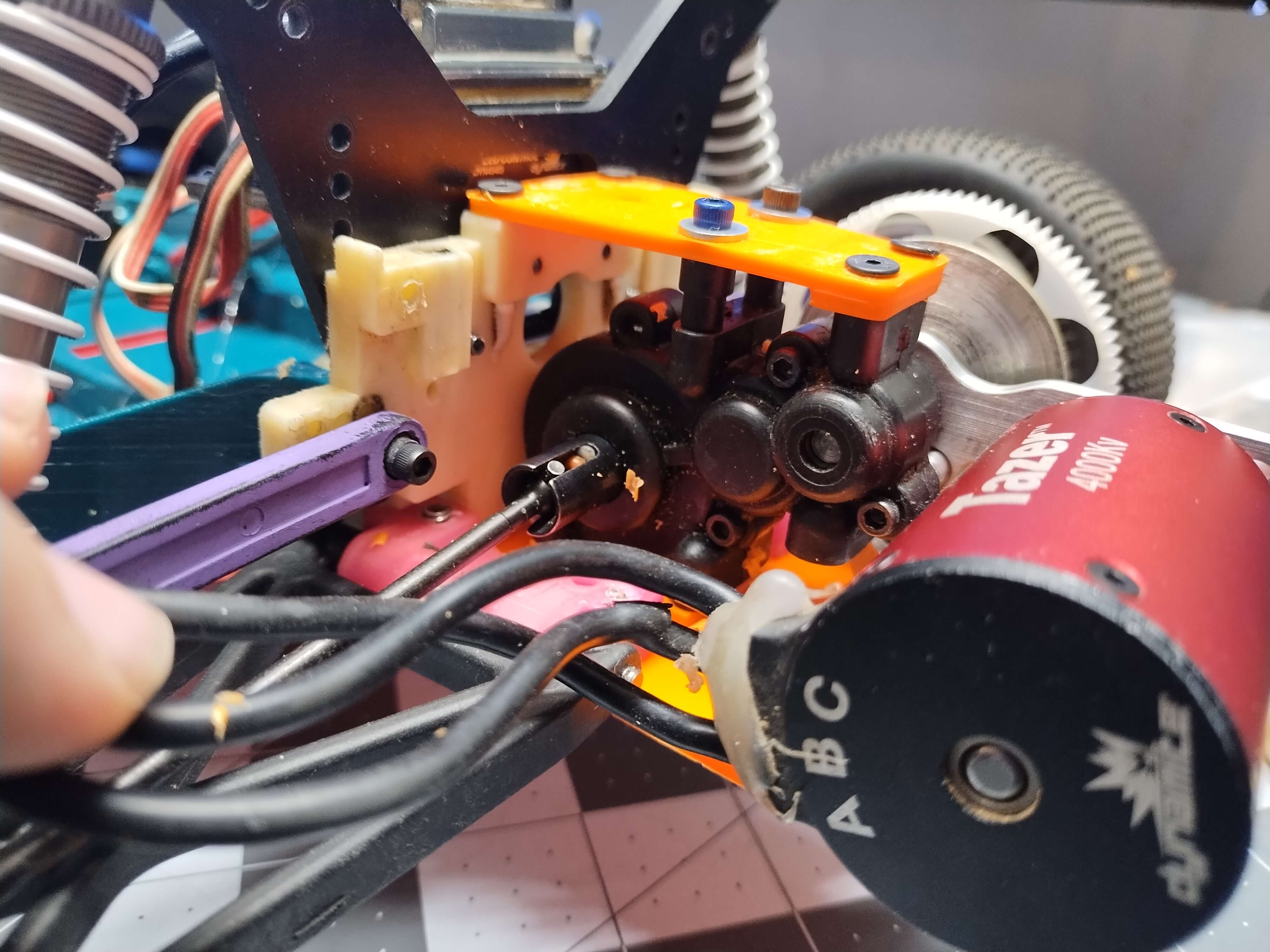

got the rear transmission brace sorted out for using a rc10gt gearbox
