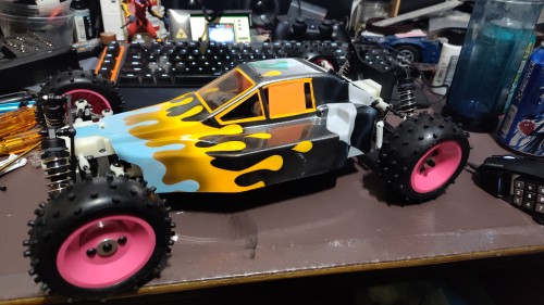

I like what youve done. Does the shock towers fit without any trimming? Are the screw pattern identical on rere vs "original"?JohnE wrote: ↑Wed Jan 31, 2024 9:09 am Chipping away at mine
I have a 89 worlds conversion kit that I got from Fan RC that I am using on it, most of it fits after I re-drilled the chassis using the new one as a template. if you go this route make sure you have a dremel tool! it isn't pretty but who cares since this car has undertray
the dogbone length is funky, normally the kit uses the 422 length which is too long for the re-re diffs so I ordered a set of 421s.
870c ReRe?

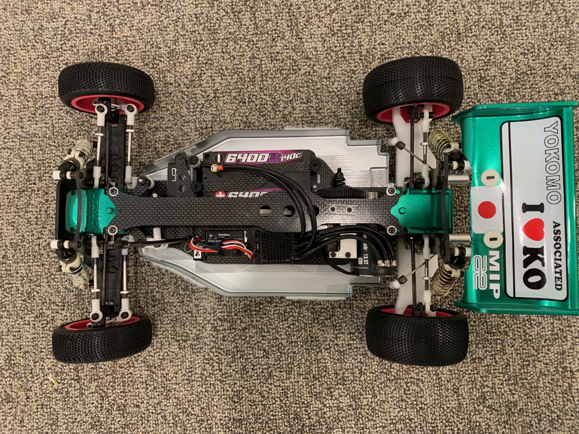

Loving the 89 conversions. @gomachv is that chassis brace available on factory works and will it work and the standard re chassis? Is that a turnigy servo? Seems the servo arm and 20mm is a bit long what length did you shorten to dial in the steering?
For a shock swap what lengths are you running?

It's the Protech version. I think Boki or Sabulatech repops them. Here's mine.

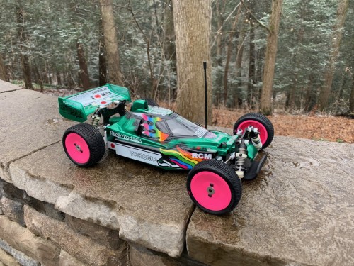

I had to grind the rear tower a bit to clear the sway bar, the front was fine. I did drill new holes for the camber links since I was playing around with different lengths and angles. The holes for the shocks were fine but I drilled new ones for the wing mounts. I didn't bother with the kit shocks, I just put the AE style ones one.sandkil wrote: ↑Wed Mar 06, 2024 4:20 amI like what youve done. Does the shock towers fit without any trimming? Are the screw pattern identical on rere vs "original"?JohnE wrote: ↑Wed Jan 31, 2024 9:09 am Chipping away at mine

Are these chassis set available from Factory Works? I dont see it on your website or Ebay. Id rather just convert it to match my already done 89 Masami.
