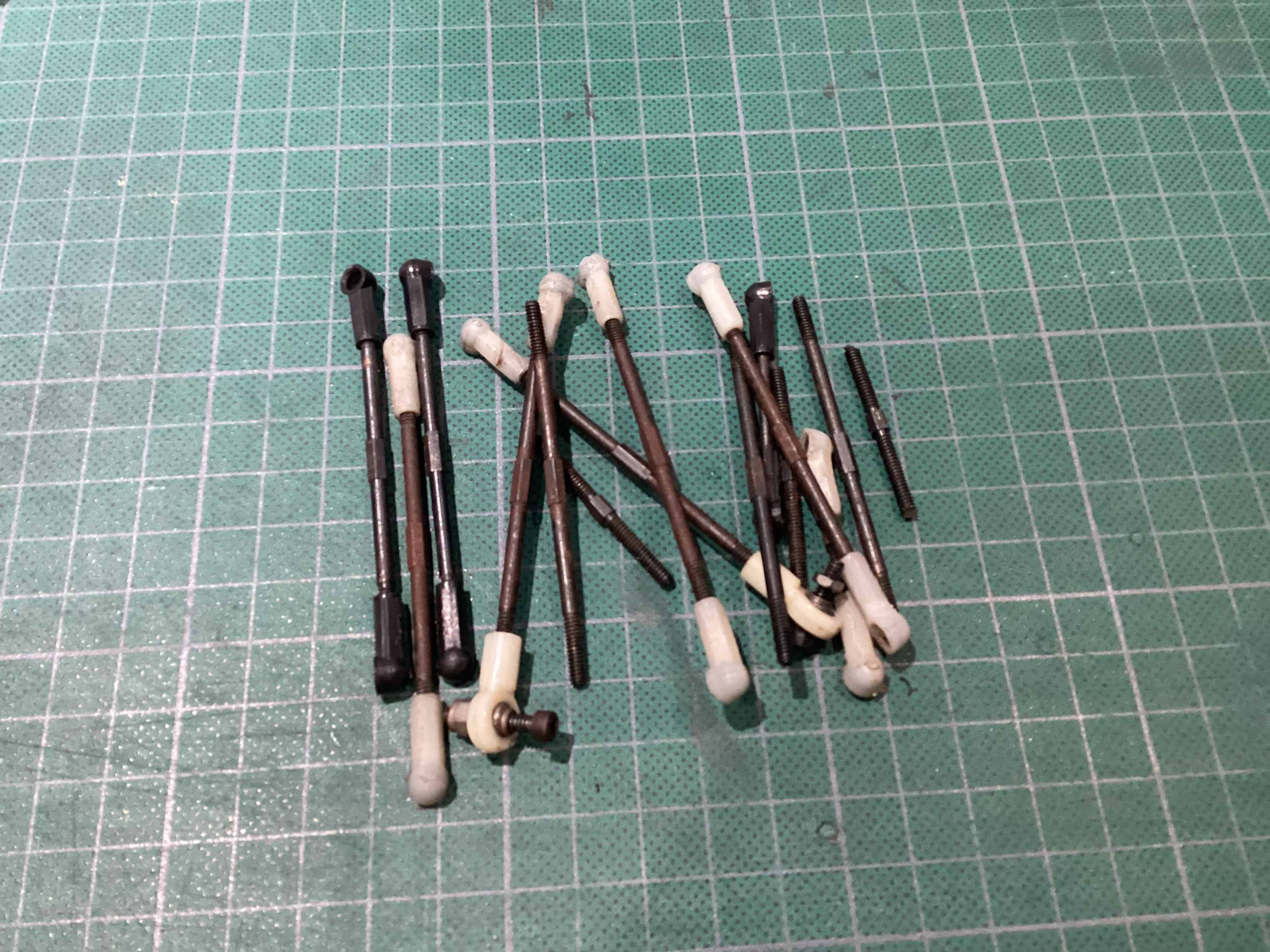

Let’s see if we can save some of these rusty turnbuckles.
Sanded down and then wiped down with acetone
Four applications of Cold Blue using a q-tip
Dumped and wiped down with veggie oil and will be left overnight

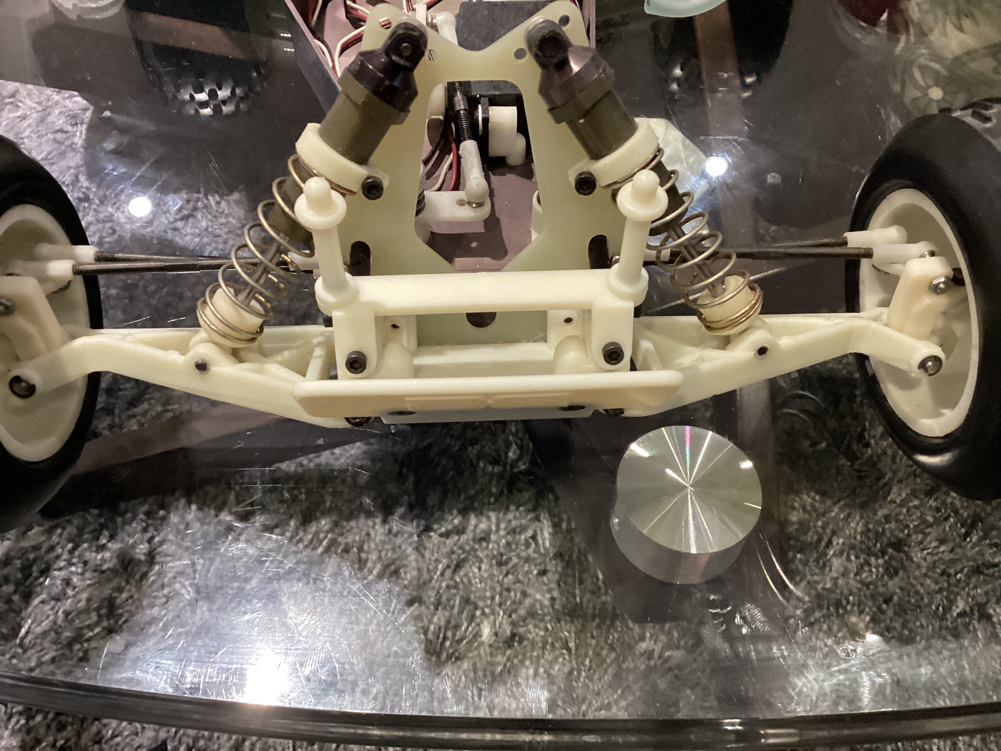

Post by Toaster »
Just a quick one cleaning up the front shocks (replacing the gold pistons with standard steel), replacing front springs and shifting the blues to the back, just to get a little closer to the box art version etc. but this will never be a box art, more of a tribute lol finishing up the steering,as well.

Re: Winter Budget Beater RC10EGT
Post by Chewbacca »
In that last picture I was going to ask if you mixed up left and right front arms. Those “upside down” wishbones had me thrown off. The shock mount clarified it for me.
Beautiful build btw! 👍
