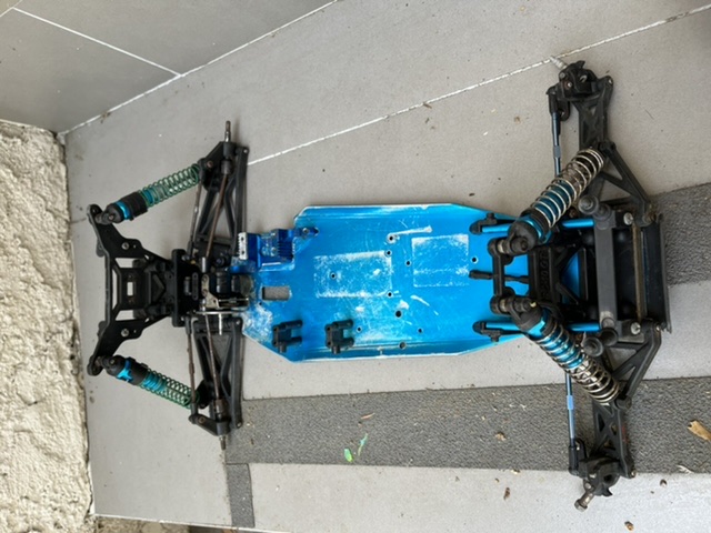

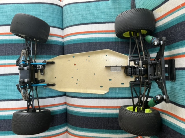

This started as a very inexpensive purchase. I decided to keep it that way but not investing a ton of parts.
It was a challenging disassemble. There was a lot of superglue. I just drilled and tapped what I could.
This was the first Grenaded diff I’d ever seen. The diff ring shattered and launched though the diff gear into the spur. Crazy enough the diff was functional.
The diff gear and a new rear arm mount were the only parts I added.
To keep the cost down I’m going to cut my own motor mount. Right now the template is on the car to prove the fit.

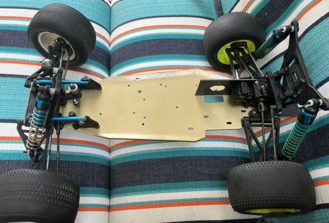

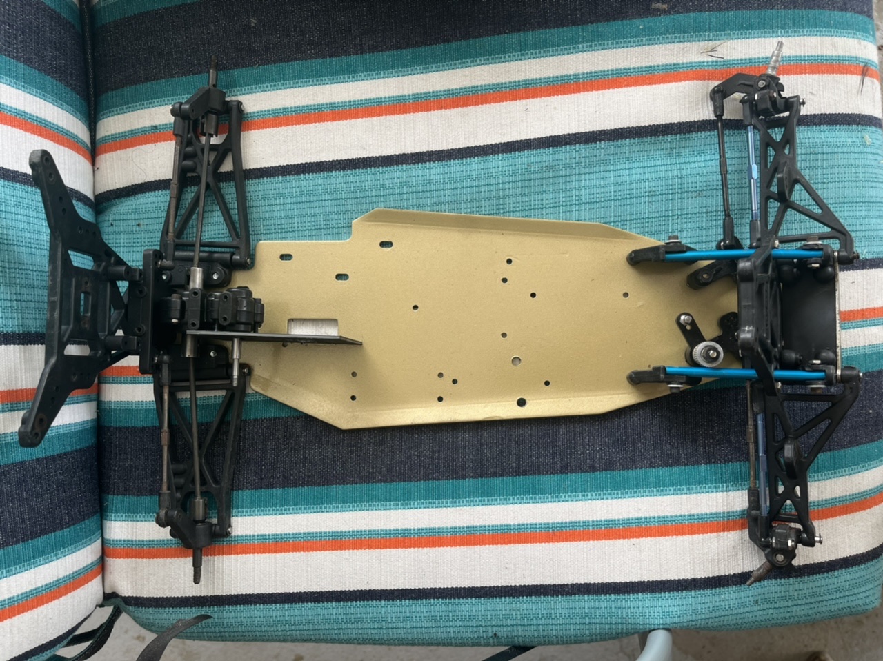

mikea96 wrote: Sun Jul 31, 2022 5:54 pm Very cool! Is that chassis painted?
Yes the chassis is just painted. I deanodozed it and spent a few minutes grinding out some of the big scratches.
The kids wanted gold and I already had a can I used for something else. I like the way it looks.
I also polished up and blue’d the steel.

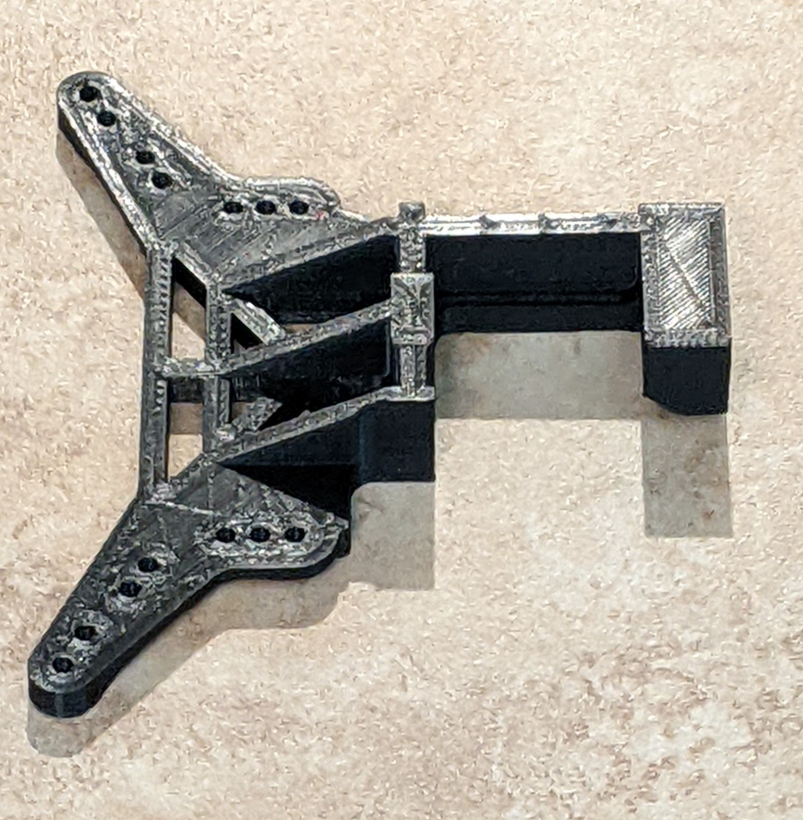

JosephS wrote: Thu Aug 04, 2022 3:25 pm I am going to try and heat up an existing t4 body I have and see if I can stretch out a location for the rear shock mounts.
I think that Frankentruck has a shock tower that fits more like a 10T that might work.
I'm using a JConcepts T5M body on mine.
Posts: 3808
Has thanked: 2604 times
Been thanked: 2977 times
Re: Quick and easy rc10eGt
I do have a 'forward of gearbox' rear shock tower. It will allow use of a T/T2/T3 body. It you want to use a T4 body, I have an adapter that works for the front mount on an RC10T that might work on the GT too.

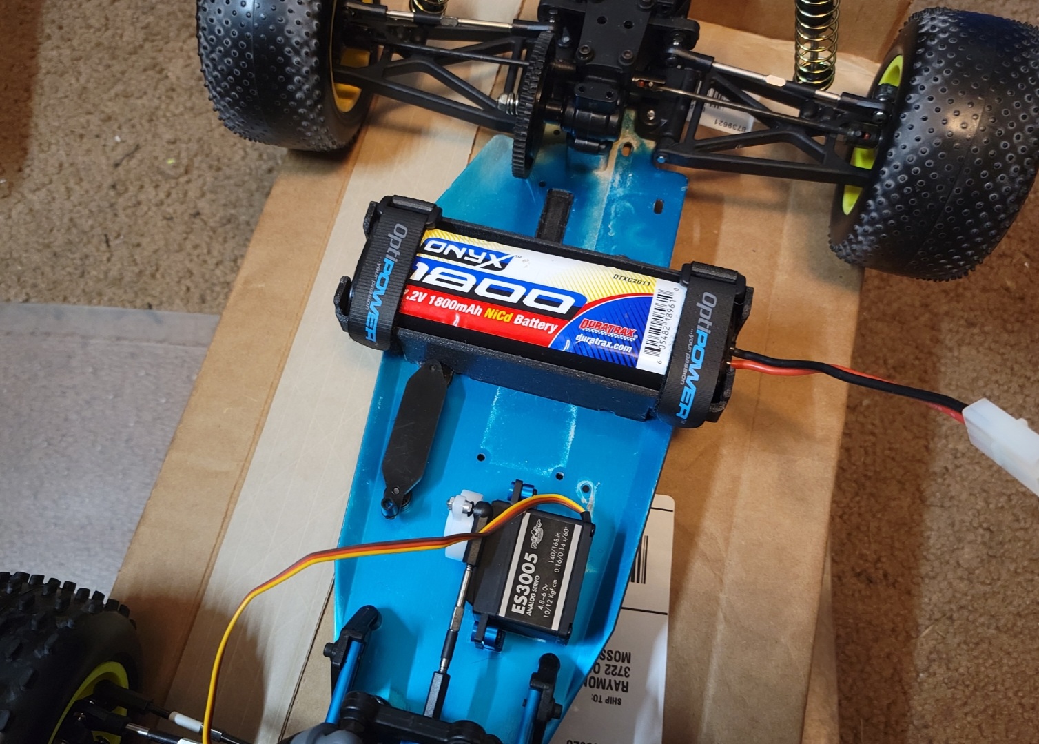

Frankentruck also made this battery holder for stick packs. Those are 16X190 battery straps.

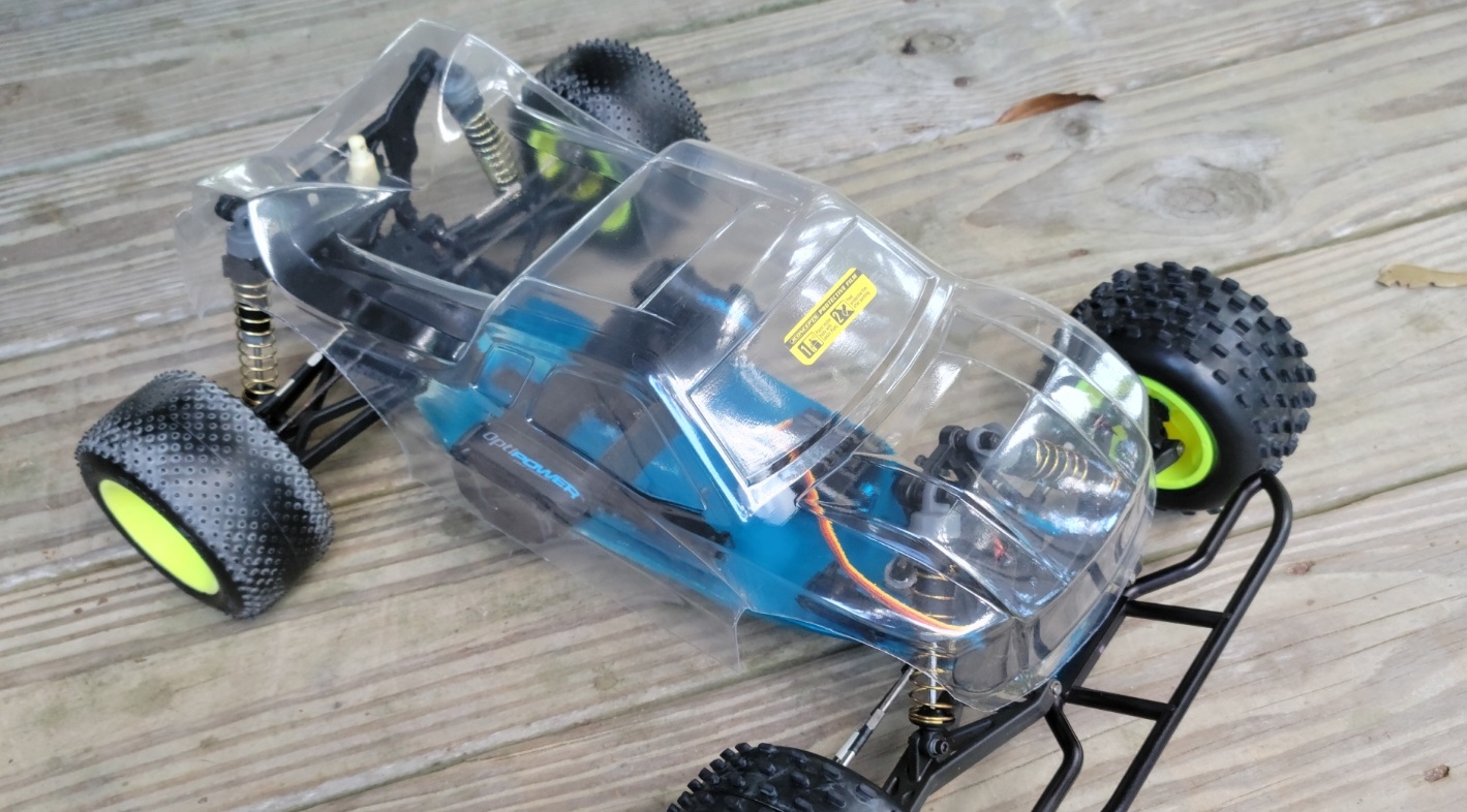

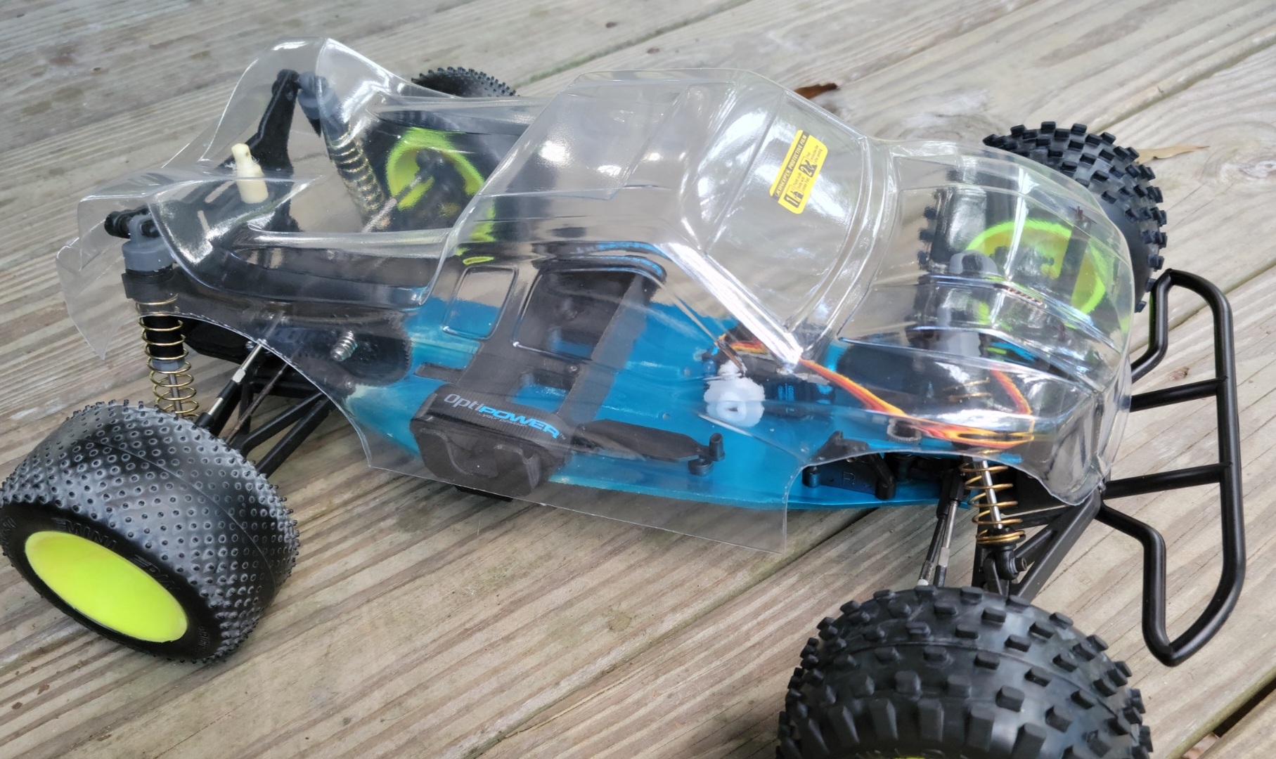

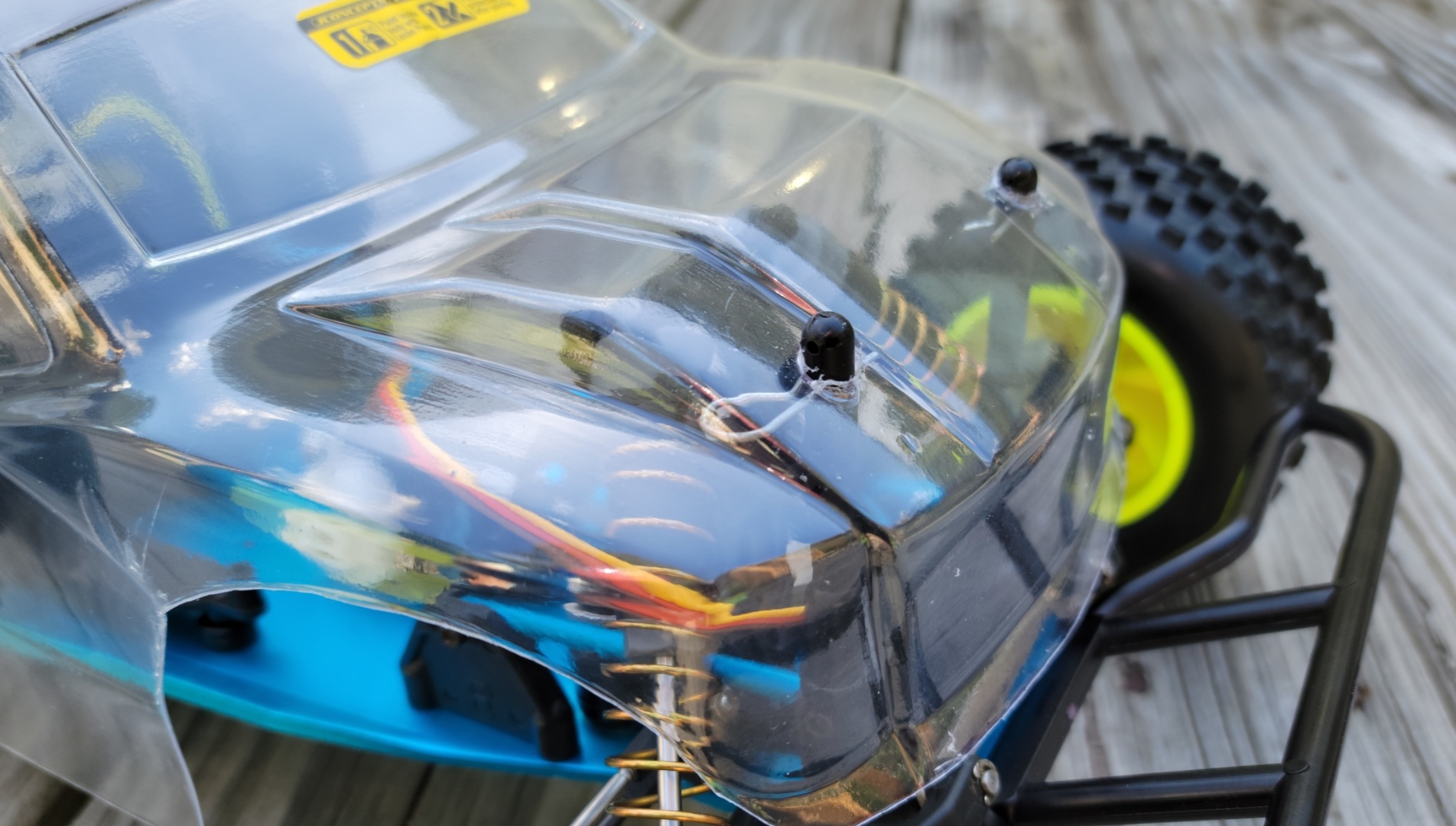

This is the JConcepts T5M body, rough cut and fitted on mine. This is the same body used on their short lived EGT conversion kit.
The front body posts aren't the correct angle but are usable. I'm going to use 2" universal posts.
In the rear, I used a center post bracket and a cut down RC10 post. The 90° bracket is just a piece of Kydex.

A flat plate relocates the front body posts to a good angle for a T4 body. Might work for a T5 body too.
https://www.rc10talk.com/viewtopic.php?p=535168#p535168
What works for a T might work for a GT.
Posts: 3536
Has thanked: 269 times
Been thanked: 2094 times
It's not bad, just a little off angle. Once the body is painted, foam washers applied, and the collars put on the posts, nobody will give it a second glance.

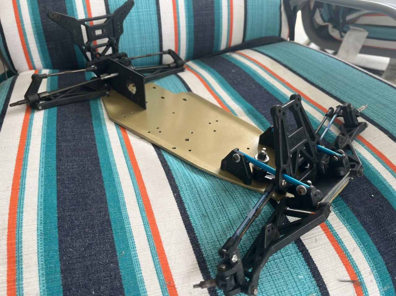

I'm going to see how far I can get with the parts I have before I go farther. I am having a heck of a time drilling out my motor plate. I made a thick kydex template for drilling and that fits on the carfine. I drilled out a steel plate that bolts exactly onto my kydex template. The steel plate does not fit on the car. looks like I'll have to jbweld the holes and start again.

juicedcoupe wrote: Fri Aug 05, 2022 3:28 pm This is the JConcepts T5M body, rough cut and fitted on mine. This is the same body used on their short lived EGT conversion kit.
Hi
What bumper are you using?
Posts: 3536
AJ DRAGON wrote: Thu Mar 16, 2023 4:55 pm
Hi
CRP. Get them on their Ebay store.
