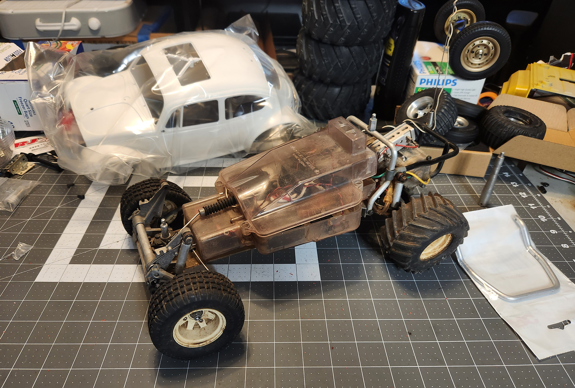

I picked up a SRB Ranger awhile back, and decided to pull it out and see what it would take to refresh. I just started into a puller project, but it is starting to sink in that that is a LONG TERM project, so still needs normal builds going on.
I had it in my head that it was the same body as the Blackfoot, and I have a couple of those sitting around, but after comparing the two, not so much. So, then I remembered I ordered a Scorcher rere body and some aluminum wheels when I first got my 4X, and I haven't used them, so maybe they can go on this. I even picked up a roll bar for some reason back then, and I am pretty sure it is the correct one for the Beetle.
Looking through the manuals, the only differences I am noticing between the XLT and Scorcher are the rear roll bar, the wheels/tires, the body, and the engine headers. Does that sound about right? I can't see anything else that clearly denotes this as a Ranger.

This is interesting in that most guys convert Scorchers to Rangers since they are so rare. You may want to hold on to those Ranger specific parts in case you change your mind some day.
Anyway, having recently restored a Ranger, I can add that the front body post is also different from Scorcher. The Ranger post is very tall.

I did not notice the differences in front body post lengths. Thanks for that! I definitely have the longer Ranger version.
If I stumble across a Ranger body in the future, I will probably make the change back. But no point in it sitting around waiting to see if that day ever happens.
