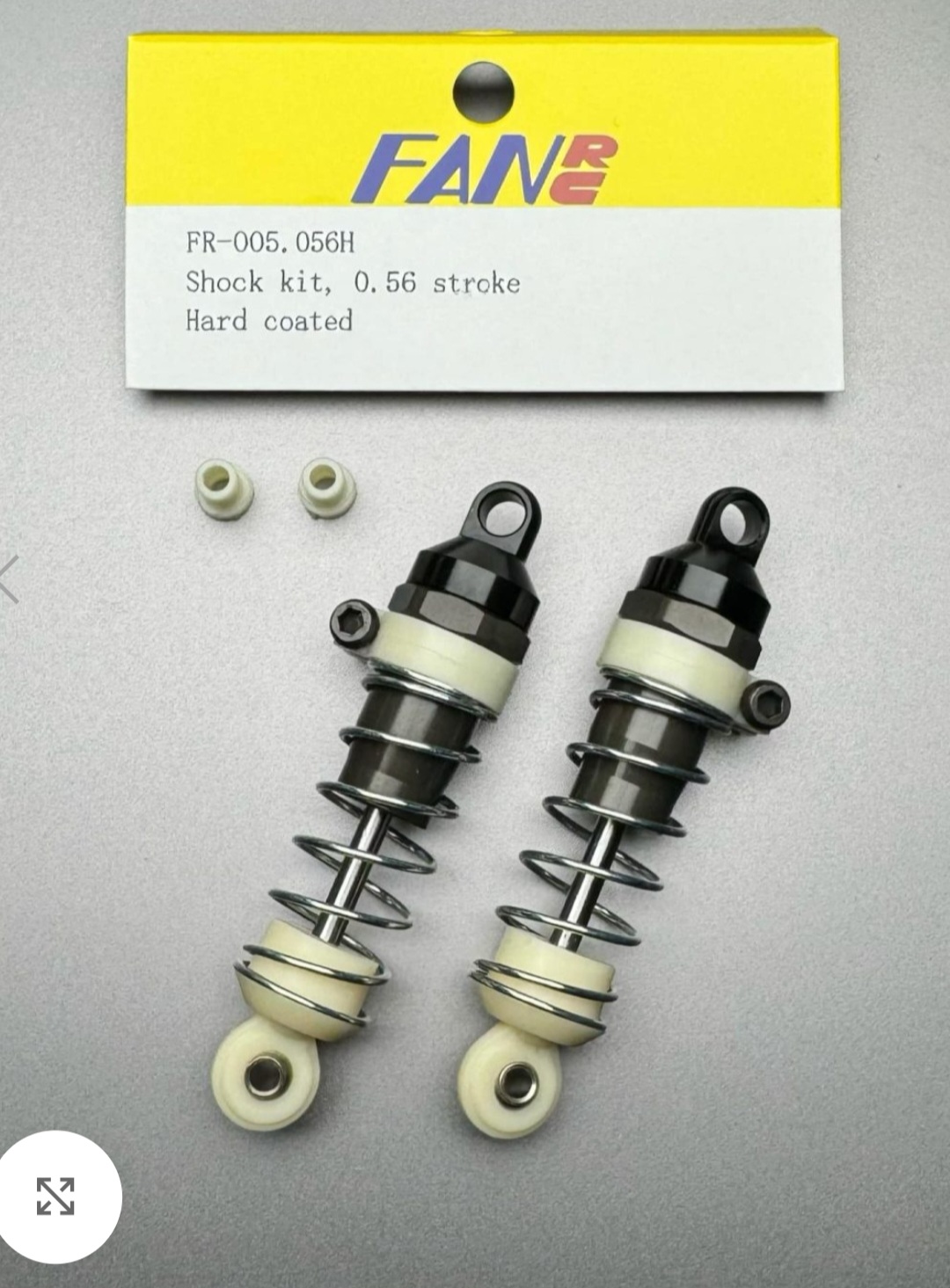

How do you guys think they did the shocks? Paint, or Aluminum Black?
I have a spare set of CE shocks, that have rubbed off a bit, that are good for this. Will CE shocks fit on an A stamp car?
Should I paint them, or use Birchwood Casey Aluminum Black?

Looks like black paint.
0.71 shocks are on the long side for a short arm car, particularly if you want a lower ride height.
If you have enough clearance at the body, a Factory Works 0.89 tower will allow you to use them. Jeff has a few different versions.

This will be going under a Bolink 63 vette body, it should have a lot of clearance for the front tower, I'll check again though.juicedcoupe wrote: ↑Thu May 09, 2024 11:02 pm Looks like black paint.
I just now checked out the Factory Works 0.89 tower, do I need the CE/Team style, to make the CE shocks work on an A stamp?
https://factoryworks.com/shop/ols/products/fwbbf/v/RC1-89-BIG-BR-BLC-CE-TM
Thanks again!

No, that simply refers to the style of the tower.
I like the A&L towers, and use various ones on several of my cars. But functionally, there isn't much difference.

I will definitely keep this in mind for the future, to be able to use those CE shocks on another project. Thanks!juicedcoupe wrote: ↑Fri May 10, 2024 4:31 am No, that simply refers to the style of the tower.
Decided to try to keep as close as I can to the movie car, and use the stock length shocks, for the narrow front arms.
From what I read, the early front arm car is 0.56 and the rear is 1.32 stroke.
Not looking forward to painting these nice new Fan RC shocks, black, but original shocks cost more and would need to be rebuilt.
https://www.gofasthobbies.com/collections/fan-rc
Found a late Edinger motor mount for $15 today - this one I am looking forward to painting black.

Before painting a new set of shocks, I'd probably settle for the dark grey with black caps.
