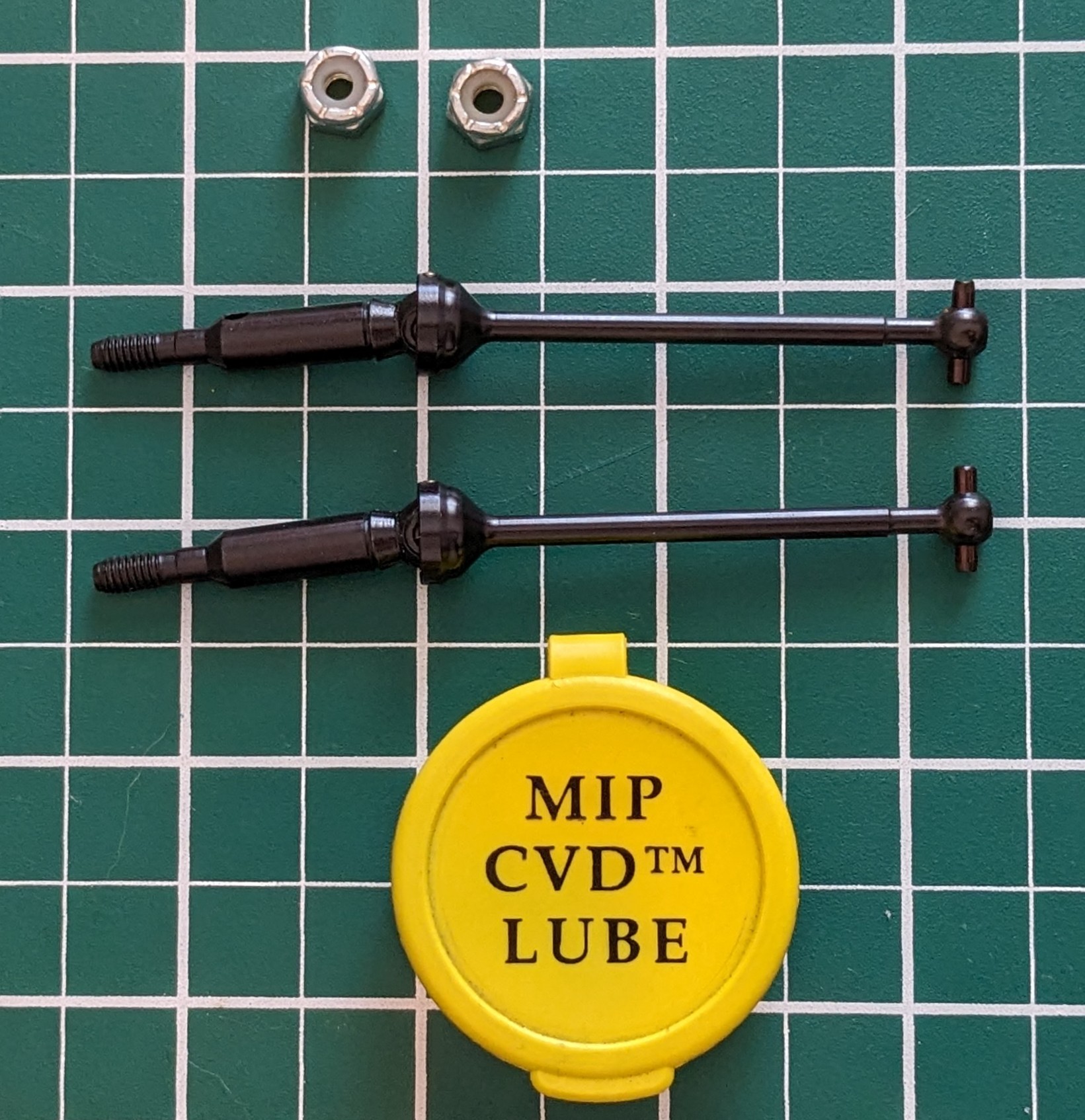

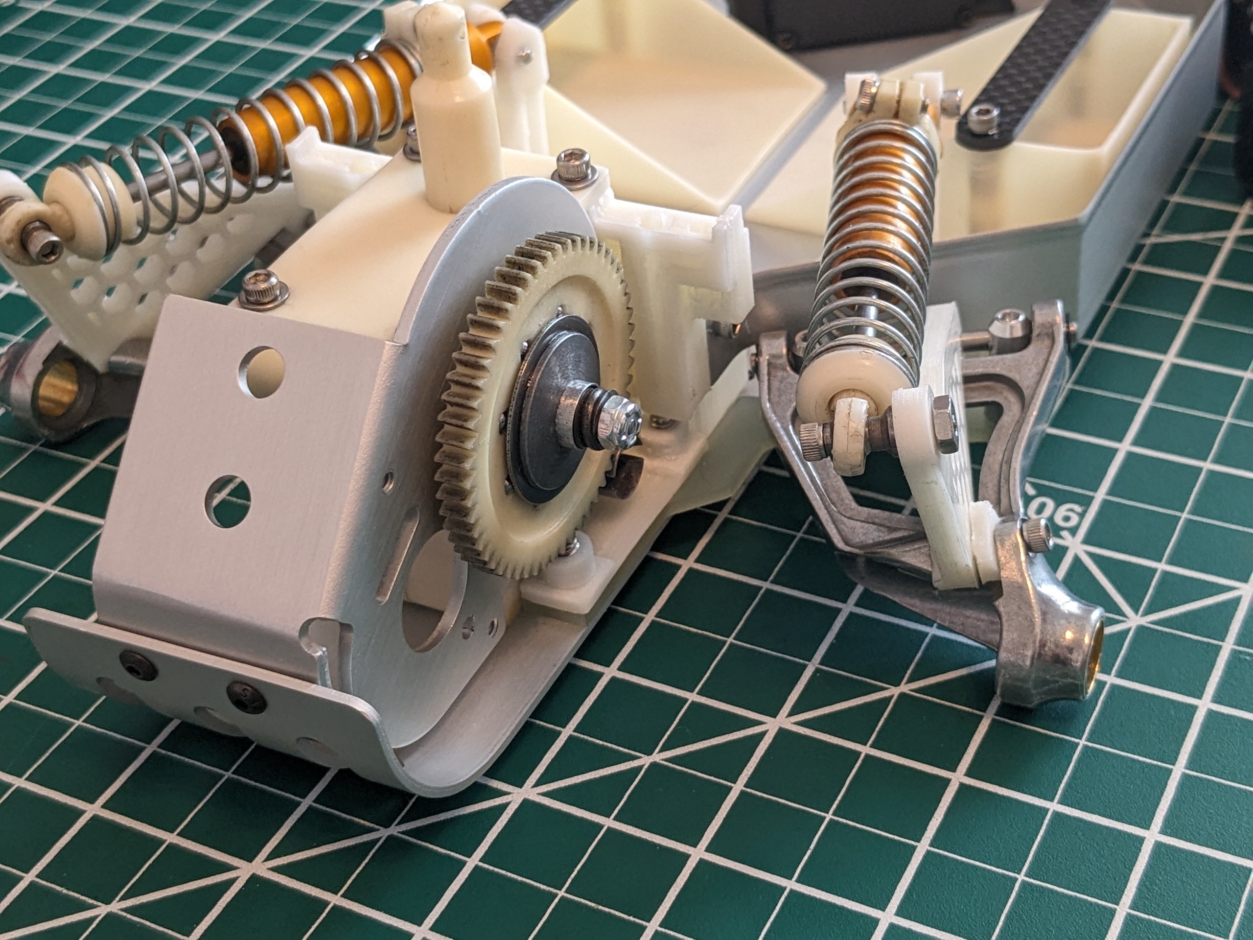

Next decision is 1/4" CVD or 3/16" CVD. For this build I'm leaning toward 1/4".

I also need to decide which gearbox is going in. I kind of think the new Factory Works / JC Racing hybrid gearbox would be the right setup, but have to think about it a little more. For now it's at a stopping point.

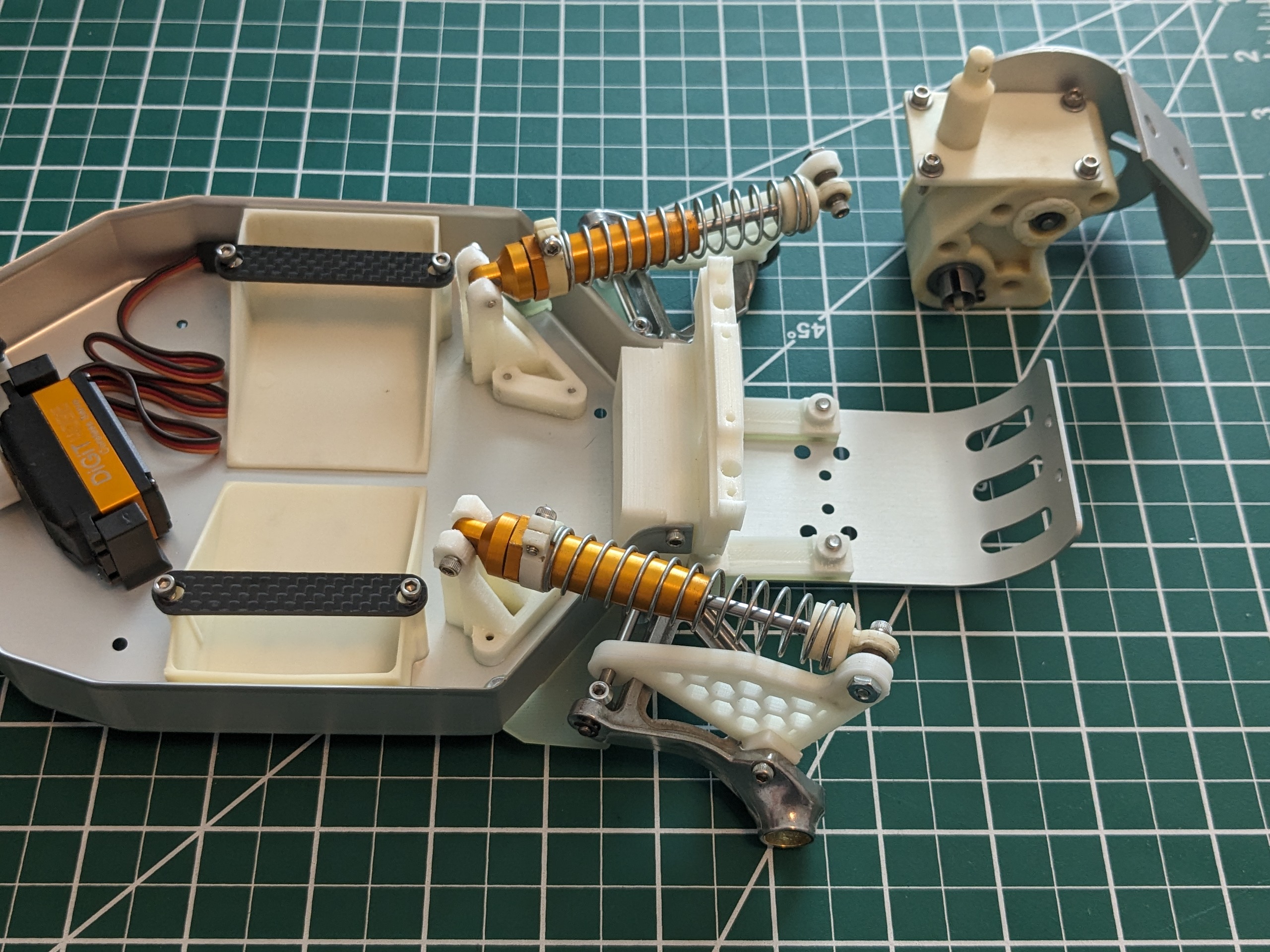

I have a nice 6 gear that has needed a home for a while. This chassis feels like the right one for it.
I didn't realize the AYK Buffalo had laydown rear shocks like this. I think I need to update the name to the Buff CAT

Got my bearings, in both axle sizes.
I don't use the jelly bean wheels very often, but since I have a nice set and the tires from my CC kit the 1/4 axles will get used in this build.

Body is trimmed and fitted. Rear body mount was moved forward a little over an inch and a new gearbox brace was added.

I hadn't considered using the brace. I was going to do the standard wing tube setup, I just hadn't put tubes in yet.
It looks like a wing will need to use standard length wire to maintain a little clearance to the rear wheels. This loaner wing has the RC10CC wire.

The nylon front rack is super durable, but too flexible. A new fiberglass rack from Factory Works fixed that problem.
While I had the front shocks out, they got changed from gold to silver springs. The front suspension is now much more reactive.
