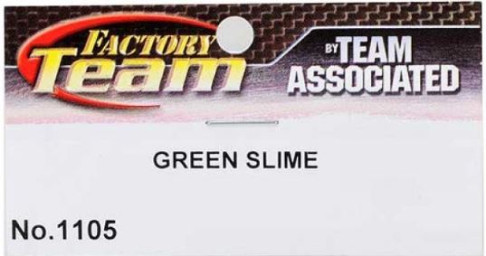

Title might be a little confusing, but I'm wondering what years each AE logo was used for parts bags.
[edit] This is pretty comprehensive list now thanks to Dangeruss, jcwrks & scr8p. It's possible some were used after they should have been expired and replaced but this is an excellent timeline.

Used from 2000 to 2003 *Made in USA" 2003 to 2006 "Made in China" 2007 to 2017 no origin ___________________________________________________________________________________

...really blow a persons mind, the AE logo was a slot car track... and Associated updated their "Slot Car" to an "R/C Car" in 1989
Date ranges for packaging is tricky because old models used old stock until it was depilated while new models got the newest packaging. I'd call the end as the year prior to the newest packaging being released.
Having said that...
Used from 1971 to 1978
Used from 1979 to 1986
Used from 1987 to 1988
Used from 1989 to 1992
Used from 1993 to 2004
Used from 1998 to 1999
Used from 2005 to 2017

Cool thread. There are two Factory Team header cards. The one in the OP is early and has Made in USA on the back. The one that came after was China.

Re: Parts Bags AE Logos - what years for each logo style?
Good catch.
Ya wanna know hard... trying to find listings that show the back of the package.
So, the second Factory Team card appeared in 2000. "Made in USA" was replaced with "Made in China" in 2003. And by 2007 no country of origin was listed.
Added a picture of the second F/T card, thank you jcwrks.
I remember white 10T parts in flag packaging when the truck was still new, 91-92... I wouldn't argue the duration of time for the buggy cards to be longer but I'm having no luck finding early 90's packaging.
Edit: found a Team Truck rear shock tower with white buggy packaging so that takes it up to at least '92... making it look like '93 was the start of the flag packaging... and scr8p is right again.

The image of the flag header card used as a sample above is for a b4/t4 part so wouldn't that stretch it's usage up to atleast 2003/2004?

It would... I wonder how azone missed that.
looking again the latest I found a flag card was for an RC18T shock tower (2004) while the RC18B shock tower (2005) used the ellipse card so, new date split for them.
Looking good indeed. "for now" being the key words... I think this is probably going to be a very fluid thread for a little while.
Edit: Added a new card to my post above... a white Slot Car card with an Edinger Address, would make it 1979-1986 and split the same card with a Cadillac address to 1987-1988.
