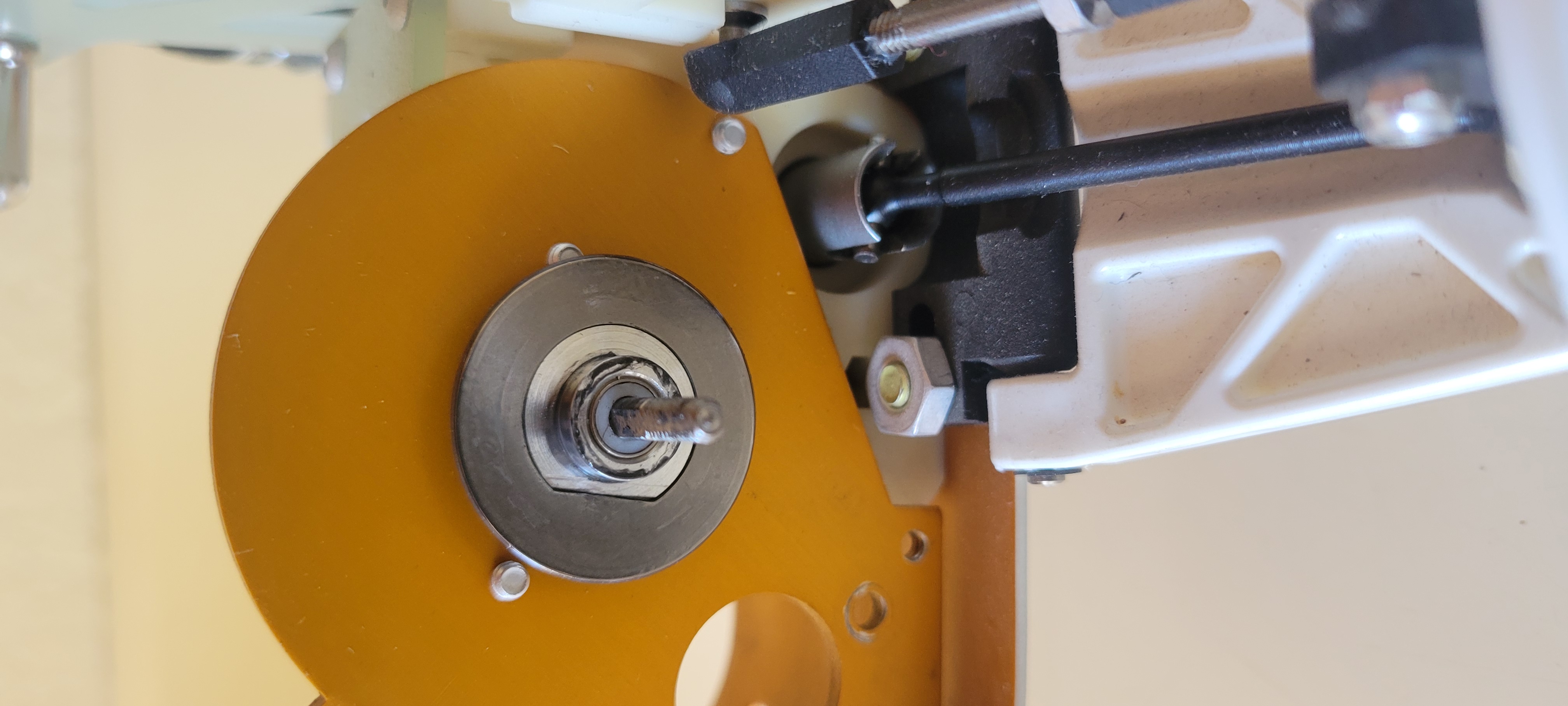

helbnd1 wrote: Fri Jun 07, 2024 10:42 am https://www.amainhobbies.com/team-associated-d-drive-ring-2-asc8504/p32677 I use these instead of pinning.
Is there a 'D' hub that matches those 'D' rings, or are you just supposed to file a flat spot in the stock hub? Thanks!

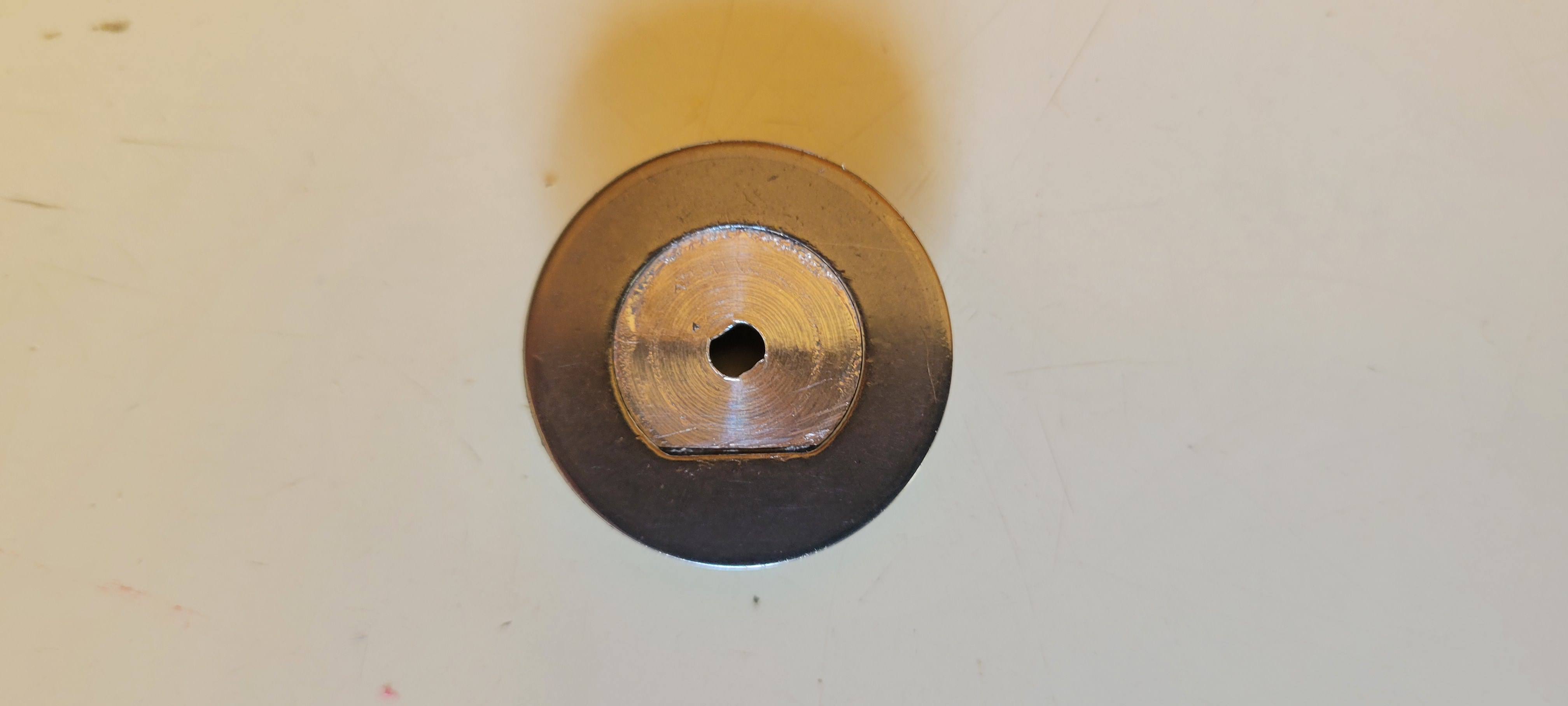

helbnd1 wrote: Fri Jun 07, 2024 6:25 pm I file them.
Image[/img][/list][/img][/img][/url][/img][/img]
This does look like the best idea to lock the rings permanently, it would be easier to mark the hubs and file them, than it was to drill and CA them; and with the D-rings the pin or set screw can't fall out or deform over time. Seriously considering doing this, by leaving the set screw on the outer hub that's already there now, for looks, and filing the 'D' in the stock rings, and not using those 2110 Bud's. Going to do it. Thanks!

You really can't make D-rings from stock rings without enlarging the hole - it won't work.
When you file the D in the hubs, you'll want to bring it precisely flush with the surrounding ring mounting surface so the ring doesn't rock when the diff is assembled and make it feel notchy. I'm not saying the hubs cannot or should not be filed, but it could be difficult to get right.
With that said, I think pinning the rings is probably best for do-it-yourselfers. :wink:

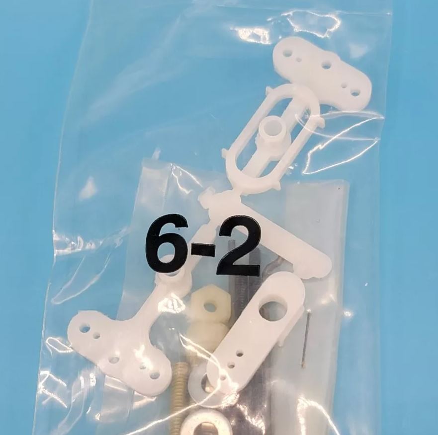

Had a moment to compare the FanRC steering assembly to the mid-late Edinger nylon.
No flash.
Flash.
How great is that match, I'd never have known that wasn't aged original Edinger nylon. I really didn't want anything but NOS parts, but if I want to drive this, another brittle and expensive NOS set is not in my future. These are great, well done FanRC!

FWIW the original AE steering bellcrank is bright white and a much harder plastic. Fan RC is not the correct color. It's possible he did that on purpose or decided to use the same nylon as the other parts.

jcwrks wrote: Mon Jun 10, 2024 8:45 am FWIW the original AE steering bellcrank is bright white and a much harder plastic. Fan RC is not the correct color. It's possible he did that on purpose or decided to use the same nylon as the other parts.
That's all true and the original parts were not reinforced and were known to crack so he might have used the reinforced beige nylon (same as suspension parts) to make them more durable.
I'm okay with the decision to improve the parts.

The JJH rings and hubs will be here later today, getting ready to put this chassis back together.
While the color of the FanRC parts match exceptionally well:
- the FanRC bellcrank is really flexible, which is great for absorbing crashes and not splitting.
If I want to drive this one, I'm thinking the stiffer 40th bellcrank would be better for tighter steering - will put the 40th bellcrank in, it's closer to stock without the NOS brittle.
