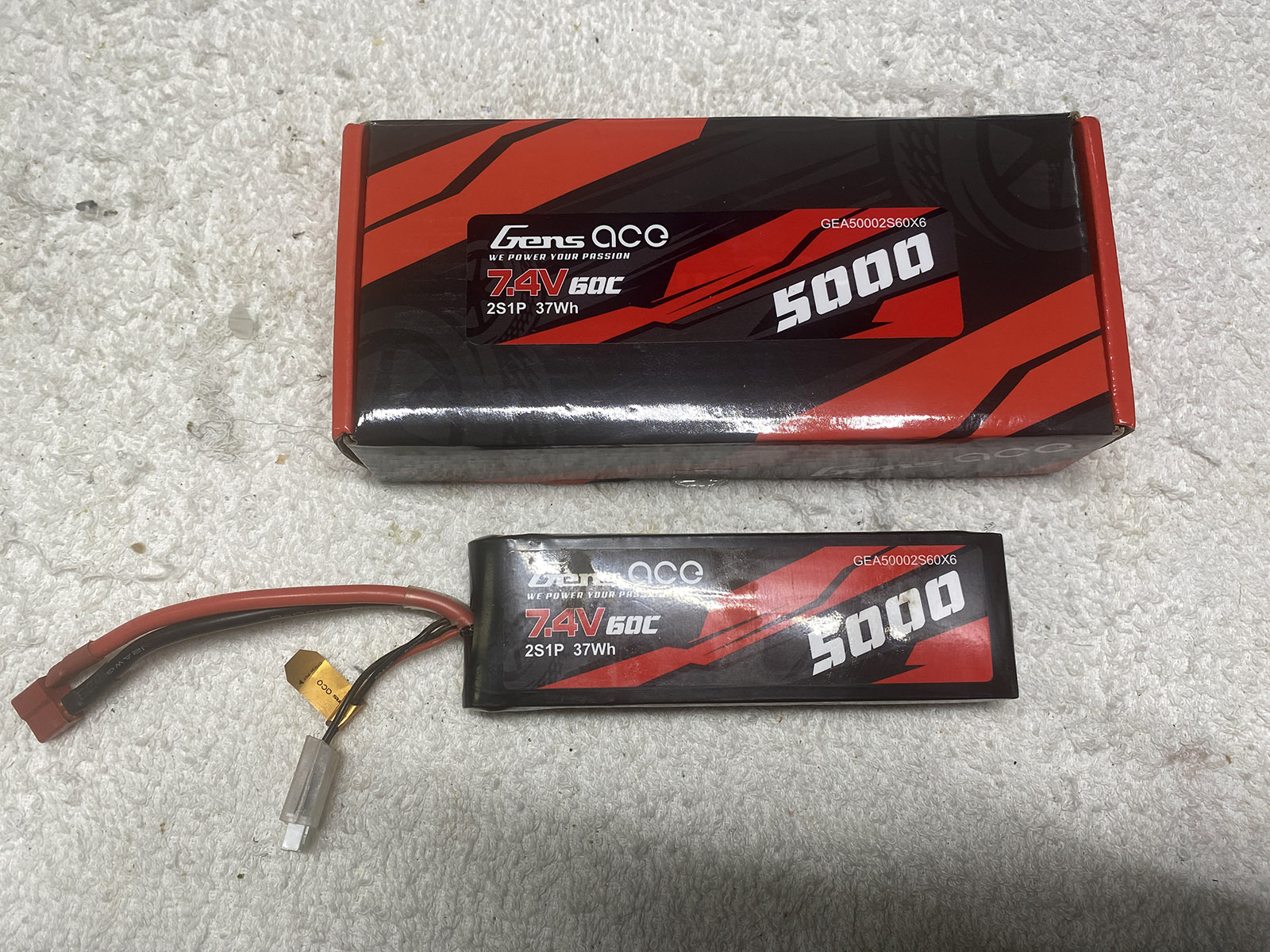

I recently found a 2S Lipo for the Wild One and it was not nearly as easy as I thought it would be. Most 2S, even ones that are stick-shaped, are a few mm too long. I finally found this one that is absolutely perfect.. but it is hard to find. I found some at Tower and had to cut off the XT60 connector to install a deans (can't find it in stock w/ any other connector).
GensAce 7.4V 5000mAh 2S 60C Shorty Hardcase LiPo Battery
https://www.towerhobbies.com/product/7.4v-5000mah-2s-60c-shorty-hardcase-lipo-battery-xt60/GEA50002S60X6.html
