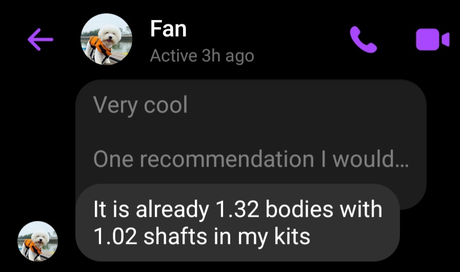

I spoke with Cheng yesterday and apparently in his kits he does include the 1.02 rear shafts so don't use the CE or Team manuals, use the original Worlds. I would highly recommend not using the rere manual for the majority of the kit since the rere manuals are beyond terrible. Find the original worlds manual online and use it, link below. The shock lengths from that manual will be correct plus iirc the bleeding instructions are better as well. He said his manual is still coming soon but no date.

Oh this makes a few things so much clearer. I saw on the link to the rere world's manual that it does infact say re-release but i wasn't seeing any other world's manual.
