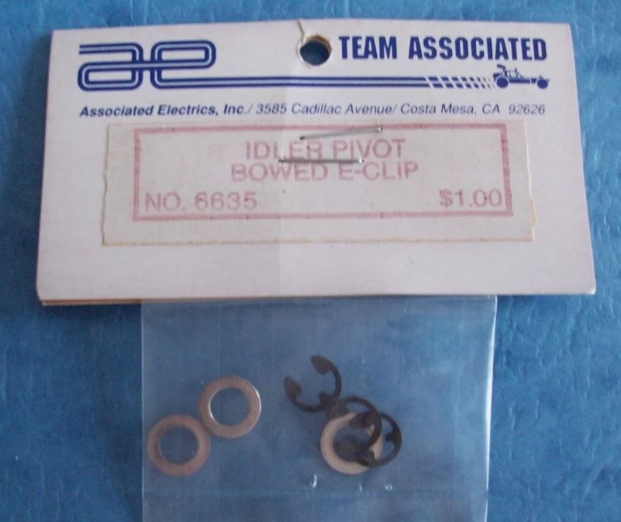

Lost the bowed E-clip for about 12 hours last night and today. It disappeared magically when trying to install it, and while trying to check the manual for which way the curve faces, concave or convex?? At that moment it was just gone, didn't even make a sound.
But after tearing the place apart in daylight, here it is.
If you've ever tried to replace one of these, good luck, there isn't even a part number listed for it. Found one on ebay, for $26 + shipping in a bag with the rest of that stage. Thankfully I won't be needing it.
https://www.ebay.com/itm/315225133633
Don't lose your bowed E-clip, put a box around the install if you have to, to keep it from flying away. The truly wise man can learn from a fool, here's your chance.

You can get bowed e-rings here, but then you have 99 extra
https://www.mcmaster.com/98398A118/
GreenBar0n wrote: ↑Sun Jan 05, 2025 5:47 pm Lost the bowed E-clip for about 12 hours last night and today. It disappeared magically when trying to install it, and while trying to check the manual for which way the curve faces, concave or convex?? At that moment it was just gone, didn't even make a sound.
