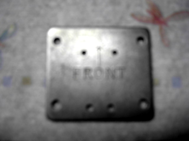

VTB,As Mel said the mounting holes need to be drilled to mount a stealth trans.maybe one of the others here has the template/ fixture Associated packaged along with the Stealth trans.You could make a template out of lexan.If you have a car that came with a stealth,just cut your lexan, lay it on the stealth chassis,copy the holes and drill your chassis,plug and play!! 8)
Dan
Posts: 16774
Has thanked: 35 times
Been thanked: 1262 times
this is the template
