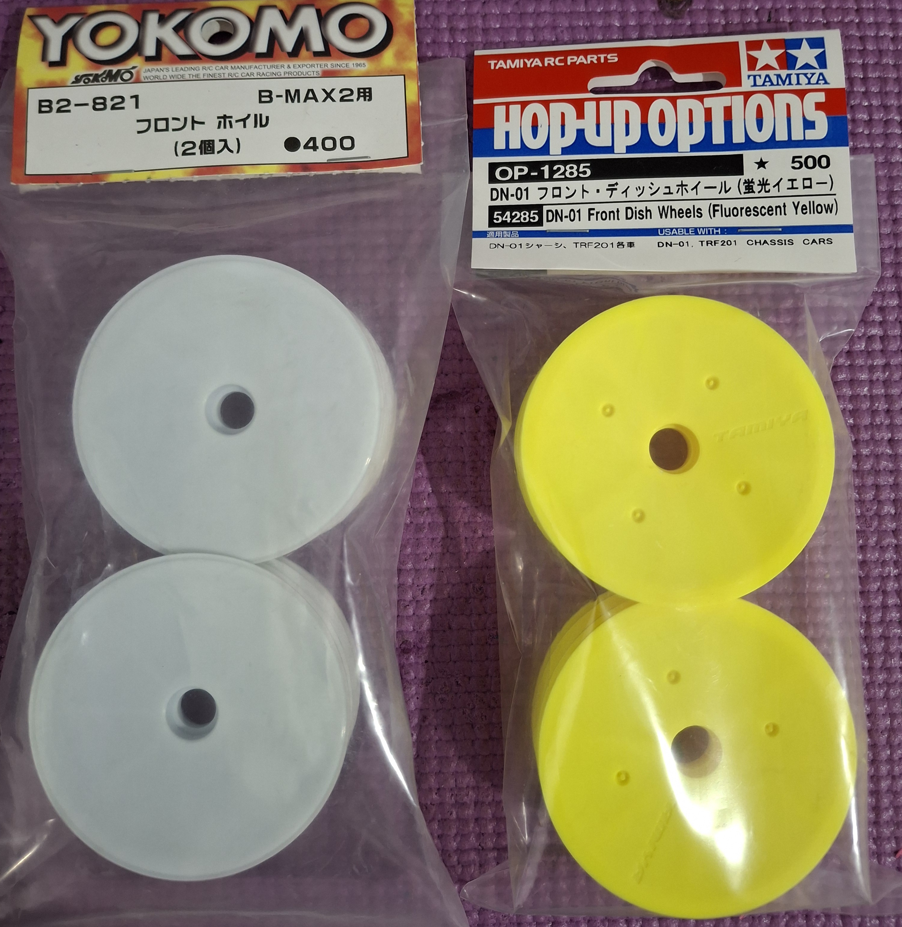

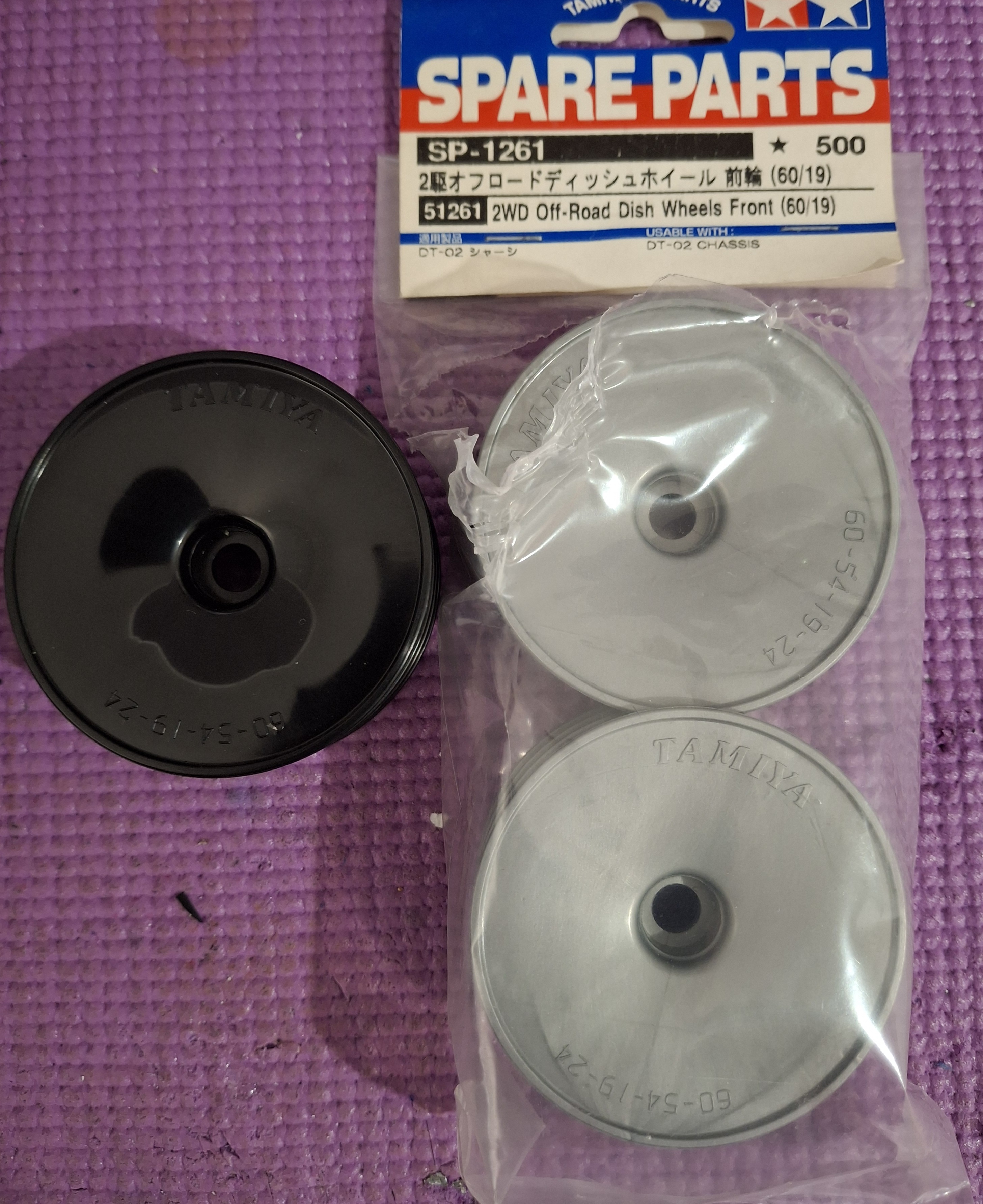

Re: 2.2" wheels for TRX-1 & TRX-3
There's numerous options as mentioned above.
Get yourself some washers and possibly some wheel nuts with different thicknesses. For the rear, you can fit a hex and use a B6 style wheel if you're not too worried about width.
Pin drive wheels are still available in both metric and imperial axle diameters with less offset. You could drill/ream out a 3/16 RC10 wheel to possibly fit with better offset? I haven't done this myself.
Or, save yourself all this hassle and just get some Bandit pin drive rears?
For the front, these wheels take either a 10 or 11mm bearing. I don't recommend the DT02 wheels, too much slop around the bearings. Front width will vary. Kyosho Ultima fronts might work, too?

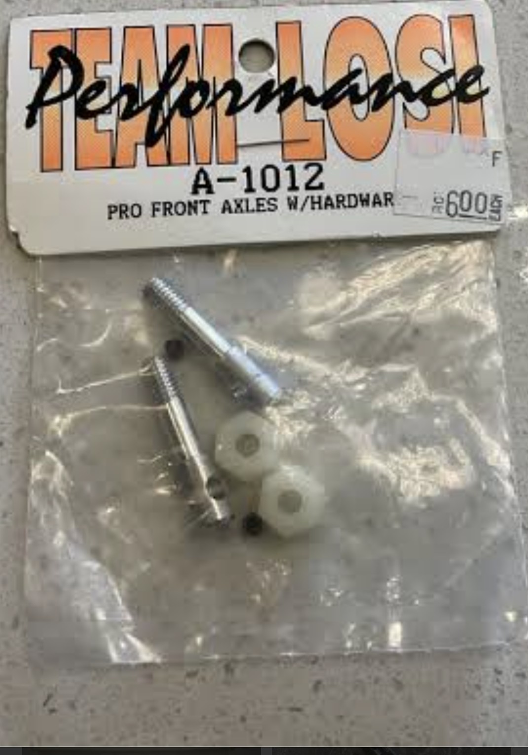

The front hex option can be done with Bandit/Rustler parts as TRX-1-3 mentioned. This involves, dremeling, changing turnbuckles and hinge pins, and drilling a new camber link hole in the shock tower. Apparently Losi JRX-PRO axles fit the standard steering knuckles if you want to use those wheels and imperial bearings.
Dirtburner, thanks for all the info. I didn’t know about the yokomo universals as an option. also the suggestion to skip the dt02 front wheels. That was one option I was looking at.

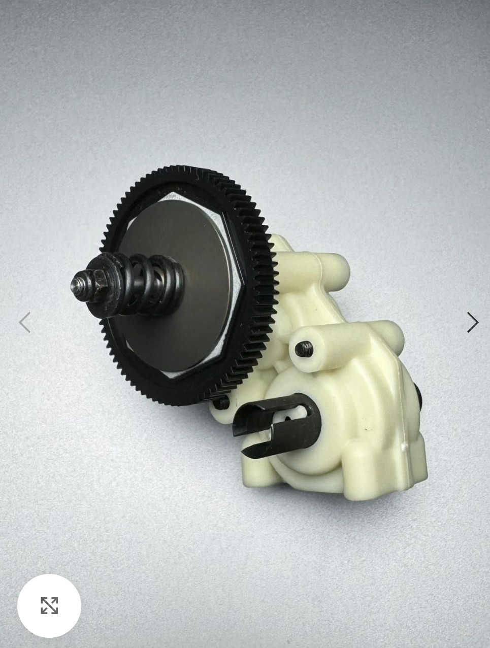

OK, gotcha, I didn't realize you were running the Stealth in the previous pic with the Yokomo universals. I know A&L bones fit the Stealth outdrives, so was thinking maybe the A&L outdrives used in their dogbone kit for TRX-1 (currently out of stock) fit the Yokomo universals. This might solve the trailing arm axle fiasco I've come up against in the past. Thank you for the clarification.Dirtburner wrote: ↑Fri Jun 27, 2025 2:45 amScreenshot_20250627_083441_Chrome~2.jpg
