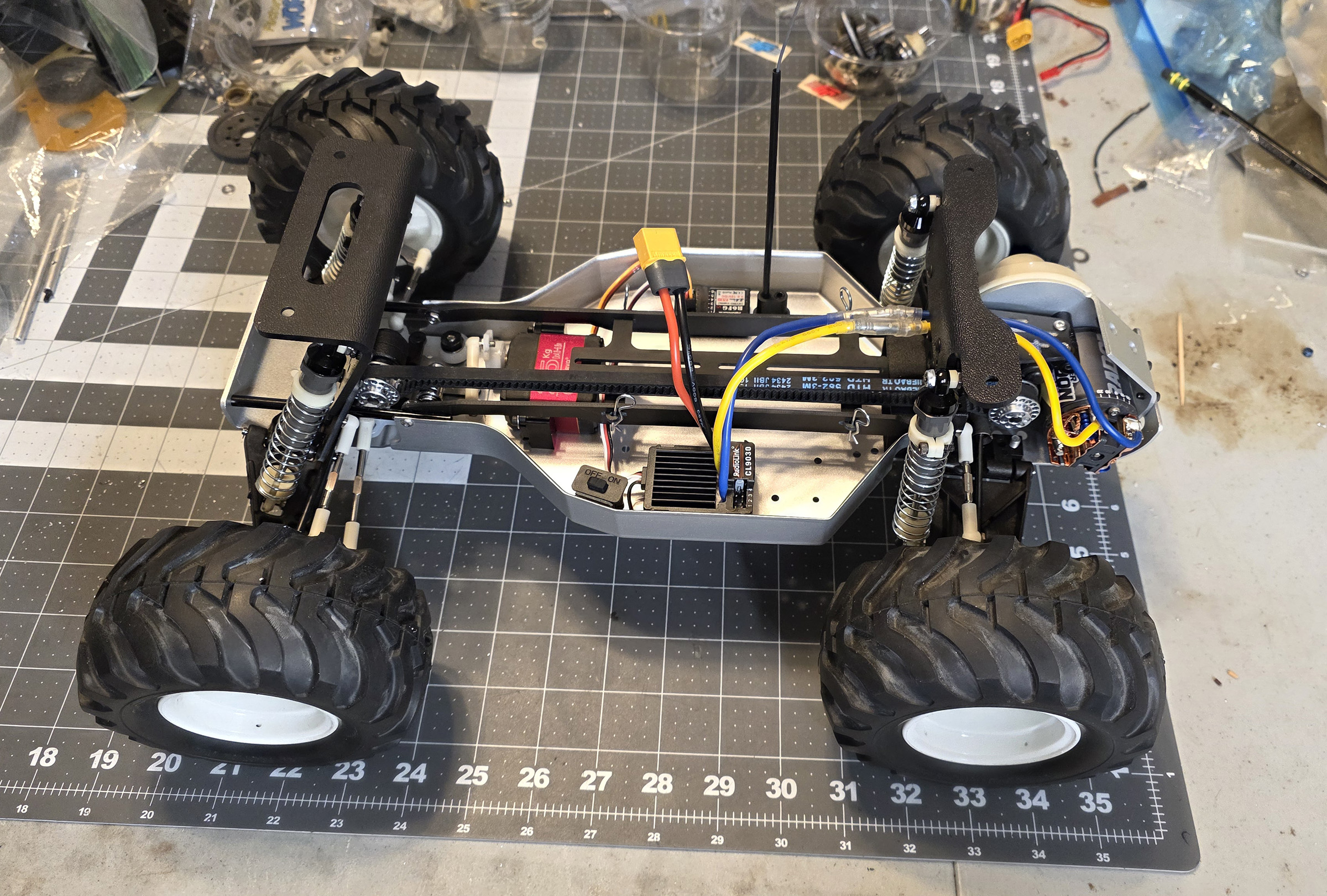

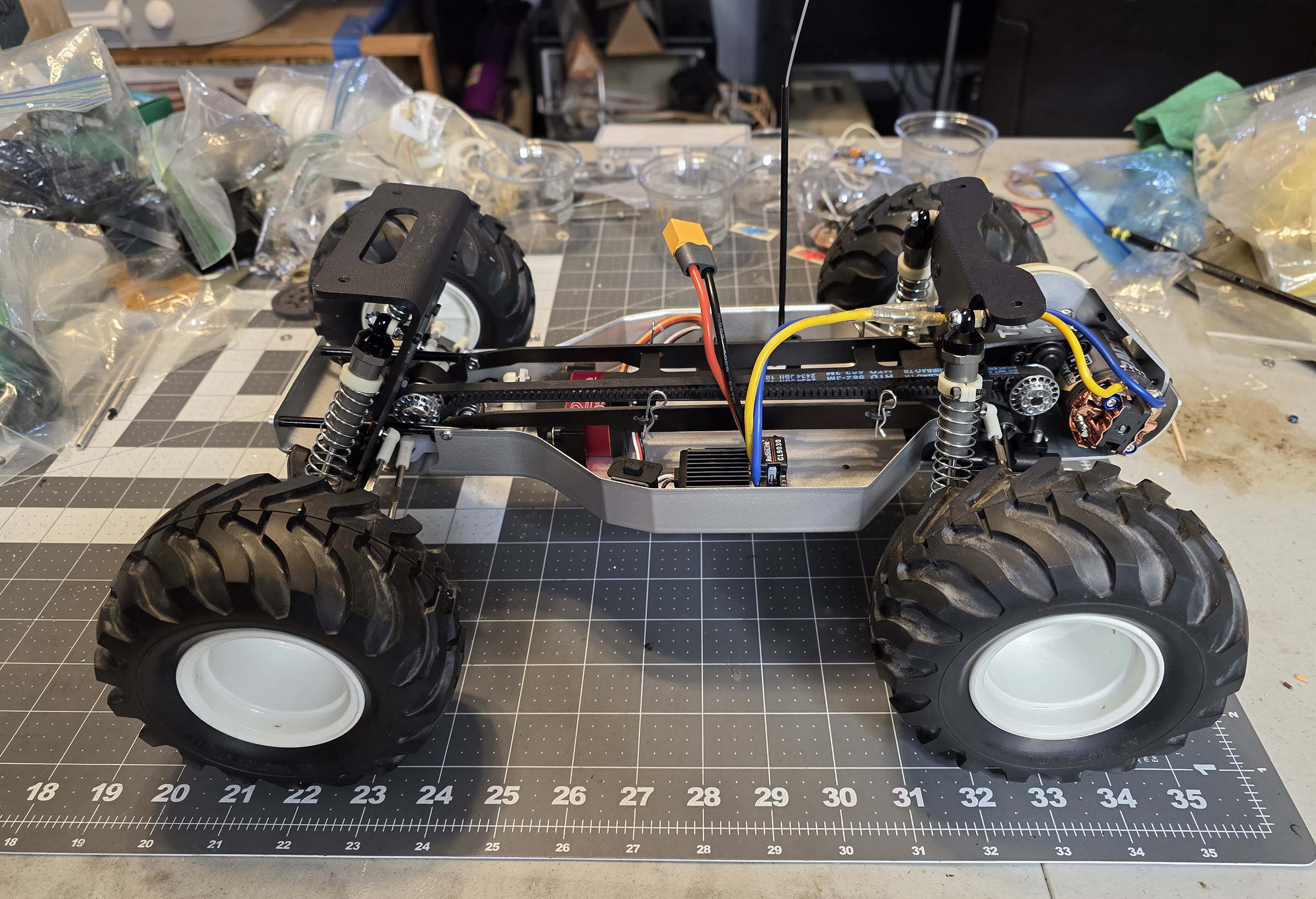

Well, I was supposed to be working out of town for the next 3 days, but that ended up being about 4 hours, so I got a little more work done on the MT. Servo mount holes drilled and countersunk, electronics mounted, servo cable shortened, motor wires changed out to match ESC, slipper assembly cleaned up and mounted. Only problem right now is that I don't have a shorty lipo with XT60 to install. :roll: That used to be my go-to plug, but I have modified everything I own to different plugs, or modified the batteries with velcro and such for the pullers. So, actually moving will need to wait a couple of days. May have some time to work on the body in the mean time.
