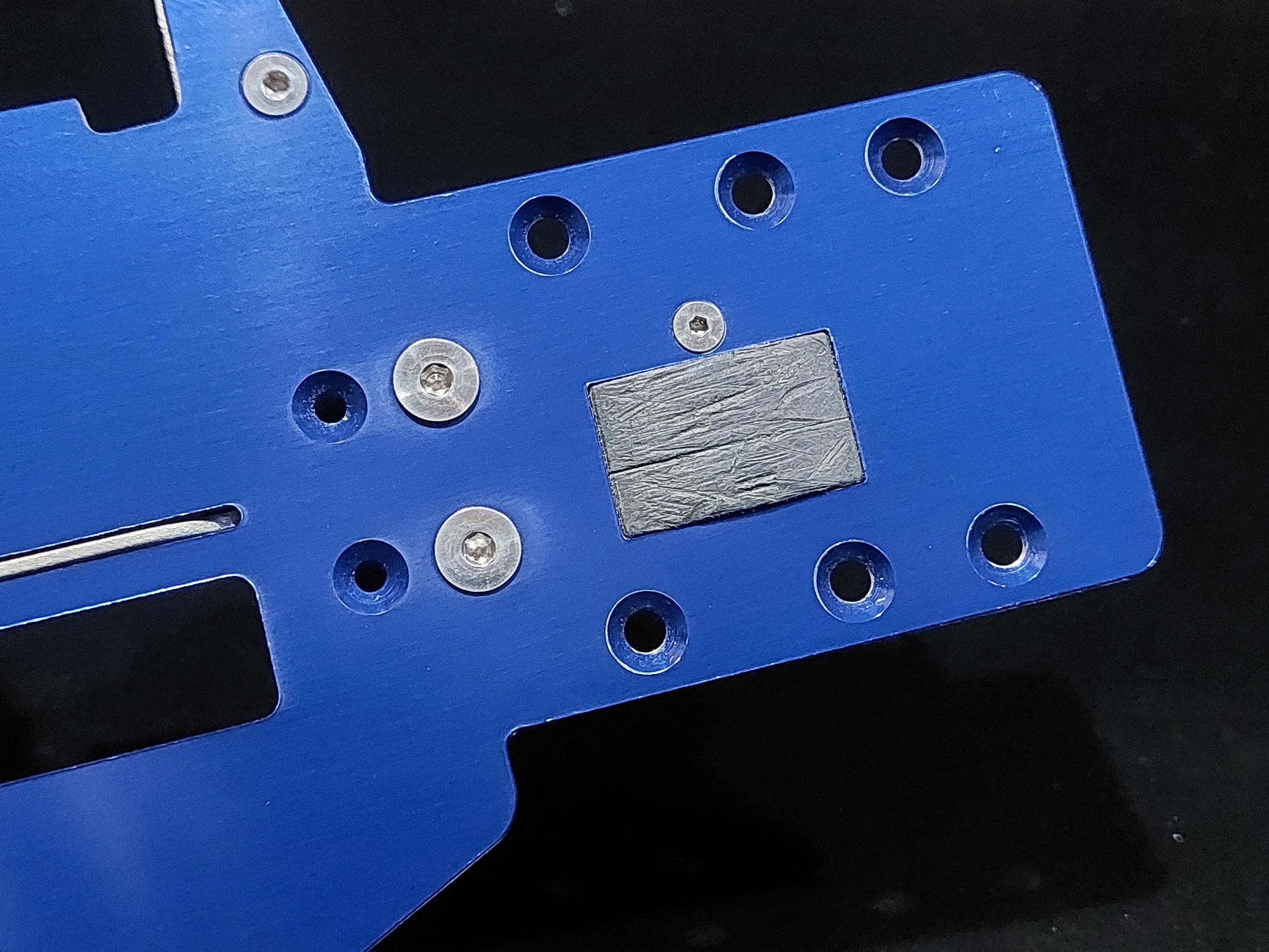

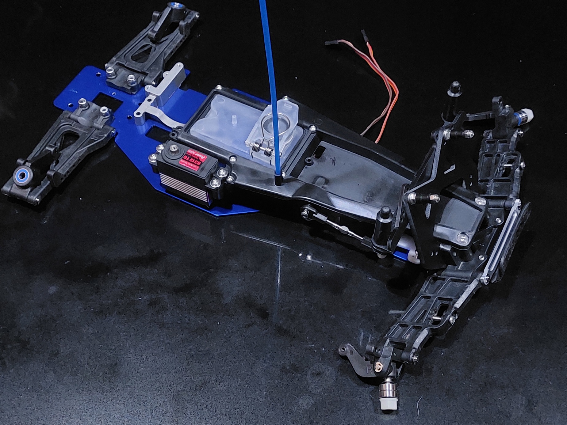

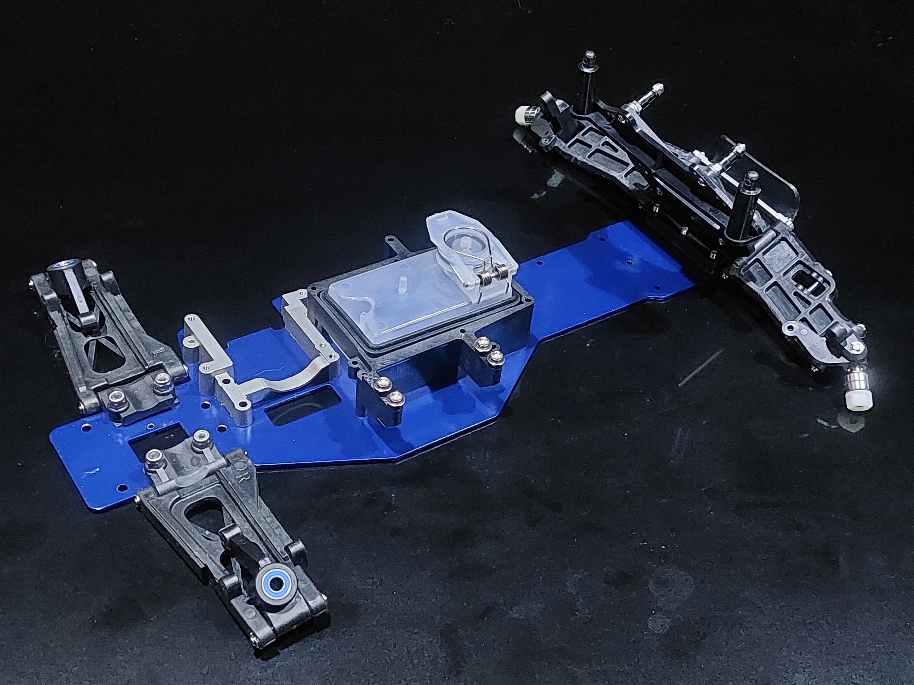

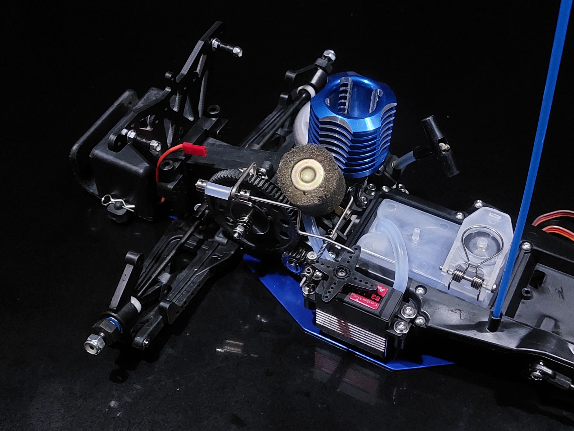

The chassis is pretty cheap, the material is thin and stamped out leaving raised edges.
Somewhere along the lines Tra**as changed the engine mount slightly where one leg on the main mount is slighly shorter and one engine adaptor is also shorter. I had to file the engine adaptors to fit the massive OS pullstart just like I did on the Nitro Sport.
I also had to modify the chassis slightly to make it fit.
Engine mount and engine test fit to the chassis...

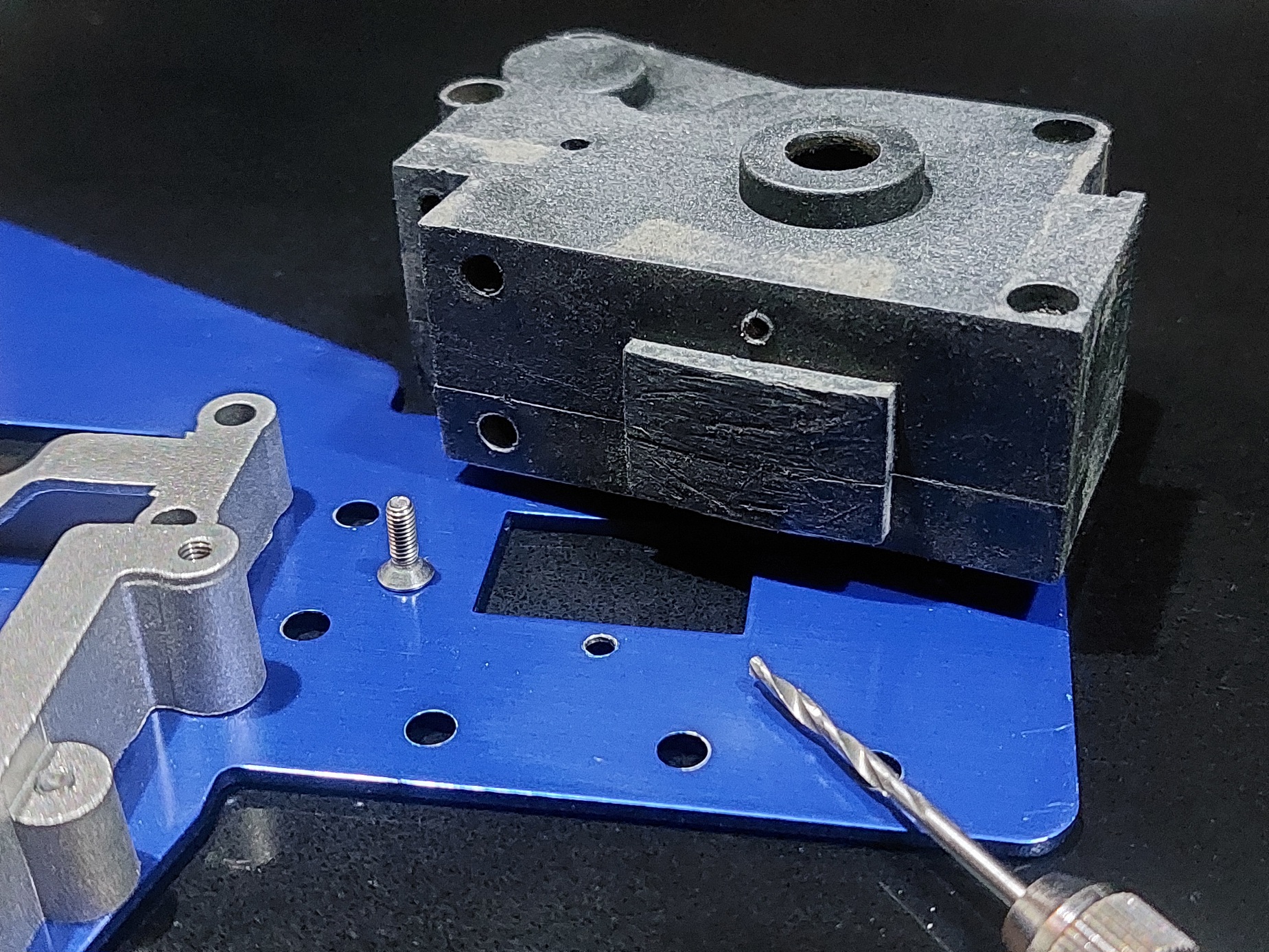

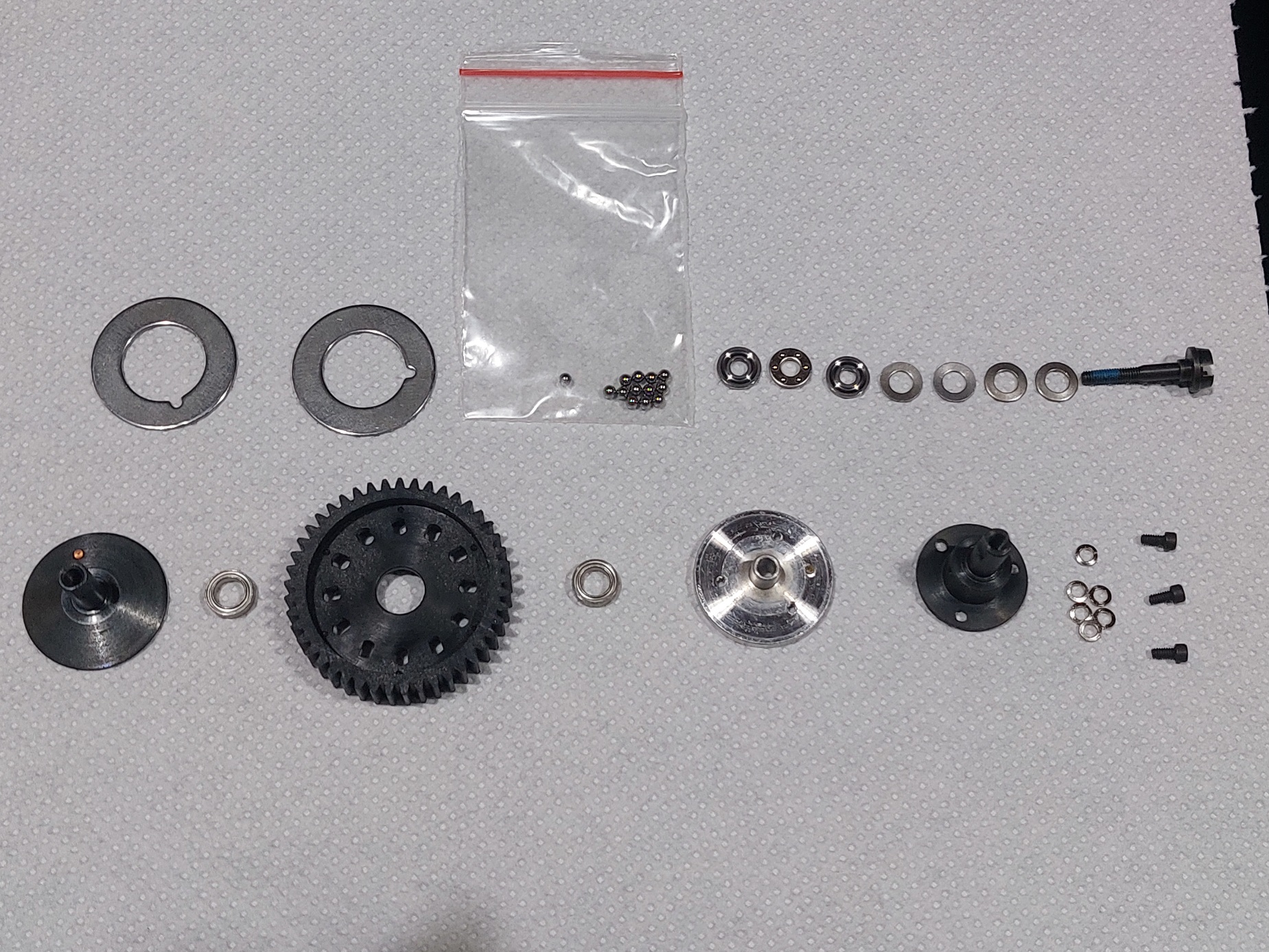

The Rebuild
I wondered what the countersunk screw hole to nowhere was for, turns out it is for adjusting the optional ball diff....
So I drilled the case.
Pretty cool but different way to adjust the diff, you stick a 1.5mm driver in the hole and it locks one side of the diff so you can loosen or tighten the diff.

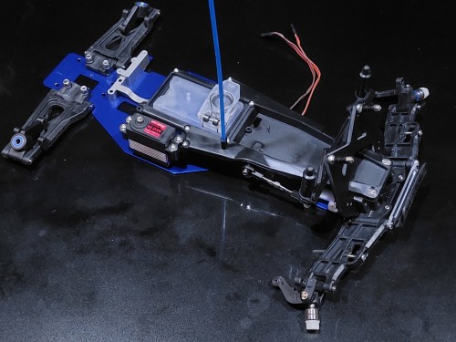

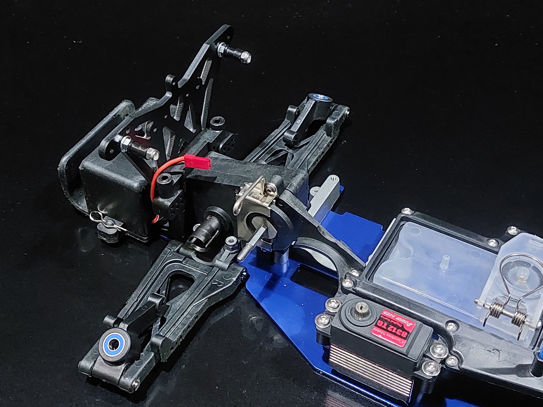

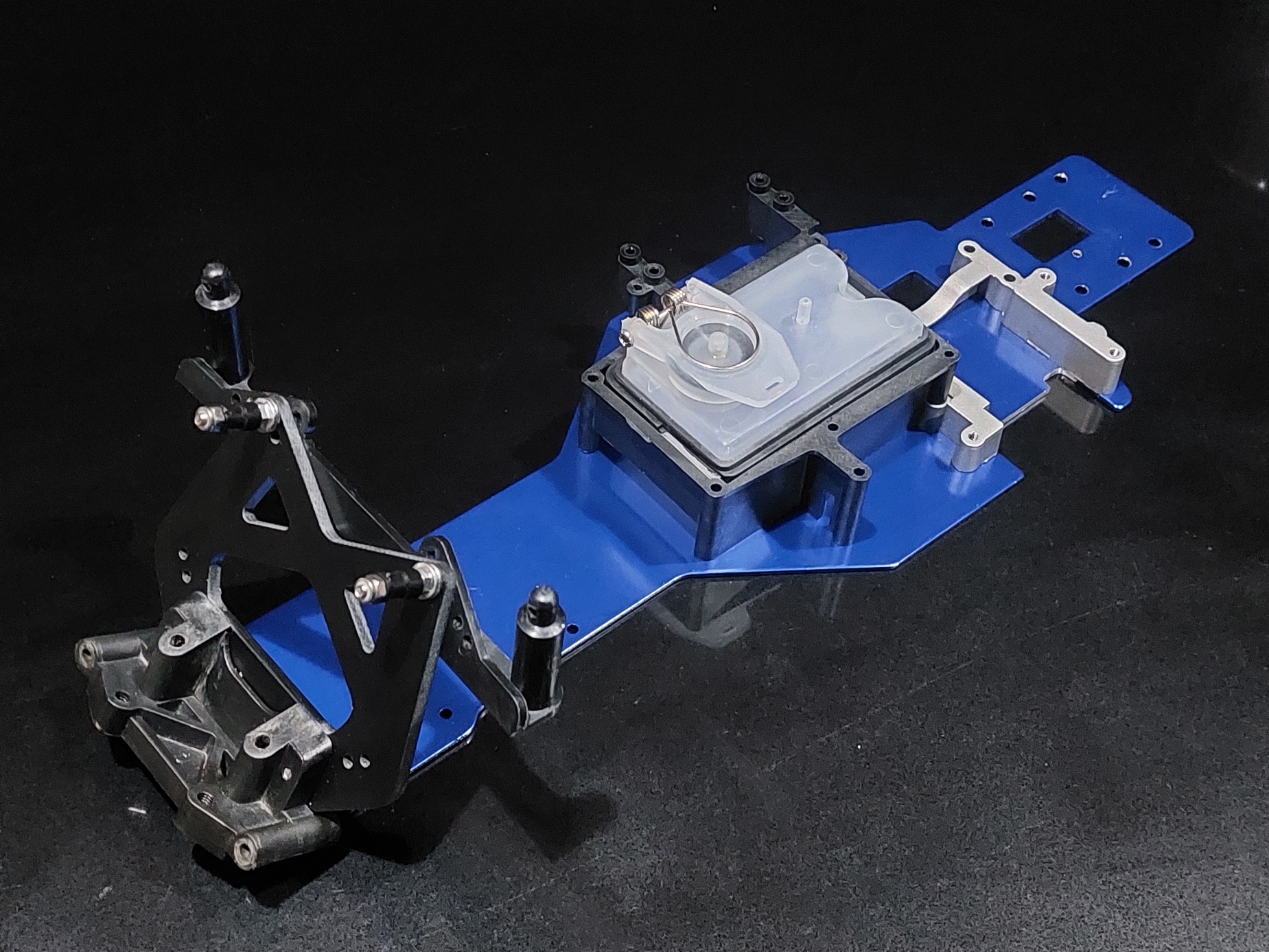

Fuel tank box and front end nearly finished. I'm still waiting on turnbuckles to arrive.
I stripped the anodizing off the original tie brace as the light blue clashed with the rest of the truck.

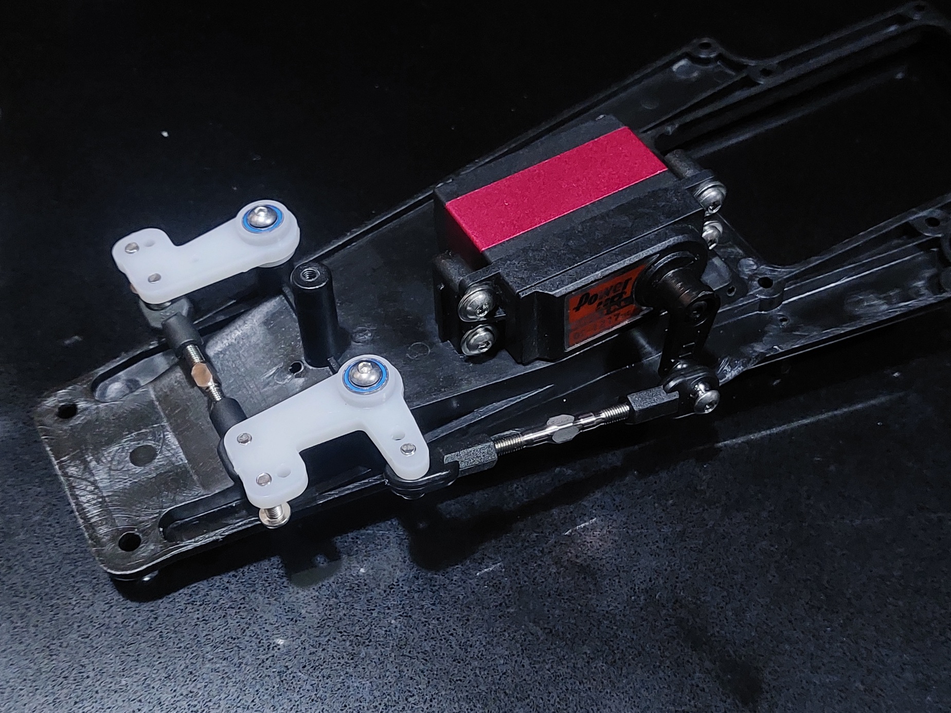

I originally wanted to flip the steering and mount it to the chassis like the SRT but I don't mind the pod type set up. The steering set up works well and solid with titanium turnbuckles.
Steering servo is a Power HD 1217MG, 219.42 oz-in of torque and .11@ 6.0v which is fairly healthy.
Upper deck attached. Throttle servo is a Power HD 8312 TG. 187.48 oz-in torque and .10 @ 6v. It should be pretty snappy and have plenty of brakes.

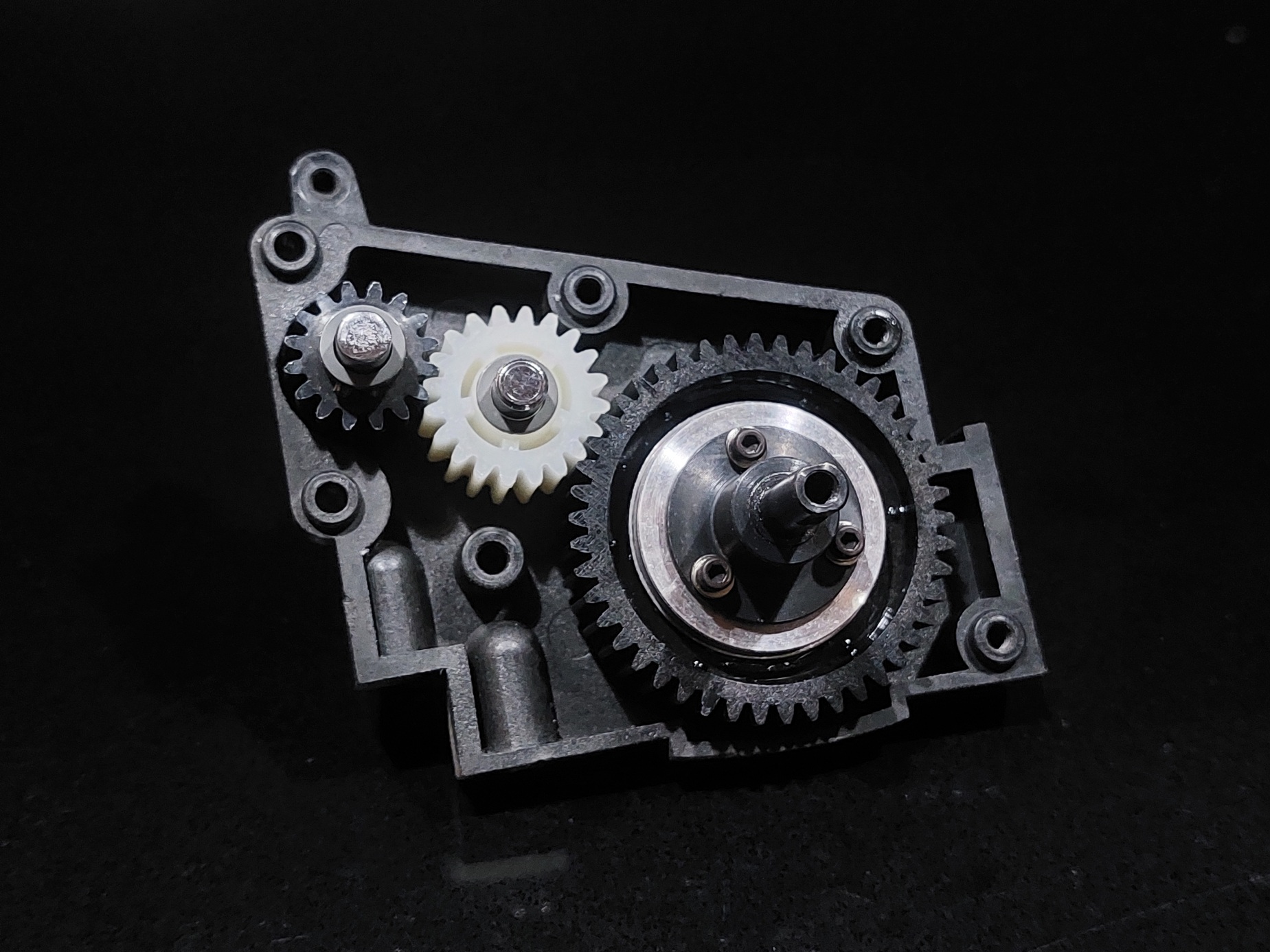

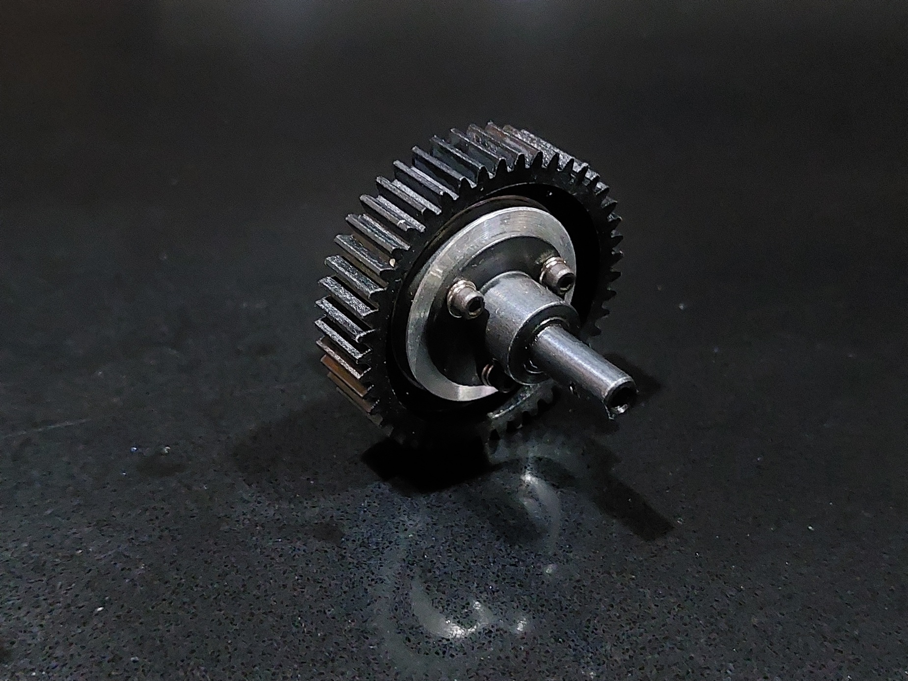

Moving onto the transmission......
The ball diff is a cross between the 2520 and 4620 diffs.
Diff finished
New gears...
Diff finished
New gears...

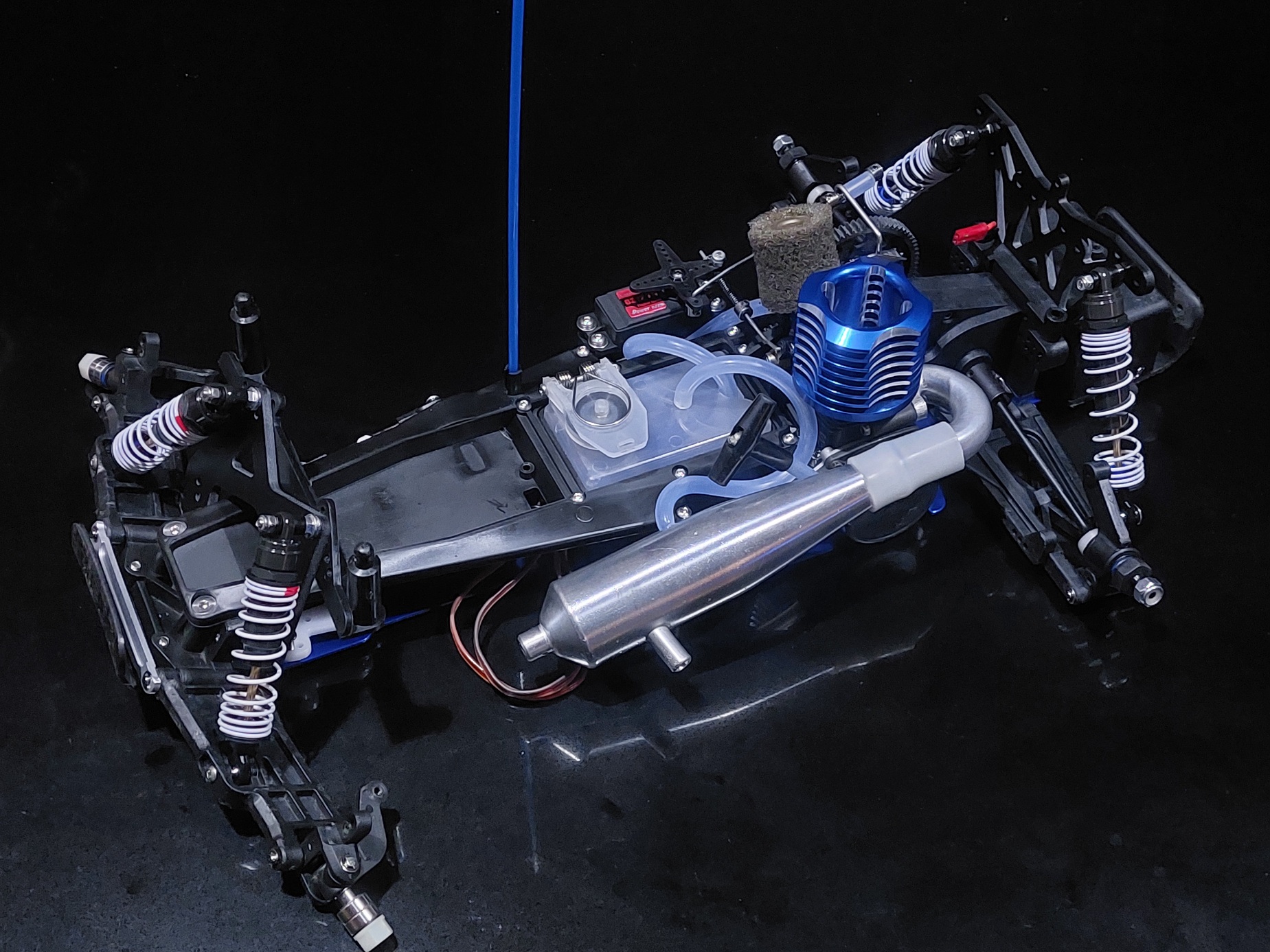

Finished transmission bolted in along with rear bulkhead, shock tower and battery box.
Engine and linkage attached. The brake set up is very much like a GT. I'll probably end up replacing the clutch bell as it is pretty worn.
Shocks and pipe, i still need to make a pipe wire hanger.
Getting there......
Getting there......

Nice work! Looking very glamorous! I like the cooling head and those servos. I swear we are on the same wavelength or something because Im putting the same diff in my NS as we speak!
What size hole did you drill in the transmission case?
And what rear shock tower is that?
