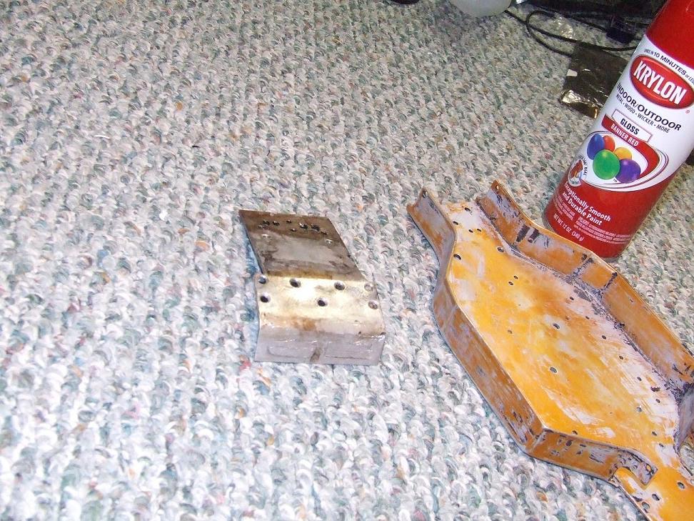

My grandpa and i made a nice aluminum skidplate for my rc10 from a piece of aluminum he had laying arround in his garage. It only has one problem- the aluminum is too soft. Does anyone know how to harden soft/ bendy aluminum? I have it all set up the way i want it but just need it hardened.
As you can see i will paint both red, the tub is orriginal, and was badly beat up, and was painted black last which i took off with break fluid. I really badly need the skid plate hardened, i tried heating it up and dipping in motor oil, but it didnt work. I might not have heated it up enough with my propain torch.- martinthegenius

I don't think it will get much stronger with heat treating. You need to use a stronger alloy to begin with like 6061-T6 which I think is what AE used. Anyway for $10 you could probably get a piece big enough to make a few nose plates if there's anywhere near you to buy the stuff.

Aluminum also has the tendency to move and/or shrink when heat treated.Bugle wrote:I don't think it will get much stronger with heat treating.

it may be too soft, but thats a pretty darn good job on a homebrew noseplate...
