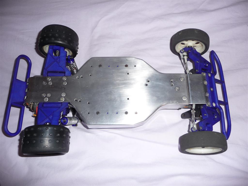

I polished this one. I had quite a hard time getting the anodizing out of the corners and I will probably take another shot at it since I've learned some things since then. The big trouble with removing the anodizing is that the bare aluminum is quite soft and easily scratched. The best way to get a "chrome" look is to use a buffing wheel, which i didn't do on this one. To do a really nice job of it is quite labor intensive IMO. (The wheels are shop rollers - I'm going to get some new chrome ones soon)

That looks really cool. Maybe do a full polish, then scuff it up a bit to get that satin look?
Easy Off oven cleaner takes anodizing right off most aluminum....I have used it on several projects, including my bike that
had an almost industrial finish it seemed to it. Just have to keep an eye on the stuff as it will eat threw alot of stuff....
here was the entire bike...just took 2-3 weekends...I did the edges of the rims too, just not in this photo:

Don't use a wire wheel! It will put a lot of hard to remove scratches in the aluminum and make it bumpy. (Ask how I know) You can use fine grade sandpaper 400 progressing up to 12000 or so to wet sand, then use a purpose made white buffing wheel on a dremel or your grinder with polishing compound. Finally, use a good metal polish to bring out the luster. The dye is simple. Use Rit brand fabric dye or equivalent in simmering water then toss the parts in. Stir for a while until the parts are as dark as you want. Rinse in cold water and let dry on some paper towels. You might think twice about dying nice white parts since they are rare and expensive to replace. Use old beat up parts that have been cleaned really well.
