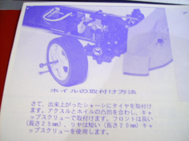

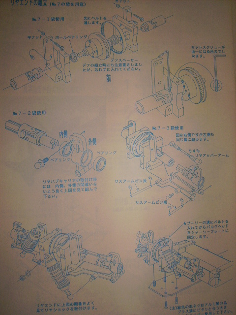

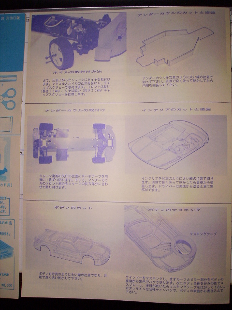

i purchased a 1/10 yokomo 1993 nsx 2wd kitt new. had no wheels in the kit.
My problem is taht i have never sen a wheel with a bow tie on the back that fits into the hub.
here s a picture of the hub.
the rear uses plastic sliders.
Need to see your wheel mounting hubs. have yoke problem

I see some cat xls wheels would fit. but that would look dumb on an onraod car. does schumache make an onroad car with the same mounting system?

The later on road cars like the mission and mi series run hexes. The only on road schumacher cars which may have been different was the Schumacher SST or the earlier Bosscat based tourer.

Sorry for the bump steer - I just checked and all the SST's seem to run hex drives.
It's Cat XL/S/Procat/Bosscat wheels only from what I can see!
I remember you could get all sort of adapters back in the day but I can't find any now. BORMAC or Minichamps are best to advise on all things Schumacher!
