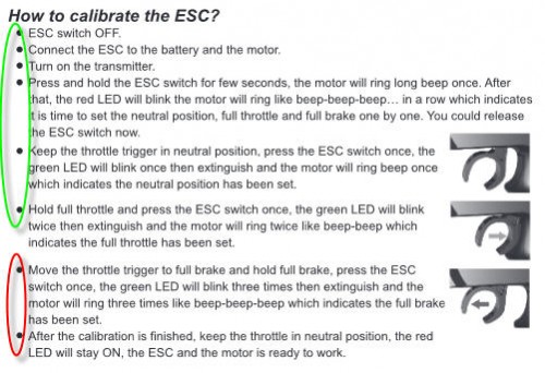

I purchased a I purchased a TrackStar 120A Gen II ESC that I have tried to install. But I can't get throe the whole installation sequence, so I need your help guys! This is my first brushless system...

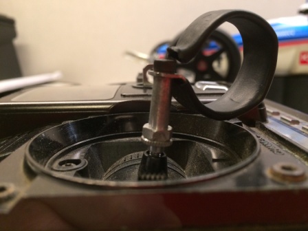

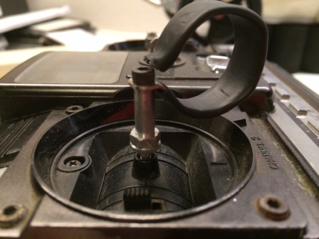

My problem is resolved, there was nothing wrong with the ESC, it was my radio settings
I drive a stick radio (Futaba PCM 1024), an you can have the throttle stick in 2 different positions. 50/50 or 60/40 (throttle 60% and brake 40%). It seems that you can't calibrate the ESC if the stick position is set to 60/40, it must be 50/50!
50/50 60/40
50/50 60/40
