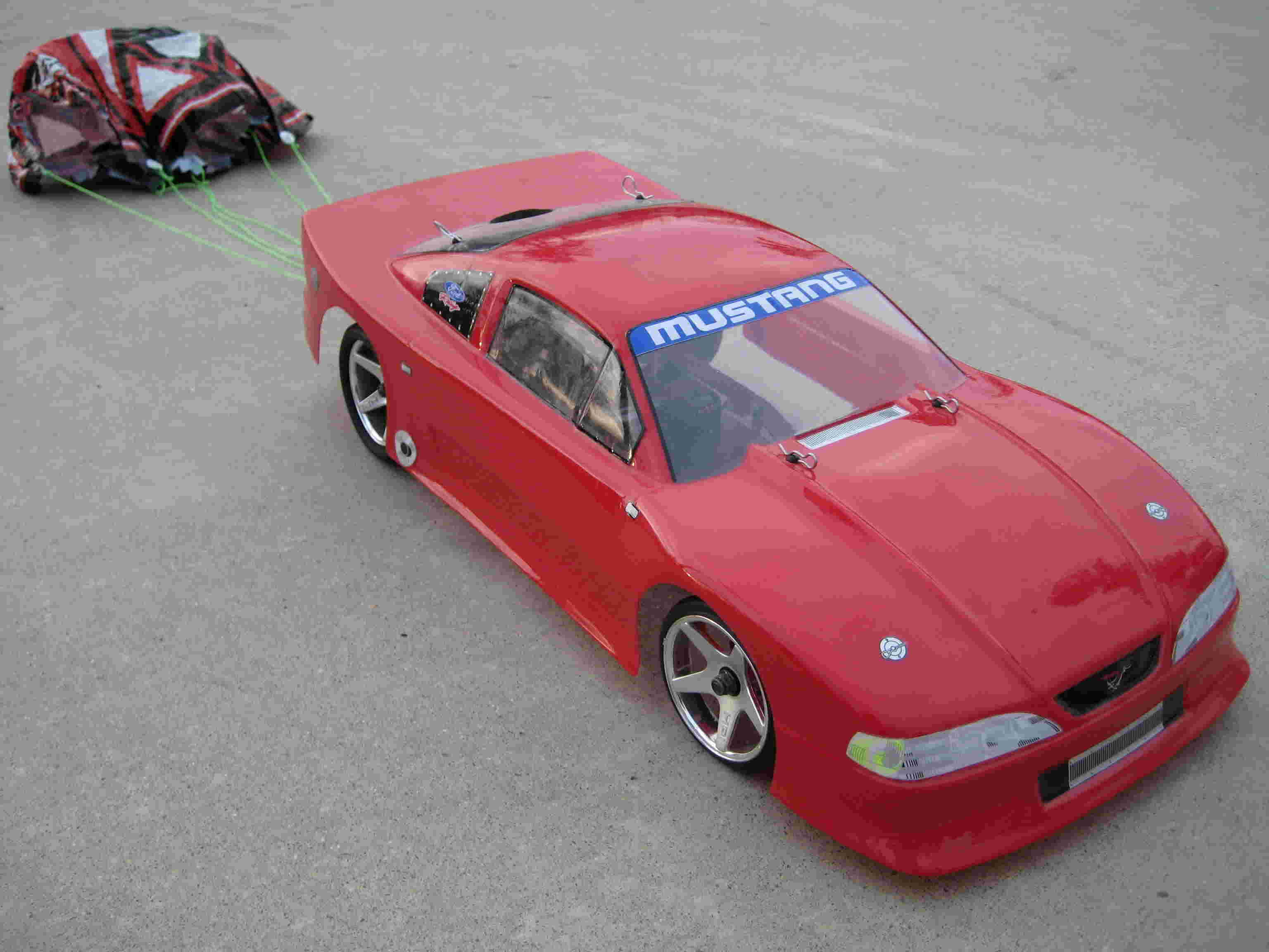

Submitted for your approval:
"Red Rockit" project.
Parts:
.Recycled Associated RC10DS Mustang body. (only 2 additional holes added)
.Mint (no modifications) Kyosho Triumph chassis & shock towers.
.Modified Ultima (front) A-arms front & rear..Fronts are old Andy's arms.
.A&L Ultima ball bearing steering.
.Narrowed chrome HPI 2.0 wheels w/O-ring tires front, standard 2.0 wheels in rear w/Proline Strikers.
.Lowered Duratrax shocks.
.Recycled (fell out of a tree) Estes model rocket, modified for engine mount.
The Triumph trans makes a great Ultima upgrade.
The Triumph can be turned back into a buggy at any time.
Fun project, ..the 'chute deploys after every run.
Created out of parts that were collecting dust in the RC junkyard..
I'm new to the site...sorry.
Parts:

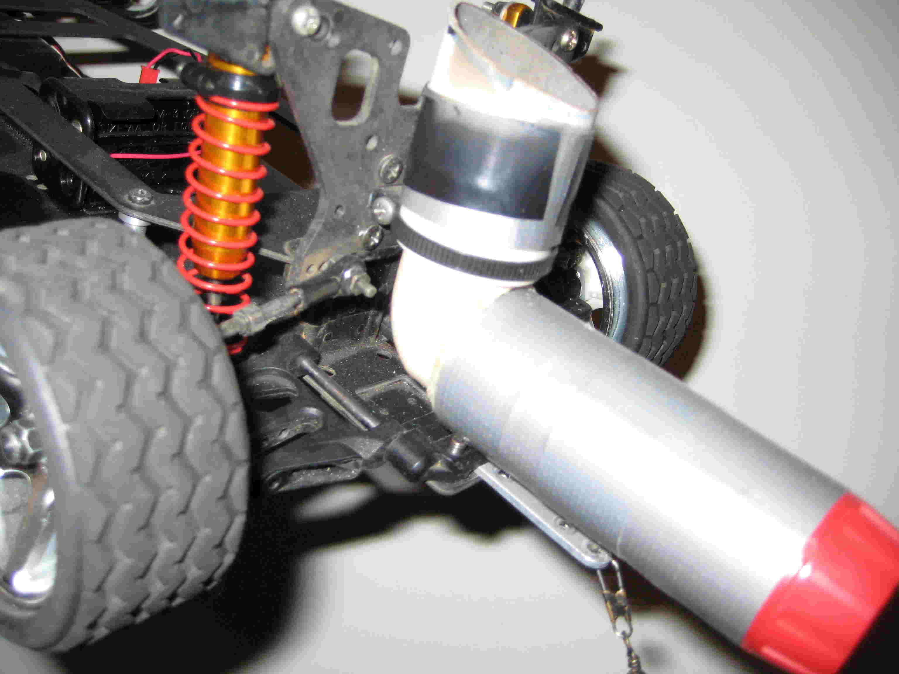

Here's a shot of the engine mount.
It's all PVC pipe & recycled Estes rocket.

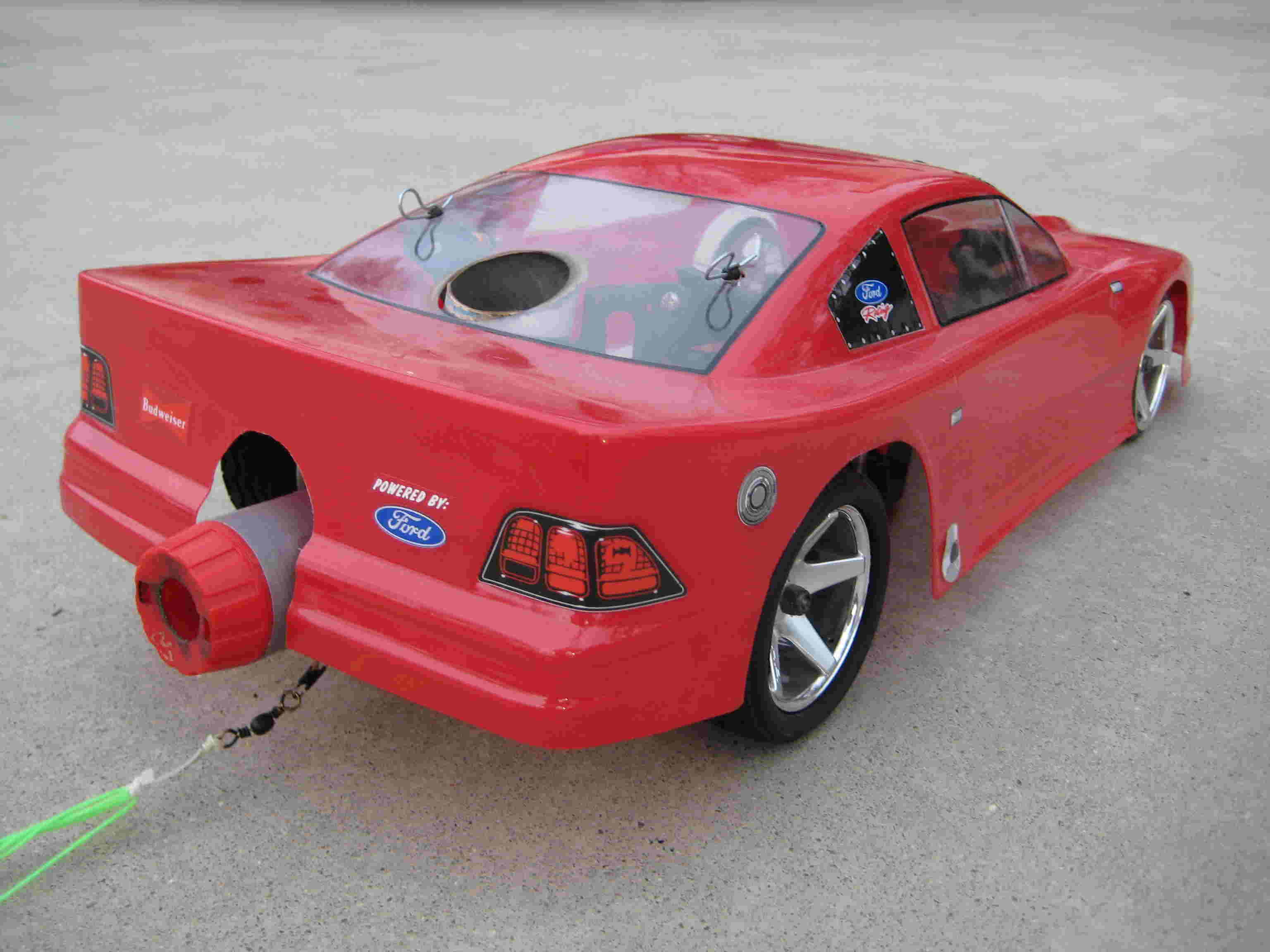

The 'chute gets packed into the vertical end of the engine at the back of the shock tower after the body is mounted.
There is about a 1" opening dead center of the back glass for it to come out.
I goofed on the orignal hole count claim... there is actually 4 additional holes in the DS body. 2 at the cowl, (original fronts are hidden by scale hood pin decals) 1 in the back glass, and one at the rear bumper.
It uses standard Estes rocket engines, packing material & parachute shock cord.
There is an aluminum shock cord mount from another surplus salvaged RC part that fits perfectly to the center (original) hole at the rear of the chassis.
When it's ready to run, about 4" of parachute cord is over the top of the trunk just off to the left or right of the engine. (So far I haven't fried any cord yet)
Right now it's set up for "C" engines.
I plan to upgrade to "D" size in the future.

Re: Kyosho Triumph Project - Rocket Powered.....
It's a blast!
It doesn't go nearly as fast as I'd like, but it looks great when it does it's thing.
I think the "D"'s will add a few MPH.
We tried "D"'s in a Traxxas Fiero years ago and it took flight after losing control. The resulting crash was spectacular.
This set up is about close to the same weight. It tracks straight as an arrow.
The "C"'s are good practice motors.
It starts geeting a little expensive after a few runs though...

Mr casual, the chute gets deployed via that right angle tube, the rocket engine has a chute charge as the rocket ends the burn. it's intended to pop the nose cone and chute on a rocket for a hopefully safe return to earth. before the run, he stuffs the chute in the tube. he made mention of it in an earlier post.
