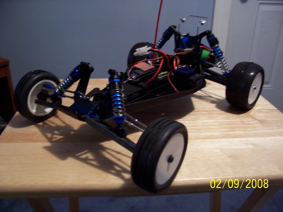

Here is a pic of my B3/T3 project. I was going to restore a T3 . I purchased and new chassis for a B3 . I did not know the length differance at the time. This what I came up with a B3 with T3 shocks and T3 front and rear A arms. I use the B3 shock shafts in the T3 front shocks . I had to swap rear lower shock mounts around (left to right , right to left) to get the clearance for the rear rims. The shock towers Were purchased from tower hobby . If you don't mind the wider suspension and you have the T3 you have all the parts except a chassis the shock towers and short shock shaft for the front T3 shocks.
