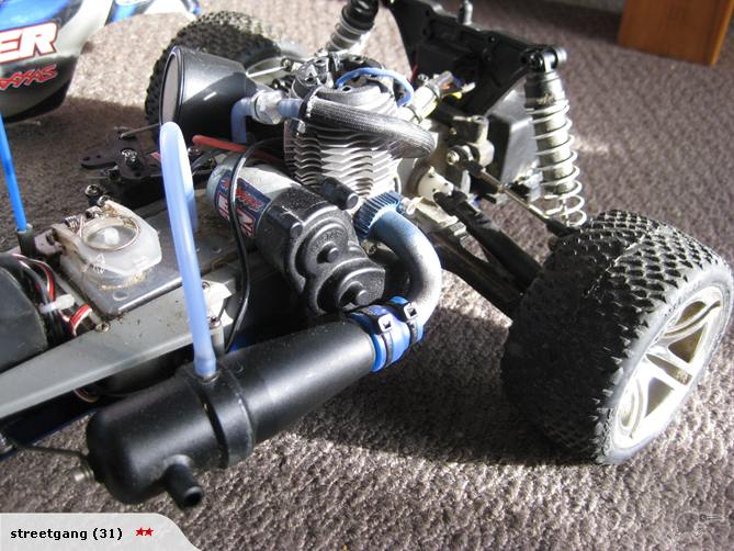

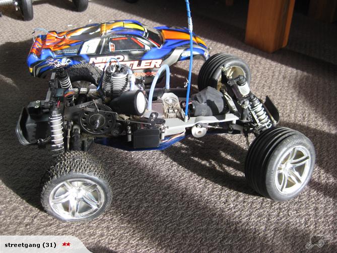

I just scored a Nitro Rustler for a whopping US$90 :D It's the '07 model,too!
It's only 3 months old,but has a stripped idler gear.
Anyone know if I can use the metal gears outta the Magnum 272 tranny in the Magnum 289 tranny in my Nitro Rustler?
Or swap in the whole tranny?
If anyone can help with setup and longevity :shock: tips,please share!
I notice the parts are cheap... :P
Here she is...

Anyone know if I can use the metal gears outta the Magnum 272 tranny in the Magnum 289 tranny in my Nitro Rustler? No you cannot. The number is the internal gear ratio, and also the nitro tranny uses a different pitch gears internally as well
Or swap in the whole tranny? That won't work either since the motor on a 272 tranny is in the back and actually attaches to it and on the 298 the motor is up front and is seperate
