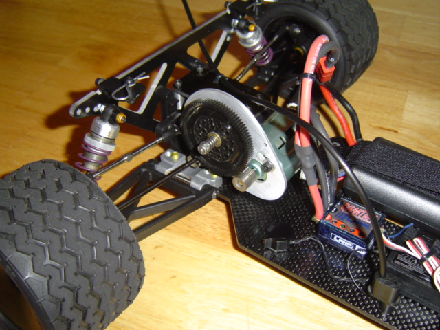

I've had this original RC10 Terminator chassis floating around for some time now and was never quite sure what to do with it. The answer came to me when I was digging through my box of old 10T parts and stumbled on a NIP nose plate (which I'm still trying to figure out how I want to brace). The rest just kind of fell together. I used a set of Daryl Lane's GT towers and fit a GT rear bulkhead with custom tranny brace and standoffs, the rest of the suspension is stock with the exception of lunsford pins and buckles, a new old set of GPM alloy rear arm mounts, custom works interim shocks, and composite craft steering. Next up will be the body, I have a super mod truck body for it, but I'm kind of thinking of fitting up a slammed original 10T body on it for a super sleeper retro look.

If you're not against putting a couple of holes in the chassis, you can use the RC10GT nose tube chassis standoff's to brace the front end.

funky build, I especially like the front tower
How did you move the shock mounting points on the front arms outward?
Re: Mid Motor Oval 10T build
Somebody, I don't remember who, used to make nylon blocks that bolted into the stock holes/location that moved the bottom mounting location outwards.Mr. ED wrote:funky build, I especially like the front tower
You could look around for the pieces for a DS front end that might get you closer the ballpark.PBR Allstar wrote:I've had this original RC10 Terminator chassis floating around for some time now and was never quite sure what to do with it. The answer came to me when I was digging through my box of old 10T parts and stumbled on a NIP nose plate (which I'm still trying to figure out how I want to brace). The rest just kind of fell together.
adam lancia wrote:If you're not against putting a couple of holes in the chassis, you can use the RC10GT nose tube chassis standoff's to brace the front end.
I thought about that, but the way the battery slots are in the chassis, and the fact that the battery is moved forward on the left side, repositioning the servo to the right side, it wouldn't work.
The shock Towers are from Daryl Lane at Factory Works, formerly the "L" in A&L. The are really nice pieces and have all the mounting hardware and spacers for the lower shock mounts.
The two bodies I'm considering are an original team truck body slammed down over the chassis, or a Factory Works, super mod oval truck body.
xtreme makes a pretty cool cf front brace that might work for ya. but i don't know if you'd be able to sneak the front of it through the factory works front tower.
here is how i braced mine, i know i posted it on dirtoval but here are some more pics with the brace. i tried a few different styles of bracing before i setteled on this one, it worked the best. by the way the belcrank screws are stainless not aluminum, that alone helped alot the aluminum ones just kept bending.
Thanks for the pics Bill, I saw them last night on dodc. I'm still not quite sure how I'm going to do do it, Last night I was playing around with some 3/16 T-6 rod, but it was late and I didn't get very far. Basically I was thinking about mouning them up like stock to the front bulkhead, and putting a bend in the so they came straight down to the chassis on either side of the steering bellcranks, with a 4-40 tapped hole in the end. We'll see, I'm going to mess with it more tonight. Okay, off to work!
Okay, got the rest of the chassis sorted out I think. I made some nose brace tubes, and tidied up the rest of the bits. I ended up making the tubes out of 3/16 stainless rod, and bent them in a brake tubing bender, I drilled the hole in the bottom end in the lathe prior to bending them so tapping the 4-40 hole would be easier (still a pain in stainless, but then again, anything in stainless is a pain). Not super fond of the 10T steering, I forgot how much I don't like those big long bellcranks, for now I just have a servo arm on there, I had a small kimbrough servo saver on there, but it doesn't have enough resistance and the wheels would just flop around, I'll have to pick up something a bit more robust. Anyway, here are some more pics, just have to mount up a body now!
