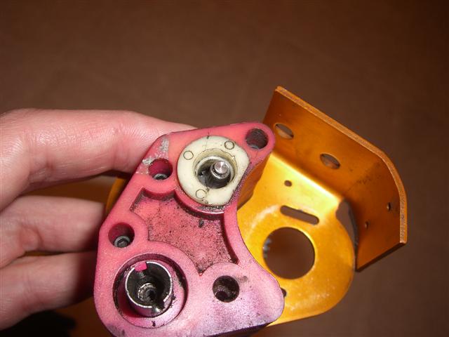

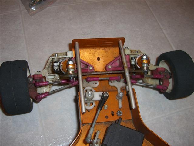

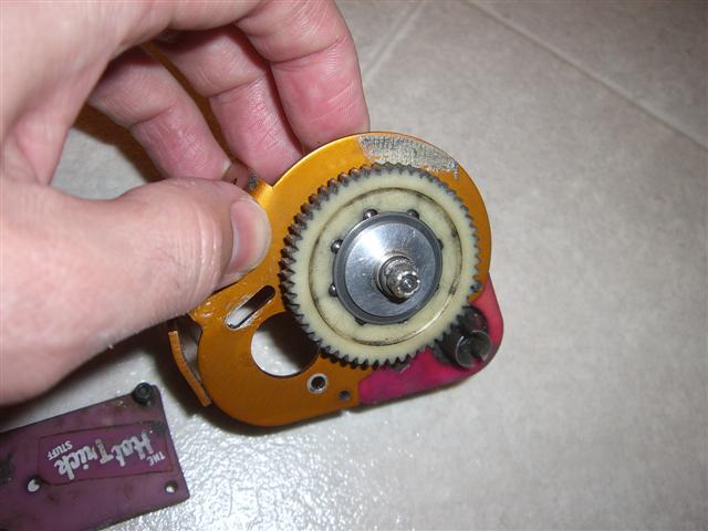

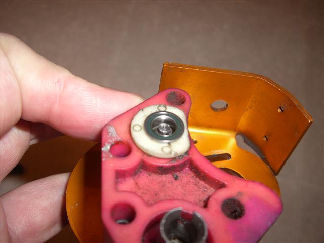

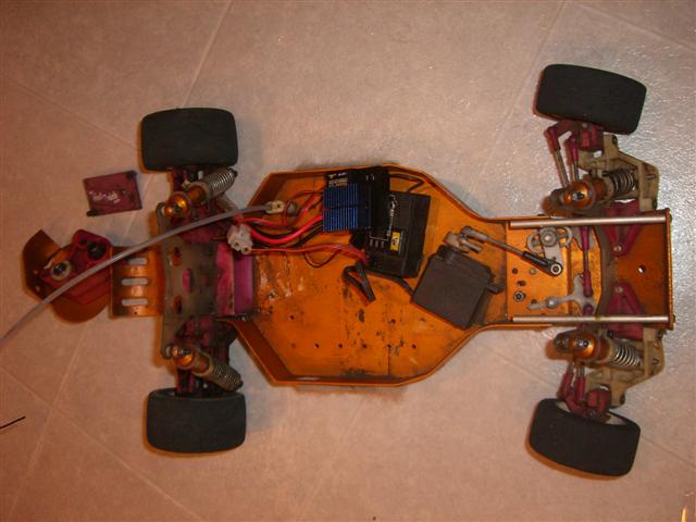

Here are the pix of my old RC10 showing the transmission. The red transmission brace has a "Hot trick Stuff" sticker (which looks pretty well stuck on like it was originally there), but I don't know where the transmission comes from, as I bought the thing from another kid when I was about 13 (20 years ago). Also look at the bearing that's missing, and compare the stock bearing size fit into the bearing adapter -- there's still a lot of free play, so I think the drive shaft is thinner than stock.
Also, the thing is pretty dirty, but hey, it's been in a box in a shed for 20 years.

thats a stock associated 6 gear transmission. its been dyed red along with the tranny brace, but they are both factory.
apex pretty much explained your problem. there's a bearing that goes there held by a c clip.
go here and scroll down to the original buggy instructions and the pdf will show ya what parts and how they all go together.

Thing is, see picture 1251. I explained this all to Associated, looked up the part, ordered the "correct" one, and the bearing that's in there (see in the picture) has an inner diameter that's too big. It doesn't fit, and I don't see any other bearing that could fit. Do you know the exact dimensions of the bearing that's supposed to go there?
