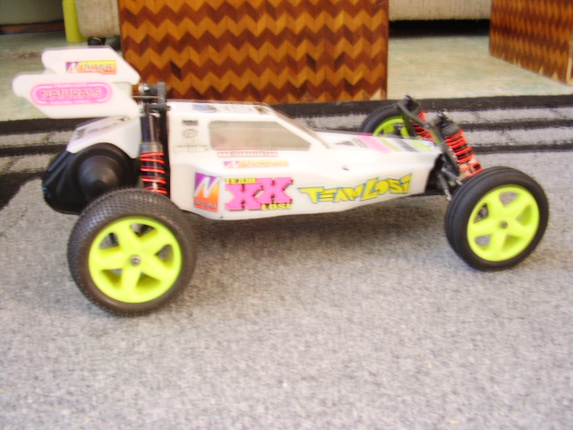

Does any one know if the rear hubs from a XXX will fit on a XX? The reason is the XXX rear wheels don't fit, the rim rubs on the top part of the hub. So rather then grid away at original parts I thought I would try and fit the XXX hubs and see if that solves the problem.
