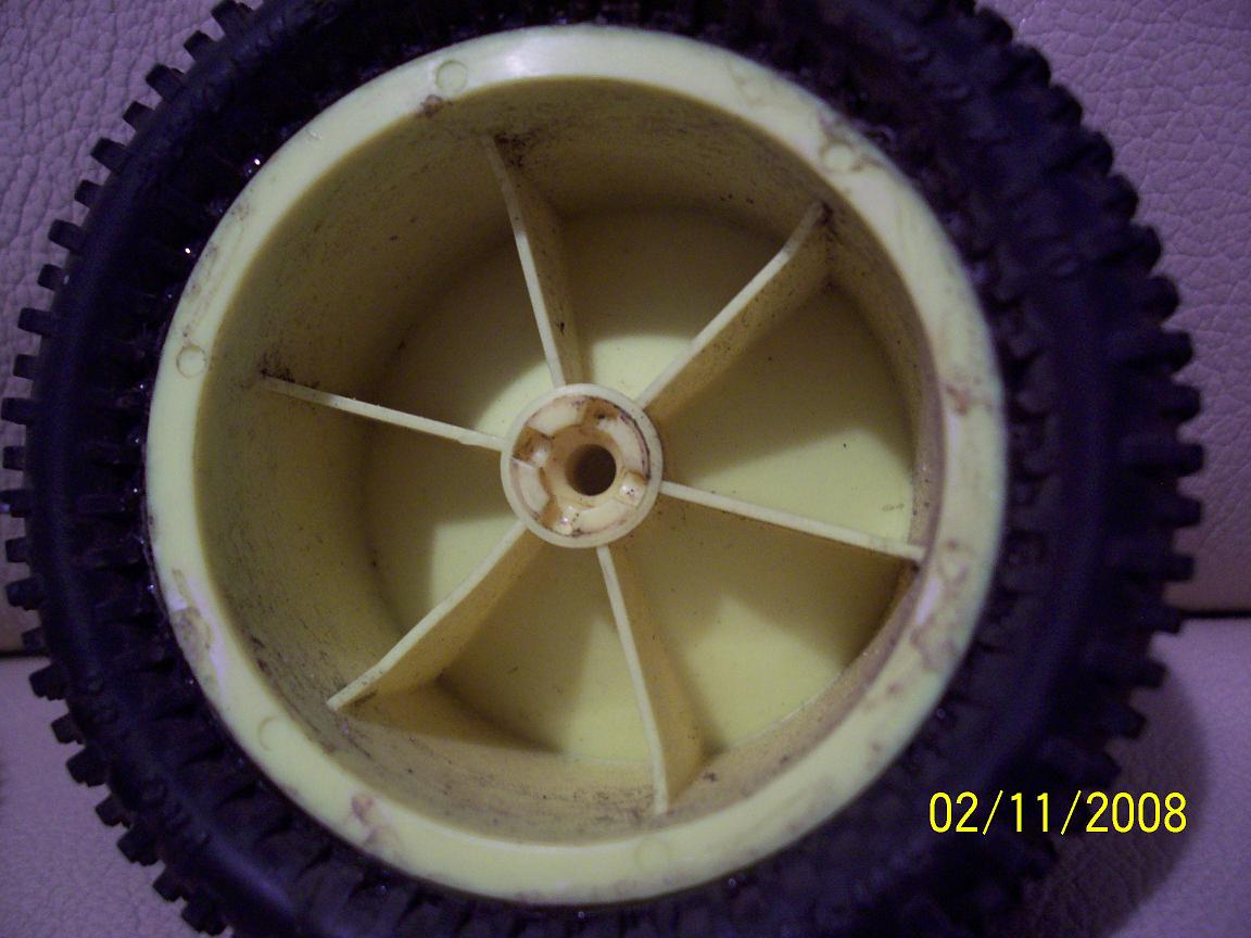

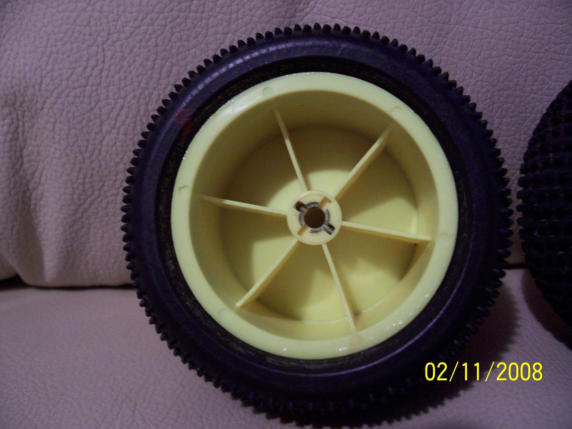

I have the B3 sport rear rims and the B3 team car rear rims . The sport rims are for the 1/4" axles and the team car rims fit the 3/16 axles.

because the old axles used a 1/4" bearing, and the old rims were tapered for those axles. the newer rims are for a 3/16" axles, hence the need for a different bearing and axle. now, you could get just a 3/16" stub axles and use dogbones instead of getting cvd's. but you'll still need to get the correct bearings. you can't beat cvd's, though.ericsp2 wrote:y the cvd's and new bearings
