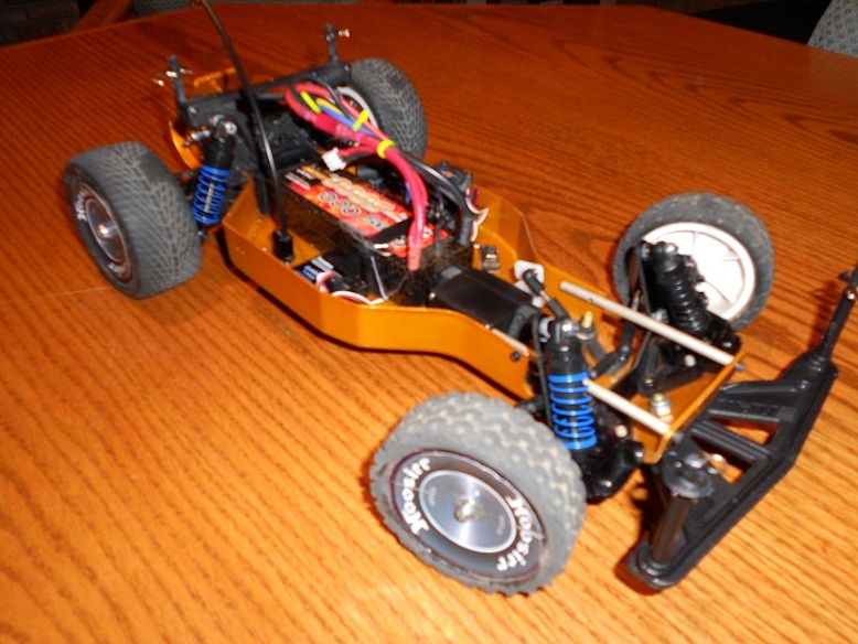

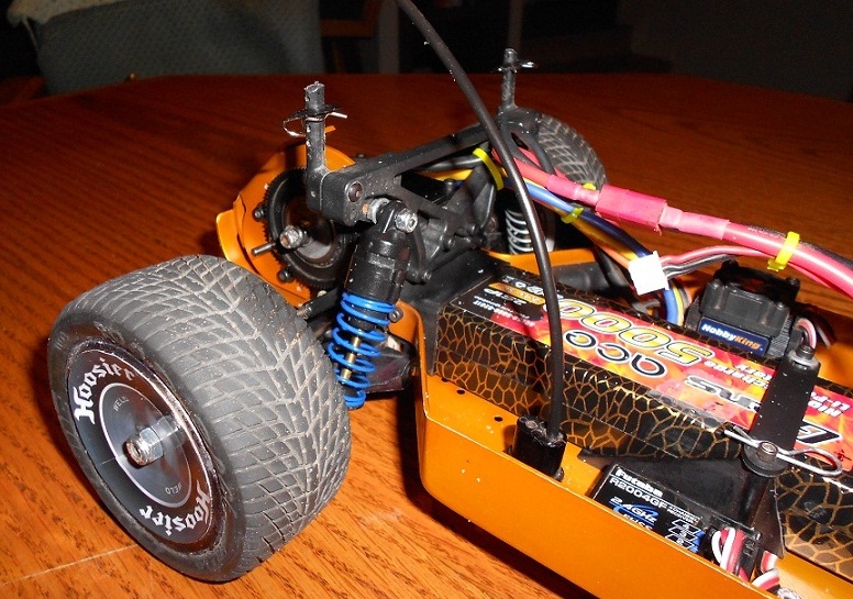

Russ Winn wrote:I have officially moved to phase 2 (I guess this thread should be moved to the "Onroad" section.....Nahhh!)
Here's the DS in race trim. I never thought I'd race it, but it works well on the oval. Basically, it's stock, with TC shocks and Duratrax rims using Custom Works tires on front and Pro-Lines in back. The body is a Mcallister 55 Chevy bomber. It's a little short for the chassis, but it has good clearance, and isn't bulky....They're gonna freak on Saturday :twisted:
are they tc4 shocks front and back??

Re: Project Circle Track
Post by Russ Winn »
Yes they are. I swapped out the gold top-load shocks with my TC4 because they simply looked better on the car. I wasn't planning on racing the DS, and thought black shocks went with the refinished chassis. I was too lazy to switch them back, but they work, so I'm leaving it alone.

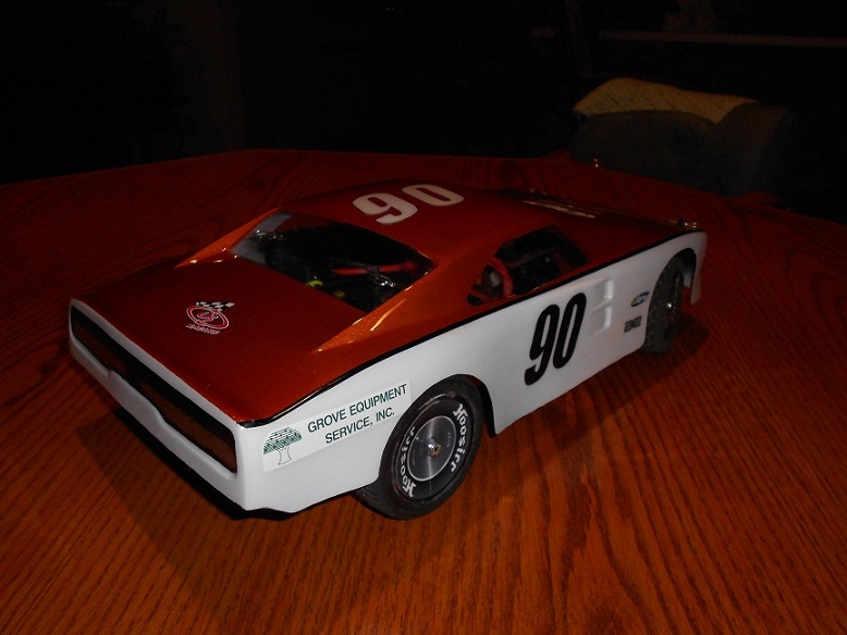

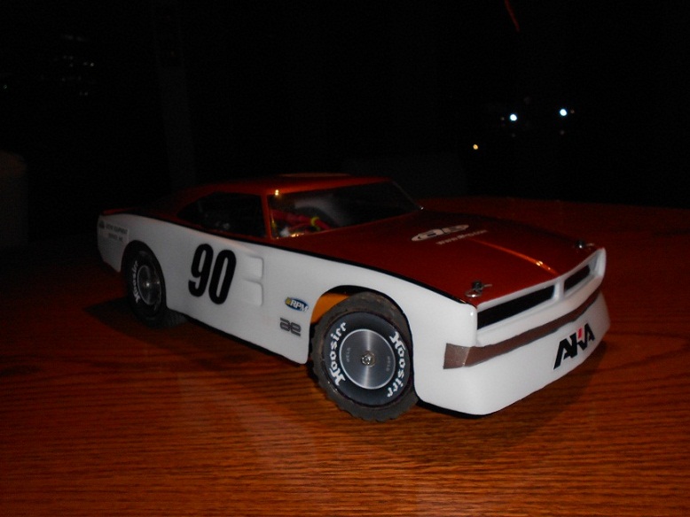

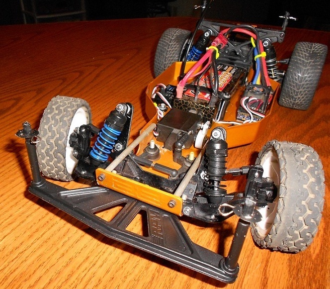

Post by Russ Winn »
Well, the project has evolved once again. I've learned a lot since getting back into racing. The days of Nicads, brushed motors and hard pin spikes are far removed from today's equipment. I've finally figured out what setups and tires work, and how to keep it working as the track changes. That being said, here's phase 3 of the ongoing project.
I liked the stability of my 6 gear, but was having a rough time getting it to corner correctly. The DS worked really well on a low to medium bite track, but had a tendency to traction roll on a high bite surface. After getting a feel for how everything reacts, I've decided to bring back the 6 gear with some changes...I swapped the rear bulkhead and shock tower to the short style from the DS, and I'm using the short TC shocks I was running. Also, I reverted back to the original short arms in front. The car is just as fast as before (plus I now have a ton of 6 gear tranny and axle parts for spares), but now it feels more predictable in the corners. I did make one slight shock mod by using .80" shafts in the rear. The stock lengths were just a bit too short. That change makes it sit level, with no excess weight transfer at the corner entrance.
All that's left is drive and adjust for conditions.
Also, since I'm never satisfied, I had to add a new body for this version, as well.
OK....I'm done, unless I get another wild hair :lol:

Is that a cuda body ????

REMJ666 wrote:Is that a cuda body ????
Yes. It's a 69 from McAllister.
