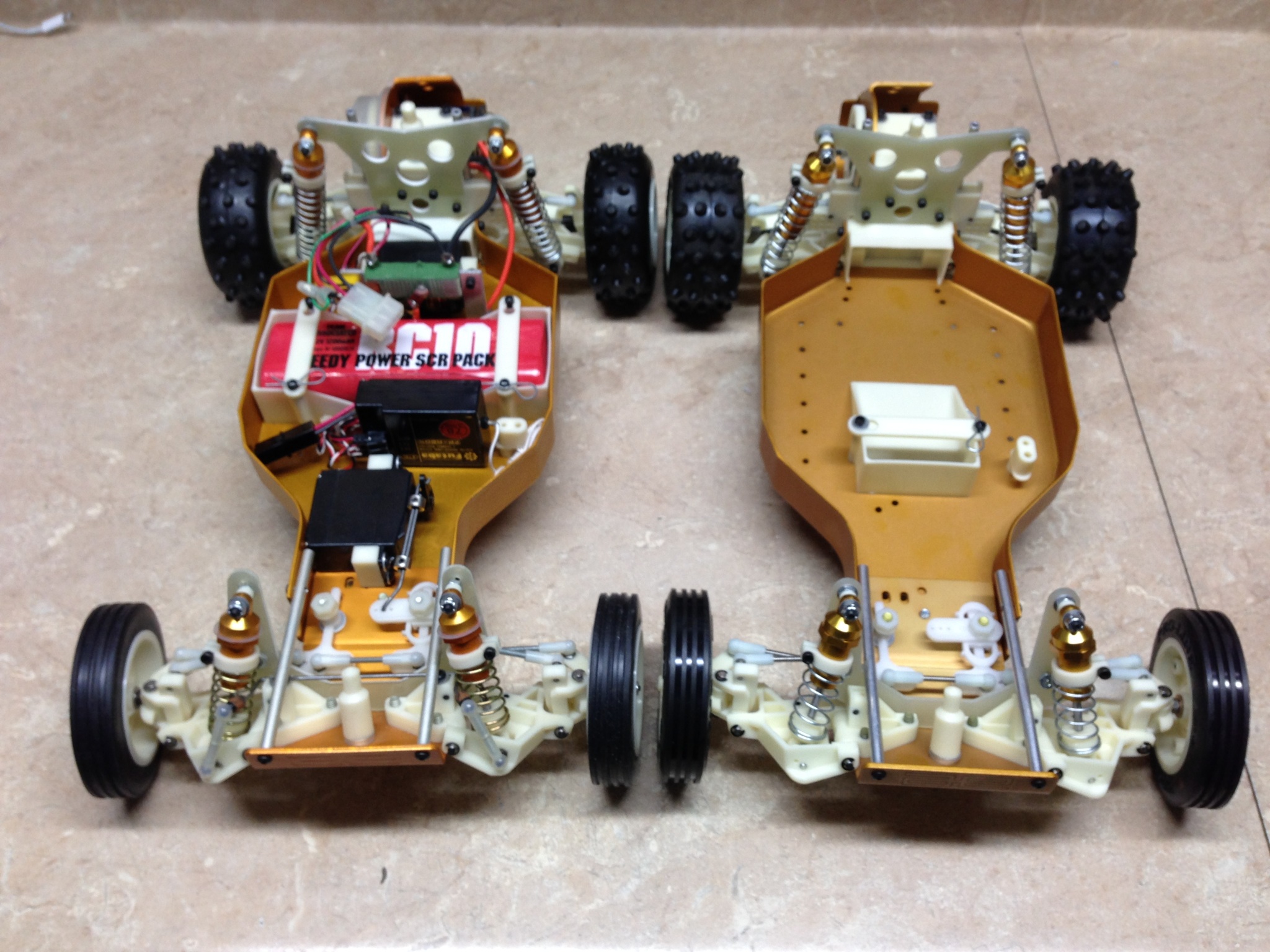

Is the gold anodizing a different shade on the new Re re versus the original?
Posts: 12336
Been thanked: 3919 times
Re: Part Differences - Old vs. New
Yes it's different. A bit lighter but not like the early cars either. It's also dull and blotchy. Here is a caddy on the left and the rere on the right
