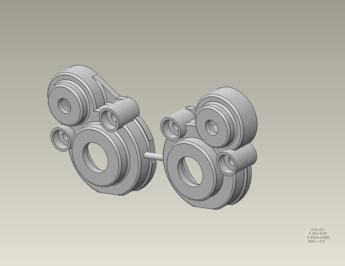

So Jeff (GoMachV) and I are taking on the 2-gear stealth trans case/4WD project together. Here's the first pass. There are no mounting provisions on so we can have freedom to play with different mounting options and how it will fit with the other components up front.

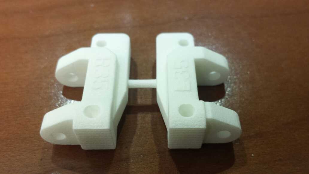

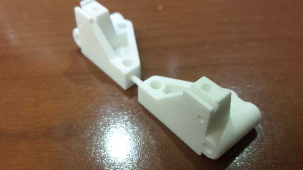

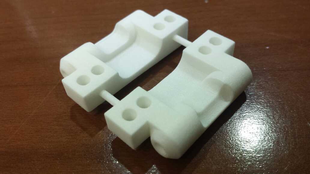

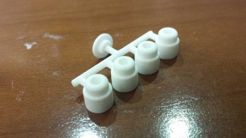

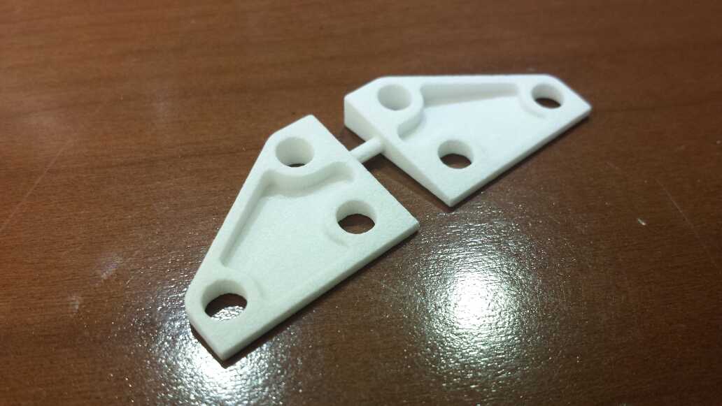

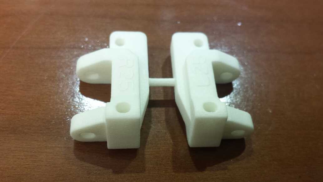

Got a nice package from Shapeways yesterday:
Stealth cap and spacers 25 degree kickup arm mounts 10 degree caster shims 0 degree toe x 3 deg antisquat rear arm mounts +5 degree caster blocks -5 degree caster blocks As soon as I verify all this stuff works, I'll make them avalable on Shapeways.

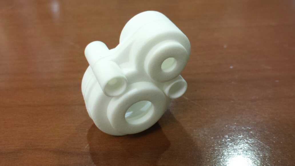

Oh, and not to forget the 2-gear Stealth box

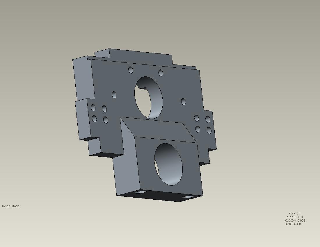

I finally got around to designing the "bolt in" mid-motor rear bulkhead. This bulkhead uses the rear two 6-gear mounting holes and puts the bulkhead in the correct position for a mid-motor conversion. Use this with either my bolt-in 3-gear or 4-gear mid motor case and you don't have to drill any holes in the rear of pan. Prevents "Swiss Cheeseing" of the chassis, like I had to do on my B1M to mount everything. I also trimmed the "wings" off to save you some money (less material = lower cost from Shapeways) and retained the World's and Team ball stud holes, and added another below each for more tuning options.
Once I get one of these made for myself and check it out I'll make them available.

I was wondering what you were going to do with the battery pocket. It looks like the bulkhead is moved forward a little bit as opposed to just having the proper hole spacing.

Yeah, you got it, the bulkhead is moved forward. If i just put holes in the original location but changed the spacing the bulkhead would be back too far. With this bulkhead and the bolt-in trans cases the outdrives are in the stock location and the trans and bulkbead are the right spacing to use the stock trans brace.
